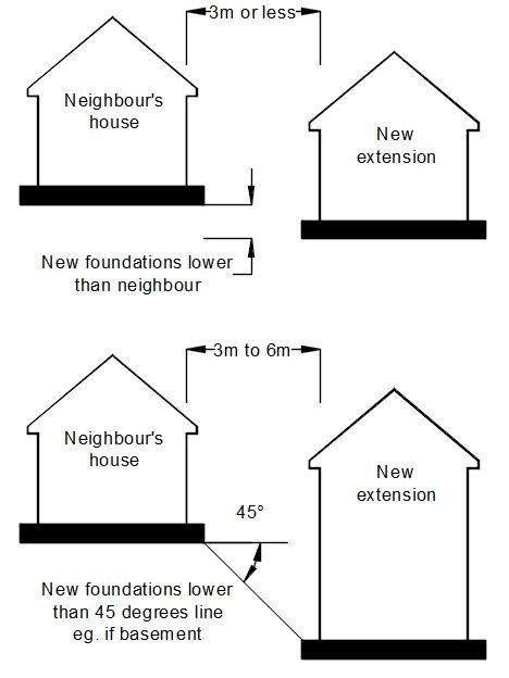

Willow Posted July 8, 2019 Share Posted July 8, 2019 We are building our new build 1.5m maybe 2m away from both neighbouring properties but excavating less than 3m, i'm trying to get insurance quotes , turning into a nightmare . Link to comment Share on other sites More sharing options...
PeterW Posted July 8, 2019 Share Posted July 8, 2019 Have you looked at the party wall rules picture ..?? It should help you http://www.mypropertyguide.co.uk/articles/display/10105/are-my-proposed-works-covered-by-the-party-wall-act.htm Link to comment Share on other sites More sharing options...
Bitpipe Posted July 8, 2019 Share Posted July 8, 2019 (edited) 11 minutes ago, Willow said: We are building our new build 1.5m maybe 2m away from both neighbouring properties but excavating less than 3m, i'm trying to get insurance quotes , turning into a nightmare . Per @PeterW's post, the key distance is that between your structures (which may be less than the distance between the actual walls when foundation widths are taken into consideration. The depth is relevant if you're going lower than their foundation depth which you'll need to guesstimate to some degree, when was their house built? Edited July 8, 2019 by Bitpipe Link to comment Share on other sites More sharing options...
Willow Posted July 8, 2019 Author Share Posted July 8, 2019 I have looked at the government sites but I'm a woman lol, there will be maximum 1.5m -2m distance between our properties, they are lower than us and I know we are definately not going below their foundations with our footings, their house was build in the late 60s i think. Link to comment Share on other sites More sharing options...
Temp Posted July 8, 2019 Share Posted July 8, 2019 As long as you don't go below their footings you do not need a party wall agreement. Link to comment Share on other sites More sharing options...
JamesM Posted December 5, 2019 Share Posted December 5, 2019 Are you 100% sure you won't be going lower than your neighbor's foundations? Any surveyor should be able to tell you the likely foundations on your neighbor's house. I imagine you know your foundation design already i.e. depth? Link to comment Share on other sites More sharing options...
