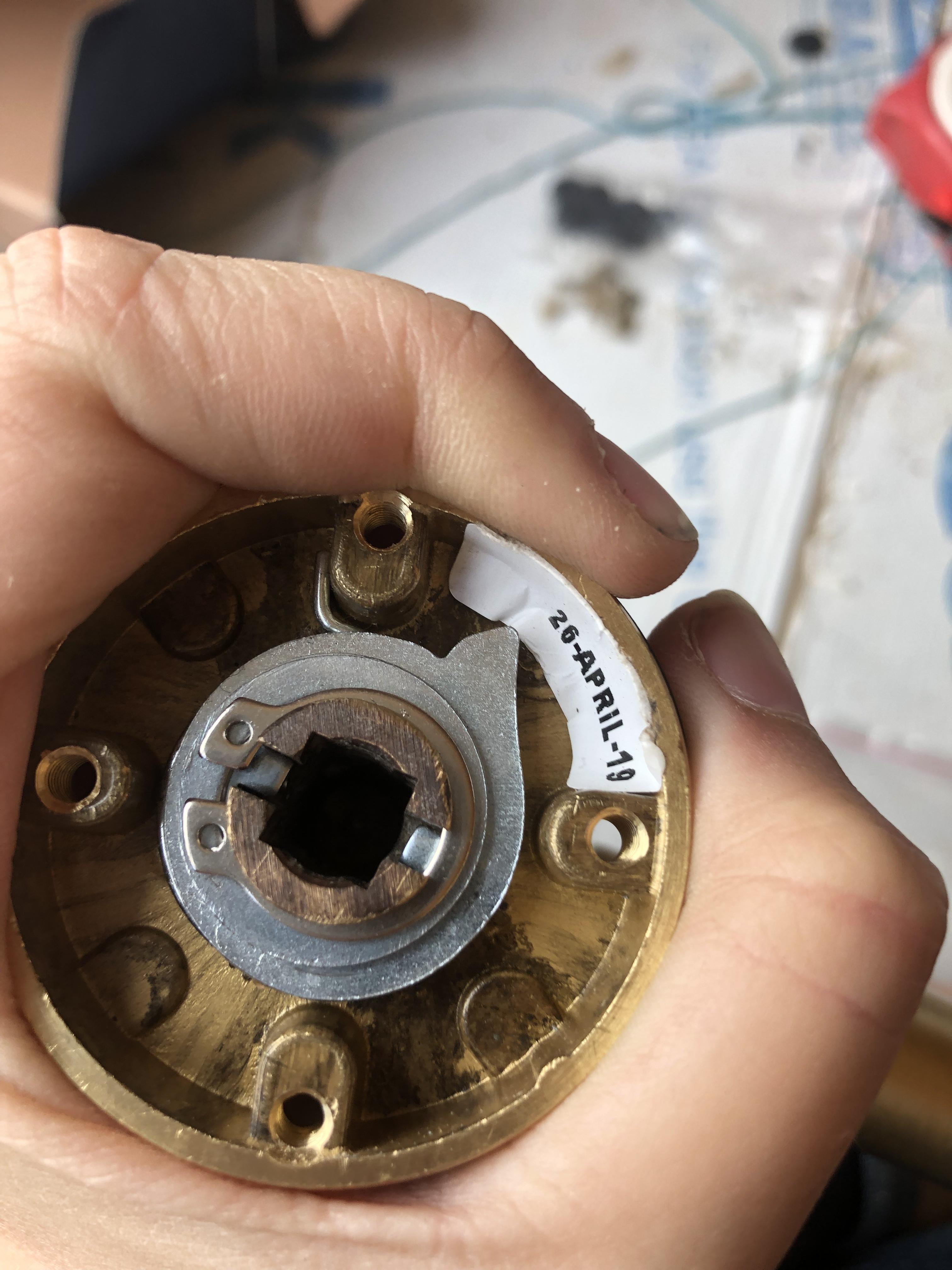

Roz Posted July 2, 2019 Share Posted July 2, 2019 So I bought a door handle for our bifold doors, I’ve never bought one before so didn’t think much about it. The bifolds have got multipoint locking on them so the handle needs to lift up as well as push down. But it only goes down. Anyone know if there’s a way to convert it?? It’s a heritage brass handle Link to comment Share on other sites More sharing options...
Carrerahill Posted July 2, 2019 Share Posted July 2, 2019 (edited) 40 minutes ago, Roz said: So I bought a door handle for our bifold doors, I’ve never bought one before so didn’t think much about it. The bifolds have got multipoint locking on them so the handle needs to lift up as well as push down. But it only goes down. Anyone know if there’s a way to convert it?? It’s a heritage brass handle If the square shaft which goes into the multipoint lock will be held in position by the lock mech itself then you can remove the stop plate, grind the stop lug off and refit without it also remove or modify the action of the spring. The handle will then go both ways but will have no integral position hold mechanism - but as I say, the lock mechs "home position" should hold the handle where you want it i.e. 9 or 3 o'clock position. Many UPVC door handles just swing round and round when off the door and rely on the "home position" from the lock itself. If not you would need to alter the stop plate and spring arrangement. In a word, yes it will be possible - but it comes down to a bit of luck or your ability to modify it. Edited July 2, 2019 by Carrerahill 1 Link to comment Share on other sites More sharing options...
Roz Posted July 2, 2019 Author Share Posted July 2, 2019 17 minutes ago, Carrerahill said: If the square shaft which goes into the multipoint lock will be held in position by the lock mech itself then you can remove the stop plate, grind the stop lug off and refit without it also remove or modify the action of the spring. The handle will then go both ways but will have no integral position hold mechanism - but as I say, the lock mechs "home position" should hold the handle where you want it i.e. 9 or 3 o'clock position. Many UPVC door handles just swing round and round when off the door and rely on the "home position" from the lock itself. If not you would need to alter the stop plate and spring arrangement. In a word, yes it will be possible - but it comes down to a bit of luck or your ability to modify it. I’m going to try removing the stop plate etc and see what happens... thanks! Link to comment Share on other sites More sharing options...
BotusBuild Posted July 2, 2019 Share Posted July 2, 2019 When you remove the stop plate, replace it with a washer (or something similar) that is of equal thickness to the stop plate. It'll stop the handle "slopping about" (technical term ? ) BTW: Can you actually continue to use that handle as it appears to have an end date in the past? ? 1 Link to comment Share on other sites More sharing options...
Carrerahill Posted July 2, 2019 Share Posted July 2, 2019 6 minutes ago, BotusBuild said: When you remove the stop plate, replace it with a washer (or something similar) that is of equal thickness to the stop plate. It'll stop the handle "slopping about" (technical term ? ) BTW: Can you actually continue to use that handle as it appears to have an end date in the past? ? I'd just use the stop plate with the lug ground/cut off as it will have a square hole in it and therefore be a decent fit and the correct thickness. Link to comment Share on other sites More sharing options...
Roz Posted July 2, 2019 Author Share Posted July 2, 2019 (edited) 40 minutes ago, BotusBuild said: When you remove the stop plate, replace it with a washer (or something similar) that is of equal thickness to the stop plate. It'll stop the handle "slopping about" (technical term ? ) BTW: Can you actually continue to use that handle as it appears to have an end date in the past? ? ? I should ask for my money back based on that! I’m sure it’s go down well well @BotusBuild and @Carrerahill thanks for the responses. I removed the innards and they seem to be sitting ok in the middle and they lift up now too. They sit a bit pointing downwards but, not too much I can do about that. Better than nothing! Im going to put the innards back in at some point (once modified or replaced) to stop any slipping around, but they seem to be sitting ok at the moment. Phew! Edited July 2, 2019 by Roz 1 Link to comment Share on other sites More sharing options...
Temp Posted July 2, 2019 Share Posted July 2, 2019 Might also be a problem with the spring. You may need to leave that off as well. Link to comment Share on other sites More sharing options...
Roz Posted July 2, 2019 Author Share Posted July 2, 2019 Just now, Temp said: Might also be a problem with the spring. You may need to leave that off as well. Yes I left the spring out too, I couldn’t figure out what nuisance it would cause so tried it without and seems alright! Link to comment Share on other sites More sharing options...
