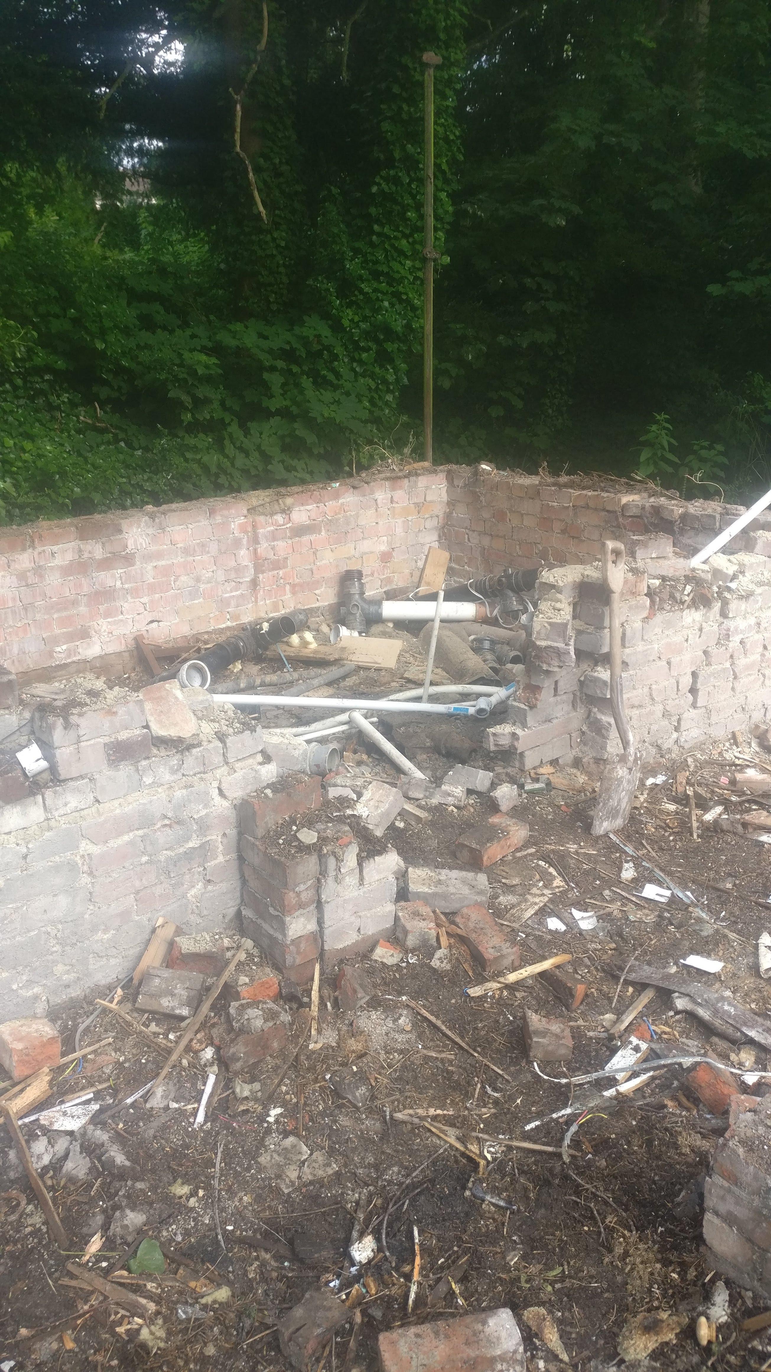

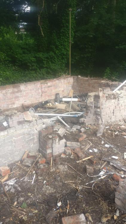

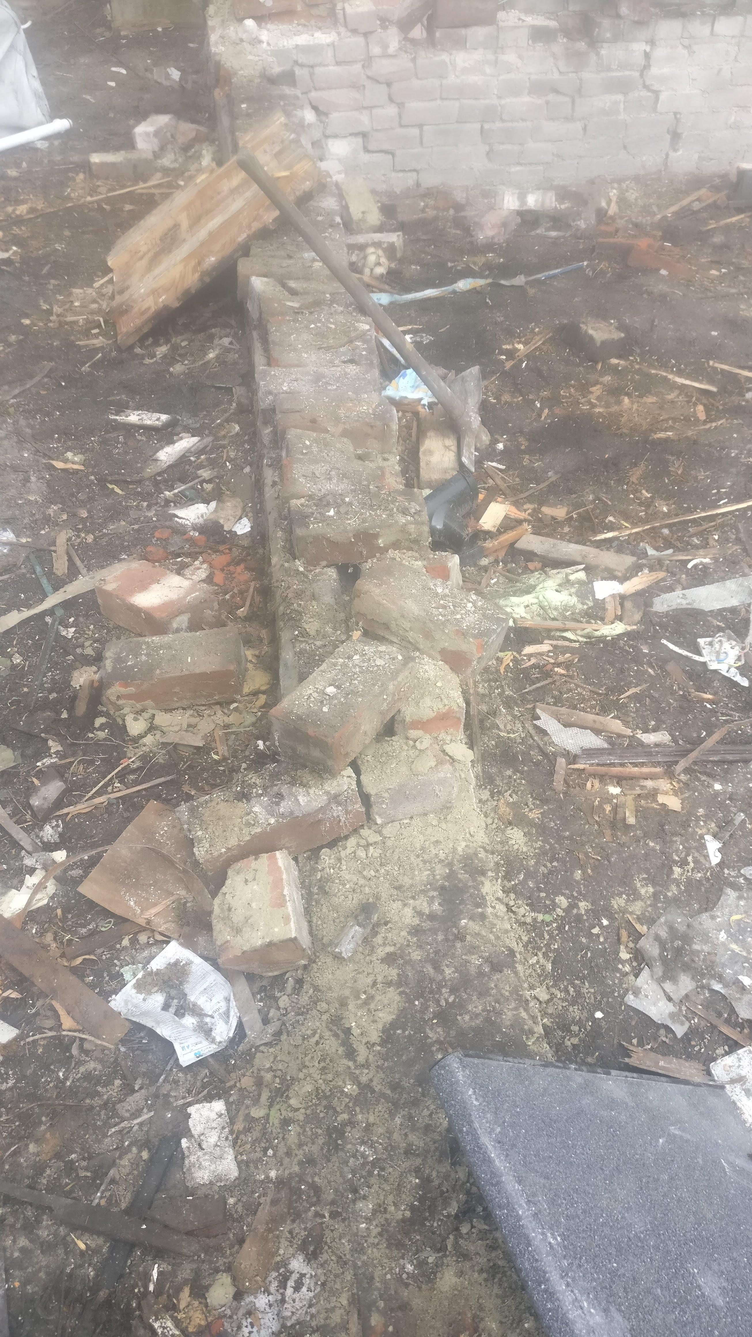

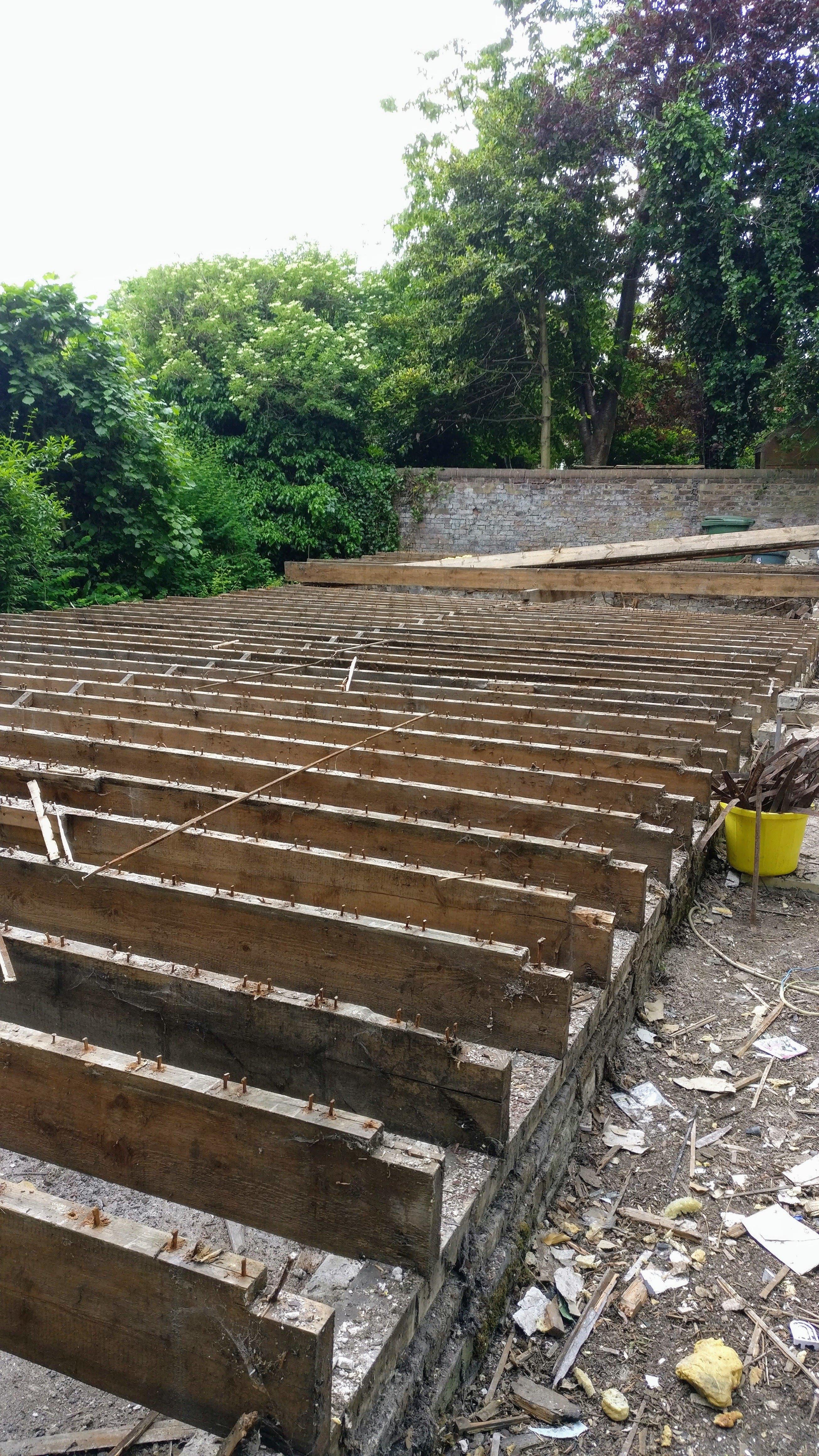

I am nearly done with my entire demolition. We only got the little Brick Plinths wall left where the previous suspended Timber floor was sitting on :
(This was the previous Timber Floor):
The new Foundations go in the exact same spot as the old Brick wall
(this is whats left of the now) :
So my Problem is, I want to re use as many of the old bricks as possible , but a fair amount is just crushed or falling to pieces when you touch them.
I am going to remove the bottom of the walls with a mini digger, but would like to avoid carrying/driving the old bricks that cant be reused out of the site.
So my Plan was to keep them in the middle, underneath the new buildings Block and Beam floor .
Maybe crush them to Gravel and fill the bottom of the Trenches as well.
The only rule I am aware of atm for suspended Block and Beam floor is, that you need an airgap/clearance underneath of at least 150mm , better 225mm which is ventilated and clear of organic material.
Is there any rules or practical reason not to do this .
So my plan was
next, to dig out the old wall and at the same time dig the trenches for the new build , ready for the piling contractor to put piles in and concrete the RC beam with the Piles in 1 go .
Any suggestions?
It is OK to have inert rubble under the suspended floor. Make sure it is OK with the piling contractor as they sometimes need special support for larger rigs.  If there is any topsoil I would remove it.

All I would say is it’s not normal to dig your ring beam trench before the piling contractor, he may struggle to get his rig in position with trenches everywhere, he will also collapse the sides of your trench with his rig.
Normally put piles in then dig between the piles.
Agreed . Thats how it will normally be done.
Problem is that I have to dig out in order to get most of the exisitng Brick wall out.
Alternatively I could do as you say by lowering the Brick wall to Ground level, let the Piling Contractor put the Piles in and than dig out the trenches (with the exisitng brick wall) in between the Piles.
Would take your advice serious , as I m a big fan of your ring beam method and am planning to copy it . Specially the Swift Form, which I think is brilliant
