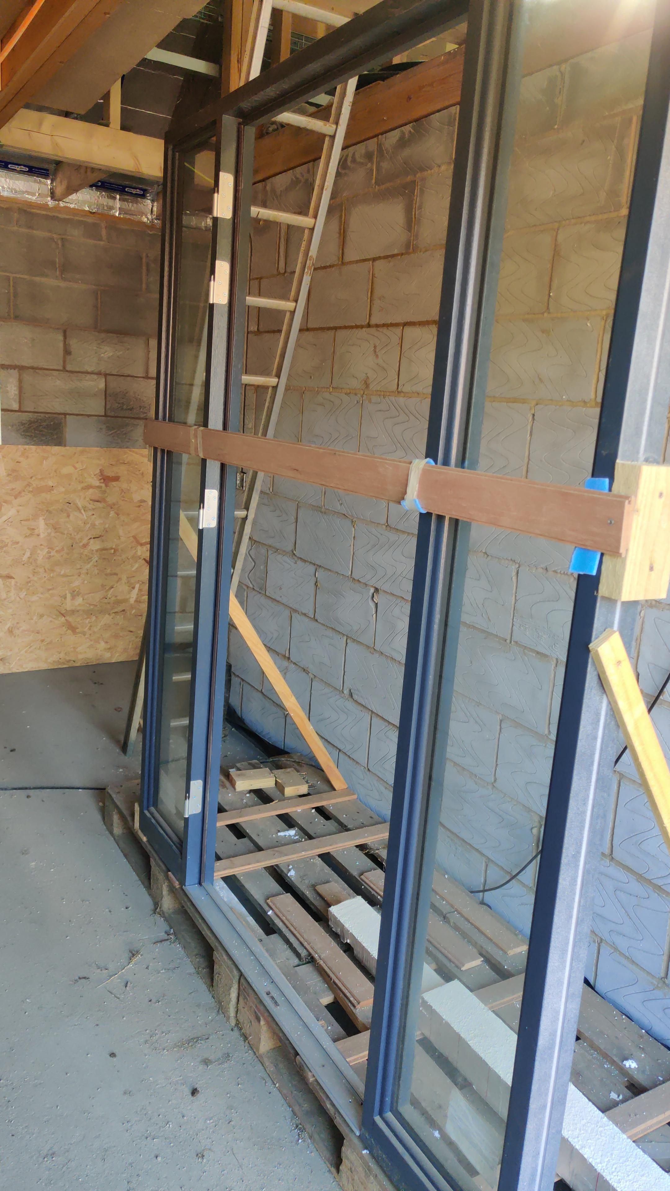

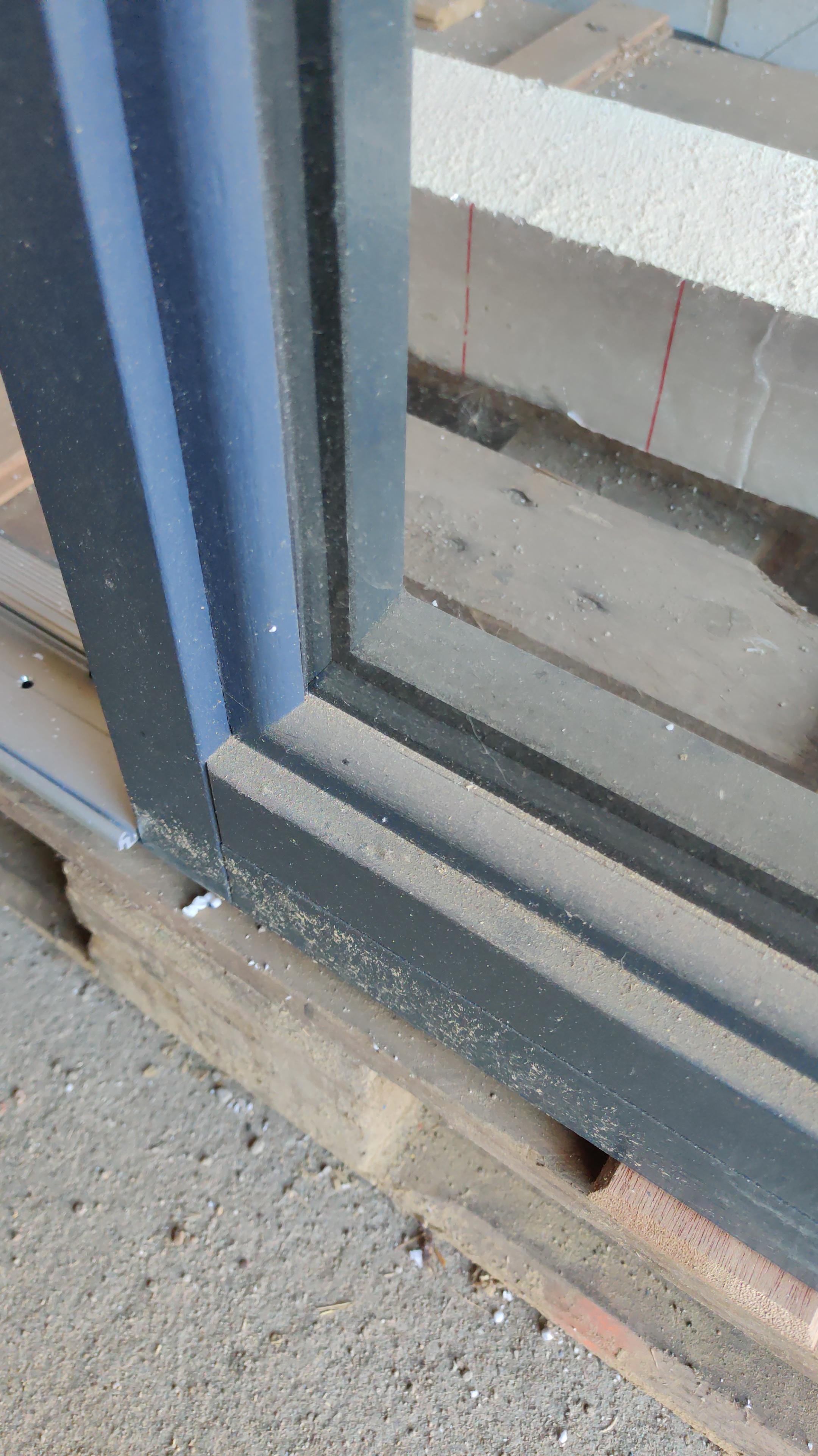

Hello I have a timber front door with sidelights either side. The sidelights are already installed, I understand this is standard practice for transport to keep the frame square. See images. However I now need to install the door, which was fine for the back door without sidelights as I could screw through the frame. The sidelights are in the way for this door though. I have found that you could use metal brackets instead of screwing the frame however I also would like to remove the glass to install multipoint lock keeps. Is it a case of using a putty knife to prise off the bead around the sash? Or just get a glazier to do it? Presumably it is normal to have to do this with sidelights if they are delivered installed? (Feel free to move to the "doors" sub-forum if that's more appropriate!)

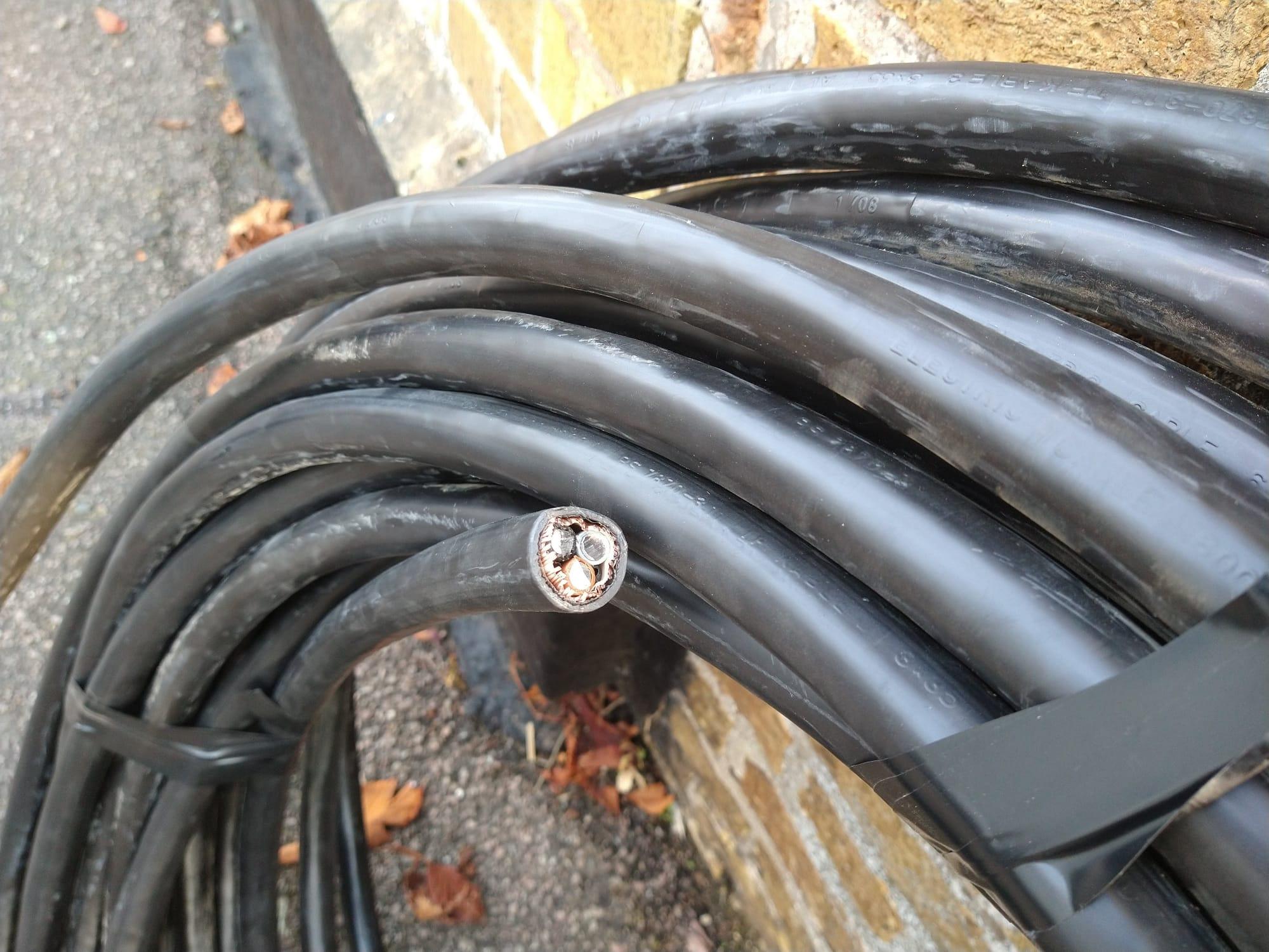

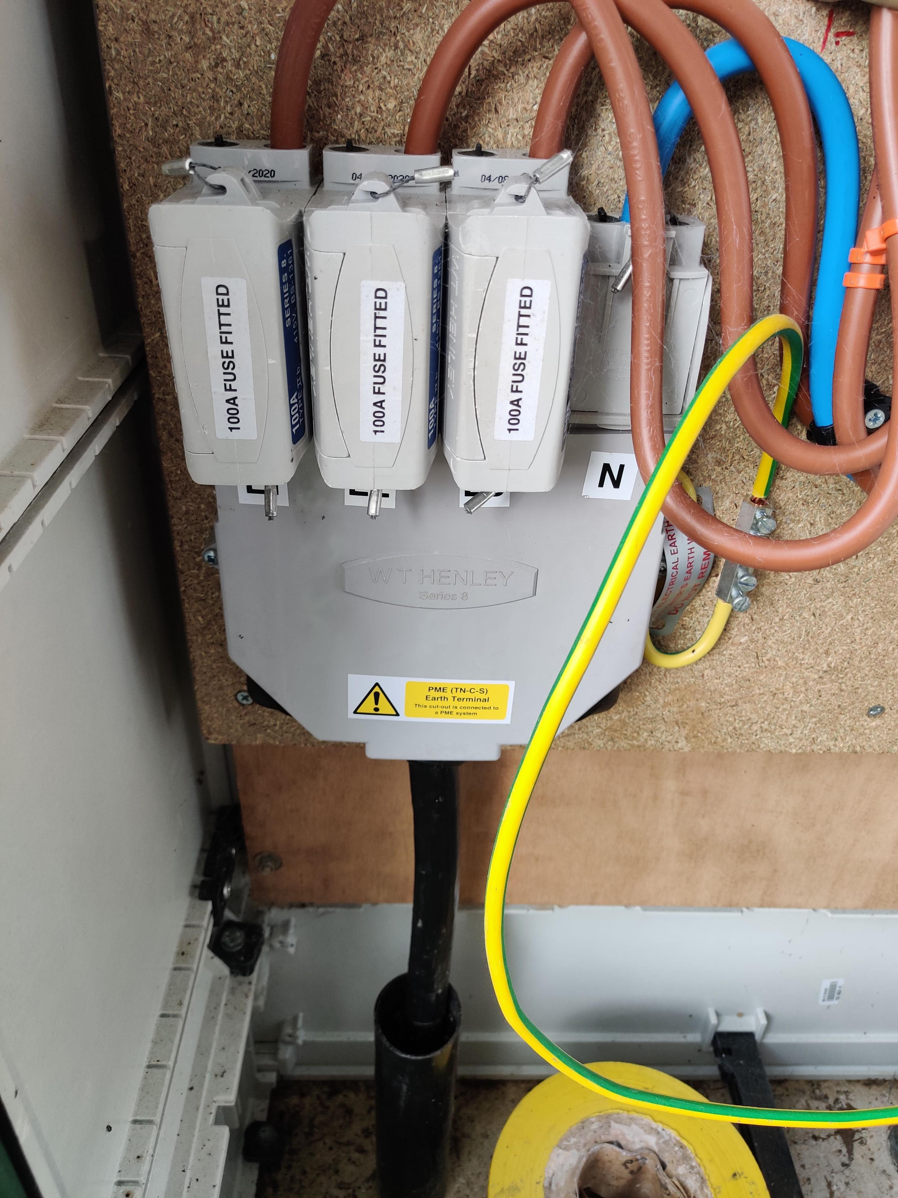

Cable between cabinet and consumer unit
bungledlow replied to bungledlow's topic in Electrics - Other
54mm (2") as requested by UK Power Networks. Difficult to get hold of, nobody seemed to offer them, but Travis Perkins managed to get them in the end -
I suppose I should ask the electrician then, but I think I know the answer - 5 core, the most expensive... -
Thanks, that all makes sense now. They did not leave that cable, I just snapped it before they put it down the conduit so I could see what I was getting for my money! Yes, exactly this. I will purchase a new 4 core SWA cable then and put it in the conduit ready for the electrician. -
Hi, this may be a case of "ask your electrician", but I was hoping I may be able provision the main supply cable to the house without connecting it to the consumer unit as we want to get all the digging done in one go. We have a cabinet with a 3 phase supply, each 100 amp. The DNO used 3 core 35mm SWA (see attached) for this from the joint bay to the main fuse. It is a PME (TN-C-S) system (see attached) so my understanding is the Neutral and Earth are essentially the same. What I don't understand is how the Neutral/Earth is supplied through the 3 core cable. Do they use the armour? The house is another 50 metres from the cabinet, calculators show 35mm cable should be sufficient for this. The question I have is how many cores are required? 3 like the supply cable, 4 to carry the Neutral, or 5 to carry Neutral & Earth? Any advice appreciated
