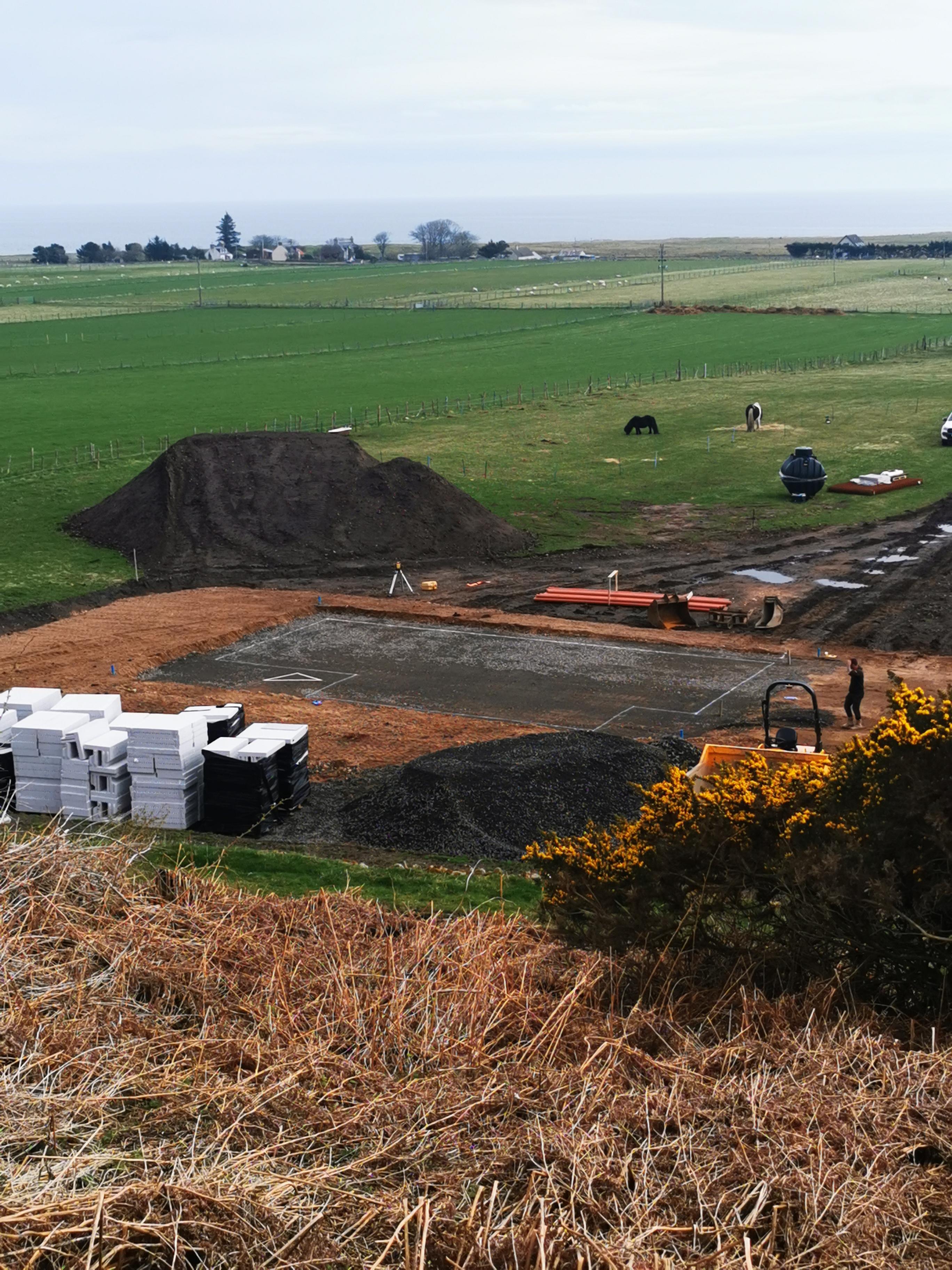

Hi I wanted to put this in the rendering plastering trades section but couldn't click on that topic title for some reason. Has anyone rendered onto external polystyrene insulation? Its actually the base of my founds an EPS insulated raft. The two products i'm looking at are Aquabase EWI 226 a silicone render system with a fiberglass mesh or a cement slurry aquamat elastic with either 10cm polyestewr fleece or fiberglass mesh Anyone done this before and got any advice on either product or covered their EPS RAFT base in anything else that worked well? Cheers

This is where we're at just now. Water and electricity being connected next week and the insulated raft being put together head is spinning but I guess that's building a house and will probably continue for the next 6 months ahhhh so yea I'm not loosing sleep about earthing clamps and tape any more!
