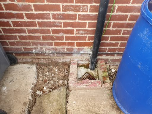

Thanks for your replies. I will check with the installer whether pipe and ducting are sealed. Water does not splash out of the brick surround on the drain, but I think is probably getting between the mortar and wall sometimes. What is the best way to ensure that it goes down into the drain better?
Not sure if it is significant, but there is a down pipe outside, off to one side of the damp patch. The underground drain comes away from the house at an angle (off to left of photo). It is not blocked.
Ground level inside is 3 bricks below damp course, ground level outside is currently only 1 brick below damp course (plan to lower this later this year), so ground level inside is about 6 inches below ground level outside.

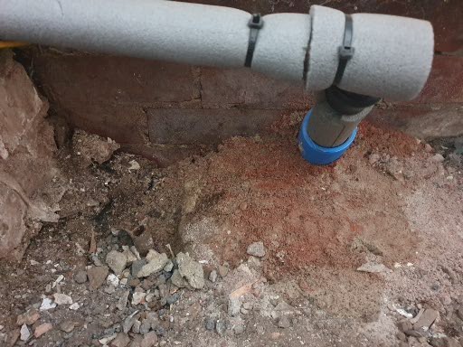

We have recently had a new water supply pipe installed. Where it comes into the house, there is a wet patch. Two weeks later, and it shows no signs of drying out despite not having a floor in that room and plenty of ventilation. Is it the sort of thing that might take months to dry? Would I be alright to insulate and replace the suspended timber floor, or should I leave it open longer?
