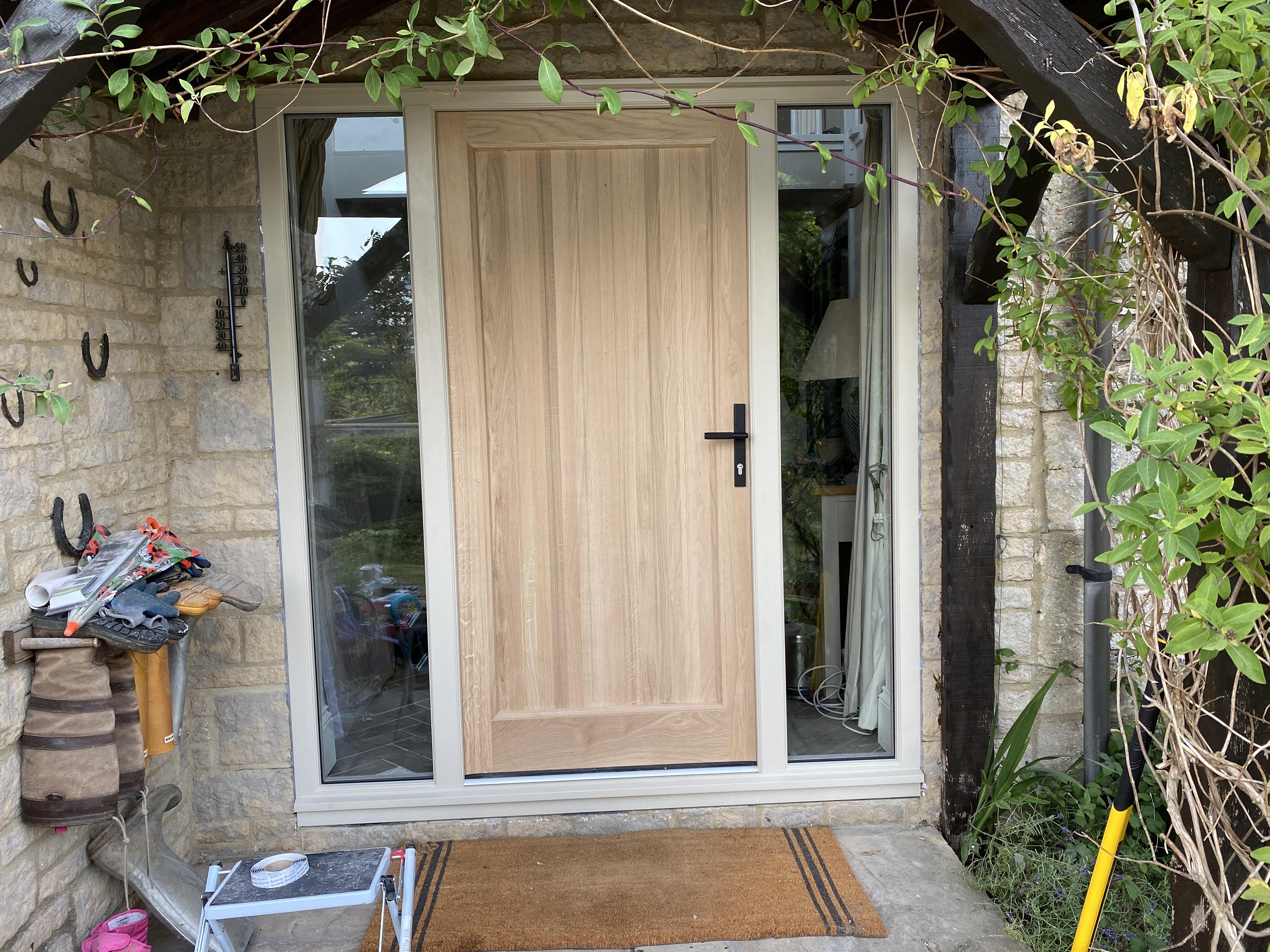

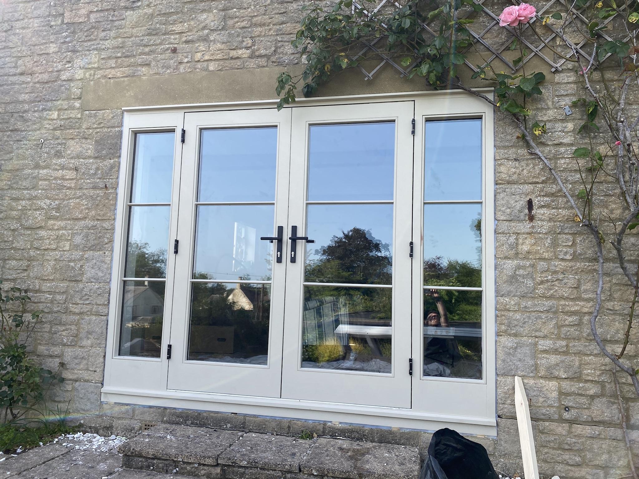

We decided on wooden windows. They look great and are a big improvement on the 30yr old uPVC things that had blown glazing! order process simple, loads of options, simple to fit. V happy! Yes, they will need some maintenance but happy to do that in order to save the 4-5k over the other alu-clad timber products we were quoted for.
