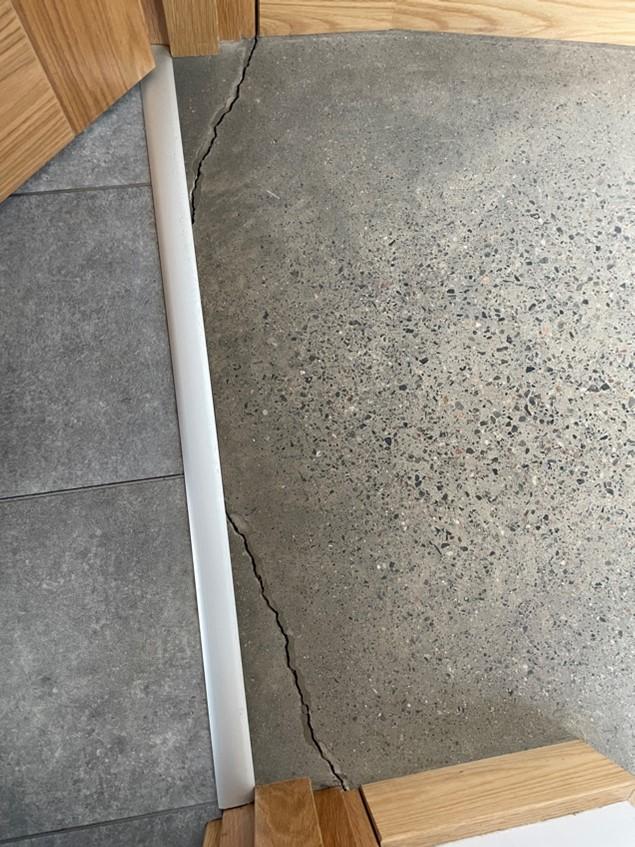

  1. There's nothing on the exterior where the floor crack is thankfully, I think I'll just mix up some cement and fill it in, hope for the best Not sure what a door standard is that you refer to. The house is a timber frame kit sitting on top of a polished concrete slab with UFH (which isn't leaking etc.

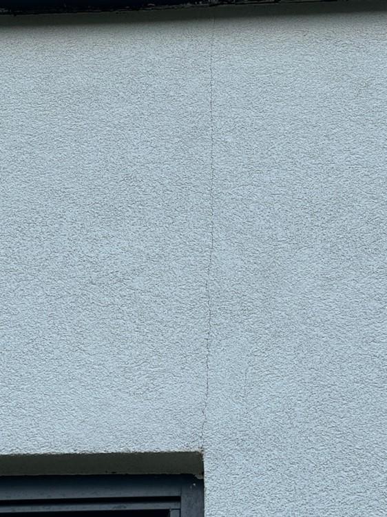

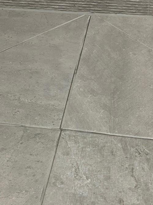

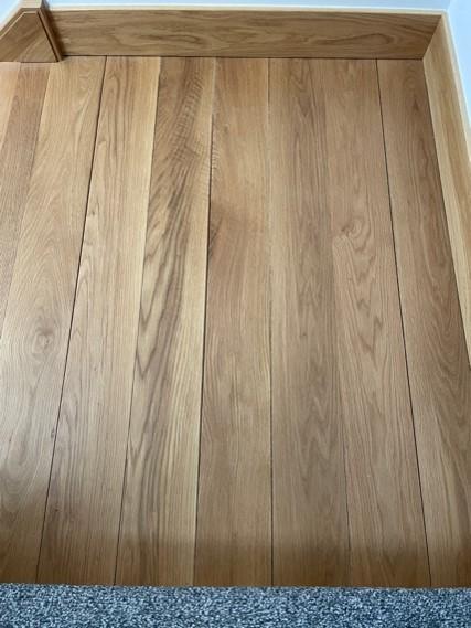

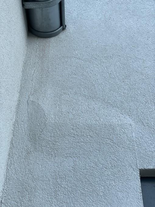

  3. Thanks for the replies guys, especially the very detailed one from Gus It is a main contractor builder I engaged, to build my own, architect designed house. The only paperwork between us was a signed quote I have bought a new build off a developer in the past, so know about NHBC and the householders rights there etc, but just not sure what rights I have to have issues/snags fixed in my current situation. Polished concrete crack Cracked exterior render Bulging exterior render Cracked grouting in wetroom shower floor Gaps opening up between boards on stair landing
  4. Is there any requirement for a main contractor builder to carry out snagging on a new build? House was finished last year and although is generally to a high standard, there are a couple of niggles that are annoying me and I'm getting the silent treatment from the builder. There was no contract agreement or talk of snagging prior to the build and no money retention etc. They have sent decorators in to sort a couple of minor interior cracks but have gone silent on everything else. The main issues I have are: Cracks in polished concrete floor Top landing of Oak stair separating between the boards Exterior render cracking and bulging Couple of edging half slates fell off (have since fixed myself) I'm just not sure if I'm wasting time and energy chasing the builder and should accept they won't resolve and move on, or if they have any sort of obligation to correct issues?

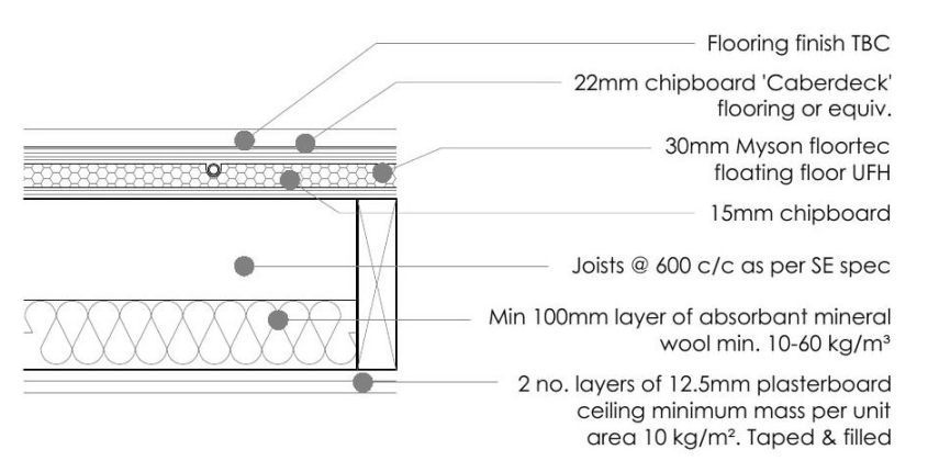

  11. I have UFH on my upper floor which is fed by an ASHP as well. The diagram below shows the make up of it however if I was building again, I would, without a doubt, plan and budget for a concrete screed upstairs because the system of spreader plates, 22mm chipboard and then flooring (carpet and tiles) means the floor never gets warm and struggles to heat one of the bedrooms. It has a fully glazed wall and the heat loss in that room through the glazing means the UFH cannot heat the room to a comfortable temp when the outside temp is very low (below 0). Air tightness of the house overall is 1m3/hr/m2 so air loss isn't the issue
