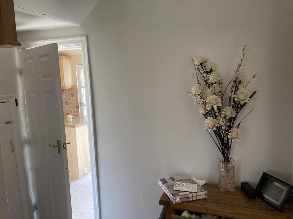

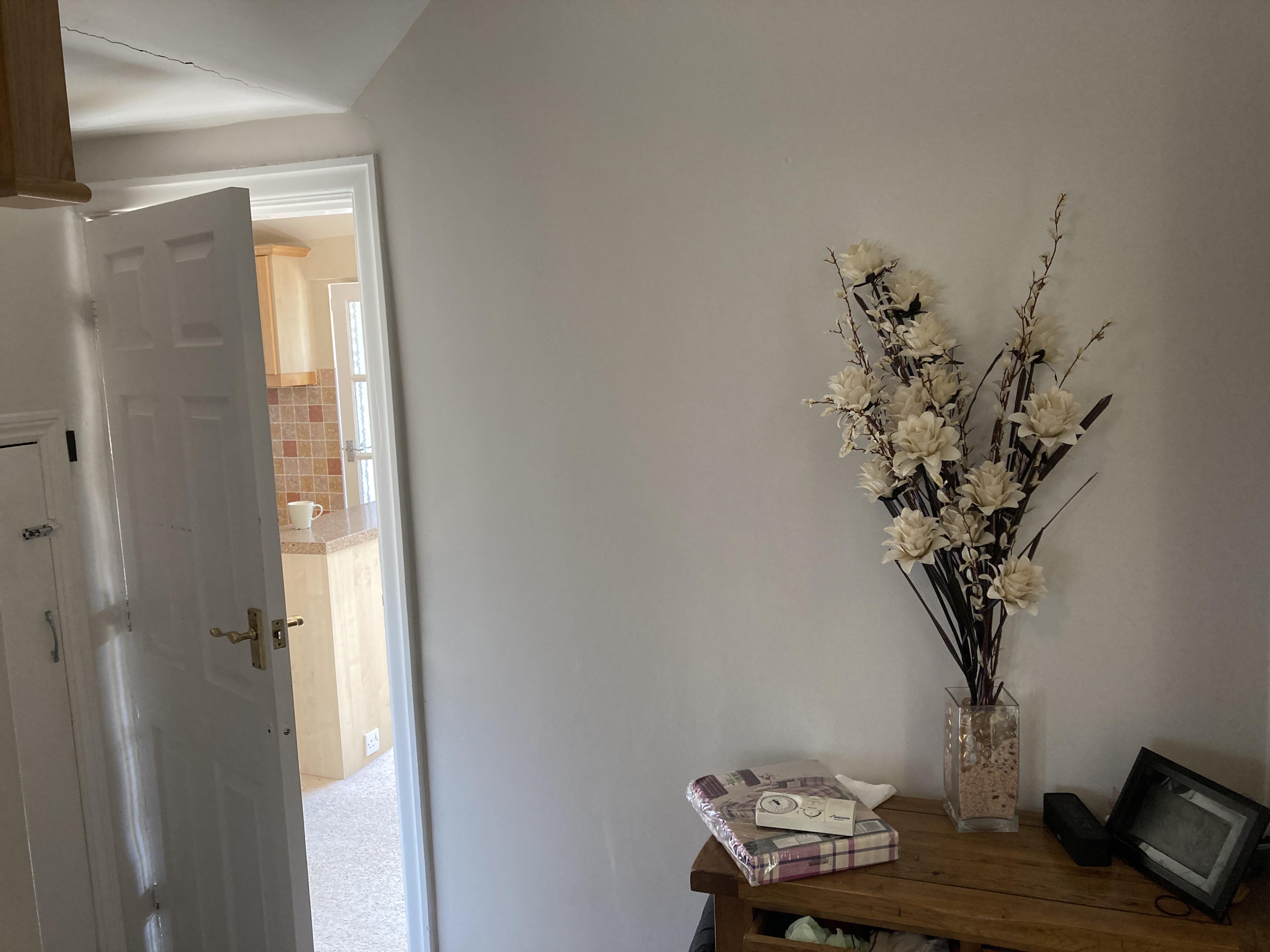

  10. Oh dear - I’ve attached a pic below. Will I need a structural engineer to do calcs on this one as I think it’s a load bearing wall and also above the stairs. if it’s too much bother then it might be just barn style rolling doors instead!!
