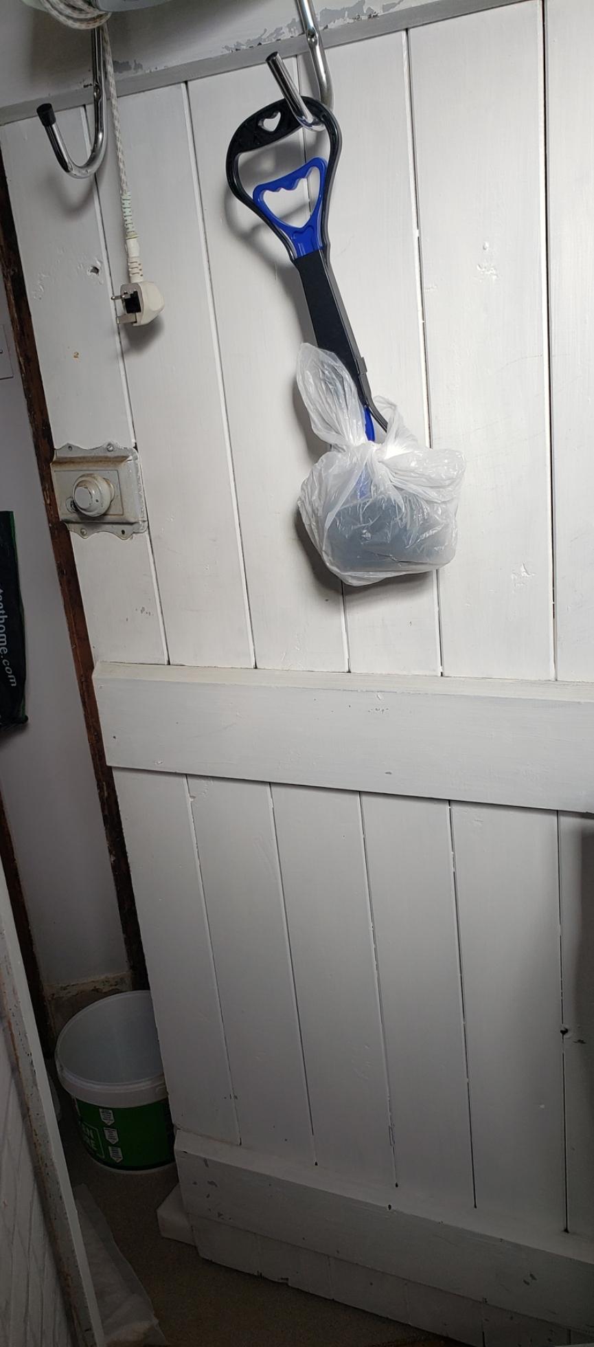

would the brace be the diagonal piece? These are the original doors, I am surprised that without the diagonal piece would 'drop' the door.
i see! thanks for your advice. I will get onto an electrician tomorrow! About the plasterer - least this one didn't dot dab my ceiling this time ha ha!
thanks @SimonD, yes! wow, i really love this forum, so many new thing I learn! a plank/ledge braced door - here is a pic of the door in question
