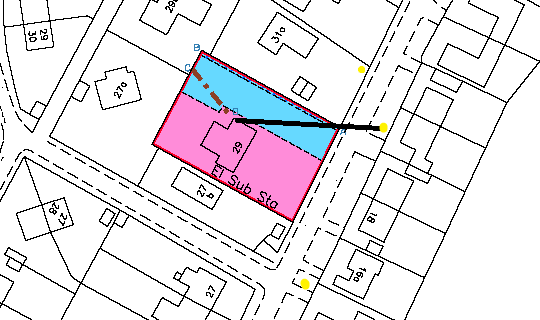

  11. Cheers @Bitpipe, that's a good shout about getting a groundworker to quote for it - then at least I'll have some sort of idea of the costs. Used my amazing skills in Paint to draw this up. The thick black line is the current overhead phone line. The three yellow dots are the positions of existing poles that I can see on street view. My thoughts were that they could switch to using the other pole - however, that looks like it'd cross the garden of 27b which would presumably require a wayleave...
  12. The neighbour is not the owner of the plot. The current owner of the plot is the previous owner of the neighbour's house, if that makes sense? She split the land from the house before selling, sold the house but has not sold the plot (it's been on the market for 2+ years at this point). I only mean that I'm not actually sure how to get in touch with them at the moment, since there is no way to contact them by phone currently and I'm getting no response to emails! I'd estimate the current span is around 30m. They would almost certainly have to close the road for the erection of a new pole - it's narrow, and all of the existing poles are on the other side in the grass verges there. Going underground may be the more practical solution, yeah.

  15. That's an excellent idea, actually! I did see some previous posts in my search here where people "accidentally" damaged the line to get them to sort it quickly, but I feel that might not be taken so well by the nice neighbours... So, the plot is a garden plot that's been sectioned off from the neighbour's house. That means that when it was installed, presumably they didn't see any issues with it as it was over their own garden. The house was then sold. Would that still require a wayleave, since when the line was installed it was all one property? The kit house company we're using have said it's definitely at a height that will interfere with the movement of their telehandler and the scaffolding. I wonder if it can be temporarily relocated, hmm. That's something to double check with OpenReach if I can ever get back in touch with them!
  16. I dread to ask what the cost of this might be. It's a single line that crosses our potential plot diagonally at a height of around 4m, and it'll need to be moved in order to proceed with our build. All I'm looking for is a rough idea of the cost. Contacted OpenReach, who proceeded to phone me at 8am on a Sunday morning (which obviously I missed, being a millenial who never has my ringer on). I emailed back straight away and have heard nothing. I did try calling them back but apparently due to "the current situation" they've shut down all their call centres. Has anyone does something similar? How much did it cost? I only need a rough idea so that I don't have a heart attack down the line, really. Met the neighbour the last time we visited the plot and he seems like a friendly enough chap - I had thoughts that I could ask him to contact them directly about getting it moved (and then we would pay).
