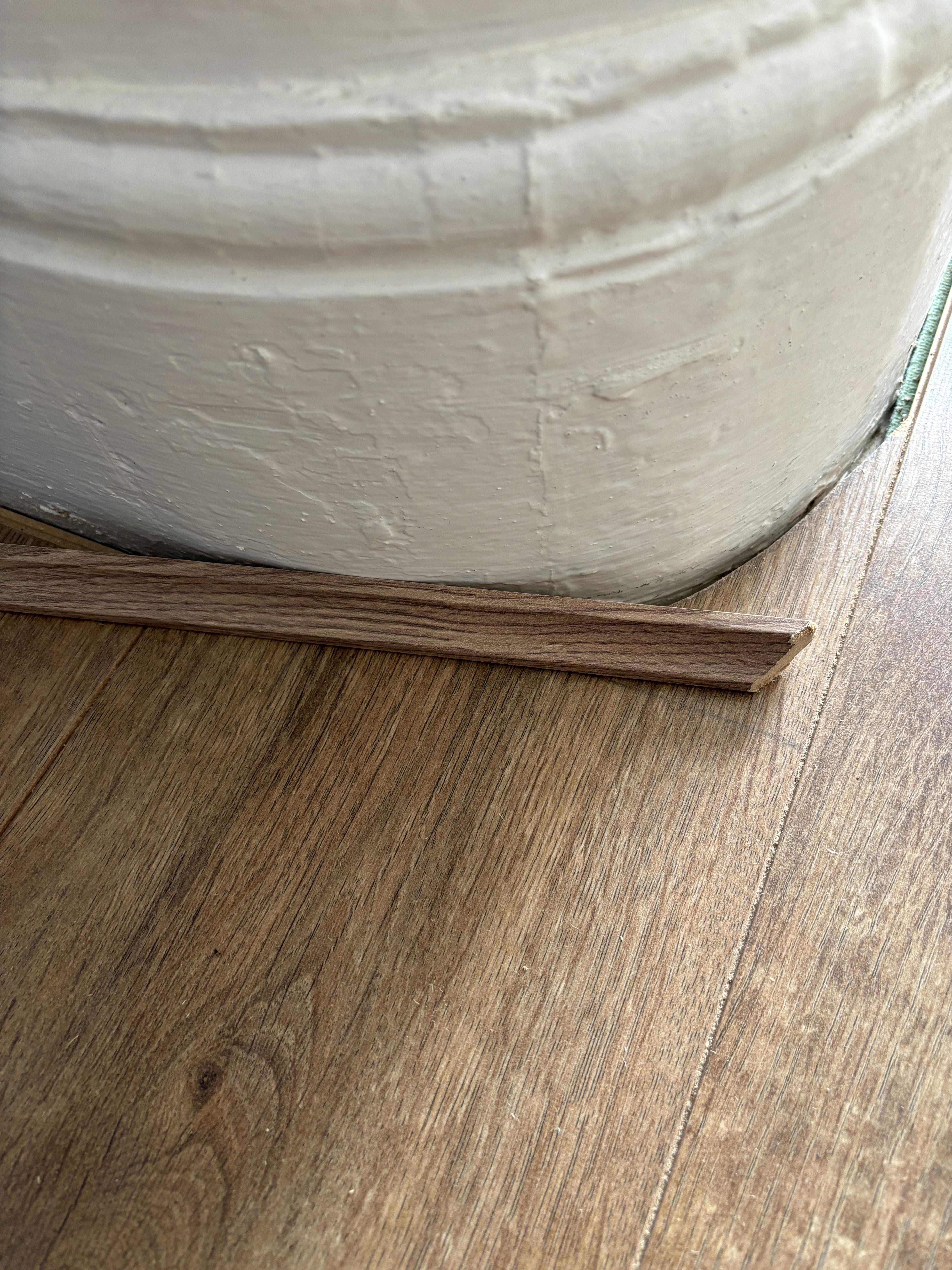

Can you cut them at angles and join them up?
Didn’t work. The bend is at the wrong angle and not flat if that makes sense
Cheers. That’s worth a try. Let you know how it goes

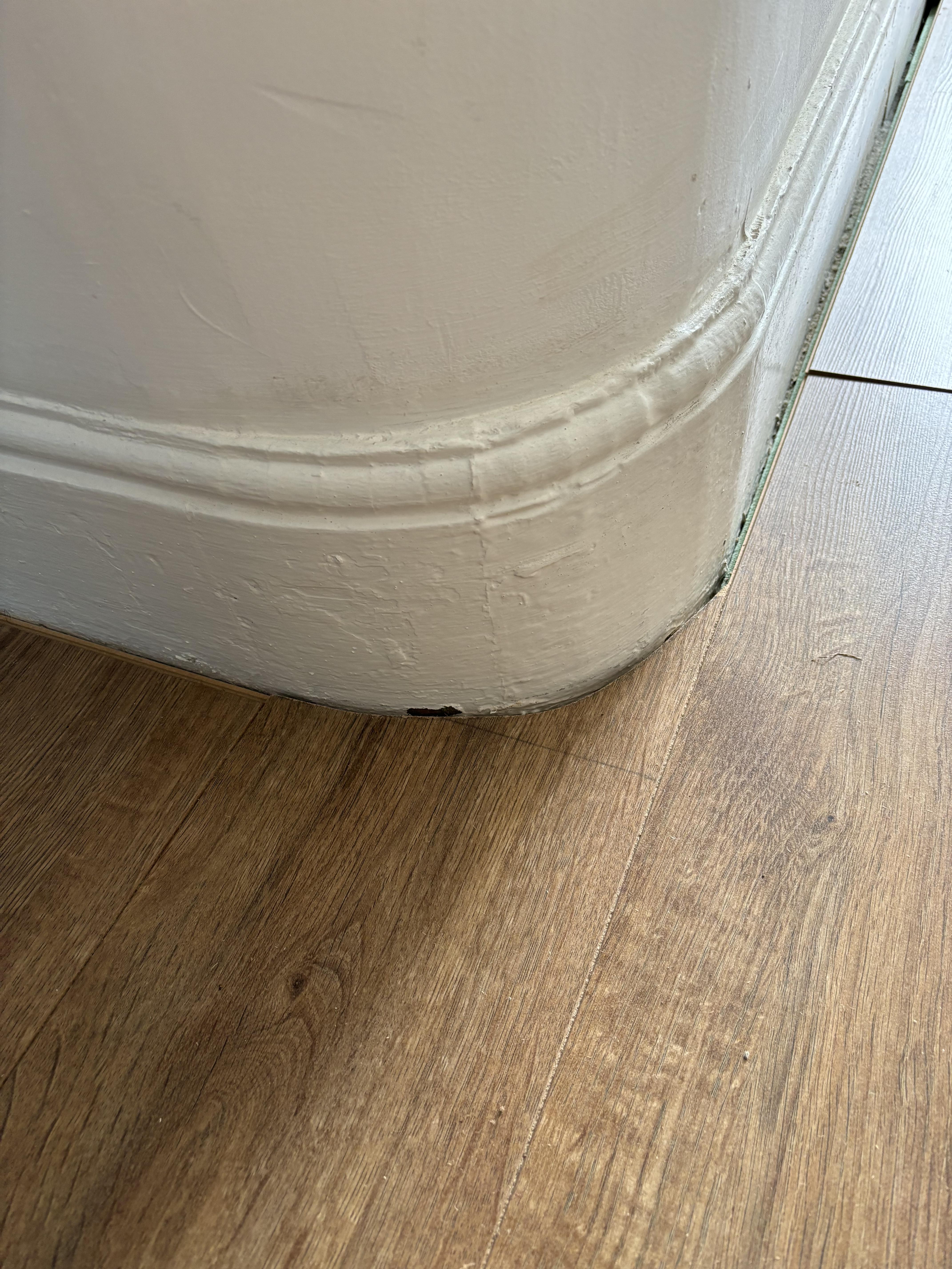

Wondering if anyone can help me. I’ve laid down lam flooring and now want to bead it but in the passage way I have a curved skirting board as the attached pic. I’ve tried adding cuts to the rear of it and it keeps breaking. Any ideas welcome.

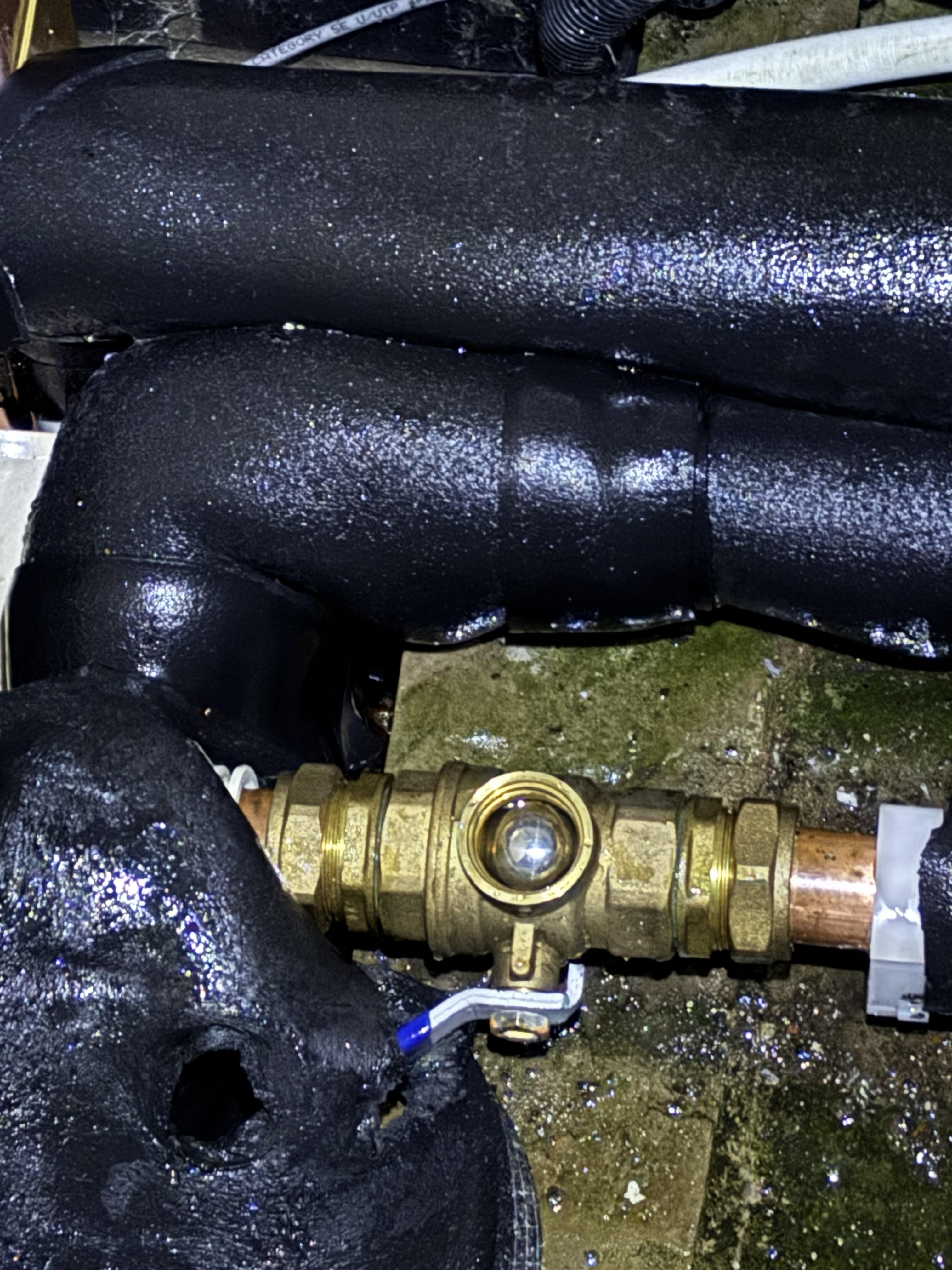

Thanks but I need instructions by using a solar fill pump. I’ve no intention of going in the roof 👍
I have bought a solar fill pump, the Rothenburger. Have the premixed glycol ready to go too. I have done one many years ago but a bit rusty. Can anyone give me an instruction to drain, flush and fill please.

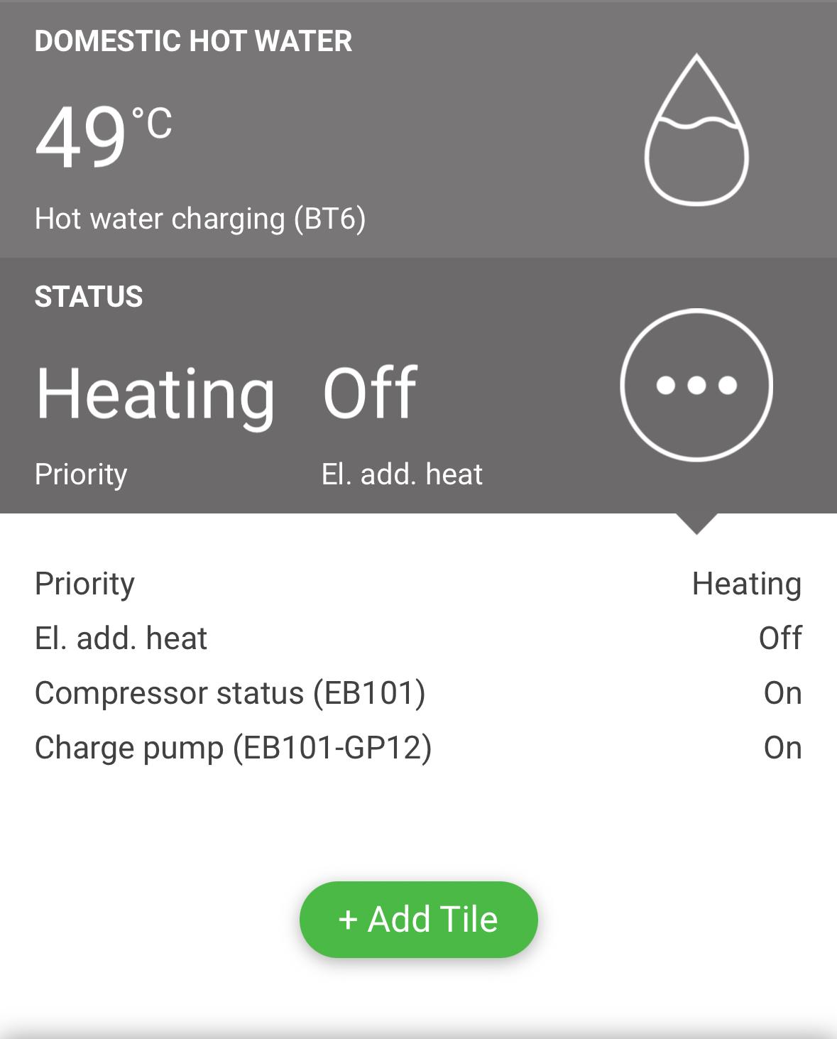

I have tried it for a few days and cant really see any difference in electricity usage with the add heat OFF
Is there a saving on bills without it? Mine seem high
Thanks, I have a seperate immersion heater for the tank too. So I could switch it off then?
Yes I thought something similar, the BLOCKED bit is worrying me though, although when it appears there are no error messages being sent through.
As per picture from the NIBE app, does anyone know what the meaning of El. add. heat is? Sometimes it is OFF, sometimes ACTIVE and them sometimes says BLOCKED? Cant find anything in the manual to explain this.

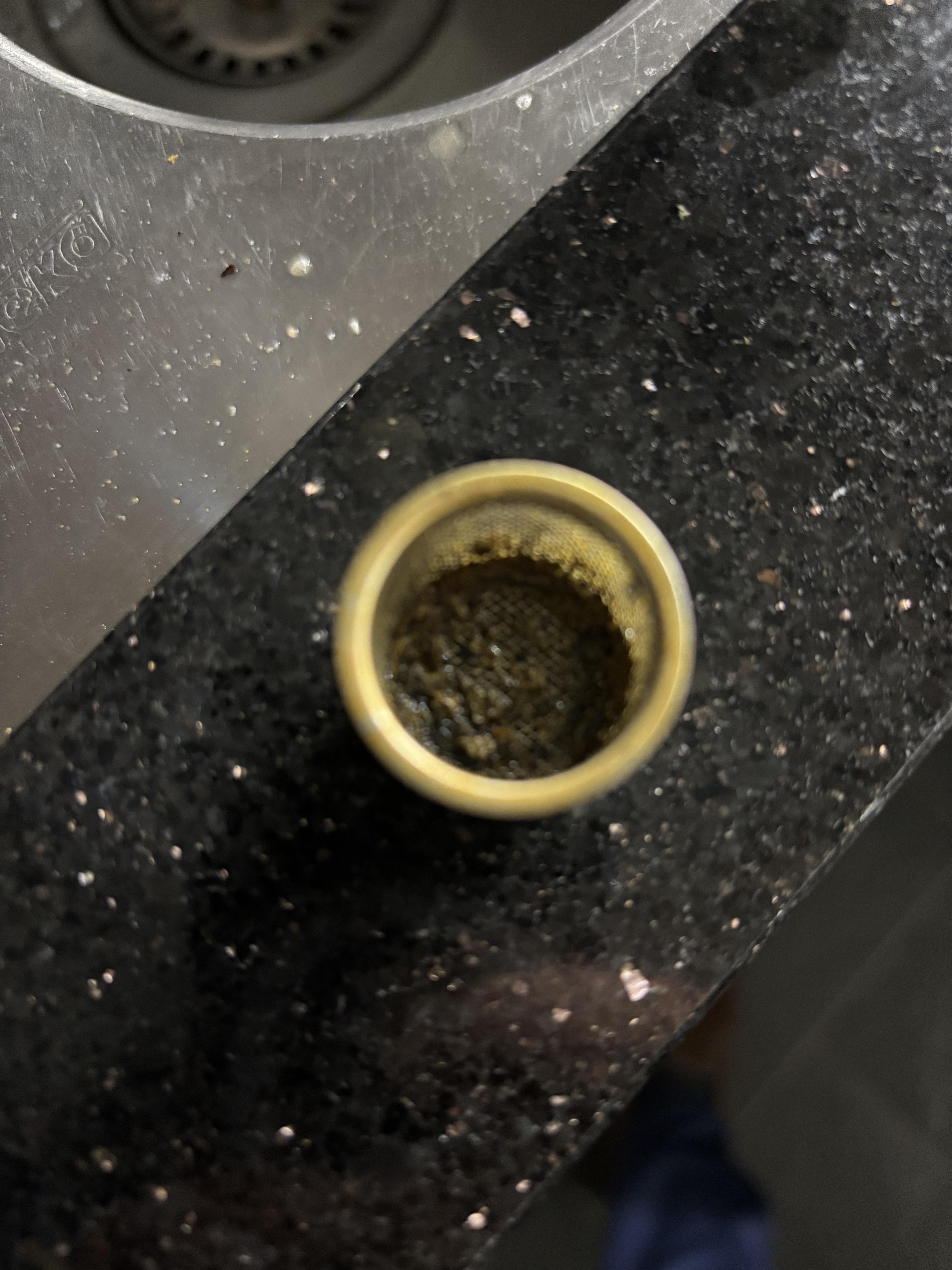

NIBE S2125 Particle Filter cleaning

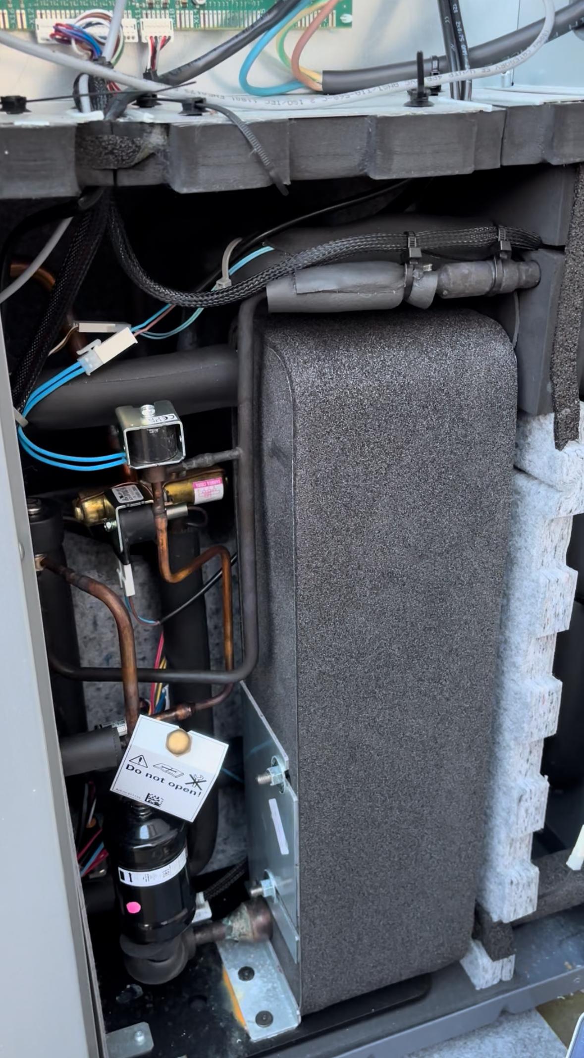

Well it’s worked all night with no issues. Thanks guys for the help. -

It’s just that the manual uses the term particle filter and mentions it in the diagram too. I wouldn’t have thought that NIBE care about any circuits after that? -

Must be something that can be cleaned easy as it mentions cleaning it every 3 months. -

I'm having an error on my heatpump which indicates that the particle filter needs cleaning. I cant for the life of me find out where it is, does anyone have some ideas please.
