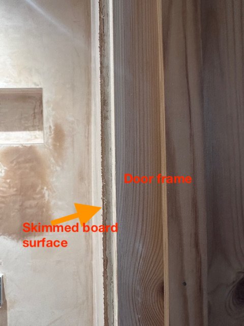

The plaster is fresh, super smooth and typically i) not a perfect beed difference in depth ii) on some doors is narrows to one end. Felt like attaching the beed (clamps initially) and then planing or using a router to register against the plaster was a solution but ... I suspect there is a perfect tool/bit out there if only I could find the name for it. I could also clamp the beed, scribe a line, take it off and then plane it down to that depth. Little tricky if it narrows. -
Apologies for what is likely an idiotic question! We have door frames that are currently stepped back from the plastered finish. I need to put some beed on to then level up to the plastered finish level (so that I can then fit the architrave). Now, the beed will actually be proud of the plaster finish and I need to take it back so that it is flush. If it were some wood corners on a piece of furniture or such then I would use a router and a following bit with a bearing to to rout out material to the same level. I'm wondering if I should use the same technique (not sure if there is space for my router) to have the bearing on the plaster level and the cutting blades on the wood beeding. Or, can you get a wood plane that will also level to another adjacent surface. Tool suggestions. Or just throw me under the bus and point out the bleeding obvious 🙂 Don't mind. cheers, -Dean

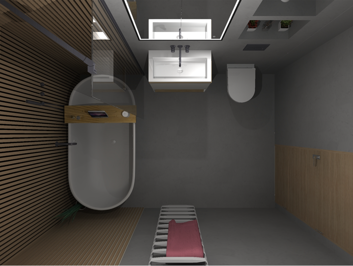

Lots of negative opinions about wet rooms I see. Not after a wet room specifically, just don't have room for separate bath and shower and also don't like shower curtains or shower screens that connect to the bath. I'm caught between a rock and a hard place of my own choosing. Here is a render of the potential design, you can't see the glass screen that clearly but it is between bath and basin, floor to ceiling and maybe 1/3rd of the width of the bath -

That is the technical challenge @Russell griffiths: - have a slope under the bath towards linear drain (wet room area, tanked etc) - have a bath sitting within it that itself is levelled and it has its own drainage connection Grout - nah, microcement/continuous surface. -
We have a small bathroom (3m by 2m) and want a bath and shower. We have a lovely contemporary curved bath in mind and dislike shower curtains or glass (to bath) screens and a screen wouldn't work with a curved bath anyway. There are loads of designs out there for bath and a shower sitting in a wet area where the shower and its drain are next to the bath. However, why not use the bath as the shower train and have any overspill of water land outside the bath but onto the wet area below the bath and then have a potential glass divide to help stop water splash into the basin. This makes the most of the space *but* it required the wet area that is all under the bath (and some margin either side) to have its drainage angle and then the bath (not on feet for this particular model) to have some form of 'anti-angle' platform to sit on to keep it flat and for its own drainage to run through that into the centre of the bath. Am I mad! I've spoken to a couple of installers and they scratch their head a little. I've thought through how it could be built from first principles (ultimately just angles and waterproofing materials in the right place) but wondering if there are products, experience, pictures, designs out there? cheers, - Dean

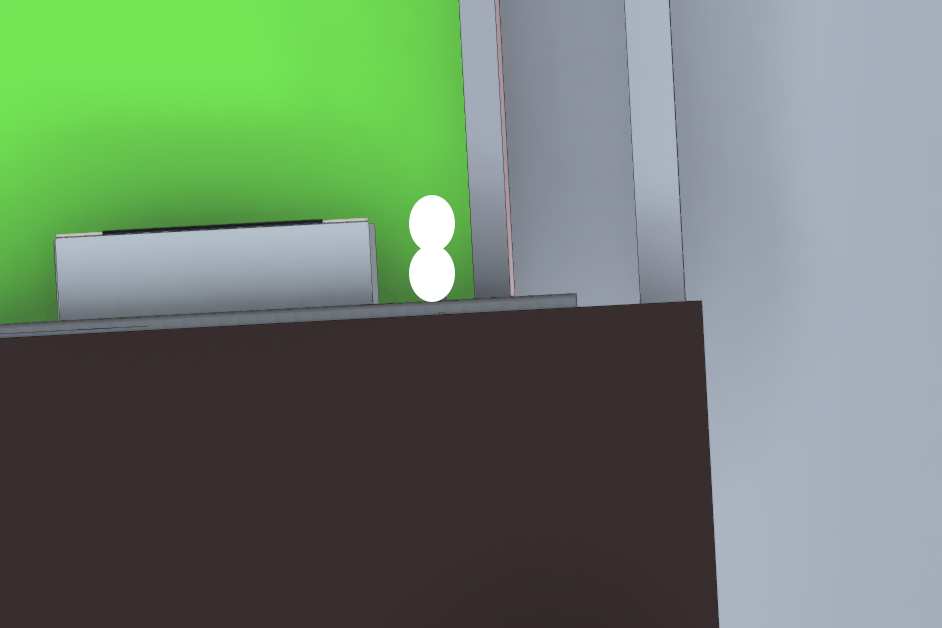

BC have signed off. We have 5 air vents on either side of large extension but due to the walls being SIPs then periscope vents could not be used (no cavity for them to rise in). We used straight through vents (in agreement with architect and building control). 10 vents have 150mm clearance but 2 of them - due to proximity to neighbours foundation and wall (600mm away) are at ground level. I might be able to dig down a little but not sure I can get 150mm clearance that warranty people seem to required (BC 75mm I believe). So, I am considering installing a periscope outside and building some brickwork or forming concrete around it for mechanical stability. Periscope would need a waterproof connection to the air-vent that is there - probably just a good sealant. Any thoughts? Structural Warranty surveyor is driving me mad - but that is another story which may go public if I can't resolve in a constructive fashion. Appreciate any constructive ideas from folks here. Really thought I had put this issue to bed but ....

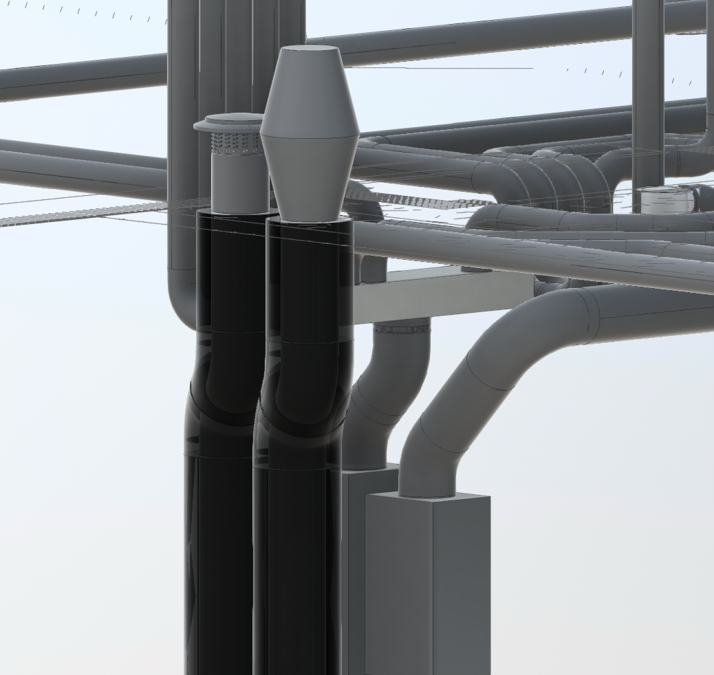

Yep, that's what I'm doing this morning @Nickfromwales Hopefully they will be ok with me going straight out and terminating on that wall but they may want me to the go up the outside of the wall to above the roof top (3m higher) but that would still be better than going through the flat roof and worrying about compromising that seal. Thanks all. cheers, -Dean
Thanks for asking @Iceverge Original design from MVHR team had the supply / exhaust coming out into a very tight alleyway (600mm wide) between neighbour and I. As the design progressed they switched to through the roof which I didn't like but they said they didn't have enough clearance in the alleyway. I wonder if better to punch through the side external wall and if the calcs show not enough air available then come up to the same height (above the flat roof parapet) to where they would have been if through flat roof (slight to the right). I would rather go through side wall than roof. That said, the side wall now has its silicon rendered cement board on batten on SIPs but still easier than going up through flat and having collar fitted and any issues that is likely to cause. We haven't skimmed internally yet so easy to unscrewed the plasterboard, cut a hole and then airtight seal it before putting plasterboard back. I have nightmares about the flat roof as it is - the thought of cutting holes in it scares me!
Hi All, I'll be asking the MVHR supplier for suggestions but the wealth of knowledge here is so great thought I would reach out. I have supply and exhaust vents to put up through flat through here. Flat roof installer says he will then fit a collar around them to provide waterproof seal. However, the roof is flat & level and at the moment (winter) has constant few mm of water sitting on it (due for sedum installation soon) and I'm wondering how to hold that water back and counter any small rainfall whilst trying to install the vents and before the flat roofer gets to seal with correct collar. Almost like some sandbags to create a temporary (and maybe 95%) waterproof wall. Any thoughts? Also, any additional thoughts on other damp/water protection I should take? I was wondering if I should use DPM anywhere but I'm basically coming down to "the flat roof membrane is either waterproof or not" and anything else I add is just complication and actually too many layers create opportunities for installation issues (bubbles, rucks, tears etc). I wish the MVHR had gone out the side wall but space is too limited the designer tells me. cheers, - Dean
