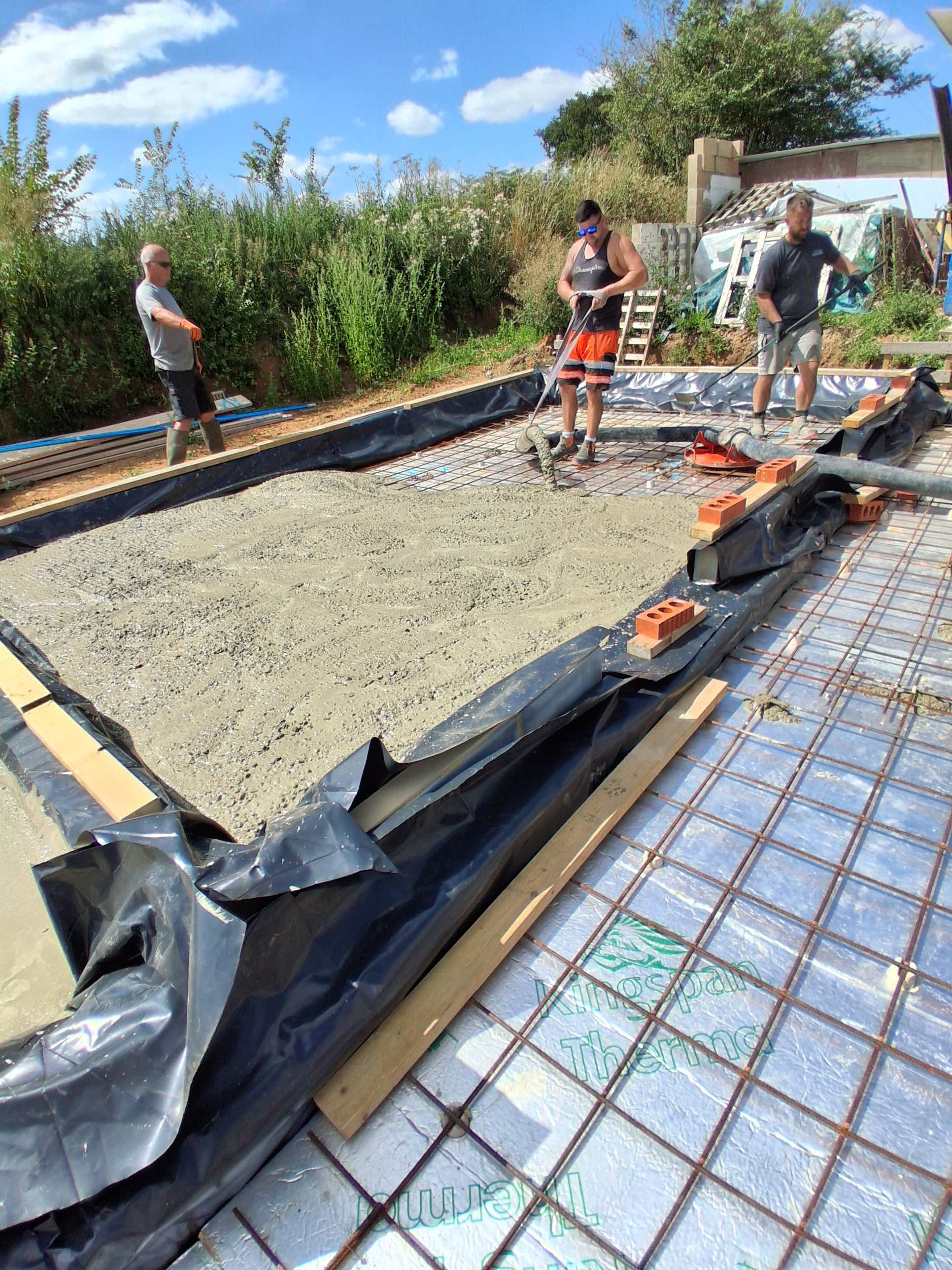

Time moves on and so does the build, albeit much slower than most of the builds featured in blogs. Over the past 4 months we have dug out, cleared and prepared our 2nd phase ready for the groundworks, as in all the stuff that goes in the ground, costs lots of money and is never to seen again. The next wall to be replaced and the old roof to be removed. This is one of the original walls, but it only had 200mm foundation so was not saveable. Cleared Trenched, this is where we had to get the SE to visit, he said we had clay and needed 2.4m trench originally. The BCO visited and said 'you're having a giraffe'. A site visit was arranged between the two of them and 1m was agreed. Of course this cost of circa £500 for a bit of paper from the SE to change the original drawings. Concrete pumping, these guys were brilliant and come greatly recommended. I think G&J had the same peeps. Certainly beats the previous trenches which we raked despite the extra cost Then we needed to dig down for the insulation and floor pour. BCO cleared us to use our own sand for blinding. Then insulation, DPM, more insulation & mesh And the next pour, again with the pump, in 30 degree heat. 22 cbm of the stuff. and our new levelling tool, a bull nosed float, hired for £17 for a week, which gave much better results than our previous raked floor in phase 1. It will, of course, be screeded with UFH when we get to that stage, but lots of walls to be built first. And drains and windows and doors. As per one of my other posts we did have some blocks knocked over for the single wall by the pipe, but looks like that is because of light blocks and hot temperatures. We also had to keep some of the existing foundations and walls as this is a conversion so we need to sort our drainage with those. Talk again when walls are up, in about another 6 months probably 🙂

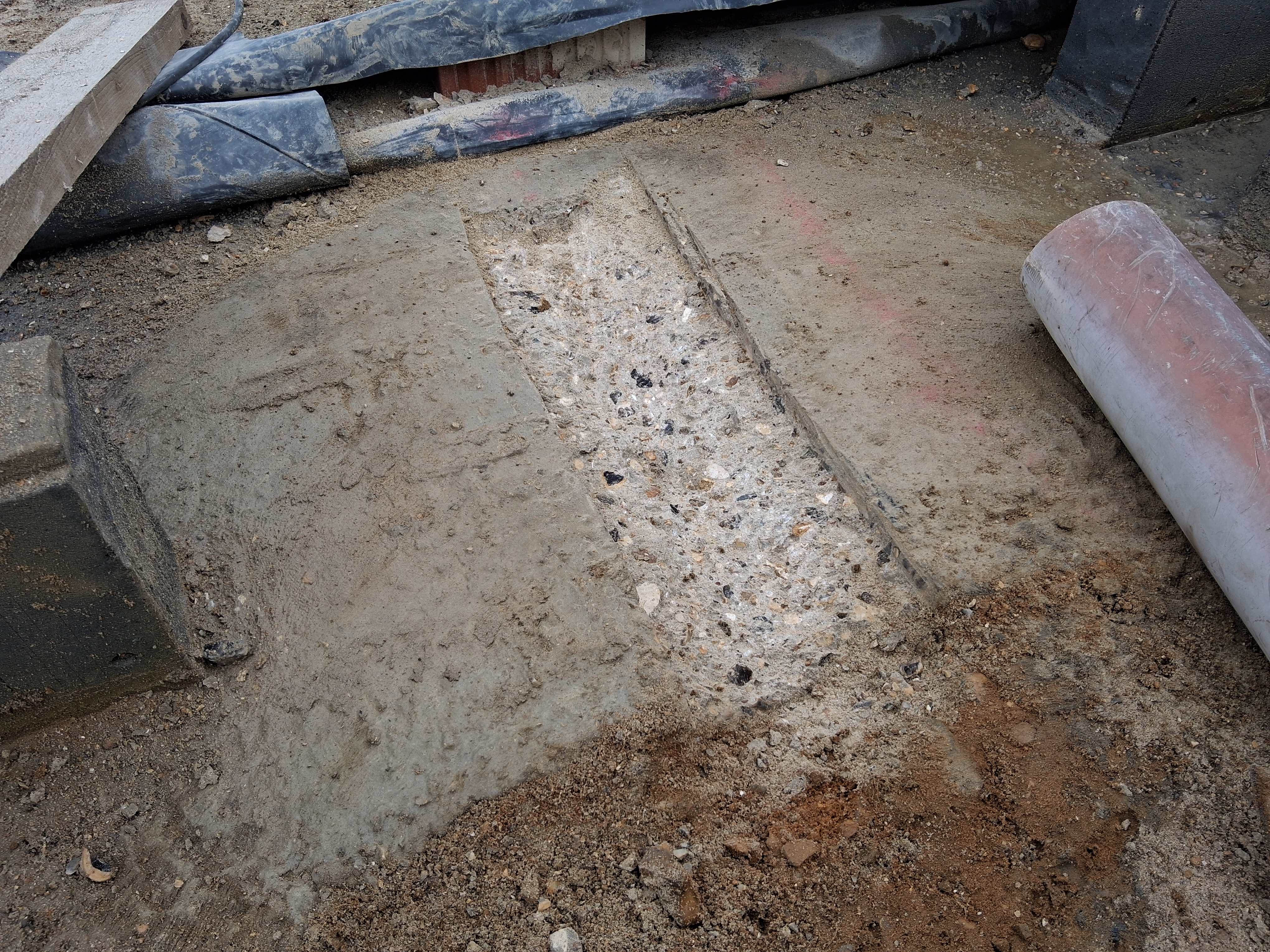

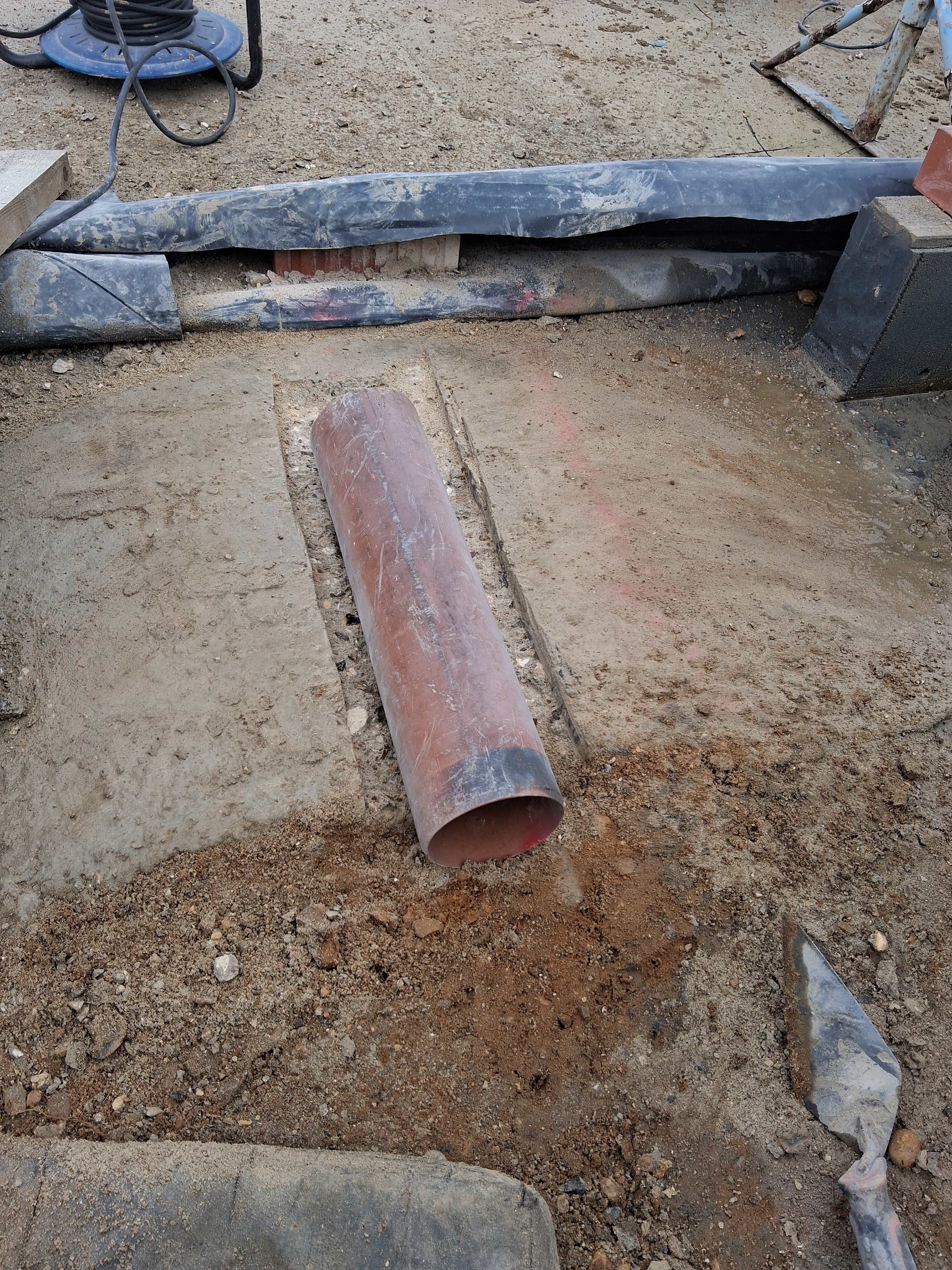

We were wondering about about floor level, but weren't sure how that would work with shower drain. This is the layout for the 2 bathrooms. It is agricultural concrete, which we have broken lots of, but that didn't matter when it cracked. We need these foundations to stay sound
thanks, I'm not sure how deep it needs to be, this may work for bathroom one at the top of the drain run, but the next one will need to be lower to allow for the drop. It's 24m in total along the back of the barn. Bath 1 at one end Bath 2 in the middle so about 12m in.
Good wet Saturday afternoon. As part of our barn conversion we have to keep some of the existing foundations and underpin. But, I would like to put a drain through the existing foundations, gen 3 concrete, in total about 750mm deep * approx. 600mm wide. This is for the drains for 2 bathrooms. How feasible is this. We've looked at diamond cutting drills, but not sure if that is the right thing. I've googled some local companies that seem to do this, but before I ask a company I want to know if this is even feasible or if we just go with the maserator approach. This is the top end of the drain so it doesn't need to be very deep. Thanks
