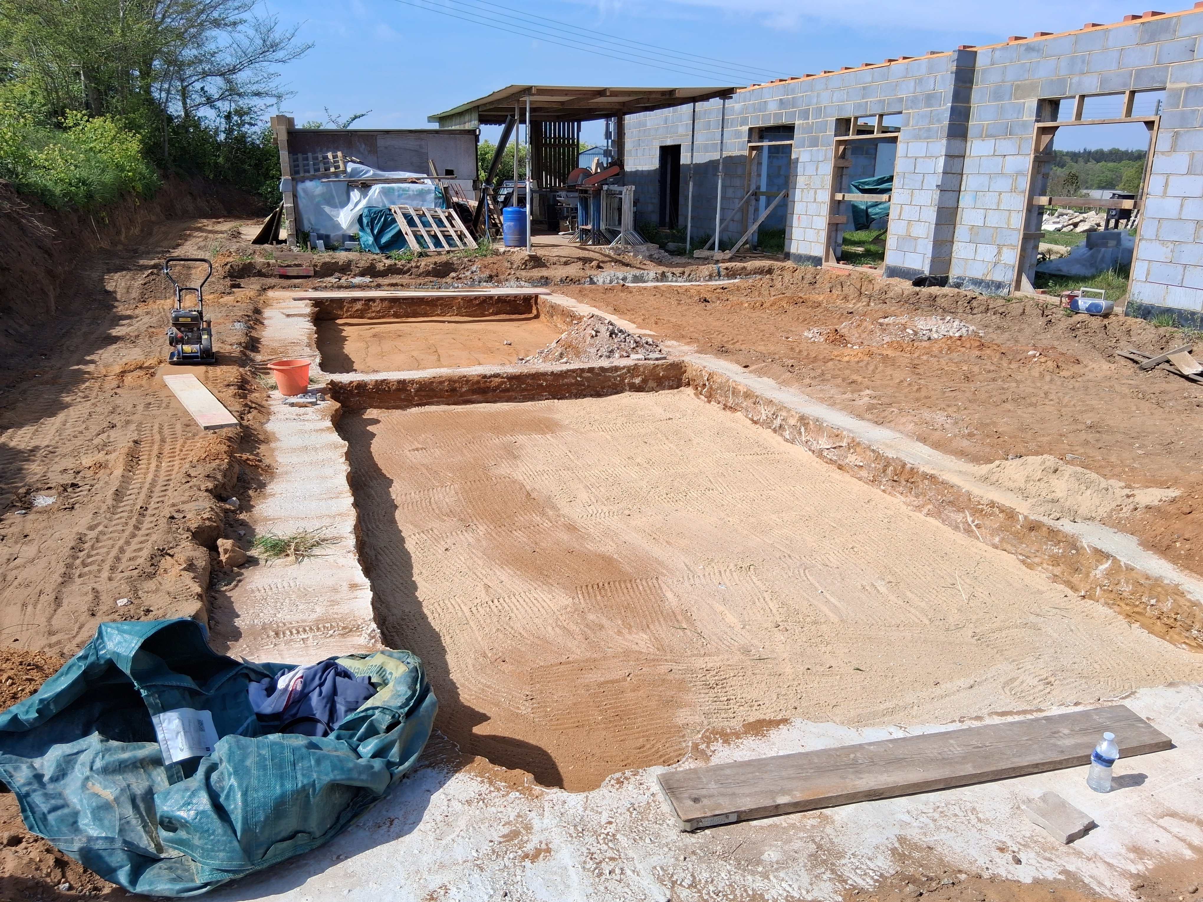

  5. We've been discussing this and like everything with building we are hitting a catch 22 situation. There are 3 parallel walls with one end wall at the moment to the East (phase 2). Phase 3 is still with the old single skin walls and concrete which all needs to be broken out and dug down to the right level which is about 1m+ Then the founds need to be poured down to 'good' soil which may be 2.5m + due to some clay. Our concern is that the 3 walls that have been done could potentially, without being braced, be unstable until the other end is done. This is not ideal but was the only option with renovating and underpinning. So, snug / hall are complete with posi roof and temp covering. The South wall (bed 3 right), East wall are done and North wall is under construction. But we then need to underpin bed 4, pantry, utility and West family wall (yes it does have the kick back from the barn) We want to brace the North to middle wall and the middle wall to South wall, the roof joists will be resting on the middle wall. the distance North to middle is 5.4m and middle to South 4.2m It is single storey. South is 11 blocks and North is 14 blocks, so difference is 3 blocks (not 2) so should be okay for roof slope and draining. Snug / Hall have their own roof which is lower than the height of the North wall. The striped walls are solid and existing, the pink ones will be stud walls and could move. The posi joists are made to measure allowing for the slope so we aren't keen on ordering the full one until we know the exact measurements. We have it specified and quoted, but don't want to say go until we are sure. Phase 3 (utility / family / pantry / bed 4) won't be built until spring / summer 2027 hence why we don't want to leave the other walls swaying in the wind until then. This phase 3 still has the existing roof which we use to protect saws, excavator, dumper etc so ideally we have the temp roof on master / office to protect from the rain. This is our catch 22 , without finishing we can't measure accurately, so we might have to pay for sacrificial joists just to brace the 3 walls, but that is expensive. Our site is windy and we did lose part of the North wall when it was 5 blocks high between some of the external doors in a gale last winter so we are not just panicking for nothing. It had not got to the stage of being braced, but the door wooden frames were in situ, but not to lintel level. Maybe this explains a bit more. Our BC and architect were all for knock down and build from scratch, but after spending over 4k on planning to do this (on top of already having spent 6k+ to get conversion planning) we gave up. The reason for refusal was that it was a new build in the countryside, even though we had planning to convert the barn. I understand that now it would be easier, but that ship has sailed. So, I hope this explains our predicament a bit more. i know that if we had contract builders it wouldn't be such as issue as it would be quicker, but as DIY these walls need to stand for another winter. So, suggestions greatly received. Thanks for all your comments so far.

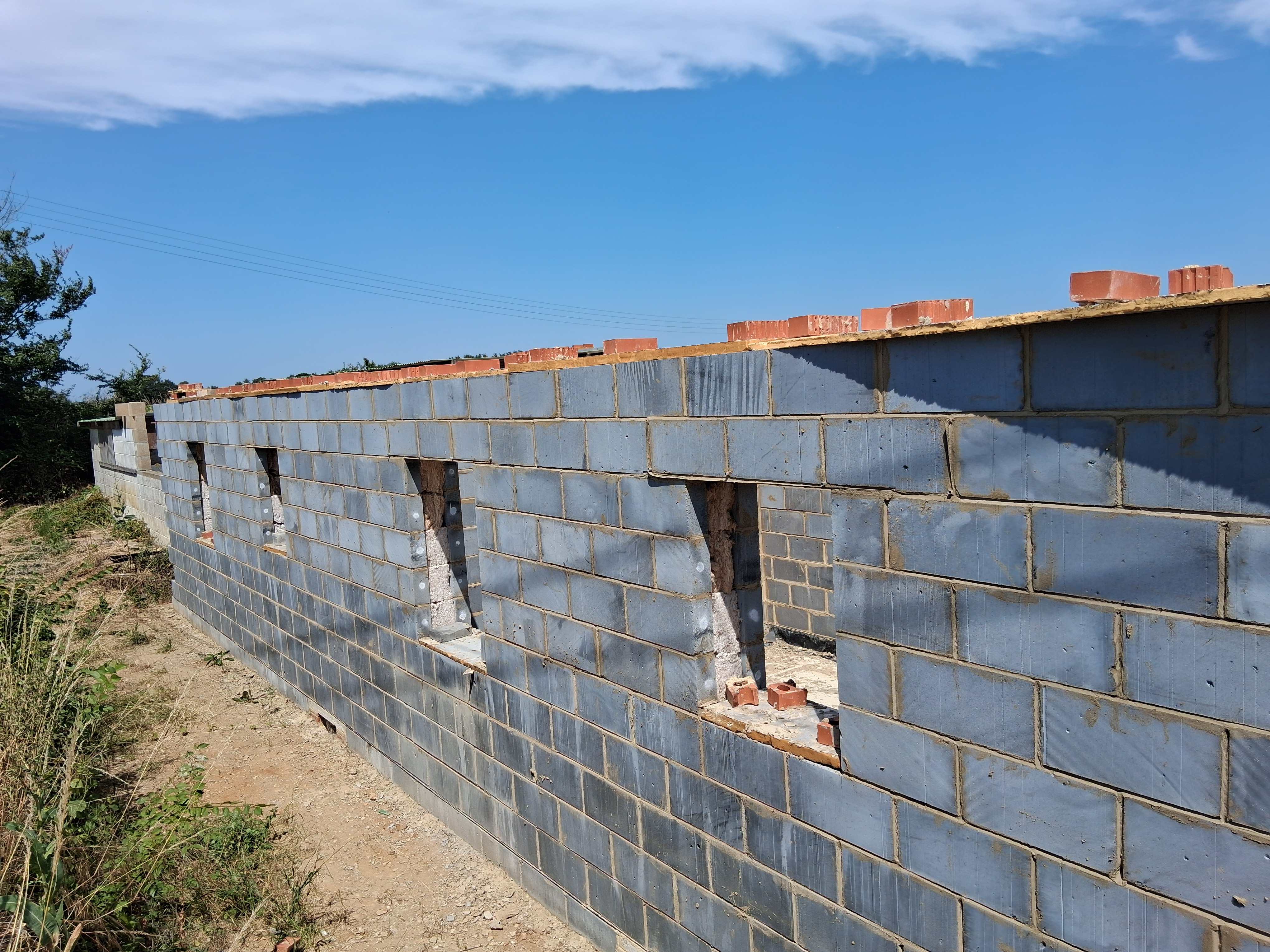

  8. I will tell hubby this, but he probably won't agree 🙂 This is what we did on the small roof, the posi joists are in place with temp sheets.

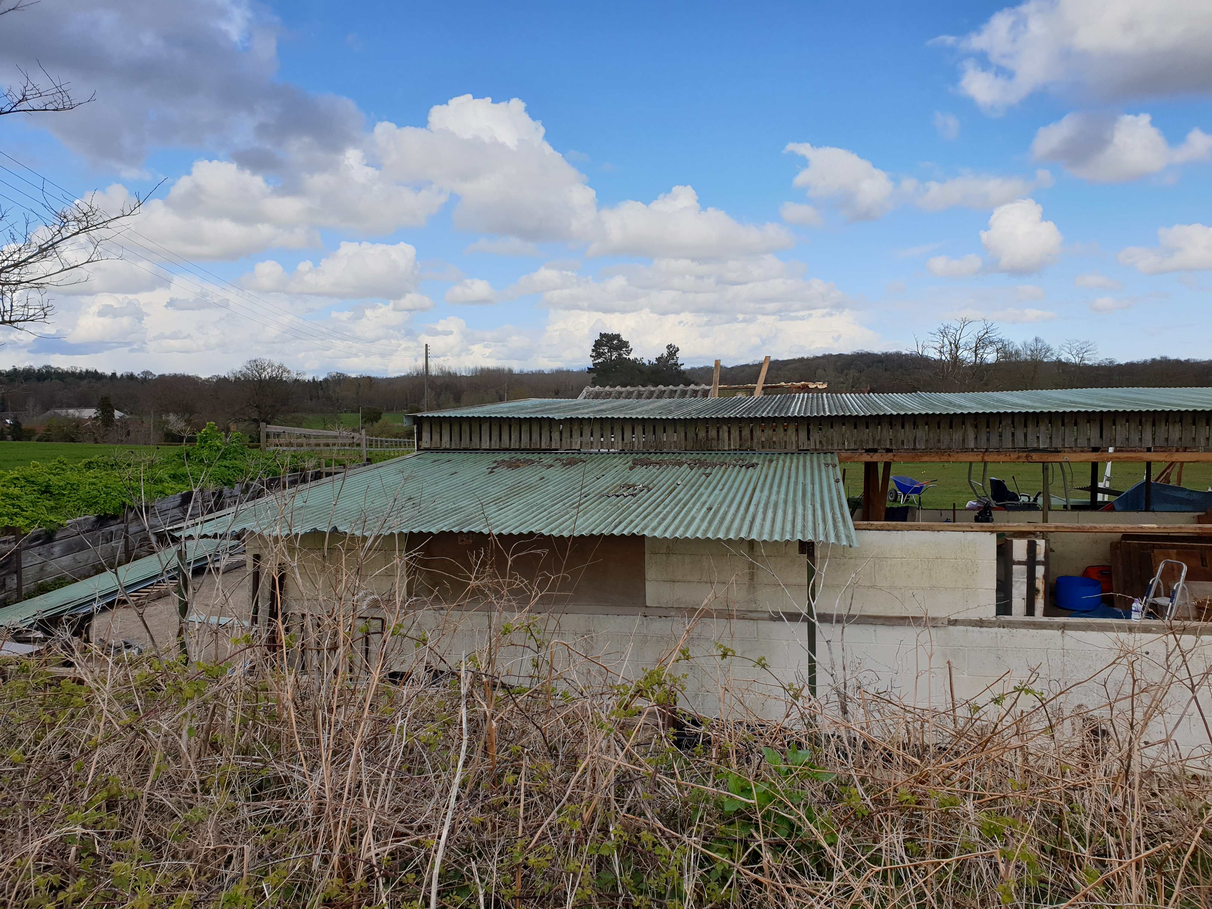

    Flat roof and solar
    Better picture of the roof being replaced. Apart from it becoming one roof our planning only allows this height so we can't raise the higher side for angle or reduce the lower side as limited head room inside.

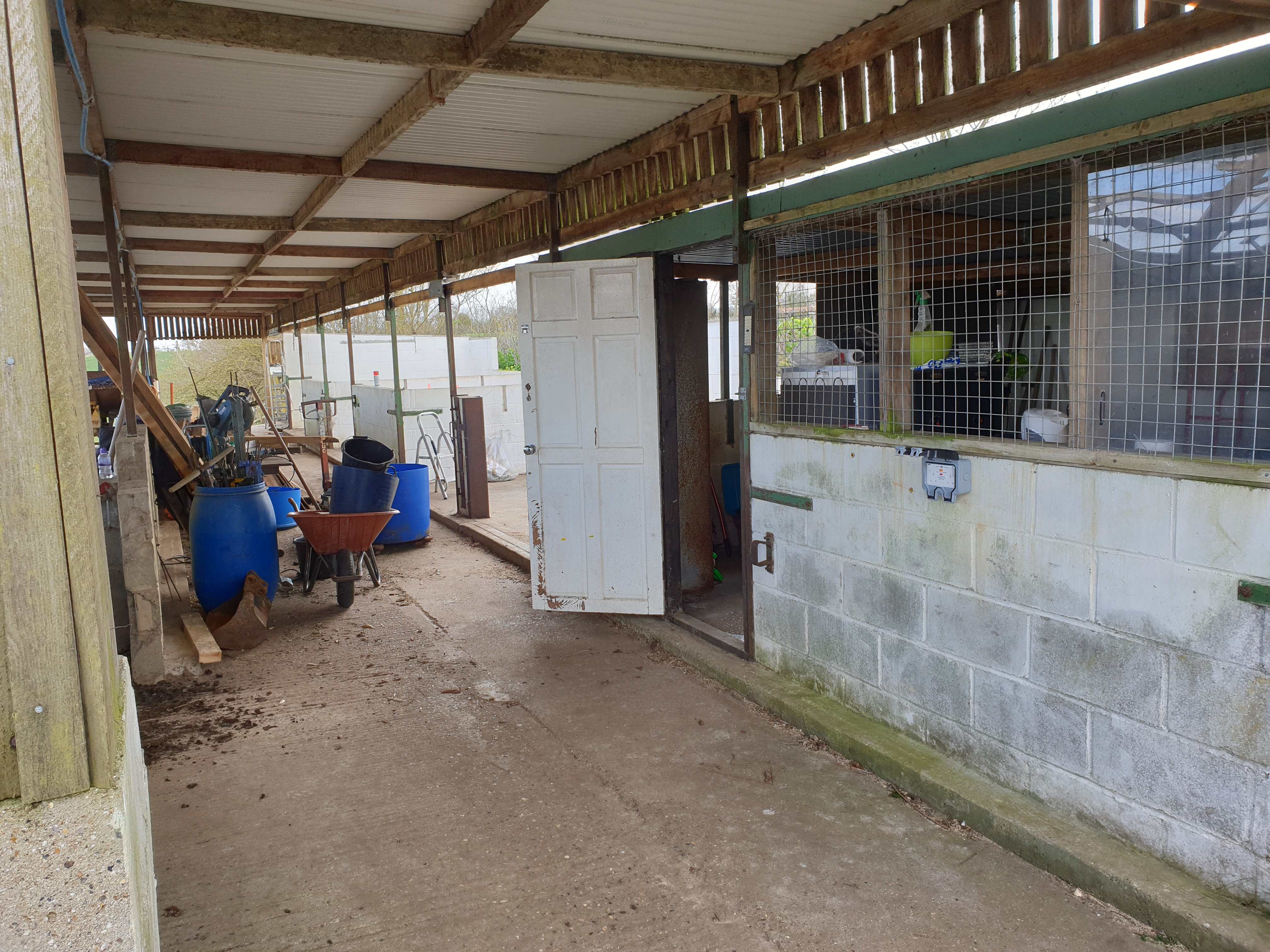

  13. WE are vey slow building, think Pocster 🙂 So, although temp for storage realistically it needs to last probably 2 year. this shows how the roof was done previously when built in the 60's. We will be using the same roofing sheets, but the wood is pretty much knackered. We just want to replicate this as cheaply as possible for dry storage, the roof material is very light as just rain cover. This is all held together with joist hangers but we were hoping to do wall plates and joists. The issue is that roof one (not there in this picture) is 4.2m including the walls and roof 2 is 5.4m. For what we need we are happy to 'join' joists to make the spans from 3.6m sections, but that means for the phase we are doing we will need 64 joists plus wall plates which potentially might not survive being left for years. Phase 3, which is the bit you can see until the blue barrel behind the wheelbarrow will not have a temp roof. Once that is finished then the whole lot will be done properly with the posi-joists.

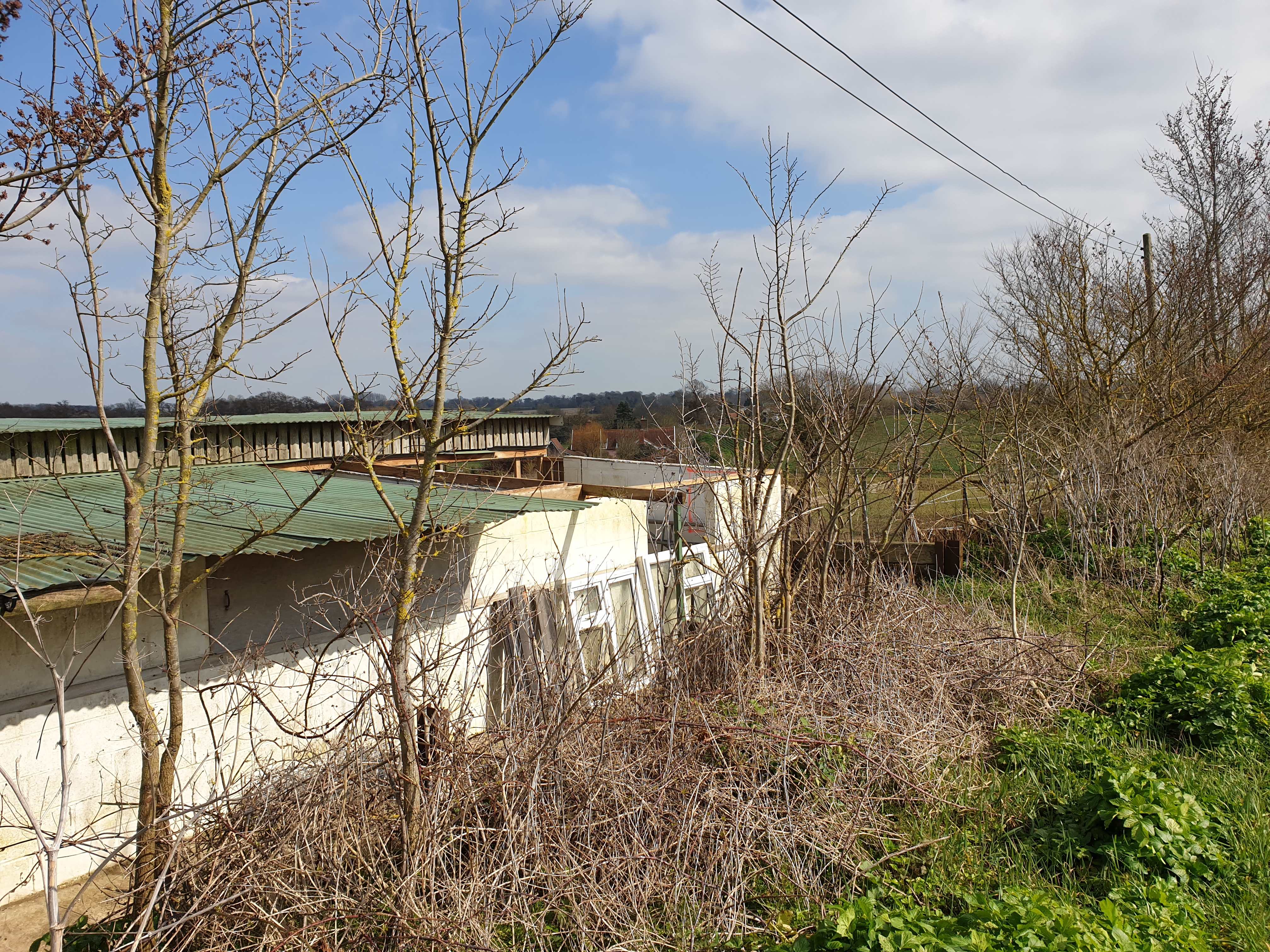

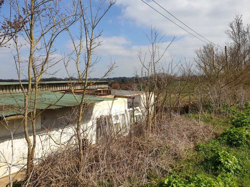

    Flat roof and solar
    This is replacing the previous barn roof which was in situ since built in the 60's. That was metal and drained fine, albeit lots of water when it rains due to the size. Very much flat. It is being replaced with one roof covering both sections seen below. In this picture we have already removed gutters and part of the lower roof. It won't be this profile of sheets. It is facing south so I was hoping to put solar on top. the dead trees are long gone so nothing to stop light. Picture taken from other end, but this is what it looks like now.

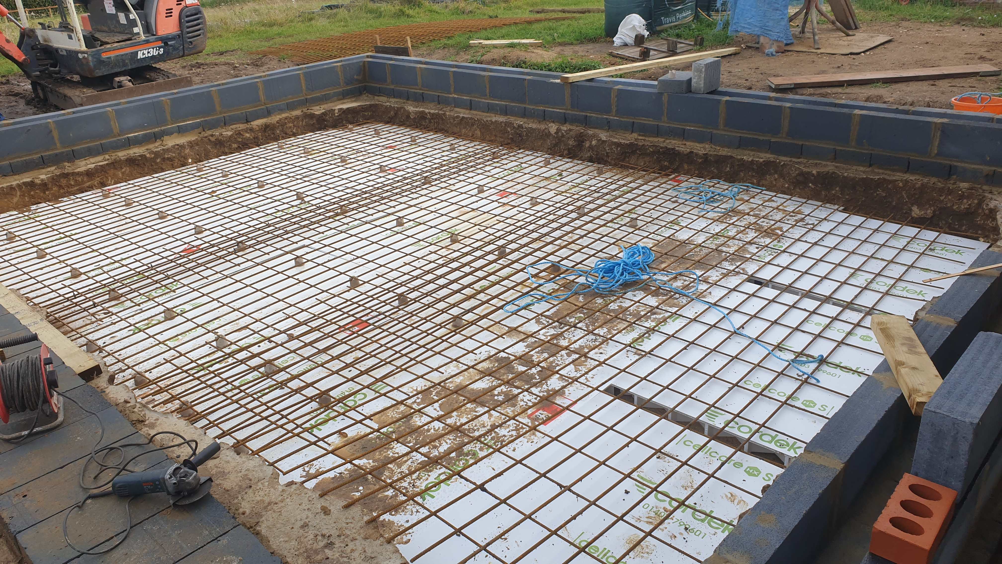

  19. What is going on top of the pour, we had 3 at some points like you, but our pour is 200 with insulation and screed on top. So, if the concrete is a bit thin at points then it will be well covered.
