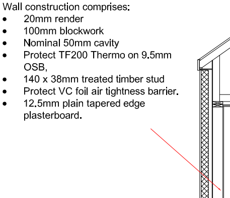

We're thinking just a simple up and over canopy door. Opening is currently 8' x 7' but will be increased to accommodate the factory fitted steel frame.

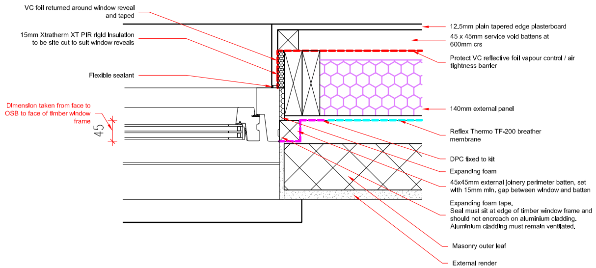

Or is it a better approach to have the frame fitted to a pinch timber/batten (rather than directly to the blockwork) the same way that the doors/windows are fitted to the main house?
We're in the process of finalising our garage designs (timber frame with blockwork external leaf) and realised that the designer has specified openings which match the door size but did not take into account the frame width. This got me thinking about how the frame would actually be fitted. The wall construction is: My thinking at the moment is that we'll fit the metal frame direcly to the blockwork before applying the render extenally and then plasterboard to cover up the cavity and timberframe behind the frame (inside the garage). Does this sound about right? Anything I need to watch out for? Thanks!

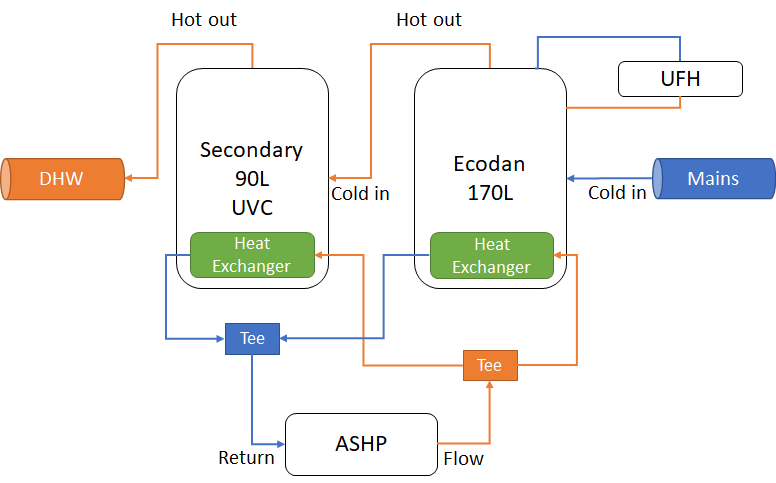

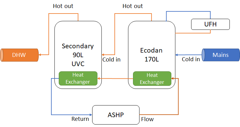

Might something like this work? No idea whether the ASHP can be connected to two UVC coils in parallel though ...

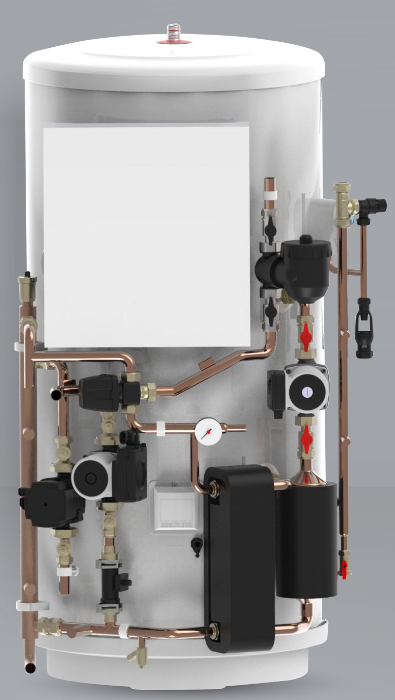

It's a dual-zone (DHW/Heating) cylinder so I imagine it is able to maintain them at different temperatures? It looks like a pretty complex piece of kit when compared to a "normal" indirect UVC: https://les.mitsubishielectric.co.uk/products/heating/domestic/cylinder/ecodan-ftc6-monobloc-pre-plumbed-standard-cylinder The white box is some kind of controller and there are separate pumps for the primary, DHW, and heating circuits.
Maybe not - yes, physically it will fit but at least the ones I've seen seem to be only for DHW? The ecodan cylinder provides both DHW and heating circuits (UFH).

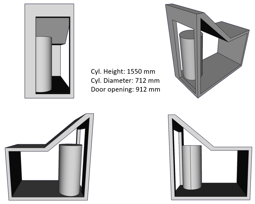

Unfortunately, no. I had been playing around with a model of the understairs cupboard which shows that it should be possible to fit in a 210L cylinder but the piping to/from still poses a challenge: The supplier mentioned that they could fit a 170L in the half-height space under the stairs so I was thinking of maybe combining that with a smaller (90L?) UVC. If it goes in series, I guess the hot water outlet from the ecodan cylinder would go into the cold water intake of the smaller cylinder with its hot water outlet servicing the actual demand? I guess the problem here is keeping the water in the second tank warm? Thanks.

Hello, We are installing an ASHP system for UFH and DHW but have a bit of a challenge fitting in a reasonably sized cylinder. The space allocated for this is under the staircase but that's obviously presenting some height challenges. Speaking to the supplier, they think a 170L cylinder will fit given the height constraints but I was wondering if it's possible to have secondary tank in parallel to increase the overall capacity of the system? I have asked the supplier the question but haven't had a response yet. A quick search on the web shows that it's definitely possible for traditional boiler systems but wondering if anyone has done this for ASHP systems? We're looking at the Mitsubishi ecodan ASHP + preplumbed cylinder systems and the cylinders look pretty complicated with quite a bit of electronics on them. So I'm wondering whether it's possible to have the ecodan cylinder as the "primary" with another 3rd party cylinder as a "secondary"? Thanks for any advice on this.
