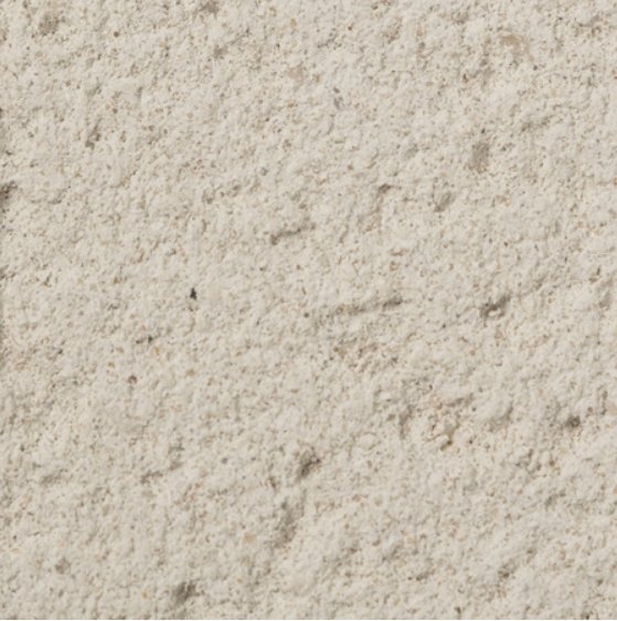

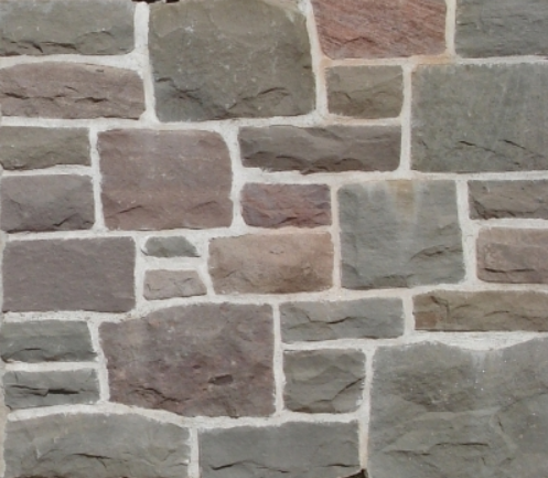

  2. Ended up going with ecorend "Portland Stone" which is actually more off-white than cream in reality -- accepted by planning office with no questions asked ? All planning conditions have now been discharged. The final palette (render and stone) is:

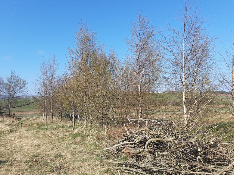

  5. We have around around 25 juvenile trees on the site that will need to be removed in order for the house to go in: They are a mostly different types of Birch with a few Goat Willows and Cherries in the mix. I estimate they were planted roughly 10 years ago and are currently around 15 feet high but the trunks are still < 6" in diameter. What's the most cost effective method of getting these removed? I'm happy to relocated them to another part of the plot or even give them away if someone wants a grown tree for their garden!

  12. Thanks, we did look at that - we've been finding that "Cream" according to Weber and K-Rend seem to be a lot more yellow/orange compared to Cream according to RAL -- at least on a screen. We'll need to order some samples to see what they actually look like in practice.

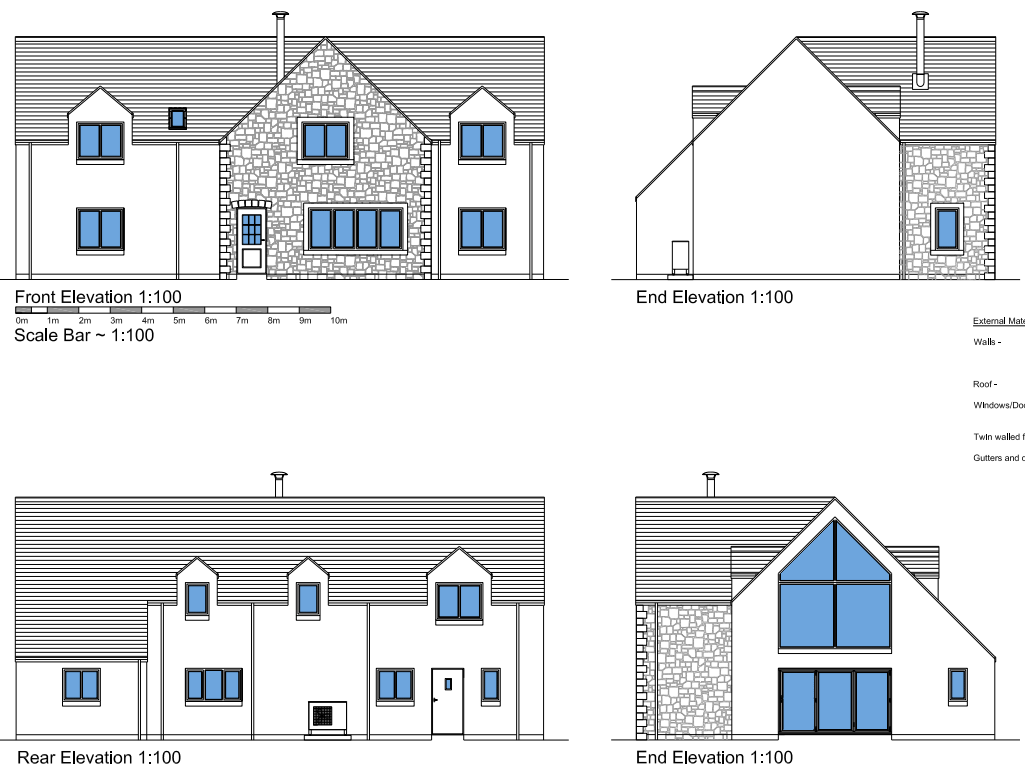

  13. Quick update - we have planning permission! The approved elevations are: Unfortunately we lost one of our favourite features - the arched covered entrance - in reducing the width of the gable but must admit that the elevation does look better proportioned this way. We still need to get actual stonework and render colour approved before building can commence so anticipate that our next battle will be over that -- particularly the definition of the colour "cream" which was demanded by the planner. We're not big fans of "cream" with a heavy proportion of yellow/orange so here's hoping we can convince him that the RAL colour chart "Cream" is acceptable: https://www.ralcolorchart.com/ral-classic/ral-9001-cream

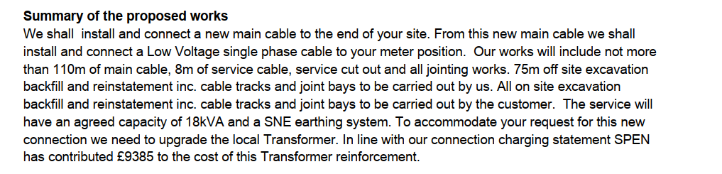

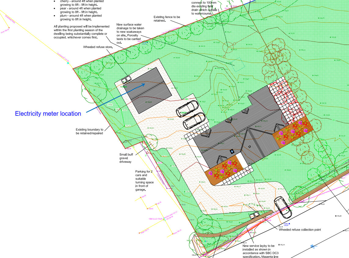

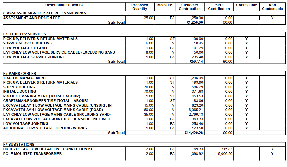

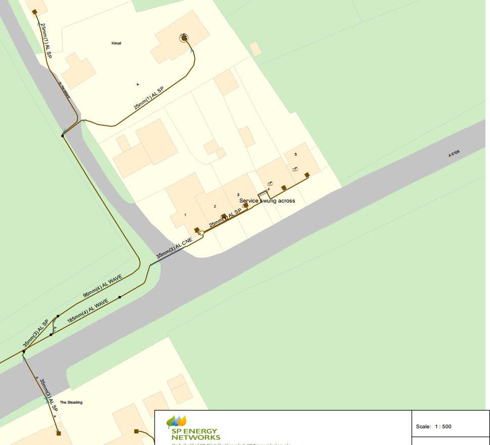

  14. Quick update after speaking to the chap at SP Energy Networks: As suspected, the local supply (transformer) is at capacity and needs to be upgraded to support the demand for the new build. He mentioned that the current capacity is 50 kVA which is shared by around 7/8 properties -- which sounds like it must already be operating close to the max capacity. Unfortunately, that means that we get the pleasure of helping them upgrade the local transformer to 100 kVA of which we will get 18 kVA. They are happy for us to do our own roadworks. This is great news as we expect that we would have need to dig up the same stretch of road to put in the water pipes. Arranging our own roadworks dropped the SPEN bill by half to £10k. This now consists of: £1250 for design ans assessment fee. It's ridiculously high but they recuperate costs for quoting/design works that do not progress to an order across those that do. £1000 for service cable connection. £650 for wayleave £5000 for laying 115 m of 185 mm (4 core) WF mains cable £2000 for transformer upgrade (18% of overall cost - 18 kVA of 100 kVA) The 185 mm mains cable will run through the property and just a few meters from the meter so that the final stretch of the connection will be made using 35 mm LV service cable. I guess we could argue for the 185 mains to end at the property boundary to save some more money but it seems like a good opportunity to just have it there for when we decide to go for an EV charging point at some point in the future. So, still massively over budget but hopefully we'll be able to come in a few £ks under the £20k originally quoted. Here's the new drawing for those interested: Now just waiting on the details from Scottish Water and hopefully things will be a lot simpler there (i.e., we can connect to the 90 mm distribution main which is pretty much at point #1 above).

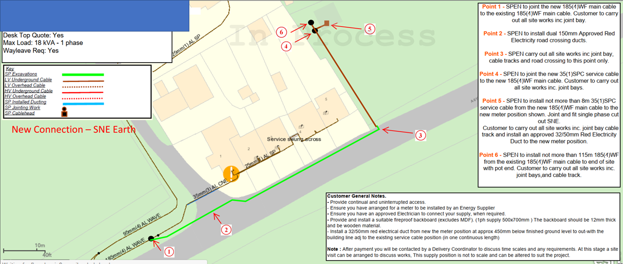

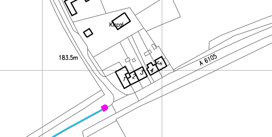

  15. Just found the drawing of the the proposed works: Is the consensus here that we just need to bite the bullet and go for it? Is it worthwhile getting in touch with multi-utility installation companies so that we avoid having to dig up the road twice? The asset drawing from SW shows a similar starting point as the electricity: Bit puzzled that it doesn't show any connections to the neighbouring houses even though they do have mains water (according to a neighbour).

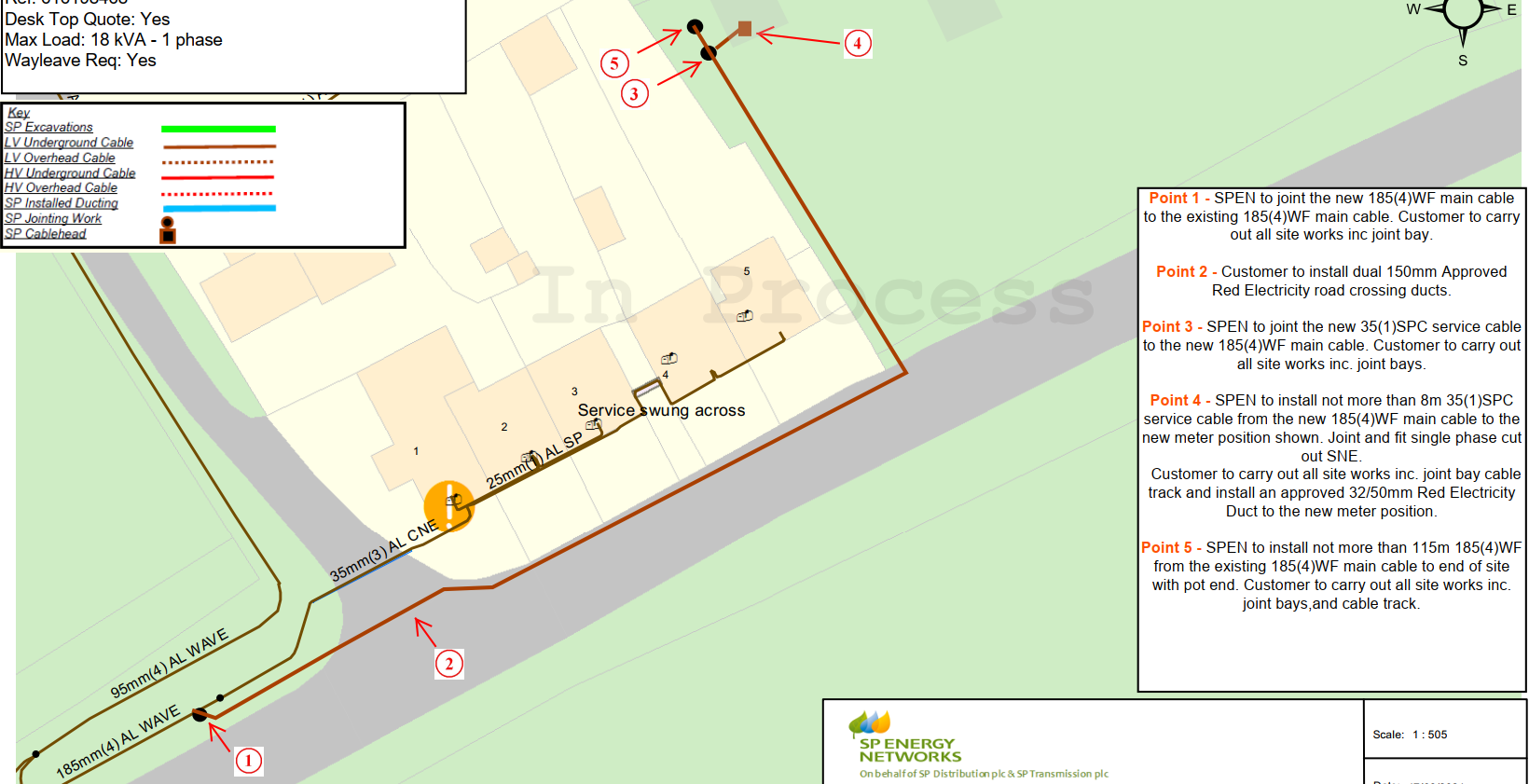

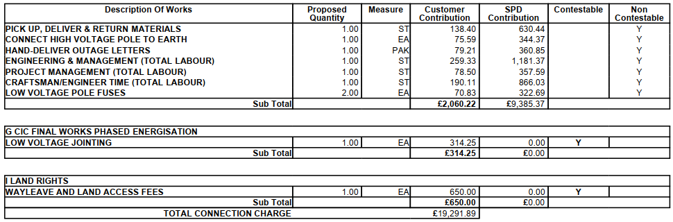

  16. Here are the bits from the quote: This doesn't include any diagrams but I received the following asset plan previously: Our site is to the North East: Thanks!
  17. Hi everyone, I'm going through the quoting process with SP Energy Networks and have been quoted £20k for electricity connection. About £15k of that is "Contestable" and the remainder is to reinforce capacity. This despite there being an existing connection next door... We also need to get water (Scottish Water) in and expecting a similar shock. Any advice on how to approach this? Would you recommend using a multi-utility connection provider? Thanks!
  18. Yup, got a brush cutting blade attachment - will give that one a go. Looks like it'll keep us busy for a few weekends!
  19. Thanks - it'll be a few months before we can start on the build. Just looking to tidy things up a bit so that we can can enjoy the site in the meantime.
  20. Hello, The site we are building on has not been maintained in a while and is rather overgrown as a result: Any advice on the best way to get this cleaned up before the build starts? We are planning to do as much as possible ourselves before the ground works start and have a petrol multi-tool and assorted gardening equipment at our disposal. Thanks!

  23. @the_r_sole - the houses shown earlier were to establish a point about the gable. There are others in the area (same postcode in fact) with the arch feature (though no protruding gable): @PeterW - thanks for the very helpful comments, gives us lots to think about!
  24. Hi, Reducing the gable to the living room section is our line of thinking for the fallback position but it would likely mean losing the arched entrance which we feel adds quite a bit of character to the build (reflects a common local feature). Will be discussing this option with the designer to see what we can come up with. As for the compass points, North is up, East is to the right. Main bit of open grounds is to the East (also the best views). Hence the big gable windows on the master bedroom and doors out from the dining room on the ground floor. Thanks.
