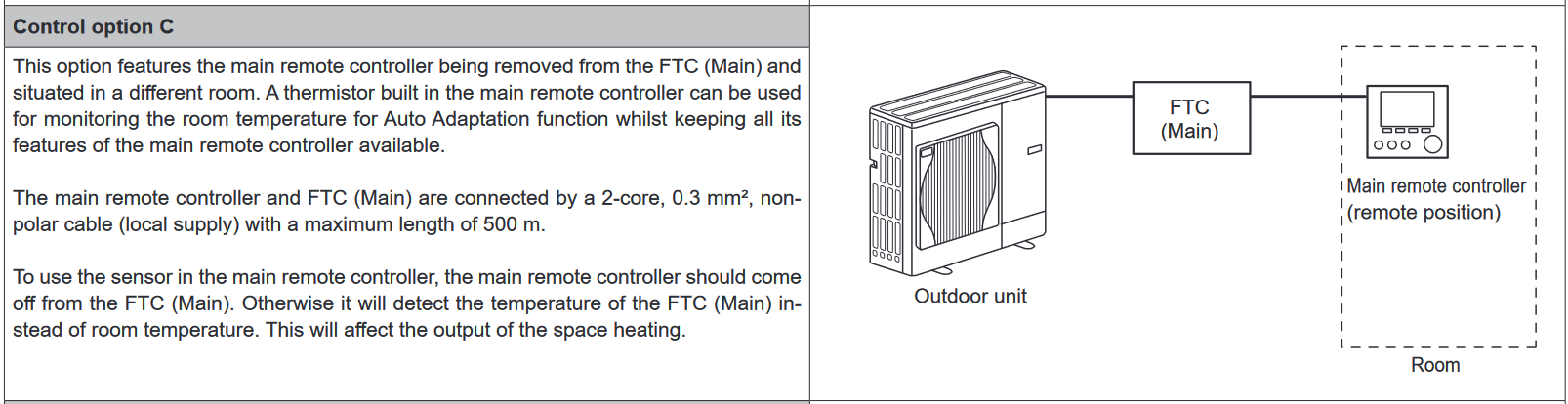

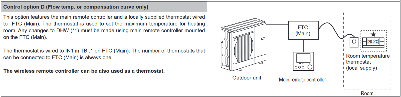

Just adding to this as I've had the exact same question (UH8 + ecodan FTC6) and managed to figure out the answer. My installer had left the ASHP configured with SW 2-1 set to ON but nothing connected to IN1 (TBI.1 7-8) with the plan being that I'd connect the demand from the UH8 once I had all of that wired up. Obviously, the heating worked just fine even without a thermostat being connected to IN1 so I wondered why anything would change once the UH8 demand was actually connected up to the FTC6 IN1. A closer look at the FTC6 manual provides the answer. Without any external thermostat input, the system operates according to "Option C": In my case, the remote controller was set to "Auto Adaptation" mode where it uses the thermistor built into the remote contoller itself to provide the "thermostat" function for the FTC - ignoring anything connected to IN1. To actually make use of the demand signal from the UH8, the controller mode must be set to either "Flow temp." or "Compensation Curve" according to the manual (Option D): In my case, I've opted to go for the "compensation curve" option and can see the ASHP turning ON/OFF in accordance with the demand signal from the UH8. I think it's essential that the operating mode of the FTC remote controller is changed from "auto adaptation" as soon as the UH8 and actuators are installed since I can envision a scenario where the ASHP eats up energy without actually providing any heating. This might happen if the remote controller is set to a higher temperature than the stats? The stats will shut off the UFH circuits once they reach target temperature but the remote controller (in auto adaptation mode) will keep running the ASHP trying to reach the higher temperature set in the remote controller. But of course this will never be achieved since the stats have already shut off the circuits .... NOTE: The FTC6 manual states that the ON/OFF cycle time of the thermostat must be 10 minutes or more to prevent damage to the compressor; however, by default the neoStat v2/Polypipe UFHSMARTW "delay start" function is set to 0 minutes (immediate). To remove any possibility of short cycling, I've increased this to 12 minute on my stats. -

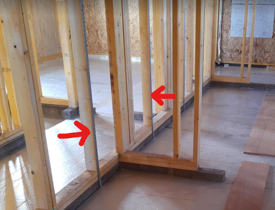

Dealing with hold down straps fixed to studs
Omi replied to Omi's topic in General Construction Issues

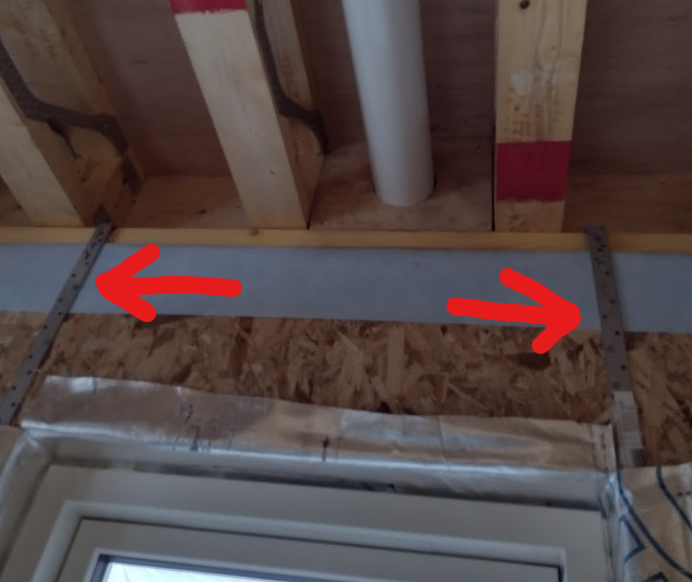

Thanks for the ideas everyone. Maybe I'm not understanding this correctly - why do I need a short PB screw? I can see how horizontal battens would help generally but what to do for the window reveals? Normally a batten would go right where the strap is such that the PB for the reveal can be screwed into that from the side? Maybe I just need to put a batten down each side of the strap, then shave 3 mm from another before putting it over the strap and screwing it into the sister batten from the side? -
We have several straps fitted to the studs in our timber frame build: The straps are about 3 mm thick and do not cover the full height if the stud. Obviously, service battens and plasterboard won't sit flush if fixed directly over the strap - if it is even possible to do so as the screws would somehow have to find their way into the stud through the straps. What's the best way to solve this problem?

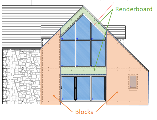

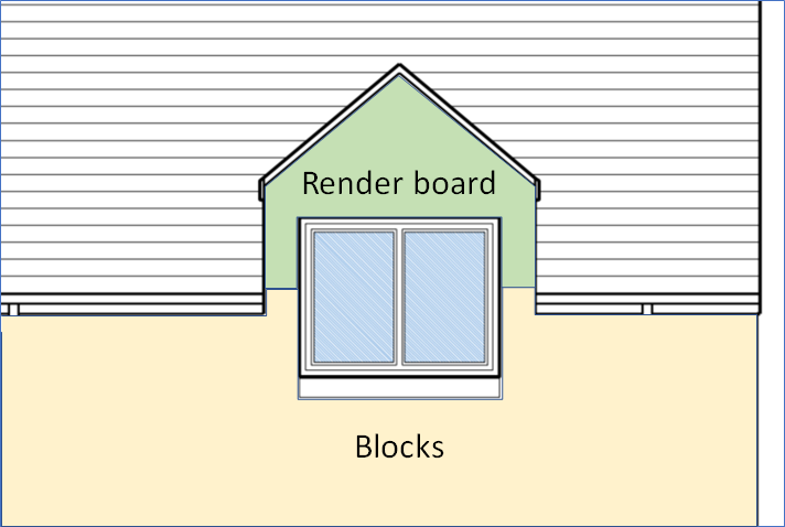

I've run it past our SE and the designer and the recommendation is indeed 3 layers of 45x45 battens: Vertical battens fitted to timberframe studs (or 600 centers) Intermediate counter-battens fitted horizontally at 600 centers Outermost battens fitted vertically again at 600 centers Render manufacturer's guideline states that the render should not be continuous across differing background materials so I think we'll leave a gap between the blocks/renderboard and treat it the same way as an expansion joint.
How do you mix blocks and renderboard on a single wall for a seamless rendered finish? We have the following situation in our build where the big picture window/bifold will have renderboard cladding (green) while it'll be blocks (orange) to either side: The external face of blockwork is 150 mm (50 mm cavity) from the timberframe so that would mean 137.5 mm of battens if we want the 12.5 mm renderboard to sit flush with the surrounding blocks? 137.5 mm could be formed using a triple layer of 45 x 45 battens but that doesn't sound right structurally? Is there another way to do this?

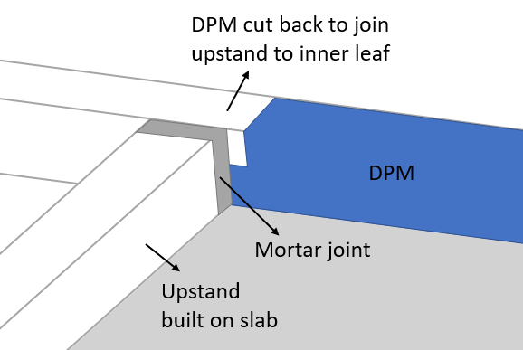

I've also got some Black Jack D.P.M. that I intend to use to seal the inside and outside edges of the repair. Hopefully that'll be enough. Now the next challenge - I noticed that the builders have cut away the DPM from a few sections where the wall upstands join the perimeter (inner leaf) wall. In these sections, the DPM extends about half way up the joint and the remaining bit is mortar: What's the best way to address this? I'm worried about lateral damp transfer through the joint but not sure much can be done about that at this stage aside from just adding the DPC as normal? Thanks!

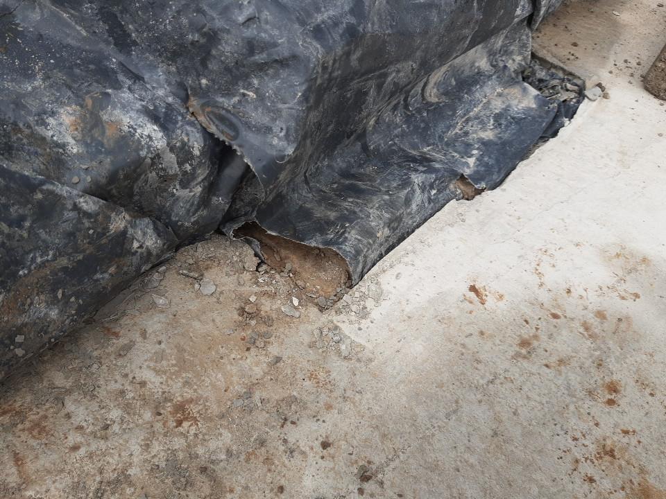

Thanks ?? Not really possible to tuck into the slab so will try lapping some new membrane over the tears as close to slab as close as I can and then tape.
Hi everyone, I noticed that there are a couple of vertical tears in our DPM where it comes out of the slab and is meant to lap with the DPC. What's the best way to repair this and should I even bother? Thanks.

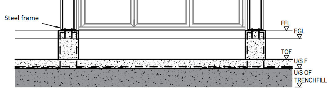

I think my main concern is water running down the inside of the outer leaf which might in this case end up collecting on top of the DPM/column. I imagine it can't hurt? Gut feeling is that the best course of action is indeed to grind it back a bit to introduce a gap between the outer leaf and the column. While I'm at it, I might also chamfer the edge to help with run off.
Hi, We have a pair of concrete columns that rise from the foundation to support a steel frame as shown below: I've found that they've been constructed in such a way that it's right up against the outer leaf -- meaning there is no longer a cavity where the columns are: Is this a big problem? The intended design (shown with dashed line) would have left a 30 mm cavity between the column and the outer leaf. Given that the columns as constructed are wider than they need to be for the steel frame, should I be looking at grinding away 30 mm of the column to create the cavity?

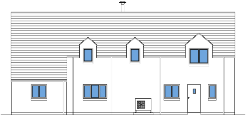

Don't have it I'm afraid. Our SAP calculation has assumed a value of of 0.35 for the dormer walls on the basis of 140mm insulation between studs and 12.5mm plasterboard. I would read this as meaning negligible insulation contribution from the external skin. -

Thanks everyone. Perhaps we should just stick with the originally specified design which is blockwork + lintel over the window openings as a tried and tested method. The cheeks will be renderboard + render. -
Hello, The dormers in our timber frame build are designed to sit flush with the external wall and are currently specified as using blocks for the front face elevations -- presumably just continuing up from the blockwork wall below: However, an alternative option may be to stop the blockwork at/just above the wall level and use render board as the external skin for the dormers. What are the pros & cons of each method? The render board approach seems simpler but would it be less robust? Would the change in materials (blocks -> render board) cause cracks to appear in the render over time? @ProDave - I see here that you were not that keen on the blockwork skin in your own build. What other alternatives would you consider? The "pillars" on the sides are around 260 mm each in our design.
