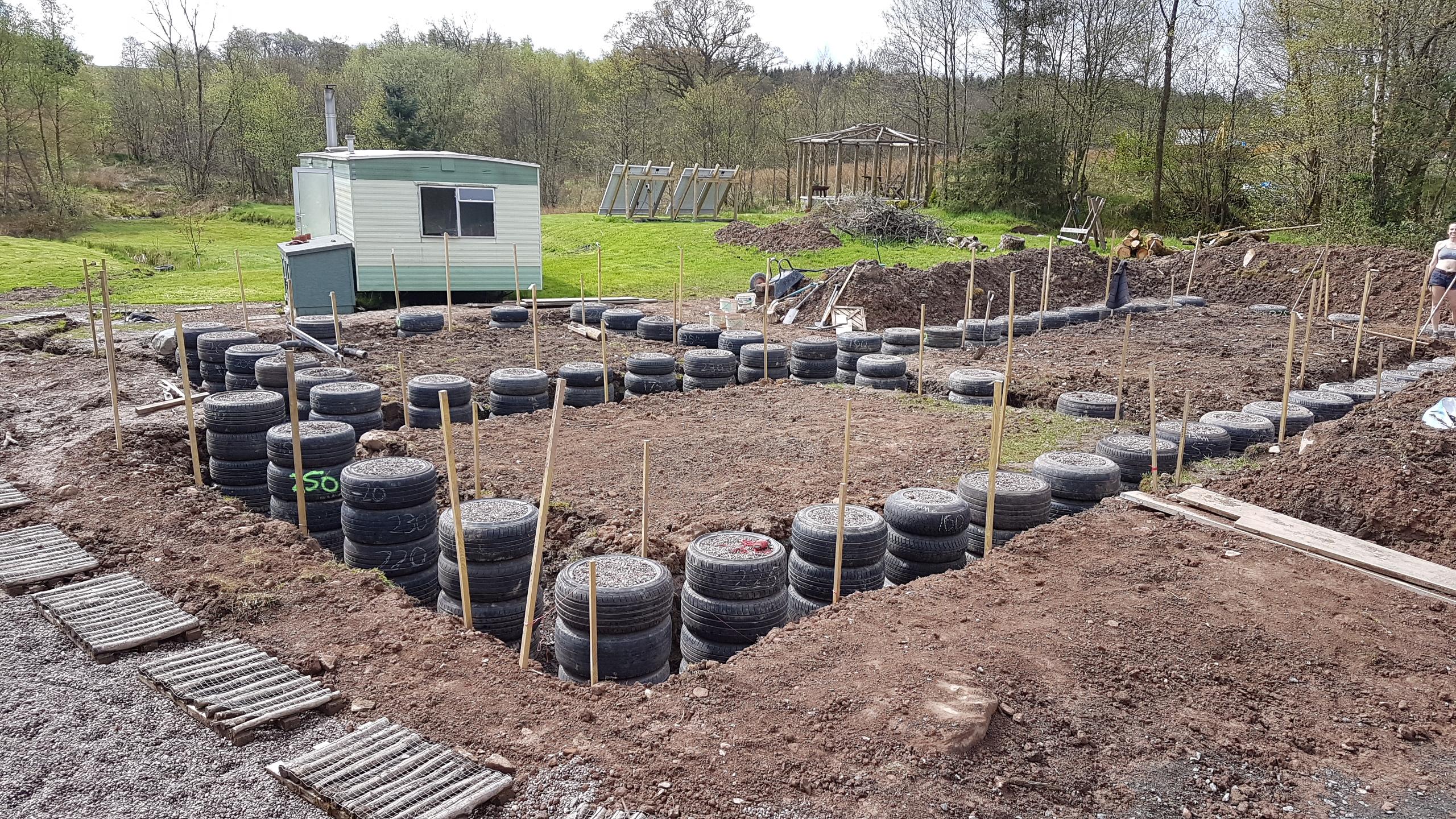

Self build offgrid strawbale house in Scotland
Pord67 replied to Pord67's topic in Introduce Yourself
The design is one used by Barbara Jones at Straw Works. They worked our original house layout sketches up into technical drawings (so no expensive architect required). The tyres are rammed with 10mm pea shingle (ie no mud), and are free draining and non-wicking. Think of them as rubber-wrapped gabion baskets. They are each around the same size but with some variations. All acquired free from grateful tyre fitters. Ideally our bales would have been purchased locally but that proved surprisingly difficult. We eventually found a farmer with suitable bales near Inverness. They are designated building bales, at the max density a standard baler can apply.- 59 replies

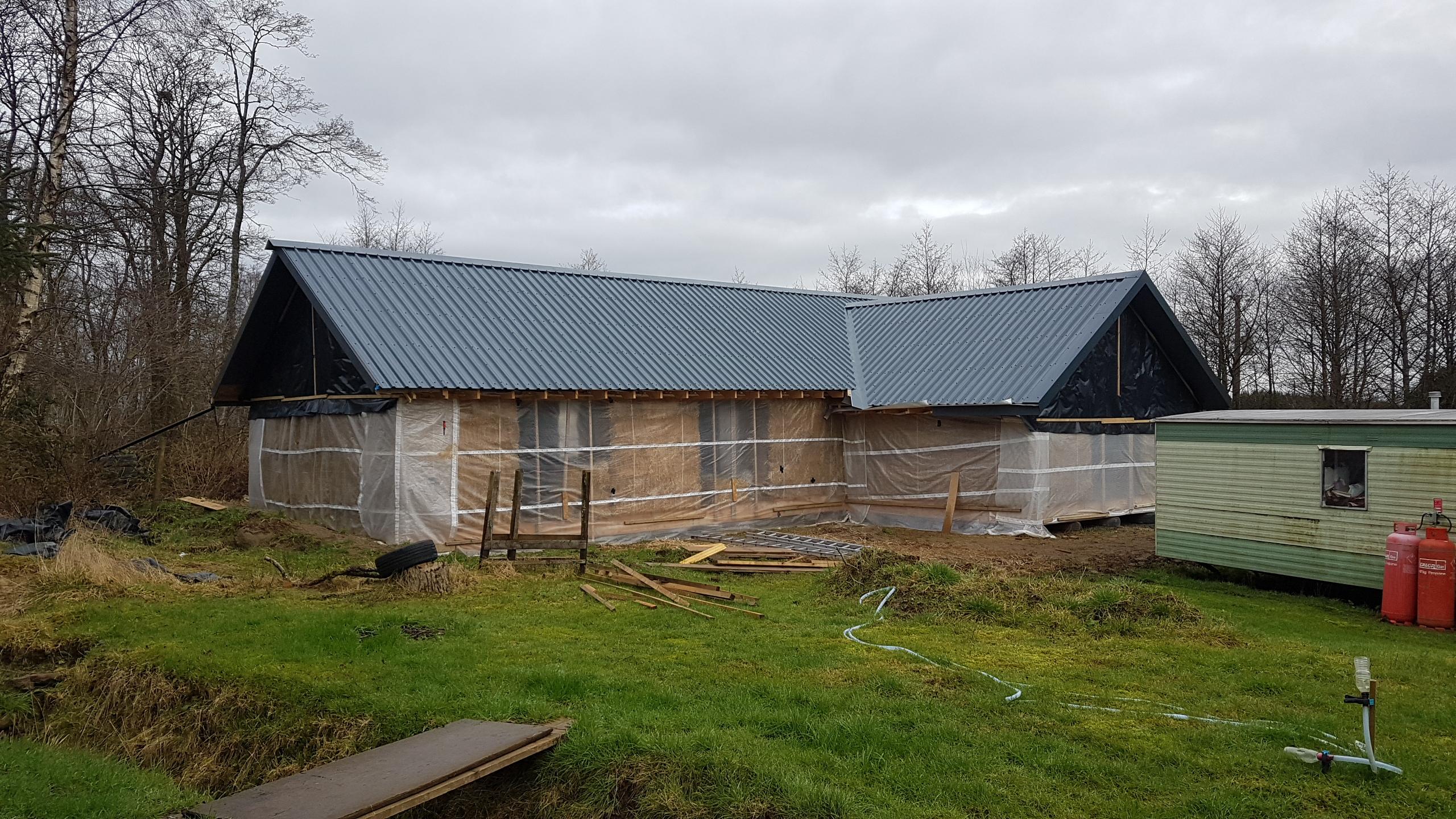

Sounds interesting Strawman. I've got details coming out my ears, so just ask away. The covering is scaffolding sheeting and has been absolutely invaluable, so much easier than heavy tarps. It comes in rolls of assorted widths, is lightweight but strong, and is fully waterproof. Very easy to attach to appropriate points and we use a combination of staples, cable ties and nailed or screwed strips of timber. The best part is its transparency, meaning the interior is not in darkness. We too are totally offgrid, currently with 1kw solar pv and battery bank. I prefer to use an inverter so we can use conventional appliances. Just last week we added an under counter freezer to our facilities. I also use a wee inverter genny to run the workshop.- 59 replies

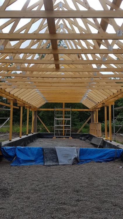

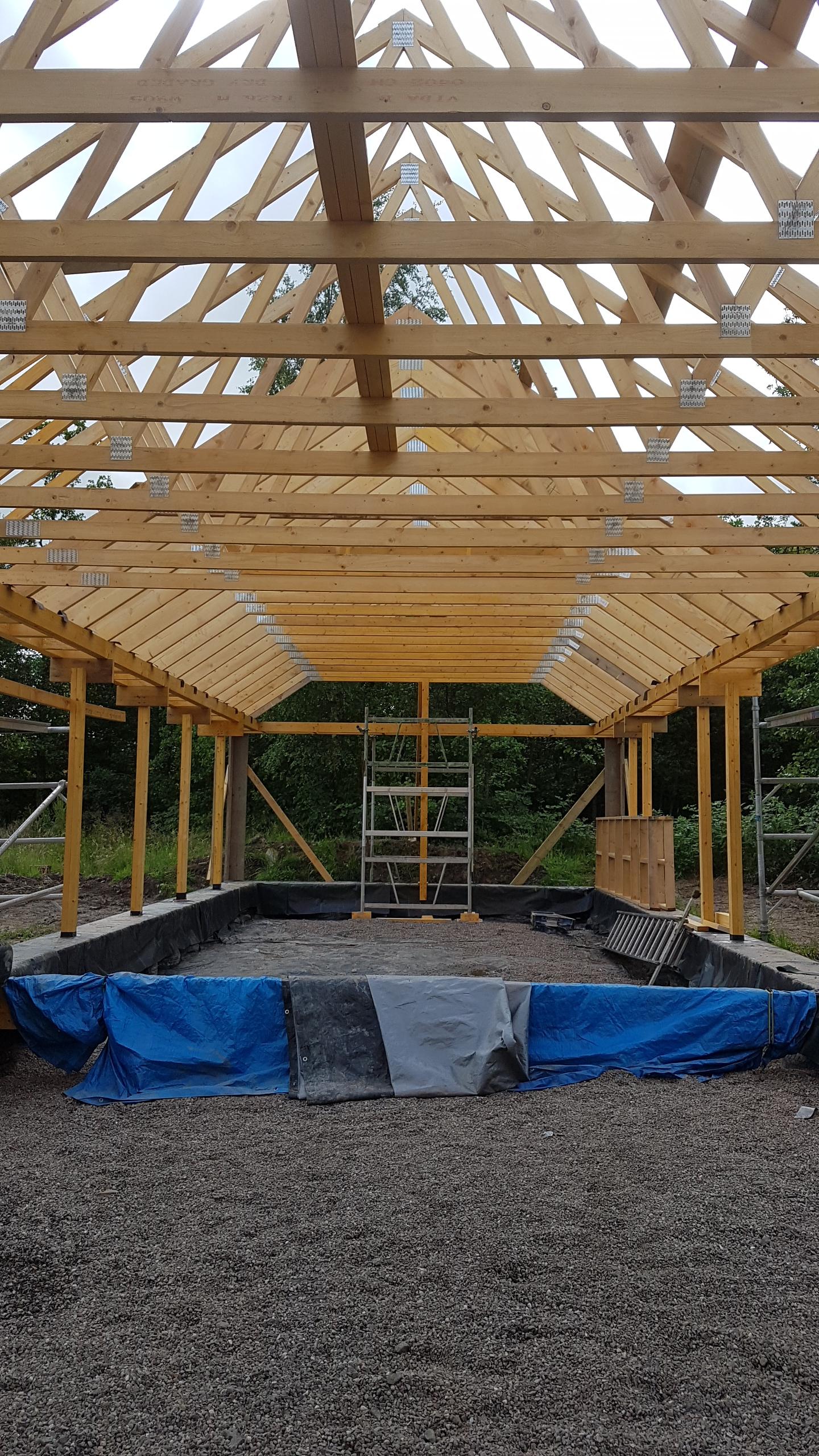

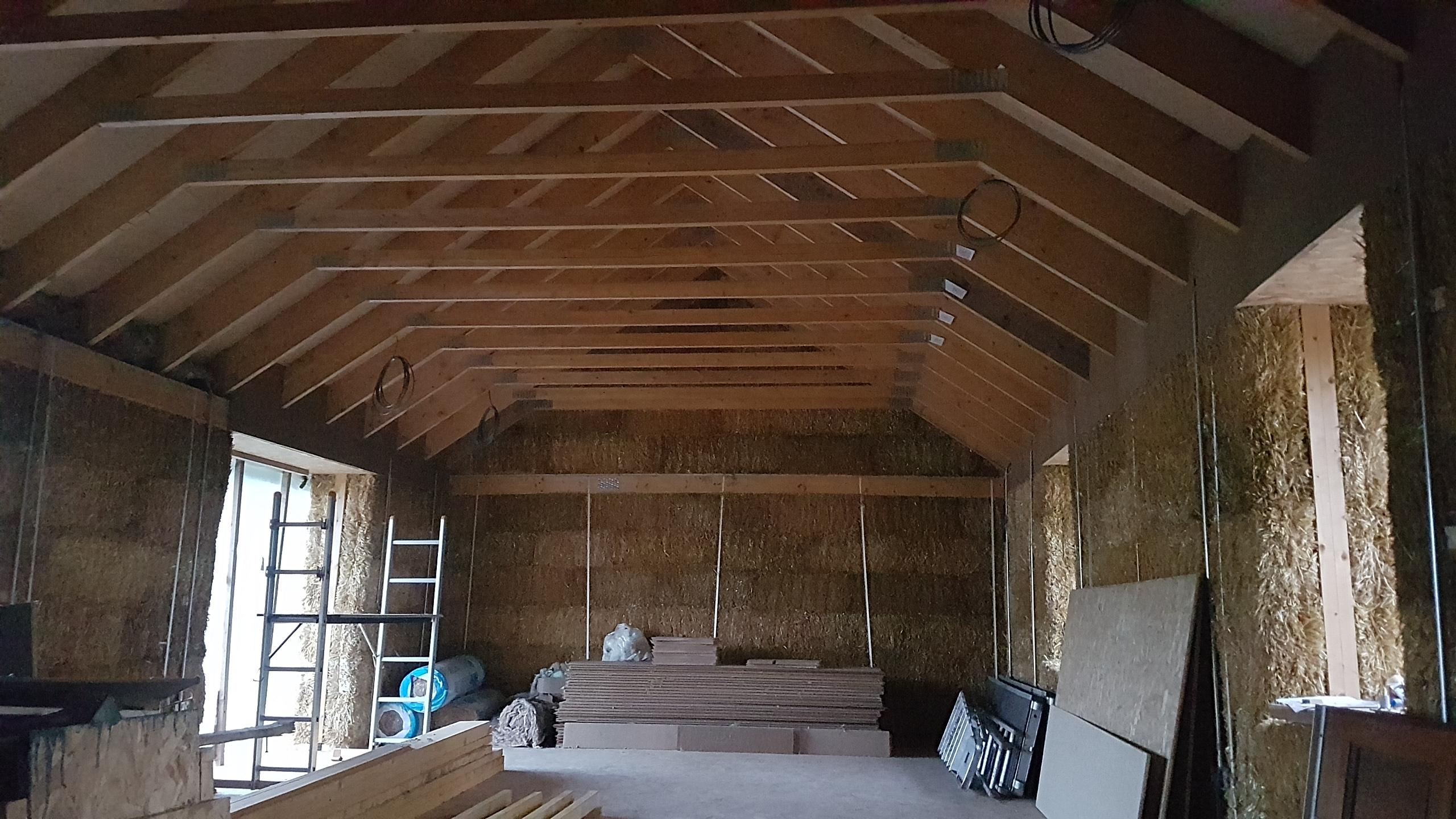

Sorry Joe90, forgot to reply. The pic below from early in the build might help illustrate. There are two box ring beams, one at floor level (sitting on the rammed tyres) and the other sitting on top of the bale walls. The trusses sit on the top one. At each doorway and window there are posts that connect the two ring beams. In addition, there are webbing straps (the kind used on pallets) looped around both beams. You can see them in the interior pic. And yes, visitors will be very welcome when it's finished!- 59 replies
We're going for it the hard way, rendering by hand, but keeping an open mind about reverting to spray if it proves too much. Yes, the entire house sits off the ground on stacks of tyres rammed with pea shingle. No concrete anywhere in the build. No DPC needed either.- 59 replies
