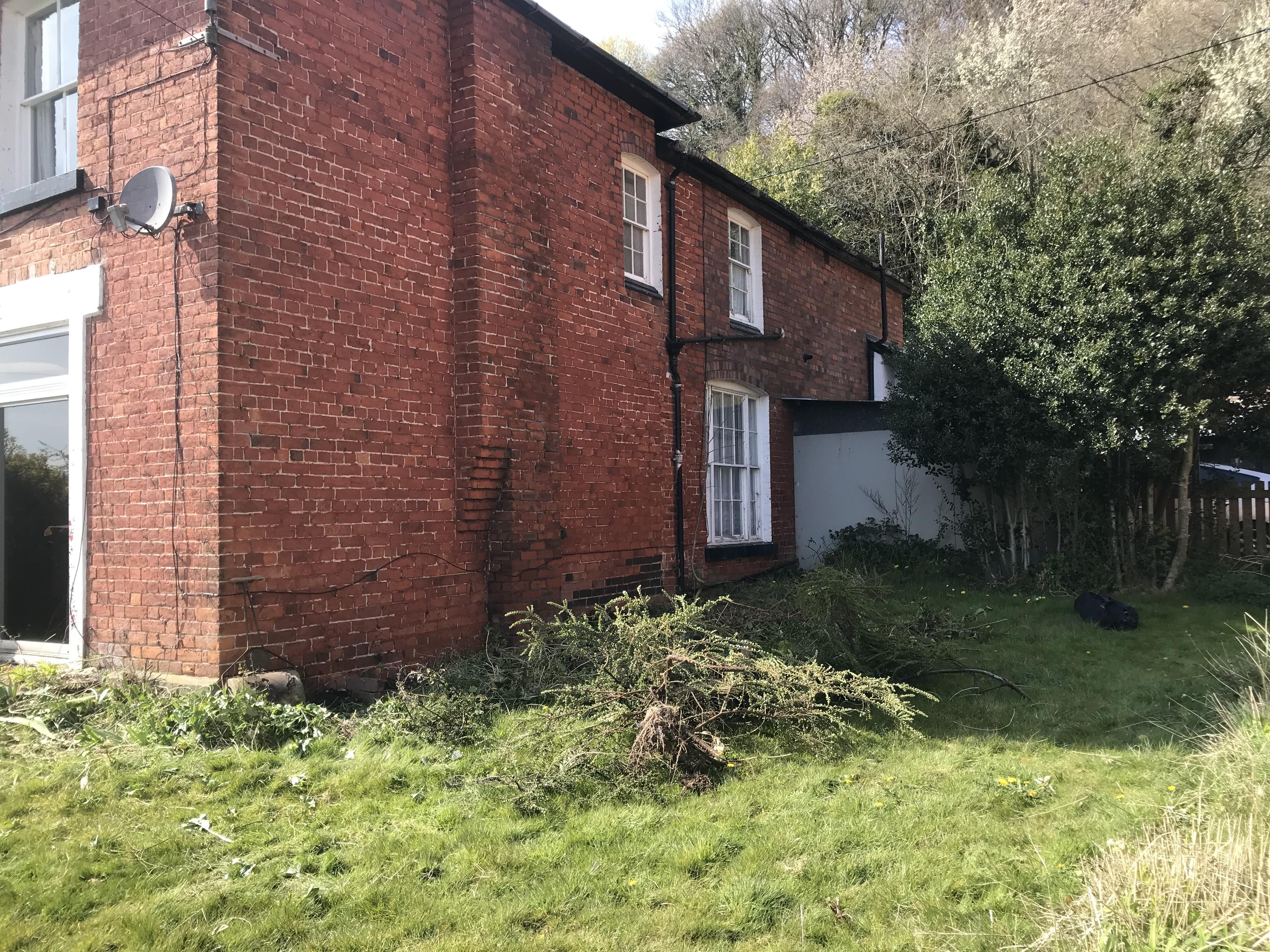

I've got a slope behind our house, which is just a few inches high at the lowest (East) point, rising to about 3-4' above the floor height in the house at the highest point (the Westernmost side of the back wall). The soil behind is gathering water which comes down off the hillside and we're getting various kinds of seeping (sometimes more!) ingress through the bricks behind into the houe. The obvious solution to this is to trench out the soil along that wall outside and install a french drain. I have in mind to trench out about 12" wide so that I can install the drain about 6" away from the wall with a slight slope directing water off the house to be safe. The question is, how deep should I go? I *can* go all the way down to 4' at the highest part of the slope, but I'm wondering if this might be overkill? Do I just scrape off the gravel and dig down to the end of topsoil? Should I try to get to bottom of subsoil?
It's Welsh hillside, so freely-draining loamy soil with grass on top, and hedging along the side above. Not a very extreme grade once I take the sloped part out, probably 3%, which I'll be smoothing to flat. Part of my reason for terracing the walls was to get a nicer visual impact and also keep the geotechnical engineering minimal. I'm imagining that 225mm thick will probaby be sufficient, provided I can get a decent angle for gravity mass, or pour a foundation with some rebar in it to take the pressure. I didn't include those details, as I gather the different kinds of block have different sort of engineering that goes with them. But the short version is, not massively complex for a wall, so not needing special kids of technology. Yeah, I'm doing gabions behind the house on another much bigger wall, but aiming for something a bit more in keeping with the structure (1830s Brick Victorian terrace). Was originally planning post and plank, but shifting to masonry, thus my query here to see if anyone else had tried blocks. It seems like some of the prefab blocks even have lego-like marks for stacking at the proper angle.

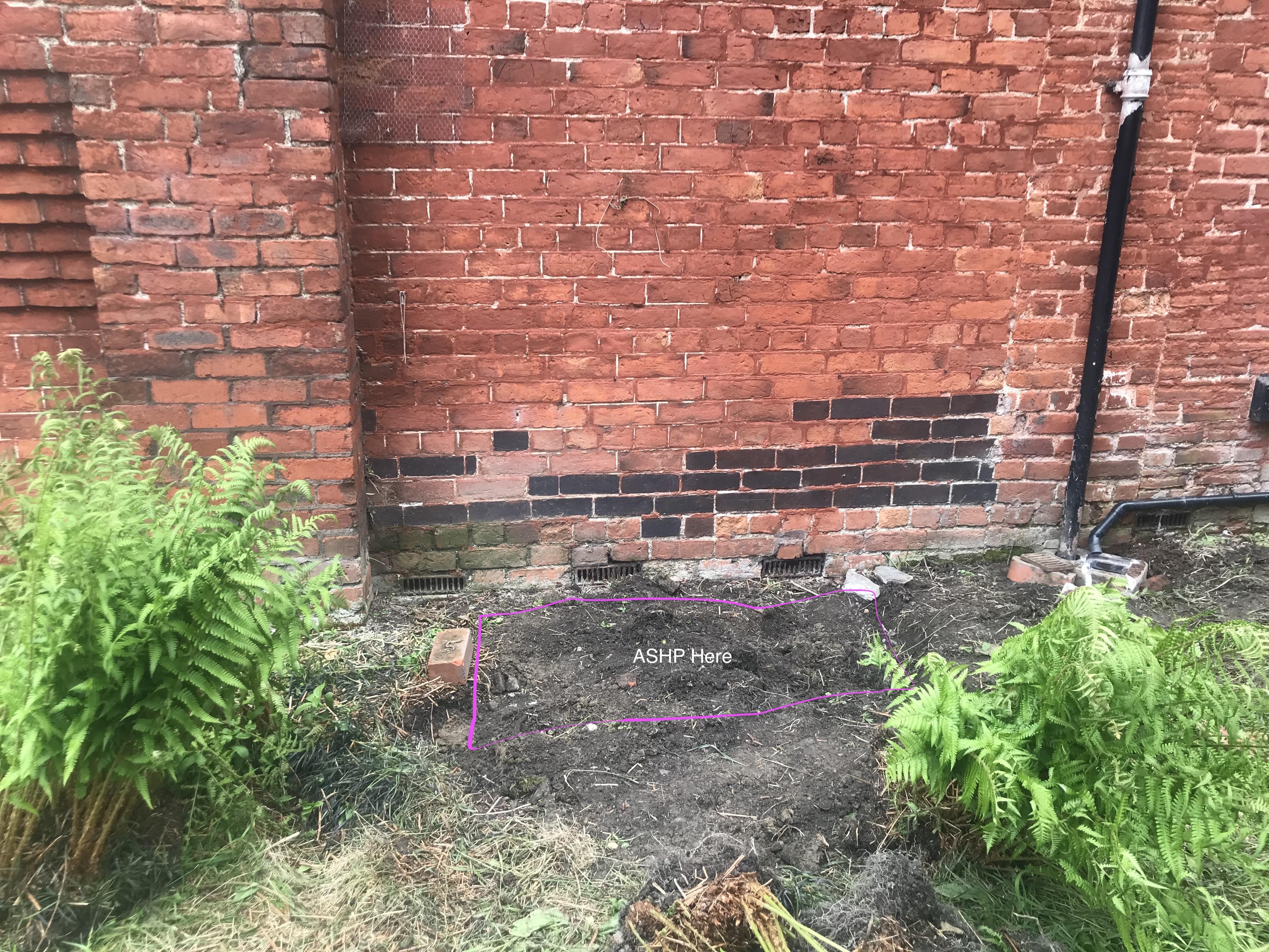

That's what I was considering (something a bit like this: http://www.primagem.org/how-to-install-a-floor-drain-in-concrete-slab/) - can you detail how you tied into the rainwater pipes? My slight concern here is how to get gravity working for me on the drain if it goes below the slab. Does yours sit above ground level like @joe90 ?

Good point - it's funny what you don't think about even when you're staring straight at it! So I'll excavate down a bit (maybe 6"?) put down hardcore (how much? maybe 3"?), compact it, and then put down sand (1" maybe?). Manufacturer requirement is 150mm (6") away from the wall, so maybe I will also move the site further forward from the wall than that (maybe 12"?). General consensus that it's not worth trying to run a pipe for drainage?

I'm installing a 16kw air source heat pump next week, and need to put in a spot to anchor it. I'm wondering if people can comment on how they've installed them and what has worked? I'm aware this ASHP will put off a lot of water (60-100l a day) and there's an inlet for sewer/waste water (it's a combined one system) about 4ft away from the installation point I've chosen. Should I put down some combination of sand, gravel and top off with cement? Or just small cement bits for the footings for the ASHP mount points? And what about water drainage? I can run some 40mm pipe from top of the pad, or a kind of soakaway. I'm just not quite sure whether 100l is too much to just drain in place. The ASHP is downslope slightly from the sewer inlet which is only about 2" below ground, so it's likely I'd need to run pipes above ground from ASHP. Would love to hear what you've done, and what has worked - and photos if you have 'em!

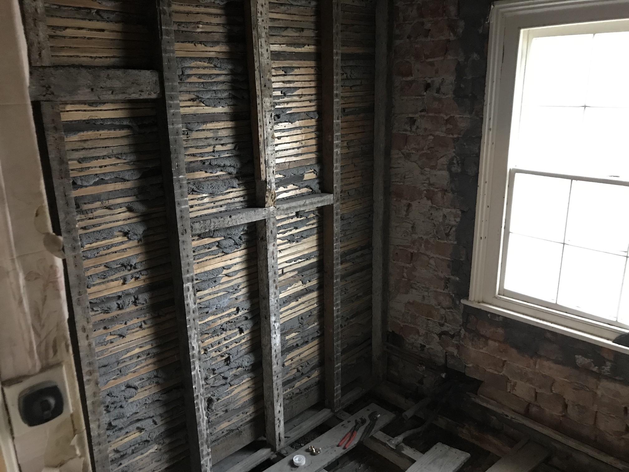

Hi all. Am finally underway on a renovation I've been planning and overthinking for a couple years now! We've just finished demolition on the bathroom, which is now this: The room is located on the first (top floor), with lath and plaster walls and ground floor ceilings (under the now removed floorboards), solid brick external walls and timber sash windows. I'm having the window rebuilt and reglazed with double-glazing. We need to re-frame and build the ceiling in this bathroom as the original was about 1" taller than I am with some nasty styrofoam tiles (now gone). I'm wavering on what to put on the external wall and non-wet wall to the right where sink and toilet will be located. The house is 1880-1910 era (with extensions added on variously), with solid brick external walls, 40mm lime plaster on internal walls, and lath+plaster for ceilings and newer walls (like here in the bathroom). There are some damp issues with the house (of course) but wherever I find a problem with dampness or water damage, but I'm growing increasingly skeptical about whether this is actually due to any fundamental issues with the house build - it seems that as soon as I remove wall covering to sort out damp, I find evidence of someone bodging on some anachronistic tech to quickly fix a problem (e.g. a patio outside with bricks blocking the air bricks for the cellar, cheap MDF cabinets in front of brick walls in kitchen, etc.). So, I'm thinking I prioritise draughtproofing and insulation, with good heat-recovery where possible, but also make sure that the building envelope is breatheable as much as possible. Obviously this is a bit tricky in a bathroom. The bathroom is inbetween guest room and MBR, so I'm planning to prioritise sound insulation for internal walls: rockwool sound insulation slabs in the floor and internal walls, and foam tape on the floor joists. Once I have insulation in, I'll put down 18mm plywood, install toilet/sink/bathtub/shower, with a beadboard/tile box around the bathtub and then tile on the floors. The bathtub will be installed on the left side of the room (shown in the photo) against the wall, with shower up overhead. Given the way that my children take baths (e.g. water thrown exuberantly all over the place), I need to put up some seriously hardy boarding on the walls adjacent to the bath. I'm thinking something like schluter kerdiboard (or an equivalent) as I'm hoping for a simple install I can do myself. But what should I put on the back wall? I considered PIR board for a bit of insulation with an air gap and moisture-resistant plasterboard in front, but I'm not sure this will be effective with the space I've got in the joists on that wall (70-90mm) and I'm worried about breathability of that system. So now I'm leaning towards 80mm or so of sheepwool batting, perhaps with woodwool boarding on it, then lime plastered and painted. Has anyone done something like this on a bathroom? Right side walls could just be rockwool acoustic insulation slabs (I gather that sound dampening is much strong than sheepwool with these) and plasterboard in front, but am now wondering if I should just do woodwool board there too? Happy to hear any/all suggestions! Especially if you've tried to do something similar. Floors:

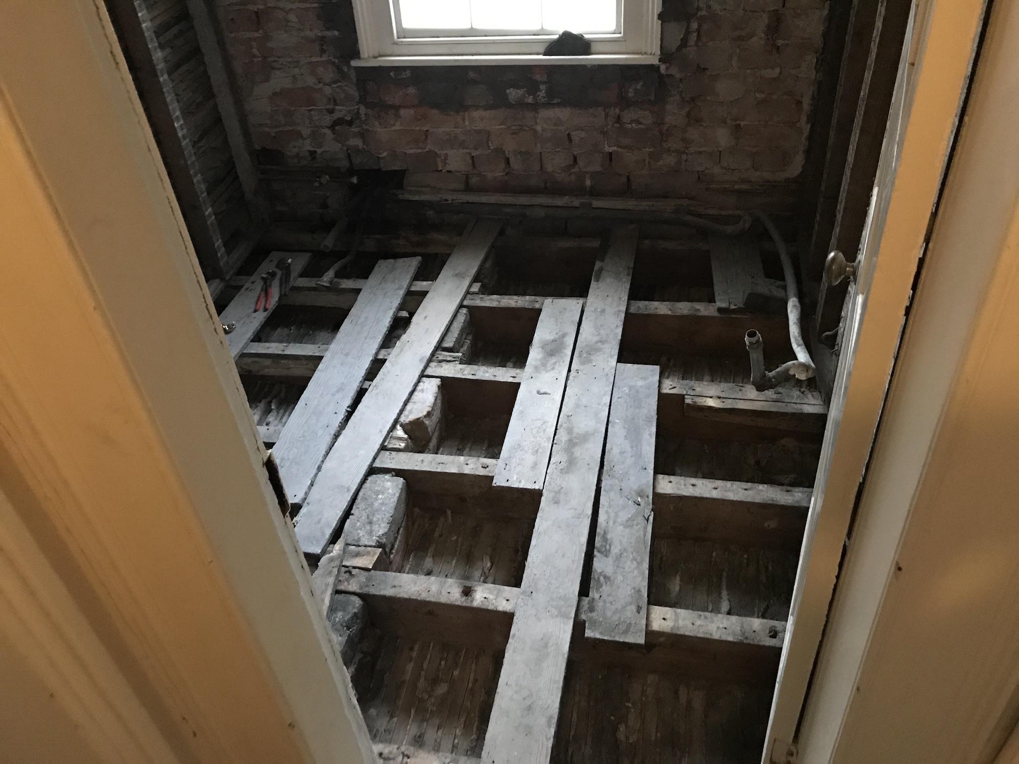

Thanks @George for confirming. Re: ventilation - I have this well in mind. There only seems to be rot on one side, which happens to be the front of the house, e.g. where cellar wall is soil all the way through and brick wall above, whereas on the other side where there is open venting to sub-floor of another room in the house, joist ends seem to be fine. I can't use air bricks there, as there isn't any air to be fetched, as soil level is above the joists so was thinking I might do a fan, or humidity extractor. Definitely open to ideas on this -

Yeah, @tonyshouse seems like a good idea to take out the sill plate as well. -
I'm pulling out a series of floor joists (63mm wide by 130mm deep) that run under about 40% of a sitting room. The joist ends are damaged by dry rot and there are signs of woodworm across the lengths. The floor is still sound, but I want to get this resolved before we move in. I've spoken with damp-proofing suppliers and the general advice seems to be to go for joist caps/sockets as this will prevent any ingress of moisture from the brickwork that they are laid into (on top of a sill plate). This seems like a good idea to me, but here's my problem: the joist caps are made at standard sizing with a "max height" of 225mm (https://www.manthorpebp.co.uk/air-leakage/joist-seals-wide-range-sizes-and-permutations/joist-seals-0) and then they suggest you pack the remaining cavity with cut timber. This is an old victorian house without any sub-floor to speak of, just wood floorboards nailed to joists, so there's no where for me to put that extra 95mm above the joist in that cavity. Has anyone worked with caps before and found a good hack / solution? I guess I could just cut off the top at 130mm and add damp-proof paint or membrane? The cellar is well ventilated, and will be fully tanked etc. so not worried about dampness in that way.

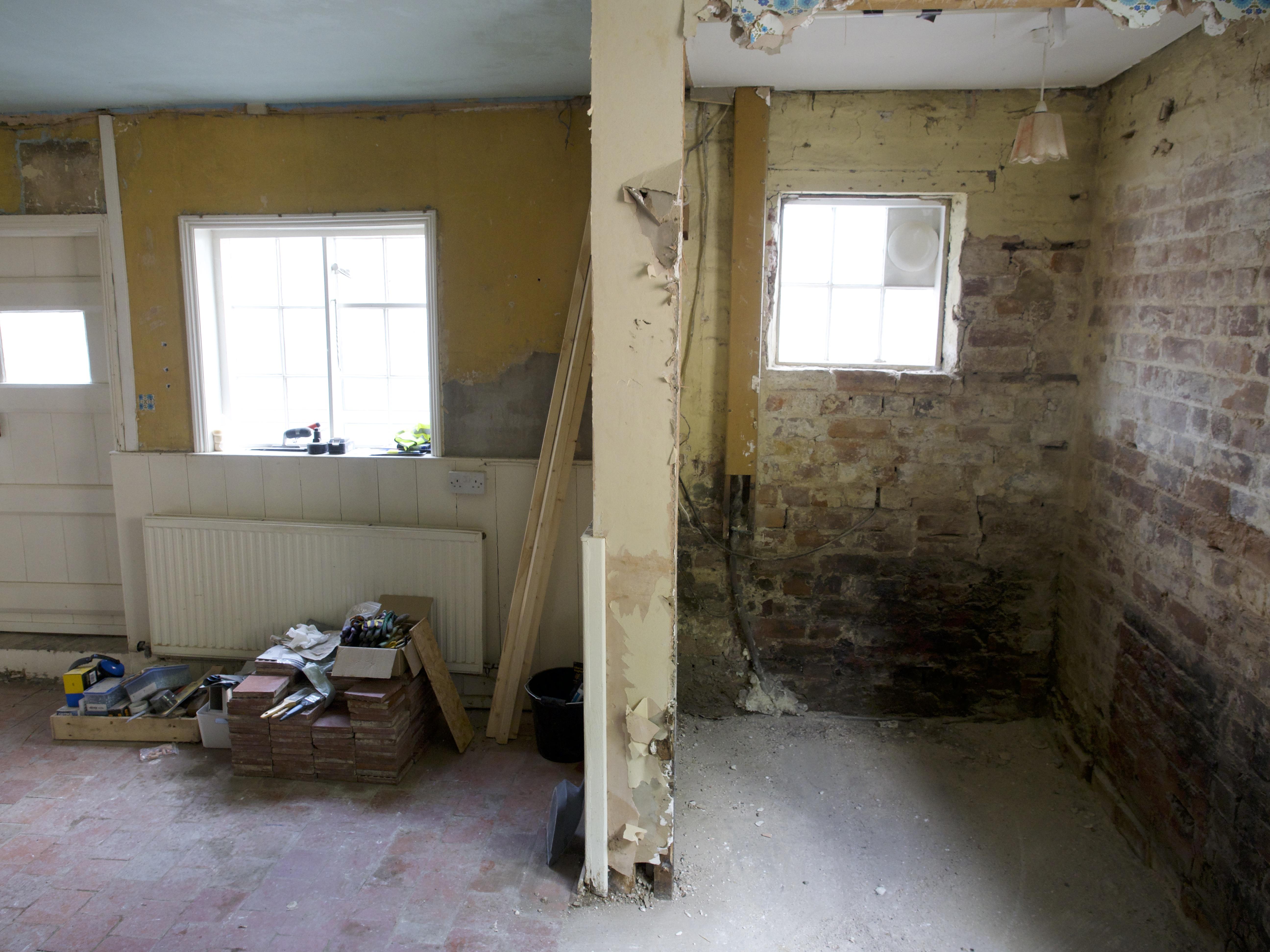

Thanks @DamonHDand @richi - glad to know the stuff works! Now I guess I just need to sort out whether to have timer, cord, humidistat, etc controlling it. I have a bunch of zigbee smart home gear to be installed so might see if I can run a DIY humidistat... -
Hi all, as per a previous post, I'm renovating a drafty old house (yes, draughtproofing, interior wall insulation, new windows, etc.) and installing an ASHP to run radiators. I'm now looking towards the kitchen more specifically. I'm aware of the need to have good ventilation and air exchange in the kitchen, but am reluctant to lose all that heat out an air vent. Wondering what experiences folks have had with single room heat recovery devices (like here: https://www.kair.co.uk/product/kair-heat-recovery-room-ventilator/). Has anyone installed one of these? Found them to make a reasonable difference?
