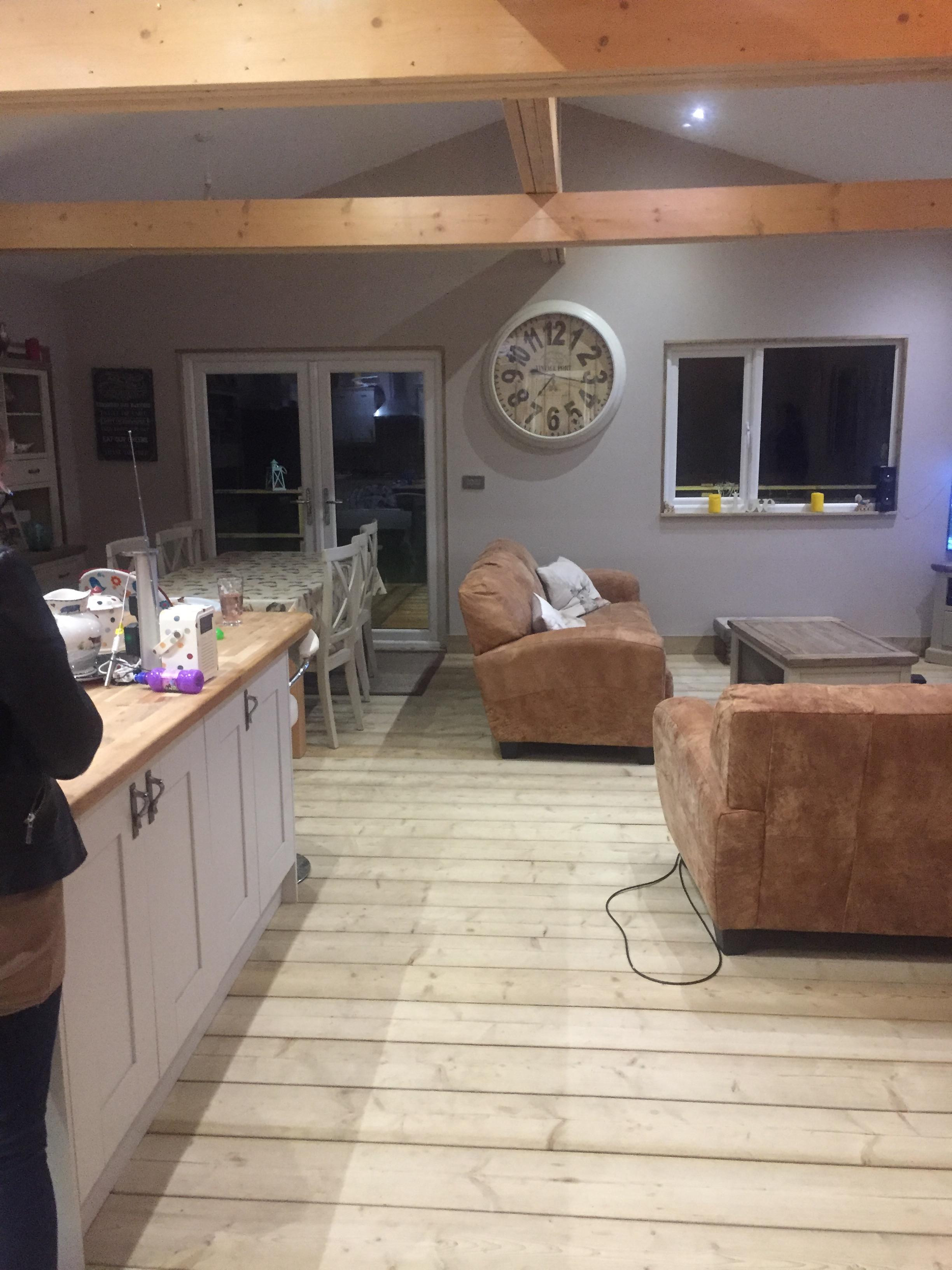

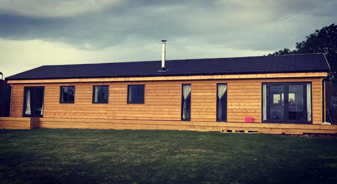

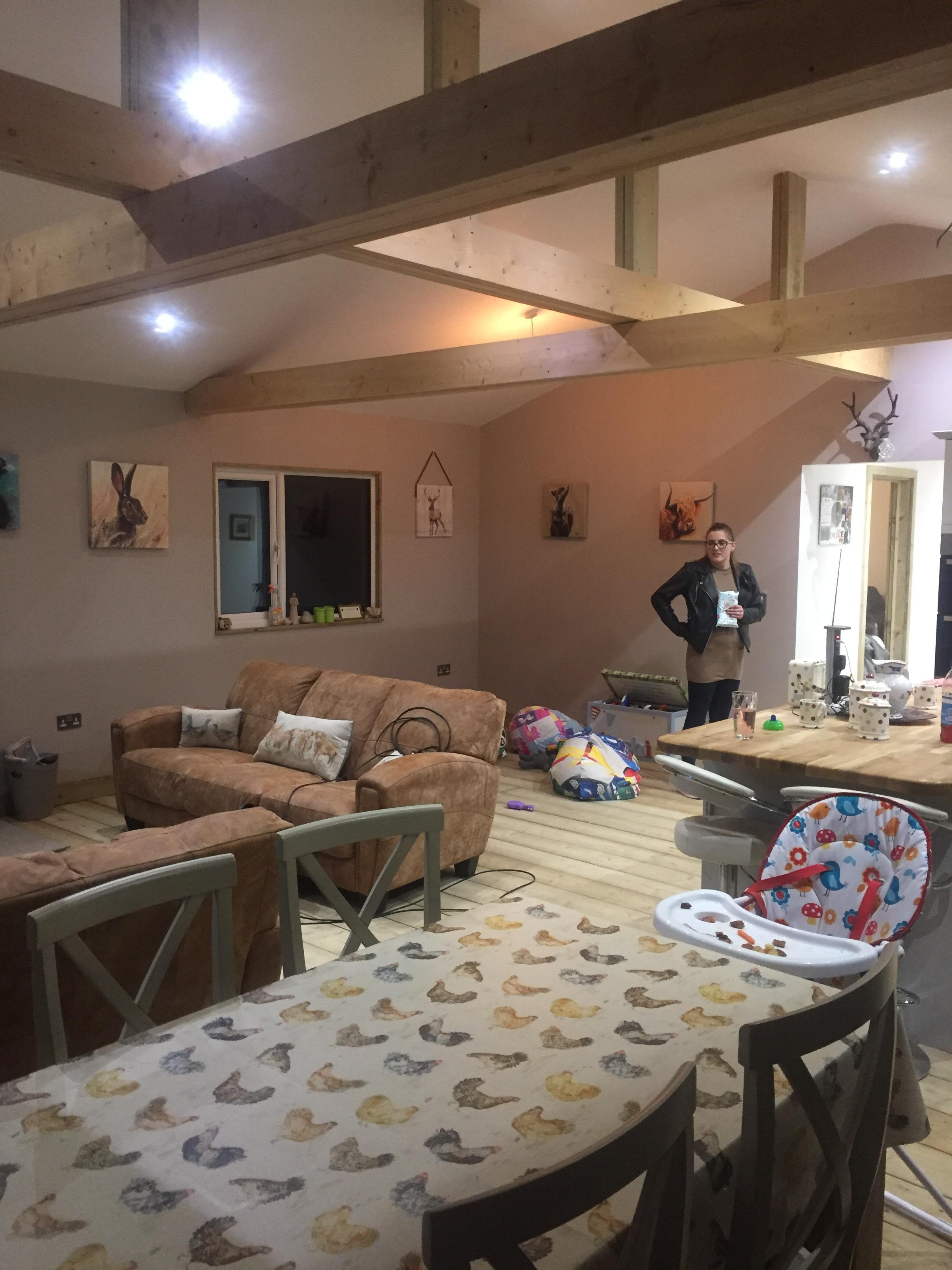

The house in picture has a timber floor yup. It’s sitting on concrete blocks, timber joists then osb boarding. Then just built directly on that. I went to visit that house wen it was -1 and snowing, all they had was a wood stove on in lounge & it was roasting, they also had smart electric heaters in bedroom but I’ve spoke to owner a few times over winters and he very rarely needs the heaters on. I was only going to go concrete flooring to fit underfloor heating and possibly leave the living area as polished concrete, fit carpet in the bedrooms.

Hey guys & girls, had a read through a few posts today so thought I’d join to try and gain as much information and experience I can. Ive been looking at building my own house for years now & ive finally found a plot of land to go ahead with. It’s 3 acres, which I’m intending on selling some on or possibly building a house to sell on. The home I want to build for myself, I’m looking to do it within a budget, I’m doing this more for the land than the quality of house if that makes sense. The idea ive had in my head is to build a timber lodge, 16m long & 9m wide, single story, apex roof. 4 bedroom, 1 bath with a semi open kitchen/diner/living area. I thought timber frame with cedar cladding, if it wasn’t too expensive, with air source heating, again if it was worth it in the long run. Well, hope this gets me a start on here & if I need to give some more info, feel free to ask. Thanks.
