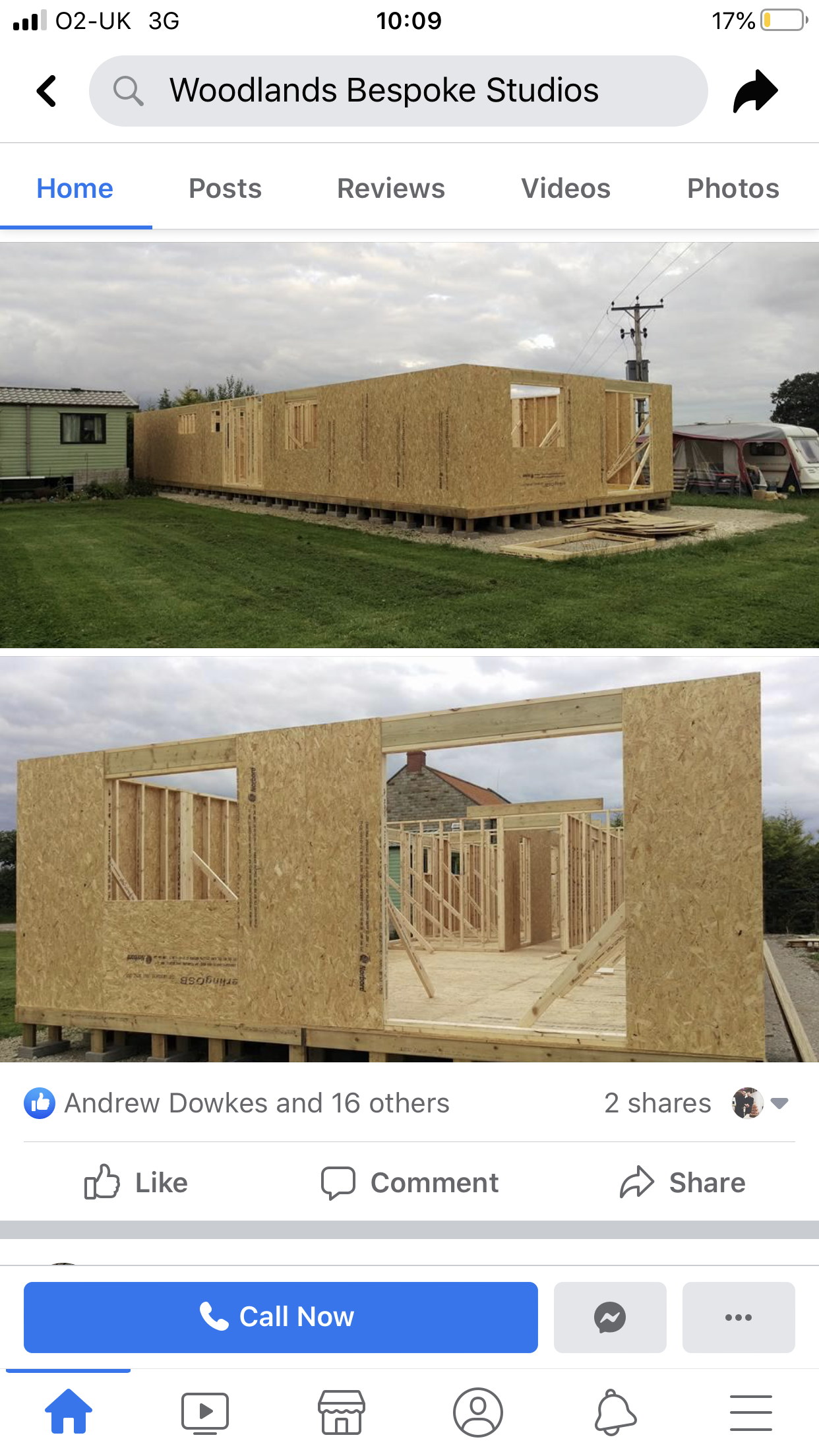

  5. The house in picture has a timber floor yup. It’s sitting on concrete blocks, timber joists then osb boarding. Then just built directly on that. I went to visit that house wen it was -1 and snowing, all they had was a wood stove on in lounge & it was roasting, they also had smart electric heaters in bedroom but I’ve spoke to owner a few times over winters and he very rarely needs the heaters on. I was only going to go concrete flooring to fit underfloor heating and possibly leave the living area as polished concrete, fit carpet in the bedrooms.

  7. My thoughts are (tell me if I’m wrong, which is more than likely) If I put in a heated passive slab, with a block ring around it, build a 6x2 timber frame, osb on outside, house wrap & larch cladding. Then insulate between studs, maybe even thin pir boards fixed to stud wall on inside with ply/plasterboard fixed on top. Roofed with fibre cement sheets. Without the little details, would that be a sufficient shell to start with?

  13. So just trying to build up a plan for everything and costing.... If I was going to be building a timber lodge on a block and joists(so crawl space under), how would I prepare that for underfloor heating? What do I need under it & what types of flooring can I put on top? If well enough insulated, Would I need it in every room? Bedrooms? The only UF heating I’ve dealt with is an electric mat under my bathroom tiles at the moment.
