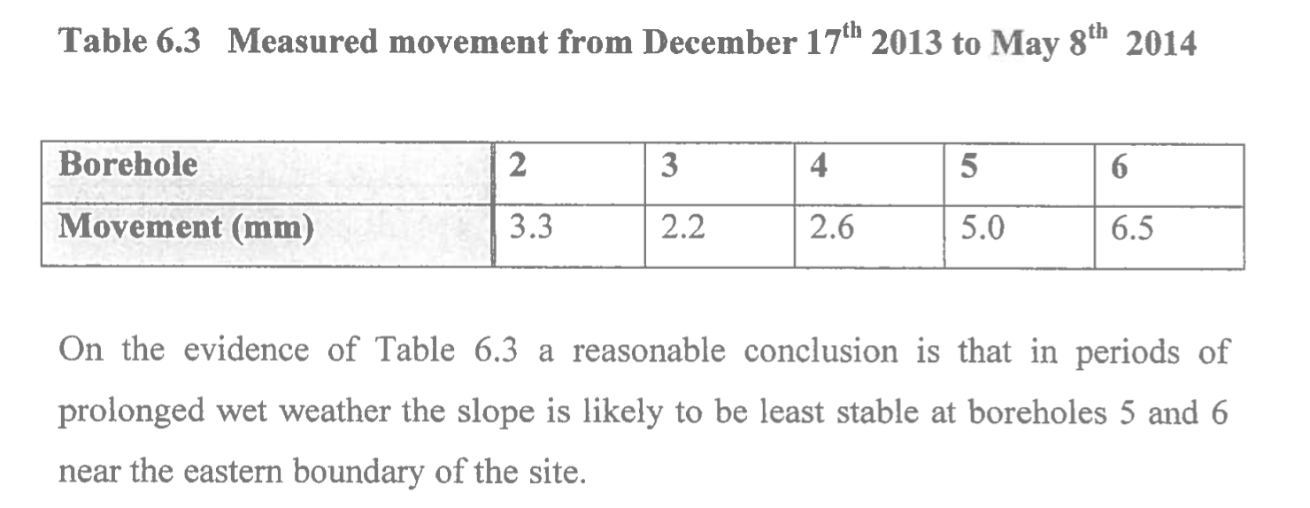

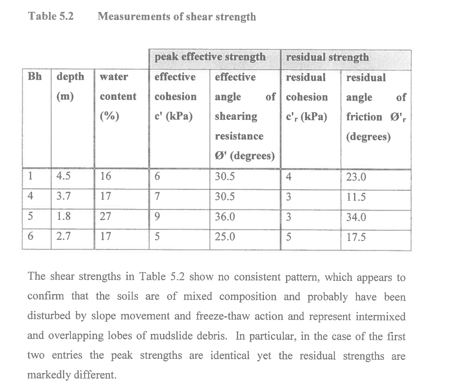

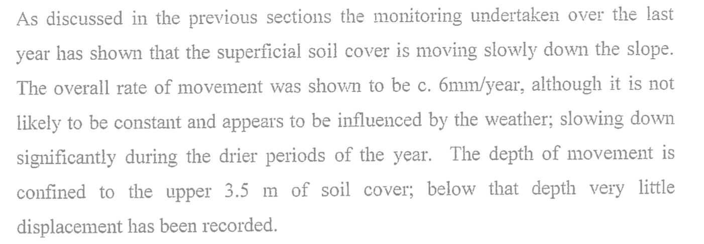

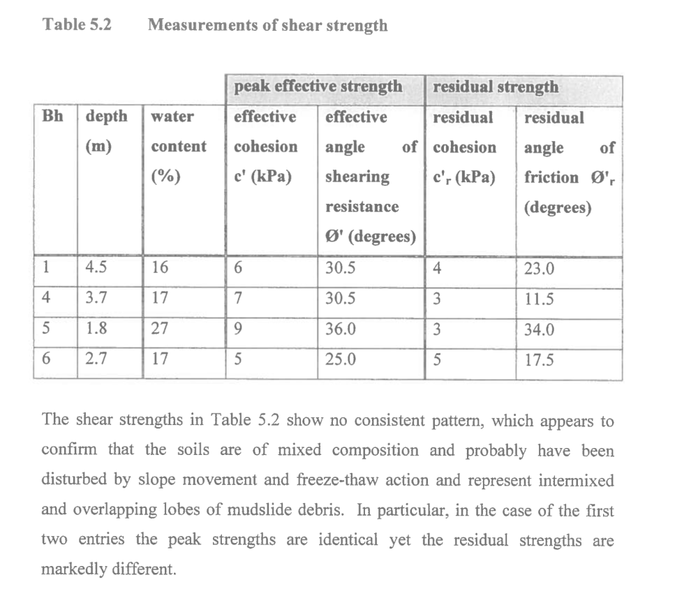

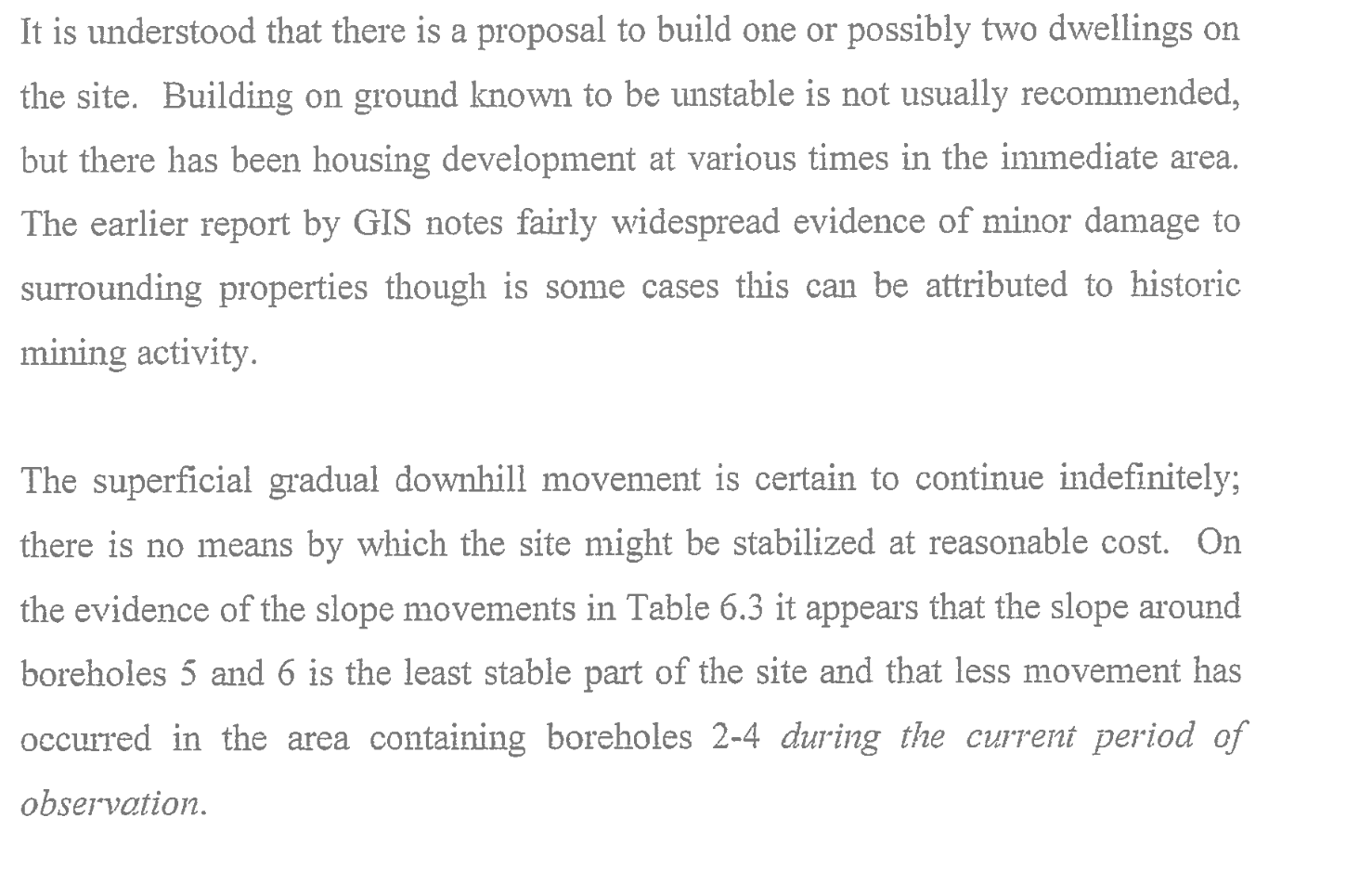

Hi All, I was hoping that I would be able to get some friendly advice which would help us decide on a sensible solution for the foundation design on our self build. During the planning phase we had an investigative ground survey, The report which was very extensive involving 6 piles drilled to various depths of 4.6 to 6.9m over the site, the soil was then tested for quality and the holes then monitored and tested for subsidence and water content over a 12 month period. The results of the test were that construction could be permitted but it was highlighted that some ground movement to the top 3.5m of superficial soil had moved down the slope during the test (6mm during the year of this test). In regards to foundation design the report summary recommended re-enforced deep trench foundations or a re-enforced concrete raft with a lightweight timber frame structure. After getting our planning approved we approached a structural engineer who reviewed our plans and report and also spoke with the ground investigation company to discuss the report before visiting the site to assess the project. Their recommendation was to having a piling solution due to the area and the work involved. For reference the property is a 10m x 10m square, and we are intending to go brick and block now we are having a piled foundation. Our site is sloping around 14-20 degrees, but the build will be on level ground so we will be cutting into the slope and installing a king post retaining wall behind the house to hold back the soil. There is already a log retaining in place which we will replace with something much better. It has held without moving for 10 years but as it's softwood it's now rotting away. The plot is also in a world heritage site with a history of coal mining so the ground is generally poor in our county. Planners and engineers are very wary in this historic area due to many period properties subsiding due to the ground conditions, sloping sites and traditional construction methods used in the older buildings. On the recommendation of the SE we approached several piling contractors for advice and quotes. The first company recommended and quoted for 35x 150mm driven piles driven to a depth of 5m. We were very happy so we booked him, he then supplied us with his structural engineering design but last week called up to say he couldn't do the work as he had spoken to another contracter who had worked in the area and said we needed augured piles rather than driven which was something he didn't do. I then went back out looking for a new piling firm and spoke with another contracter who was familiar with the area, he had actually done the piling for a build in the same street 10 years prior. He recommended that augured piles would be needed due to the ground conditions but his quote never transpired which was a shame, likely due to being so busy. I then spoke with another company, this company seemed like a really good team, really helpful, loads of positive reviews and a great website with lots of videos and photos of previous work. After sending them all the information they quoted for roughly (35x 150mm driven piles driven to a depth of 4m) , the quote was really competitive and I called them to discuss it. I mentioned that another piling contractor had recommended augured piling and said driven was not an option for this site. His reply was that they felt that the project really didn't need it? They also said following a site visit their structural engineer would make another SE plan for us and before that they would send me an additional quote which included heave protection and augured piles so at least I had a cost for both. The revised quote showed pre-augured piles down 2m. But didn't mentioned fully augured? Just augured. I then approached another company, after looking at the ground report and plans they said that driven piles would not be suitable and that I was going to need a more substantial piling solution. They quoted for 18x 300m augured piles to a depth of 12m. This was around £10k more than the driven piles quotes I had received from others but it's also the most heavy duty solution for the job. It seems we are going for a piled solution for our self-build but with all the different information we have we are having a hard time deciding on the most sensible choice, it would be great if anyone with experience in this field could give us some advice on what way to go. The information we have summarised: 1. Quote for 5m 150mm driven piles - But then said he couldn't do the job 2. Said we needed augured piles, driven no good - Quote never received. 3. Quote for 4m 150mm driven piles, but did an additional quote for pre augered piles with driven should it be need once's SE calcs done. 4. Quote for 12m 300mm driven piles. Many thanks, Edd

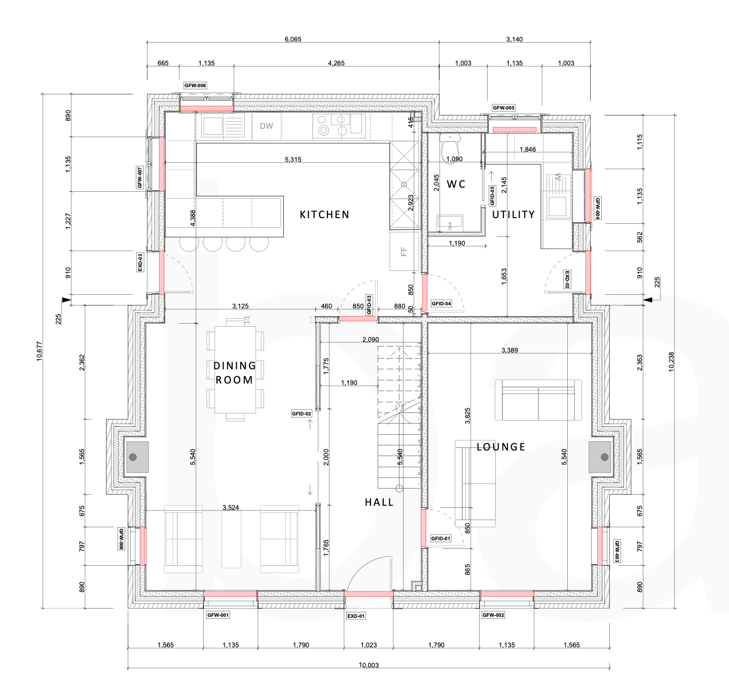

Evening, So we are hoping to start getting an architect on board soon to get some plans drawn up, size of build and budget is high on the agenda the moment as are the cost of the preliminaries. Ideally our house would be: 200m2 ICF construction two storey dwelling £200,000 build budget, ex fees etc Vaulted ceilings 4 Bedroom House Master Bedroom with en-suite, walk-through wardrobes etc 3 further bedrooms capable of growth. Family Bathroom Remote or attached storage area/plumbers workshop? Attached 2/3 berth garage Attached hair salon / utility Open plan kitchen dining and living space Separate lounge room Ground floor wc Pantry/utility space Dry store of the kitchen Additional storage on both ground and first floors In an ideal world the build work completed would be done by the following people: Who’s doing what??? (in theory) Ground work: Me + Labourer / Chargehands Underground Drainage: Me + Labourer Foundation: Me + Labourer ICF: Me + Labourer Roofing full: Sub-contractor Windows/Doors: Manufacture install UFH/Boiler : Me Plumbing : Me 1st Fix electrical : Me Above ground drainage: Me External brickwork: Sub contractor (friend) External cladding: Me Internal joinery : Sub-con (friend) 2nd fix plumbing : Me 2nd fix electrical : Sub-con (friend) Dry lineing : Sub-con (friend) Me Plastering: Friend Decoration: Me Snagging: Me Landscaping: Over time / me Speaking with several lenders, (Buildstore / ecology) once we line up all our ducks its looking like we will be able to borrow between £250-£350k, the maximum we want to borrow is £280k as after all this is a loan we have to pay off before we retire, 30 years on a repayment with a general bank remortgage once its built Im going to be looking about £800-900 a month which is at the top end of what I would want to spend on a mortgage. Out of the 280k we would need 40k to pay off our outstanding mortgage on the plot, 40k contingency budget & 200k for the actually build. I've been looking into the cost of getting this project off the ground and what sort of money we need to put in from the start. Attached is my schedule and its looking like most of it is going to be needed to be paid upfront out of our own hard earned cash before the build commences, I am sure that we have missed some unforeseen cost's such as lending / broker fee's so any advice would be greatly appreciated if their are any hidden fees that I may need to add it would be great to know? and I am yet to be given an estimate for building regs plans yet? Another concern I have is about the land itself, we are in a local high risk coal mining area and although there are no pits nearby and we are building replacement dwelling, the neighbouring self builds and private developments have all had to have invasive ground investigation reports done and some bore holes drilled to check the land quality. I have had this priced up and am of the thinking it maybe wise to have this done first to ensure that we would be able to continue our build knowing that we will be able to afford the foundation type (strip or raft) as I cannot see us being able or wanting to pay 40k + for pile footings? After all we are not millionaires and this is not grand designs so we want advert the expensive why! moments and hopefully have a fairly straightforward build. Financially our project plan is Move up to ou
