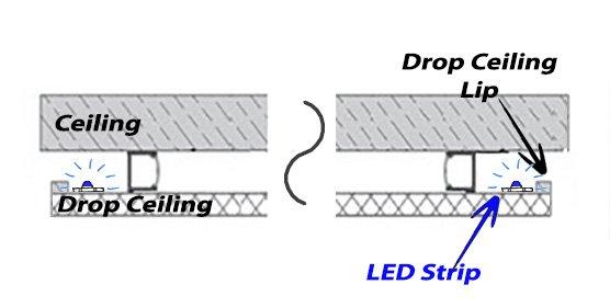

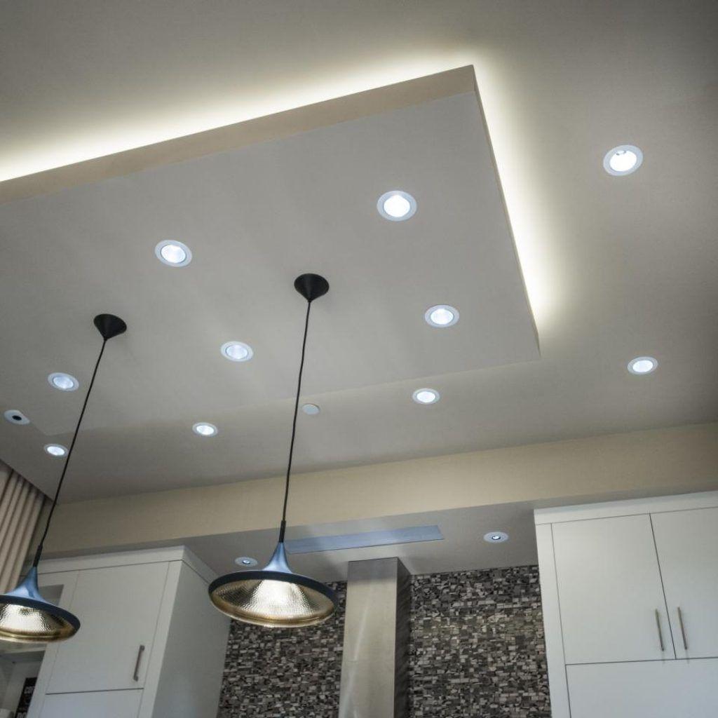

Hi, I'm looking some help how to install a dropped ceiling and the detail required for it. I'm looking to create a dropped ceiling in two rooms like photo attached, I want to know how to hide the LED strip like the detail attached? Has anyone any experiences? I was going to fix timber studwork to the existing ceiling level and fix plasterboard onto it but not sure how to create the lip around the perimeter to hide the LED strip? Thanks

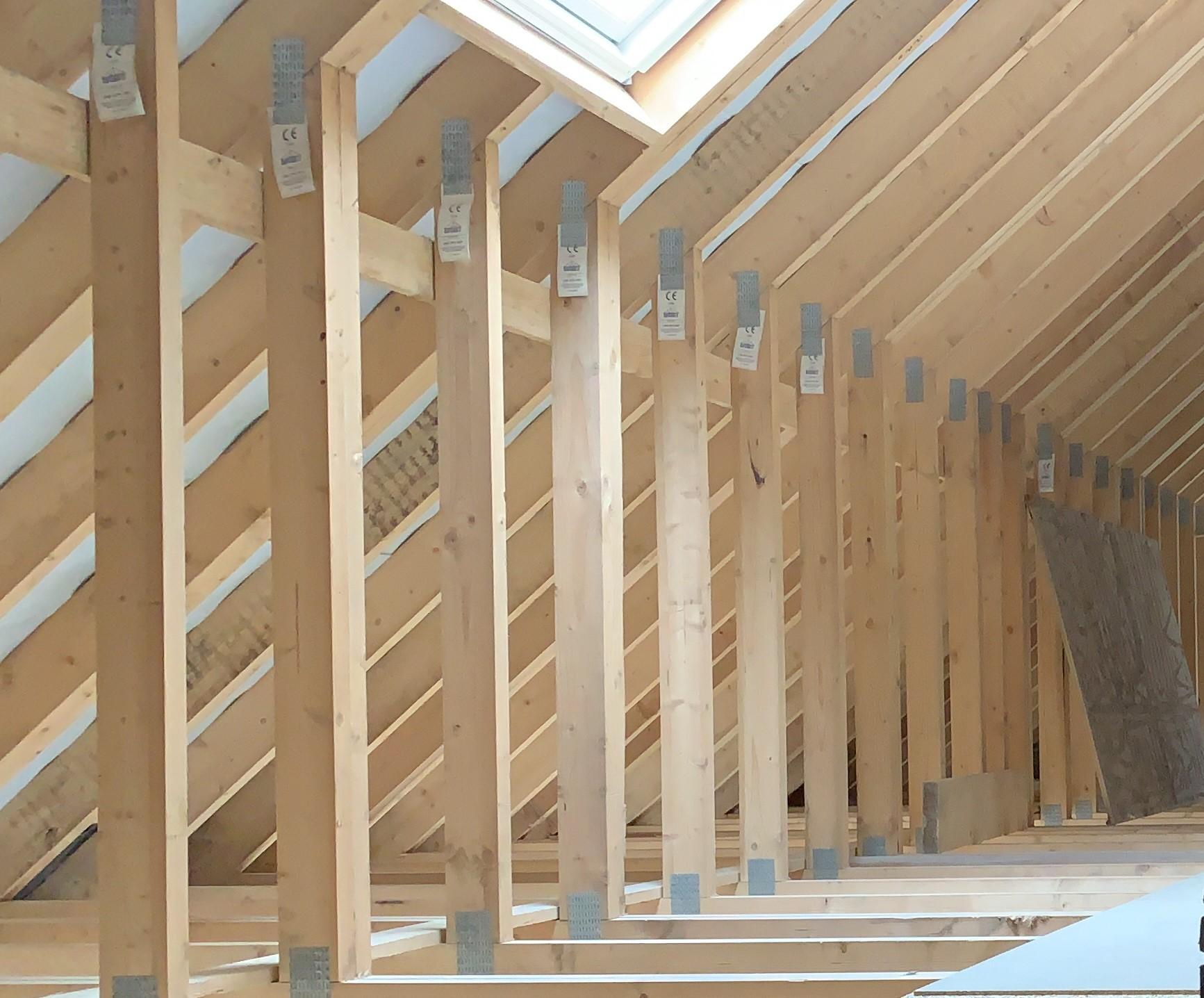

Quick query - I will have 100mm PIR board between sloping rafters and 50mm below, then in the voids 200mm rockwool between joists and 200mm above. Do I insulate between the vertical timbers? With the same as rafters 100mm and 50mm PIR, or does it not require insulation at all? Thanks
