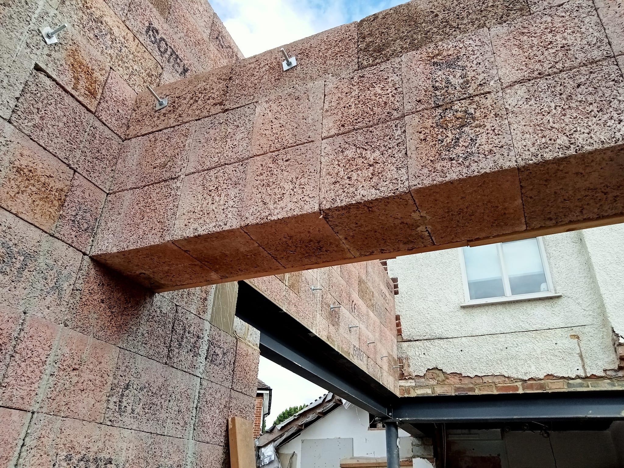

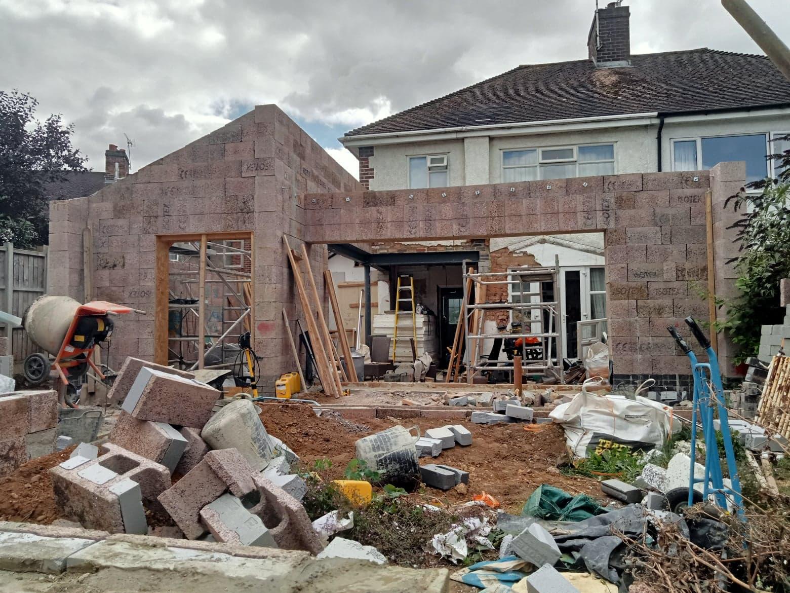

  1. This is part of our ISOTEX extension I have been working on, no real glitches. First time doing a build of this scale, its took me a year from groundworks til now.

    Huge afternoon, 4.9m Lintel beam *tick*

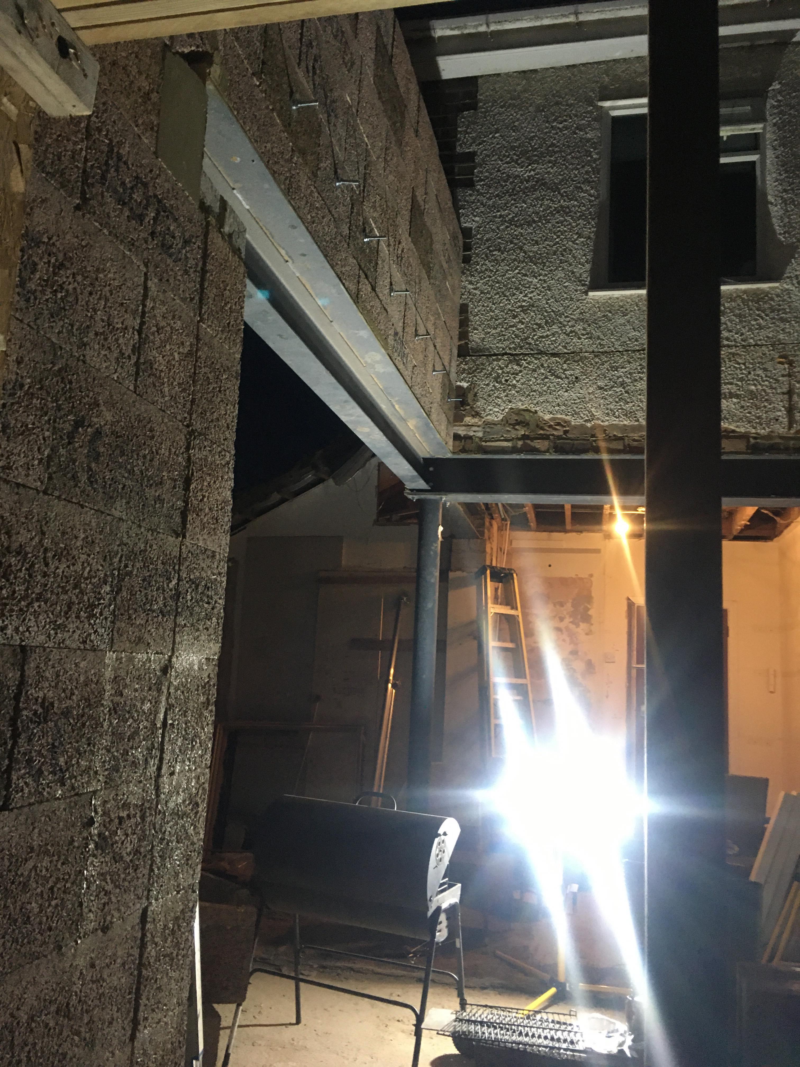

    bit hard to get a picture of the steel that made up the lintel, but it is in there!

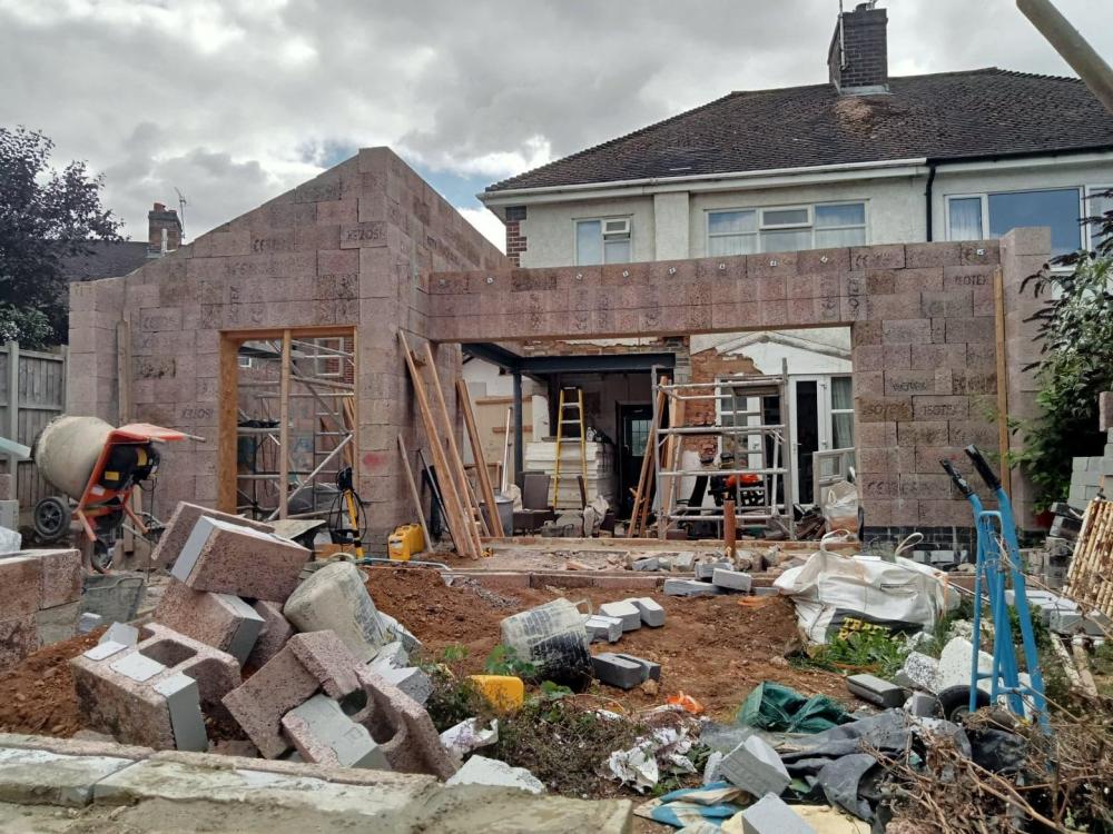

    Feels like we are making good progress once again

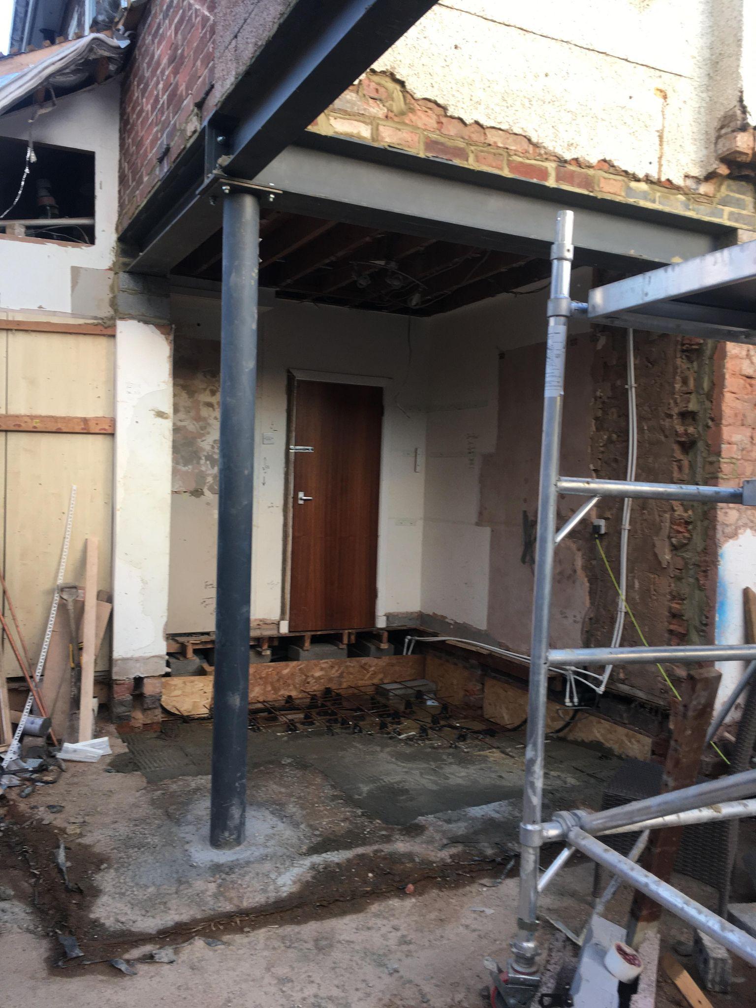

  11. steels in...passed off by BC too
