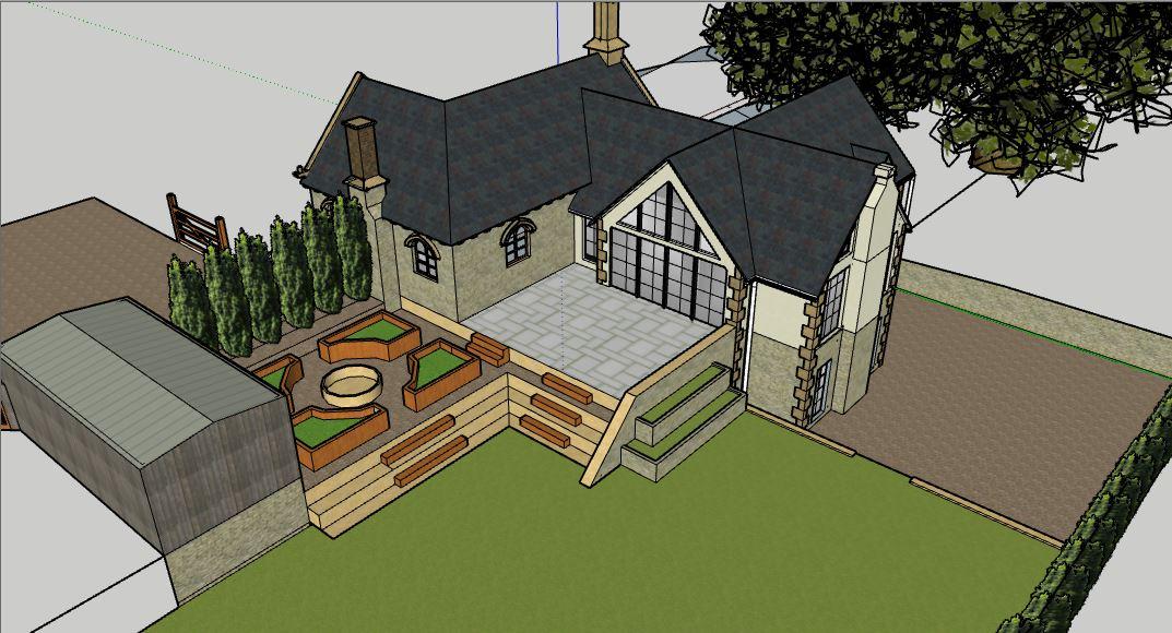

  9. Presto! I've attached some really rough Sketchup screenshots from the last time I played with the external landscaping to give you an idea of the level change...
  10. The reason i didn't really do a great deal of investigation was because the new extension will be lower than the current septic tank soil pipe run, and hence we would have to look into pumping sewage up a story. If we bite the bullet and re locate it to the other side of the garden, it can be sited lower and remain gravity fed, whilst also be upgraded to a sewage treatment plant and hence not have any issues in the future should we ever decide to sell.
