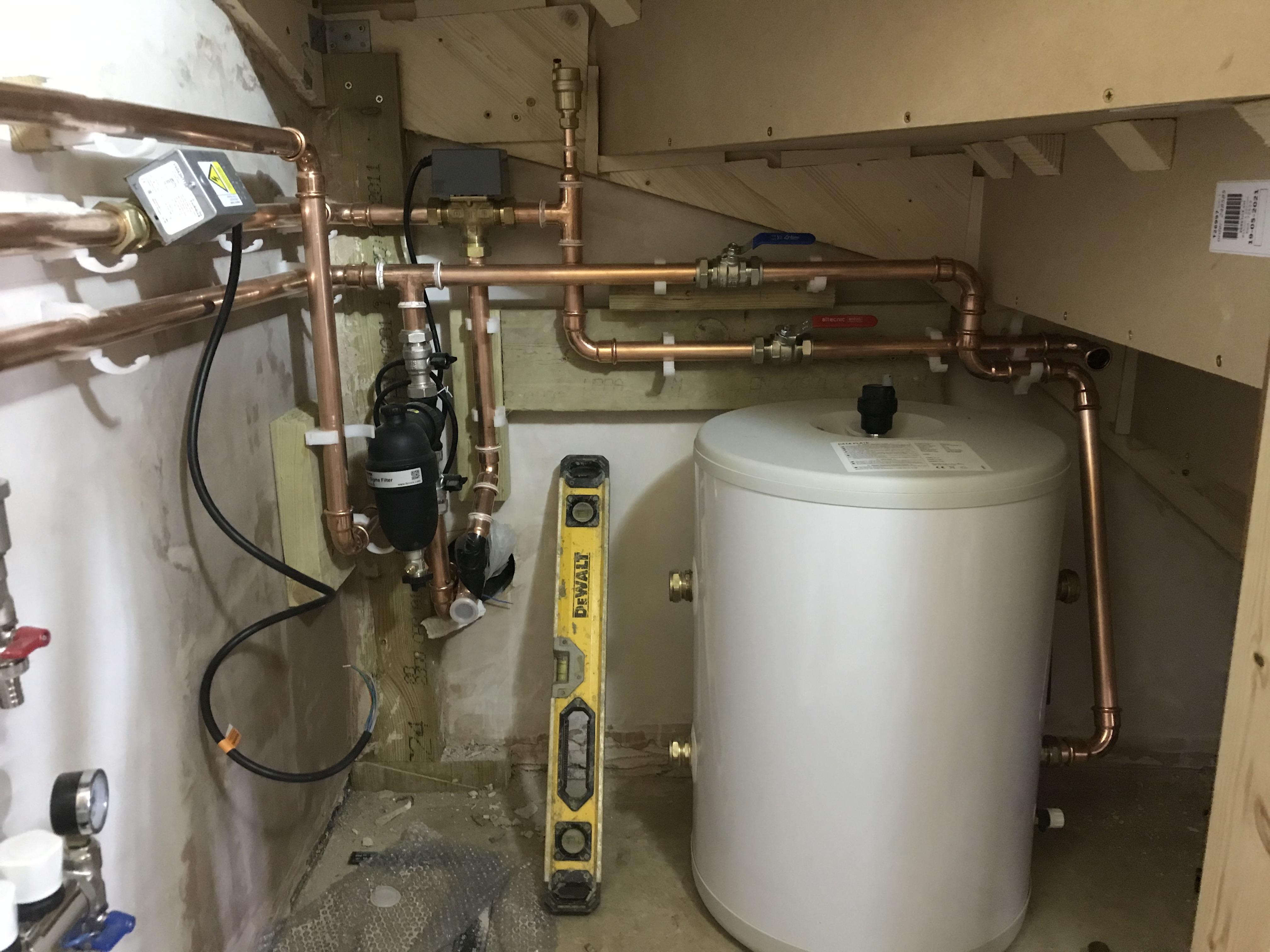

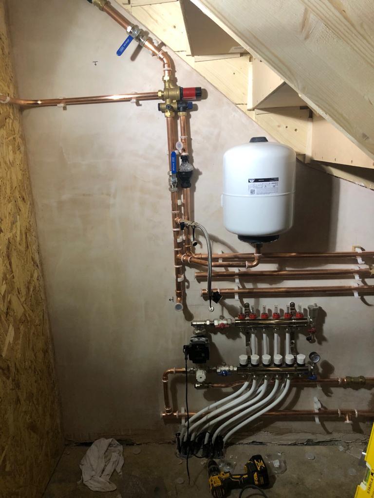

  4. Hi Triassic! Touch wood so far so good...since my last update, I have also fitted the armaflex pipe lagging in 9mm in line with Peter's advice, and tested out the two relief valves to ensure that I didn't get any splash back out of the tundish (running 22 >28mm Tundish which is a fair size). I've wired it all in and gone through the set up / commissioning procedure which was fairly painless; the one area which wasn't as per the manual was the 3 way valve wiring; I found that it needs both white and grey wires connected to a single terminal on the ASHP motherboard. I've also run a contactor to take the no voltage short circuit from the high limit stat (UVC) to the ASHP which wasn't explained either. The only thing I'm not terribly keen on is the fact that the 2 way motorised valve which is down stream of the 3 way valve on the Hot water side and in line with the high limit stat is always energised, however was told this is the done thing!
  5. The D2 run to the right is 2 metres to the termination point by the way!
  6. Thanks! I had to squeeze it in up there due to being tight on the 300mm pipe on D2...Thought about another Tundish...will look into it again Interesting that it's BREGs requirement...does that include the Central heating side or just downstream of 3 way valve to UVC (& back)? Tundish currently runs out near the flow and return of the HP, and will terminate above ground in some form of cage (adjacent to the ASHP). The tundish is 22 -> 28mm, and I just managed to get away with the 300mm straight pipe for D2 before going off to the right.

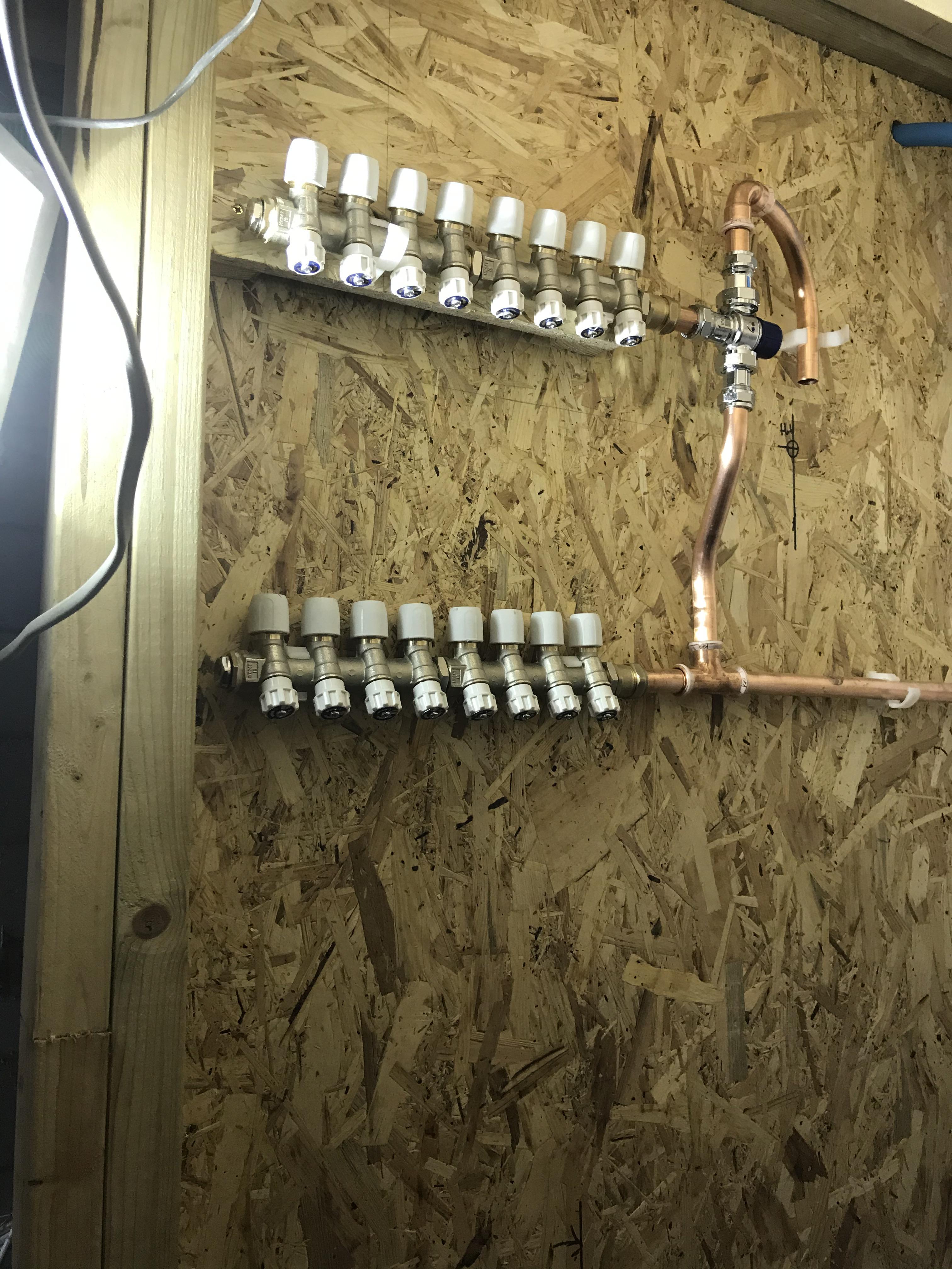

  7. Thanks! Things get a little busier once the UVC comes in! Thanks Peter - I was thinking worst case scenario would be that I insulate just the flow runs? All the pipework is within the thermal envelope of the building if it helps...would be it a show stopper if half of the pipework was uninsulated? All cold water pipes go upwards, but I've stepped the hot water manifold outwards above it so that I can slot the cold water pipes underneath without too much fuss; taking my inspiration of a photo shared on here a while back Photo added of 250L UVC in the picture to give some perspective on that side of things!
  8. I managed to make a start on the plumbing this weekend after having put it off for a while - I sourced the wrong type of pressing jaws for my Novopress gun, so all joints are currently loose (and more importantly can be taken apart again if I've missed something!). Comments welcome!

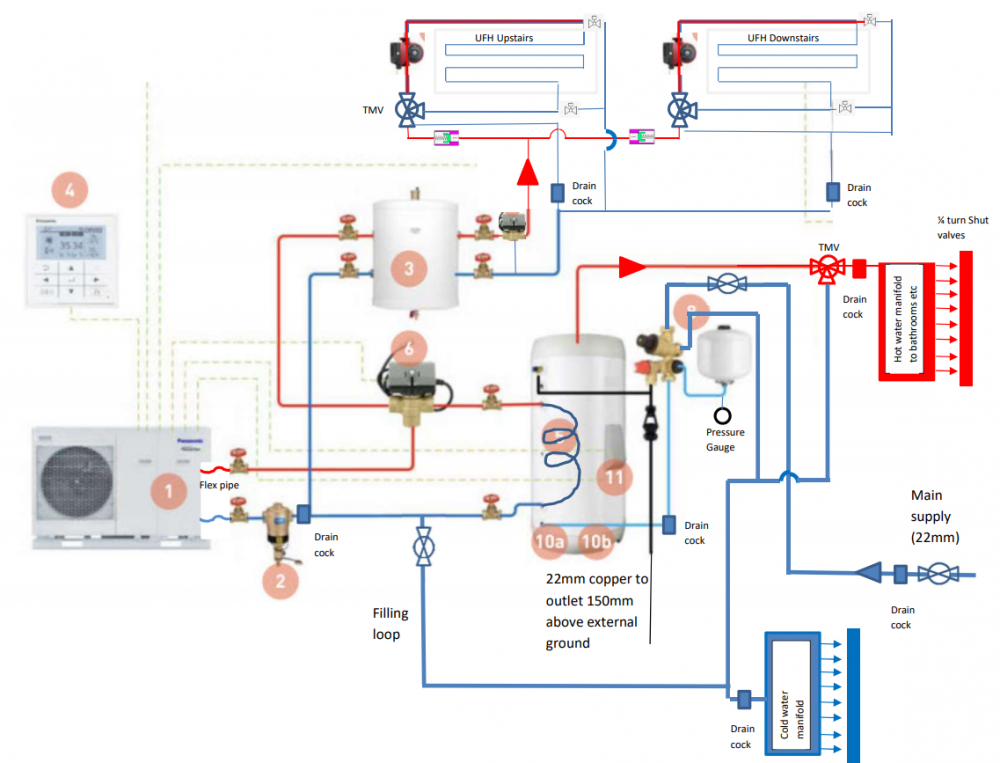

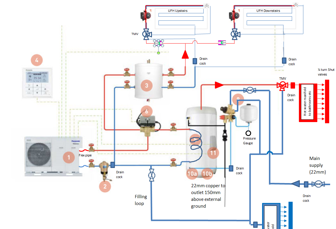

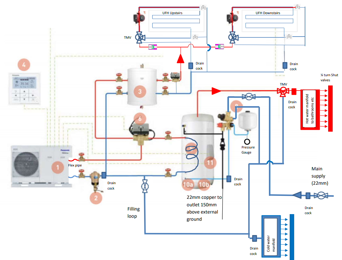

  9. Morning Pete, How had you gotten on with your install? I'm just about to embark on a similar process with my TCAP (9kW), and thought I'd share my thoughts having read through the latest 2021 Pan installation manual and spoken to Secon Solar. In a nutshell, they have advised to treat the central heating side of the system as two separate parts. On the HP side, we connect the 3 port valve, UVC stat & immersion heater. These will allow the HP to switch between DHW and CH, control to UVC tank temp and water flow temperature for the CH side which feeds into the buffer tank (which is the critical part of this approach). My understanding is that we will then call on that buffer tank 'heat' when needed through the wiring centre; UFH pumps, room stats will be hooked up to this side, and operate as a seperate entity (i.e. no connection to the HP). Presumably when UFH (in my case) fires up as the thermostats 'asks' for heat, this will begin to draw heat off the buffer tank, which in turn sets off the HP to regain that heat in the buffer eventually. Thoughts?

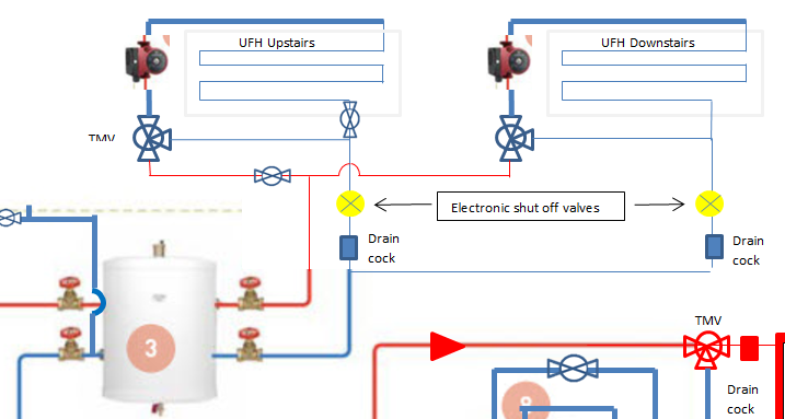

  10. Interesting! I'll need to pull up the lengths of my UFH across both floors, but from memory the fluid volume was ~100L. I wonder if there would be any knock on affects from daisy chaining one manifold to another on split levels...worth some thought if you were able to get the right fittings to connect from one end of a flow rail to the second... In all honesty I was meant to, but it fell off the quote due to budget constraints...do you reckon it is worth having? I intend on doing the entire commissioning of the ASHP and what not myself, so having a hand of God in the form of someone from Panasonic being able to remote in and access settings could ease the pressure. Did you look at shop soiled items? I got my UVC with some slight scratching for around £200 cheaper, still under warranty etc. I believe both UVC and buffer tank came in at £900ish +VAT.
  11. Purchased the bare cylinder, primarily to offer me slightly greater freedom in packaging it under my staircase...if I had the luxury of a pump room, I would have loved the pre plumbed solution! With regards to the single manifold for both floors, it did cross my mind...I wasn't sure if a single pump was man enough for the entire set of runs, and I think I aired on the side of caution...thoughts?

  14. Thanks Pete! I originally had one drawn in but I removed it as there is one inbuilt in the Pan ASHP which caters for up to 200L (part of the reason why I went with the Panasonic unit as I'm so tight on space!). Was initially going with Ecodan but this swayed it for me!
  15. Morning Nick, Thanks for the reply! I’ve re-read your post a few times now to let it settle in, but I don’t think I’m fully there yet with my understanding (pardon my ignorance!). Current grey areas: What is a 2 tapping version – does this imply single inlet and outlet off the tank, rather than the Panasonic supplied 2 inlet / 2 outlet version that I have bought (PAW-BTANK50L) Secondary pump – if my understanding is correct, this is only needed in this alternative ‘circulation mode’ when wanting to even out floor temps, and hence the inbuilt pump in the ASHP would not play any part. Would the risk of not having this secondary pump be that I couldn’t guarantee circulation between buffer tank and UFH manifolds? Would there be any other risks? I’m not sure what size an additional 2 pipe buffer would be, but I am very tight on packaging under the stairs unfortunately…would there be any benefit in running a simple bypass across the flow and return buffer tank with a 3 way switch (non-Mid switch) which I’ve temporarily drawn on my cobbled together schematic? Good point re. condensation bomb – at present I’m not planning to run the ASHP in cooling mode at any stage, but part of me would want to future proof the system in the event things get a lot hotter than I expected? Part of me wants – would a by-pass in parallel with the buffer tank potentially work, or would the ASHP complain about flow rates given that I’ve removed that hydraulic separation between ASHP and my UFH system? I’m expected my UFH volume to be in the order of 100L without buffer. What would be the main purpose of the auto by pass valves be – if I’ve understood correctly these will bypass to an alternative flow path after a critical pressure is reached? Are these at all aimed at softening any of the transients in the system when valves are opening and closing, or have I missed the mark? Whilst on the subject of transients, if my memory serves me correctly, did we say to avoid NO valves as these create quite a large water hammer? Sorry again for my terrible schematic. For reference the buffer and lower ground level manifold will both be located under the stairs (within a meter of one another), whilst the upper level UFH manifold will be an approx. 2-3metre run up the wall and into the living room above. If I can help it, I'd also like to avoid having to incorporate a smart home automation system to control it all as I am trying my best to keep it as simple / straightforward as possible!
  16. Thanks! What were your thoughts on the flow path if a zone valve wasn't present on either inlet or outlet and the pumps were fired up? Would the UFH loops still circulate?

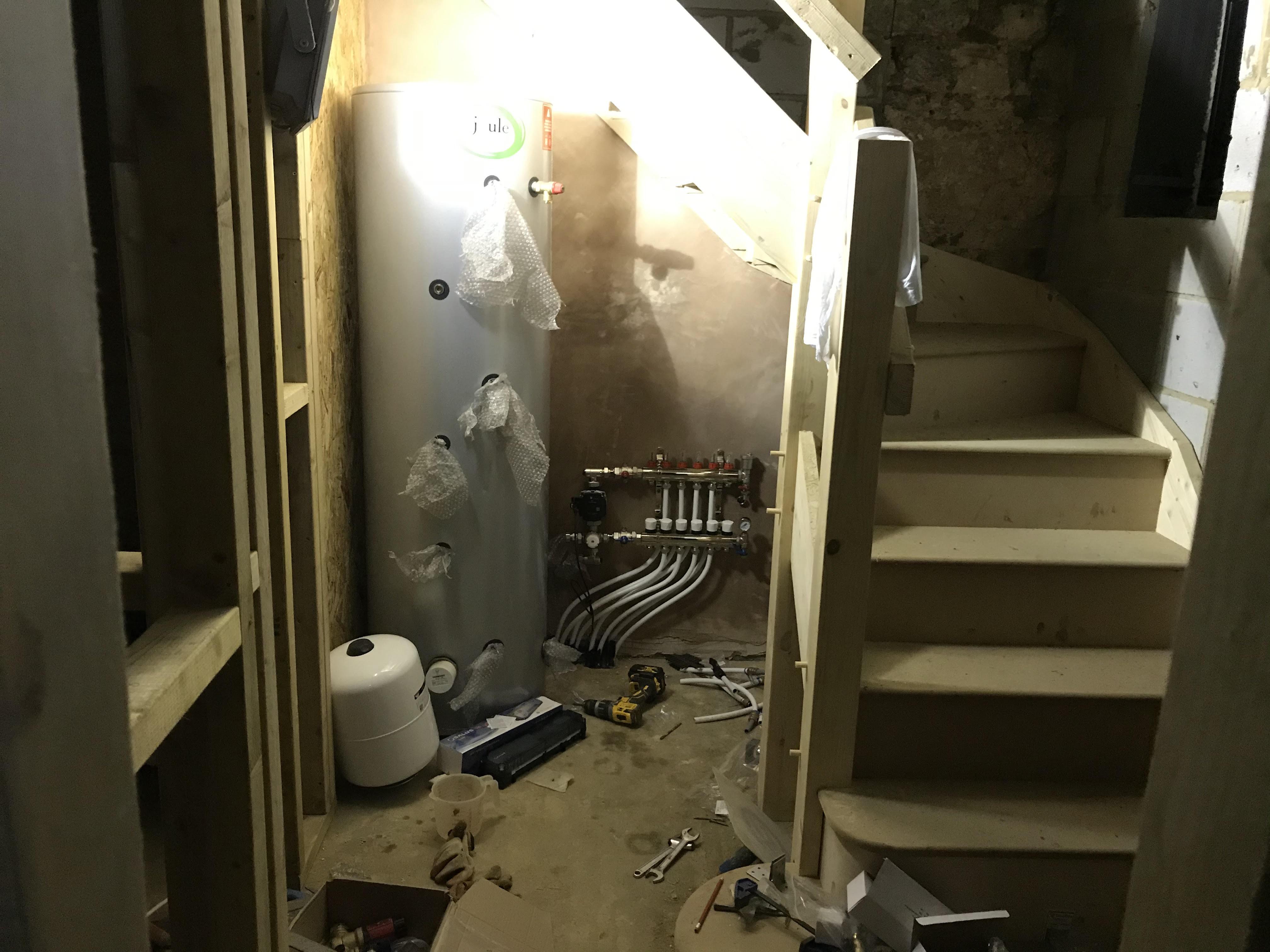

  19. Evening All, I've finally received all my central heating components (ASHP, Buffer tank, UFH pipework, Manifolds, UVC etc etc) and am wondering how best to tackle the next phase... I'm planning to install the UVC, buffer tank & UFH manifold for that level under the staircase (which isn't there yet), and depending on how snug I can get it all to fit whilst still being accessible, will then dictate where my stud partition wall to my bathroom will end up (I will be gluing down the sole plates so hopefully this should not impact UFH layout too much). My dilemma comes as follows: The floor still needs to be screeded and UFH pipes laid - precise positioning of UFH manifold will be established once I can get UVC etc in place for a dry run on packaging overhead The stairs can then go in once the floor is screeded, or alternative installed before hand and packed to the FFL height and then unpacked and suspended for the day of screeding (unless the moisture is likely to damage it?) I've read some posts where gentle UFH some time after screeding will greatly help with drying times (implying heating is up and running by the screeding stage) I could mount buffer tank and all central heating pipework to the wall under the staircase to avoid them having any impact on screeding, however the wall in question is still currently bare blockwork I could wet plaster or D&D the wall prior to fitting buffer tank and corresponding pipework, however must ensure plaster ends approx. 20mm above FFL? Based on the above thought process...would it be wisest to -> wet plaster (or possible D&D) wall -> install buffer tank / pipework, plumb in central heating (minus UVC) -> lay insulation, UFH & screed -> install staircase -> install UVC and fire system up (bearing in mind G3 checks etc)? Whilst also on the subject of plumbing and screeding... to complicate matters, I will have 2 bathrooms on this ground floor level (upside down house), and am wondering whether there would be any harm in shuttering the shower tray areas prior to screeding to provide greater flexibility on waste pipe layout / tray height. If I later opt for a raised tray, I could simply fill in these areas or would this be frowned upon due to breaking the continuous layer and creating a flush joint?
