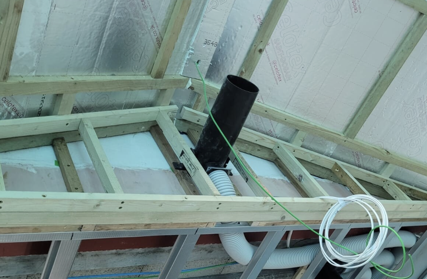

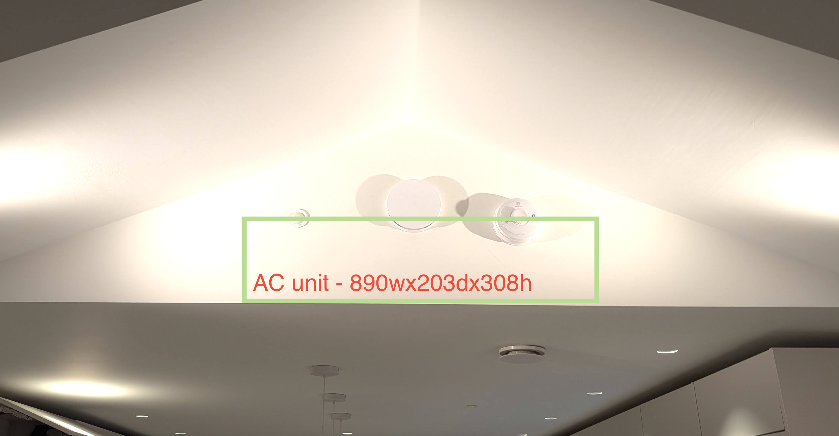

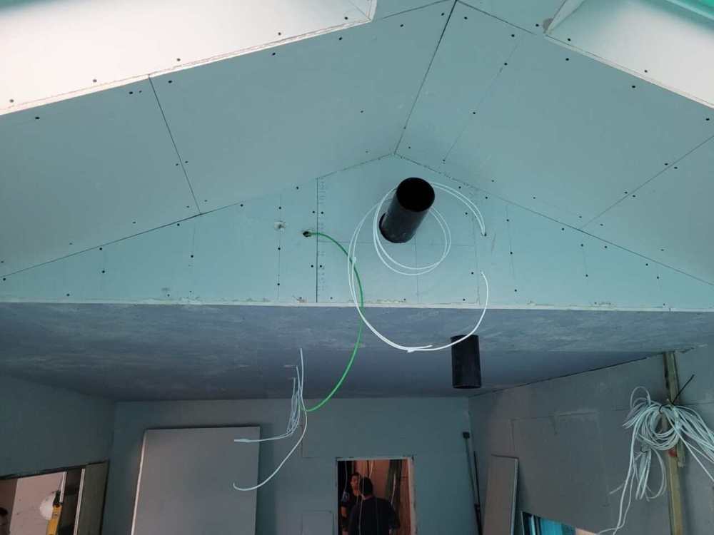

A small update: The AC guy will draw an outline of AC location and put pipes to it. Carpenter will come in to raise the pipe, possibly needs to lengthen it AC guy claims he can align some (but not all) loadbearing screws to the actual frame, and drive a few screws into plasterboard as mild support. But I think maybe I should just let my carpenter reinforce the frame (with noggins/plywood) behind the AC and then put plasterboard back for the AC guys to attach final thing -

This was my thinking too, the problem is the AC guy might not be skilled enough to do this on the spot. I'm wondering what he could do that is 'reasonable' I'm debating: A/ He could cut the AC shape out of the existing plasterboard, and fit it directly on the frame (incl a few noggins/plywood flush with the frame perhaps). And yes, raise the outlet. After that, perhaps skilled decorators can close the gaps between AC and existing/damaged plasterboard. B/ He could use a stud finder to find the frame without removing plasterboard, and somehow align the support of the AC with the frame. Basically how could an 'amateur carpenter, pro AC guy' do a good enough job that the skilled carpenters/decorators can make it all look nice - obviously one worry is that an f-gas installed unit can't just be briefly disconnected by carpenters to do work. -

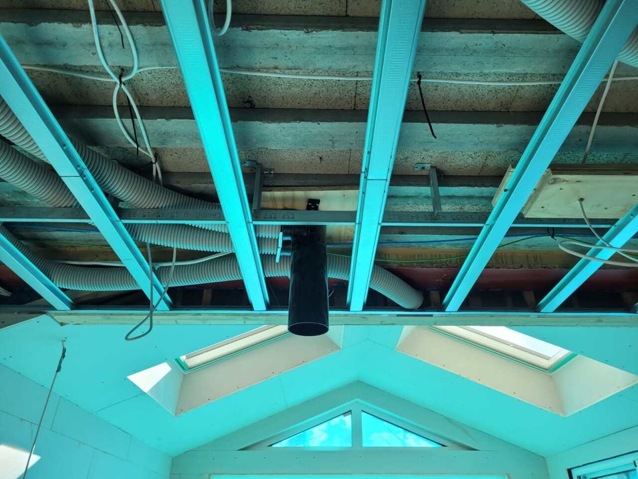

So I have a multi split outdoor AC unit, and can easily (...) add one more internal AC unit. So far so amazing. But, the perfect place to put the AC unit has two major issues: 1/ The AC unit is a bit too big, if I put the AC unit the lowest it can go, it would overlap the MVHR outlet by about 25%, assuming I change the current 'fancy, adjustable, sticky-outie' outlet with a flat grate. * a/ would overlapping the AC unit over perhaps 25-30% of the grate be an unacceptable hack? I suspect the amount of air it supplies would still be fine? * b/ I could move the air supply up, but it'd be quite the operation... 2/ This stud wall is not designed to hold an AC unit. * c/ Would you try to attach the AC unit to the frame (note the pipe is attached to the batons, but the frame in front should be fine to hold the 15kg) or * d/ Would you attach plywood to the frame, and then attach AC unit to it? (but that would mean redesigning the vent too..?) * e/ Would you attach the AC unit to the material behind the wooden frame? You'd need very VERY long screws/plugs, plus I'm not 100% sure the material behind can even hold plugs+screws that can hold 15kg.. I'm fairly sure there's a steel beam there One more pic of the buildup
Thanks @Redbeard and @Nickfromwales - so sorry I left this for a while./ The thing going through is a R32 AC pipe, which typically is perhaps 5cm diameter. Yes there's render, k-rend. My main problem is that now the house is effectively finished and we're retrofitting one more AC, they have only very little interest to come over.. they will, but "in their own good time" which could be ages from now. Should I perhaps just buy FM330 foam, spray the hell out of the hole the AC team leaves, and then hope someone comes in later and does it properly? My wall buildup is attached:

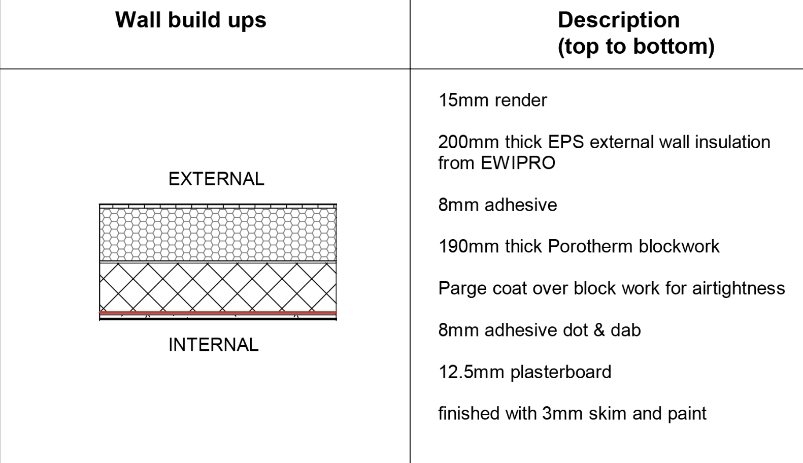

One of our passivhaus rooms is unexpectedly getting warmer than we hoped, and as such we will have to add one more fan coil unit. The challenge is that the aircon team isn't really well versed in passivhaus, so I'm trying to find a guide on how to drill a hole into a passivhaus wall and then sealing up the gaps left by having a hole with a pipe. To my understanding so far I have: - Pro Clima Tescon Sprimer Spray Primer - Orcon F - Passive Purple Airtight Liquid Vapour Control Membrane Spray - Contega Solido SL tape or (and?) Tescon No 1 tape And steps: 1/ Drill, clean drill site. 2/ Fix aircon pipe in place 3/ Fill large gaps with filler (orcon F?) 4/ Apply Primer 5/ Purple membrane spray (2 layers) 6/ Cure for 48 hours 7/ Tape with the Shingling method 8/ Rainscreen cladding somehow? To protect the tape? 9/ Perhaps finish for visuals? Is the above correct? I'm especially fuzzy what it looks like when an outdoor wall (with its render?) has a bunch of tape stuck to it? Or is there some way to eg apply render over all this?

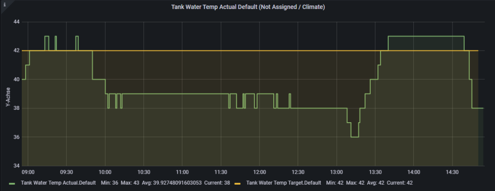

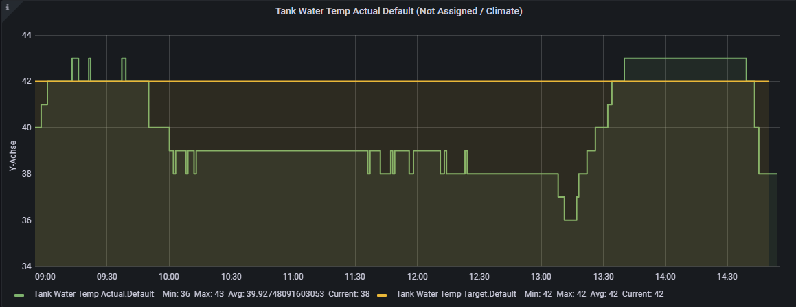

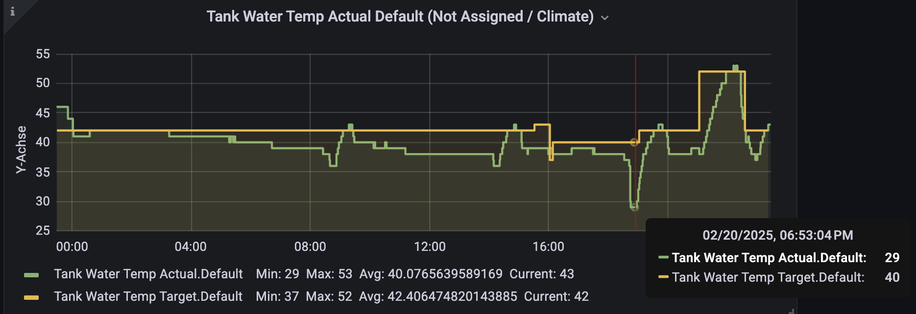

Just for clarification, I'm still tweaking my tank and heating etc. Of course (?) 37 is not my normal target temperature, for indeed just comfort, but also legionella reasons. Instead I have pretty close control over the target temperature, as indicated in yellow, vs the actual temperature, where indeed at 18:15 my kid showered, and at 23:00 two adults showered. The point of the curve was to raise the temp a little before 16:00 (elec is expensive between 16:00 and 19:00) to just have enough for that one shower), and let it cool a good amount between 0000 and 1600. even though the exact shape of the curve isn't right yet, the drop for my kid's shower was more than I expected, but as @JohnMo noted, perhaps it isn't incorrect or behaving poorly, it's just a lot of water that might not be as hot on average as I'm expecting. -
So my current tank is 400L. Pretty sizeable! Yet when it starts at 37C, having one shower on, drops the measured temperature down to 29 in 5 minutes. Is that normal, or could there be something plumbed wrong? To be clear: - I know 37C is pretty low to start with, it was semi-intentional (I figured leave it cool a bit during the expensive period) - Because 37 is already low, the shower user (my kid) probably tried to set it to max temp, so no other water mixed in. - The temp sensor is halfway up the tank, so presumably there's hotter water above the sensor, yet the kid complained the water was (slightly) too cold indeed after 5 minutes. Is this about within expectations? Of course the ideal tank temp is perhaps more like 53-55 (or way higher if gas-heated, 65?) but I still feel that having 400L of 37C water should.. in theory.. last a pretty long while - 12L/minute, so maybe we lost (and replaced with cold water) 60-100L over those 5 mins...

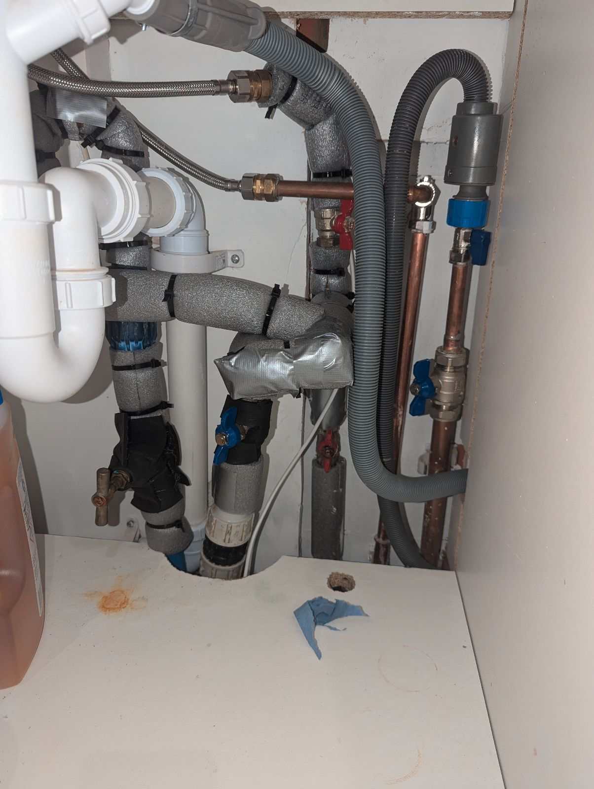

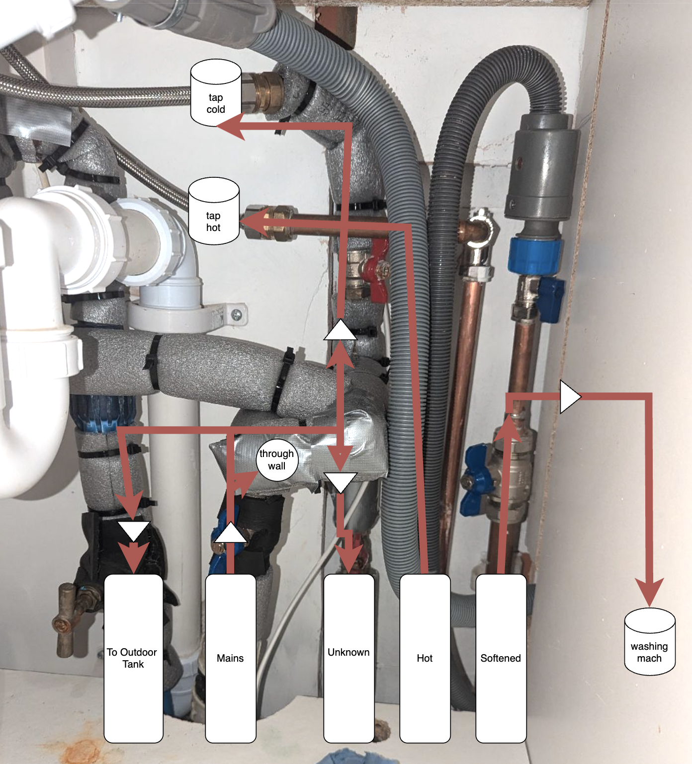

I was wondering about this. Maybe it always leaked rather than that there ever was major condensation... Yea, so currently they are actually leaking, and they need to fix a mistake (they connected mains to our utility sink, we want softened there) so now's as good a time as any to demand them to re-do it, or is that too much? -

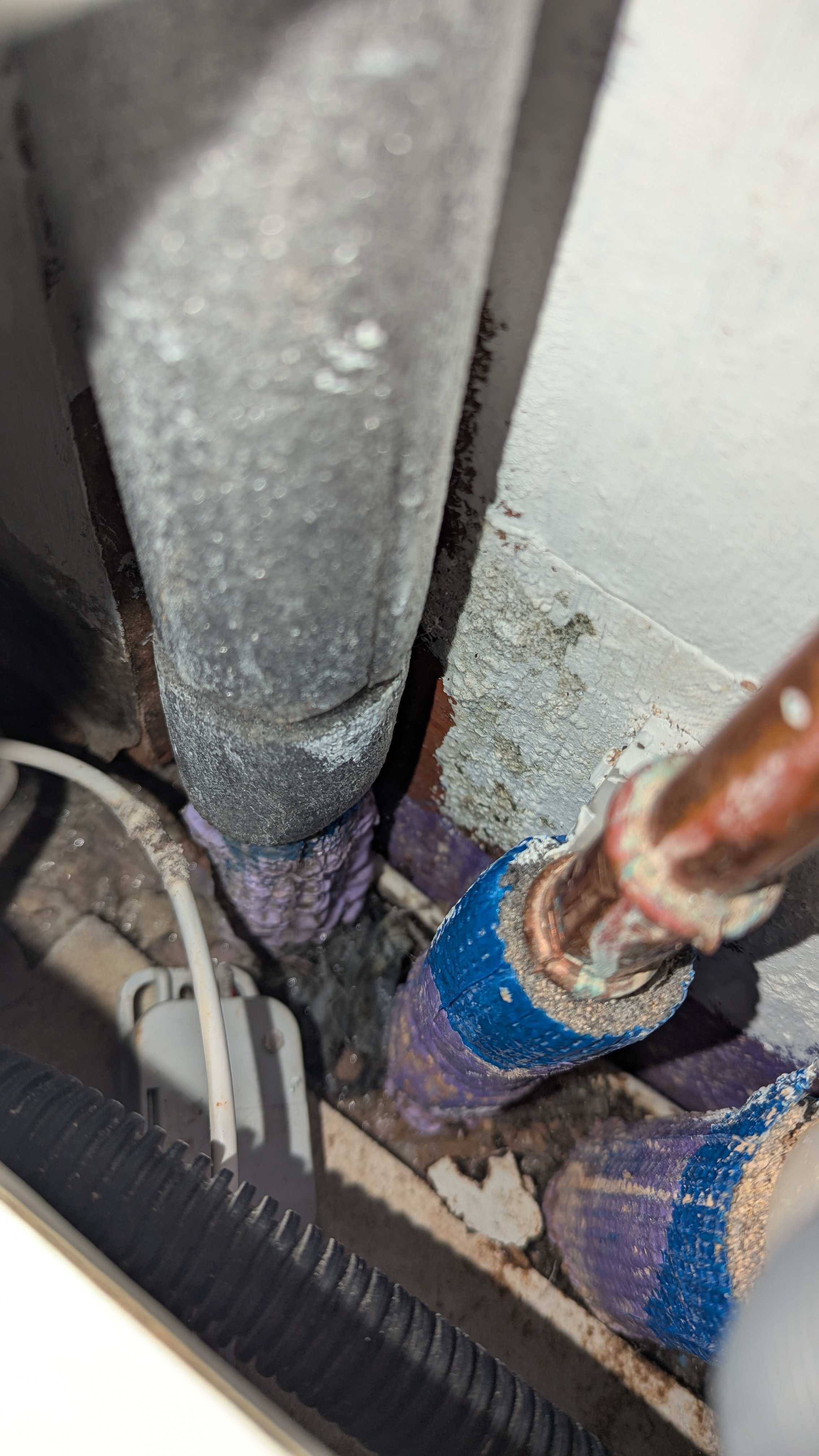

Nah the stain is 'ok' (clearly damage but not a worry). I'm looking more at this: with paint peeling away (and mould?), and the pipe itself also looking a little... warty. One very important thing I believe is more psychological than anything - as renters you simply never look critically at 'service areas' - the understair cupboard, the meter closet etc. As a homeowner with a new build I'm thinking should I be picky about pipes that are 'working fine' but a bit grotty looking? We can hide this view behind a cupboard thing and ta-daa.. but I also (esp. with water dripping deep into the house stuff like I mentioned) worry that bad visuals translate to problems down the line? -

Oh like you said, just saying that the condensation all comes from metal (like you said probably copper, or maybe aluminium?) and plastic (edpm? pvc?) will not condensate but might break sooner? Or is that a myth? -

Good, that's comforting, although indeed water or soaking the concrete in my foundation .. problem? I think the important part is that MDPE/plastic is "fine" but my pipes seem to be metal-y. Metal is more sturdy, plastic is less drippy? I've been told that the risk with plastic-y pipes is that they will crack at some point. True? -
The plumbing under my sink has been an absolute headache since forever, this is a new house, and a picture of the current state is below (at the bottom an illustration of what's what.) My problem, there have been a few leaks, water has certainly dripped past the pipes, probably into the foundation of the house. Perhaps not a *ton* but probably at least 20 litres. Also the site is really continuously damp, condensation from mains that will go straight back down into the foundation where mains comes from Potential problems: Some good amount of liters of water with no 'obvious' place to go, sitting under house somewhere? Or is that totally fine, or are foundations perhaps designed to get rid of water over time? Damp pipes - the builder claims the cold mains is impossible to completely lag to prevent condensation, but I'm concerned the pipes embedded in my foundation will rust and at some point burst on me? Not sure how you would fix basically a burst mains somewhere below the house... Thoughts? Frankly I think a proper plumber needs to redo this entirely. My question, how would you do this better? Given there's so many valves, as an amateur I would probably use something like this - https://www.reliancevalves.com/gb/en/products/flow-control/plumbing-strainers-flow-regulators-manifolds/potable-water-manifolds Or perhaps this would constrain mains too much so keep the 'main bend' into the wall intact but do all the undersink work with a manifold like this? Given that there is a current leak (the valve to 'unknown' is probably damaged) is dripping, perhaps this is a great moment to redo it all? Or is the current state not that unreasonable and I'm just imagining things? Note there's an invisible-in-this-pic bend right above the mains that goes through the wall, which is really the main inlet to the rest of the house (buffer, softener etc is on other side of the wall). I actually don't know what the pipe right next to the mains does.. embarassing
