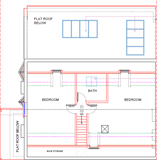

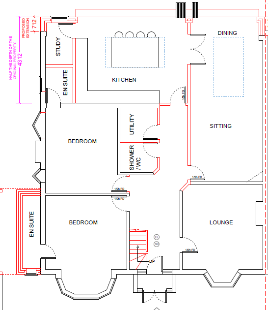

Hi All, I am please to inform that after months of discussion with the planners we have managed to get the planning permission. There are some alterations to the original design although we are somewhat happy!! I have some questions if someone can help please: For the extension are we able to use the insulated raft foundation as this is clay soil and we do have trees nearby? For the existing house how best to insulate it? We want underfloor heating (how much insulation should we get for the original property? For loft how best to insulate it? Rockwool between rafters and kingspan board on? and how much insulation will be enough? Do we install MVHR system? Do we install solar panels (in-roof ones if we can get planning for these)? Thanks in advance. Shah

Yes good point. I could workout what to do with this area in the middle So could effectively swap the two although it may not be as quite next to the kitchen... Any feedback on the ensuite for the Bedroom at the front? Loft design? Thanks

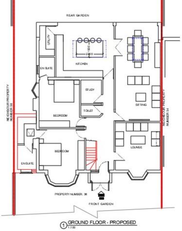

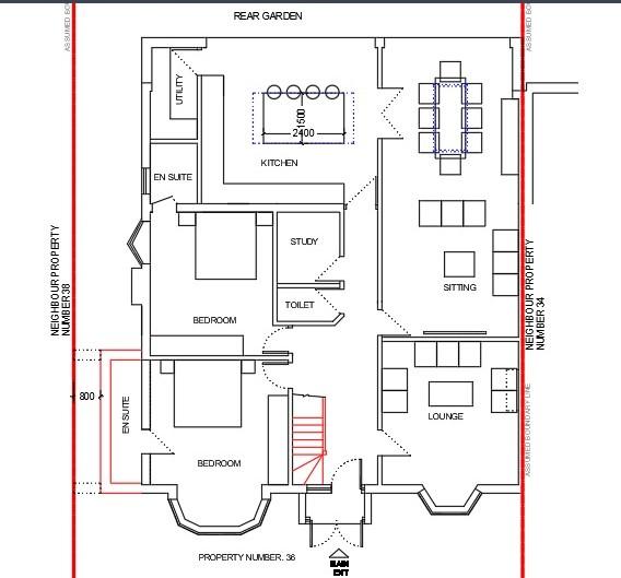

Got some redesign done. Please let me know what do you think. Ground floor has two designs (which one do you guys think is better). Is there a way to improve on this design? Thanks, Shah.

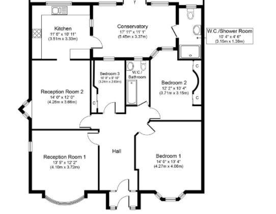

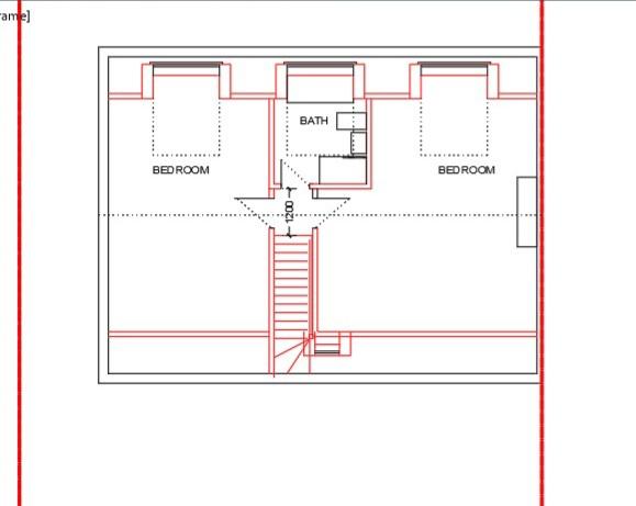

Hi All, I have embarked on a new project. Please help me in redesigning the bungalow. The bungalow is in a conservation area so any outside changes will have to be agreed/approved (will apply for planning permission). We are looking to convert the loft as well as redesign the current layout. I have attached the current layout below. Total area is about 125sqm. The aim is to have 2 main bedroom (with ensuite if possible) and 1 study/bedroom on the ground floor. Kitchen (plus utility/plant room) and two receptions. 2 bedroom and a bathroom in the loft. This is quite an initial stage so looking for some ideas and what should be added i.e. should I look at MVHR system, underfloor heating any thoughts on other modern electricals/gadgets to add or not to add, wood flooring or tiling etc etc. Thanks, Shah.

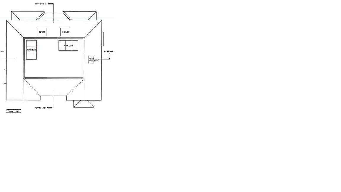

Cost of Hipped Roof with gable and flat top
Shah replied to Shah's topic in Roofing, Tiling & Slating
Thanks Peter, Yes idea is to use attic space. 25 to 30 years is a long term and I don't think anyone will be walking on the flat roof Well I am just trying to get an estimate or an idea which roof structure is easier to build and maintain as well as what are the cost implications as I like the house design. -
Yes I see. How complex is this roof structure and how easy is the long term maintenance for such a roof? -
Thank you Peter. So what do you mean 3 sided flat roof? How would that work? -

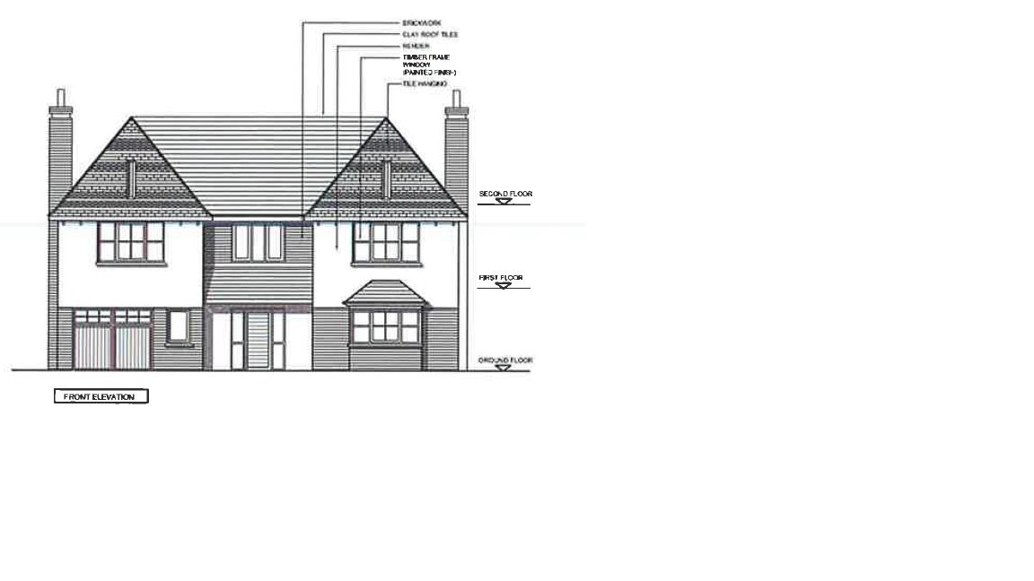

Hello All, I have been trying to find cost for a hipped roof with gables to the front and flat at the top (middle section) with no luck. Attached some drawings. Are you able to help? Also what would be pros and cons of such a roof. Thanks, Shah.
