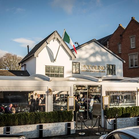

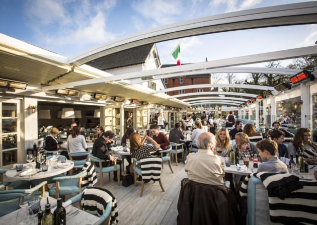

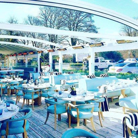

  18. Hi all, I apologise if this isn't in the correct area but I need some advise on the type of roof system used at Piccolino in Alderley edge. It's a retractable system but its very modern and not just a general slide across roof (at least not how it looks). Does anyone know anything about the design or mechanics of this? I am a part of a project where the owner is keen to include a similar design as he is trying to keep part of the existing roof for character, so something like this would work perfect. It's a long shot and not an easy question to answer, but any help is valuable. I've attached a few images to show what I'm on about. However, I can't show images of our current project as requested. Many thanks, E
