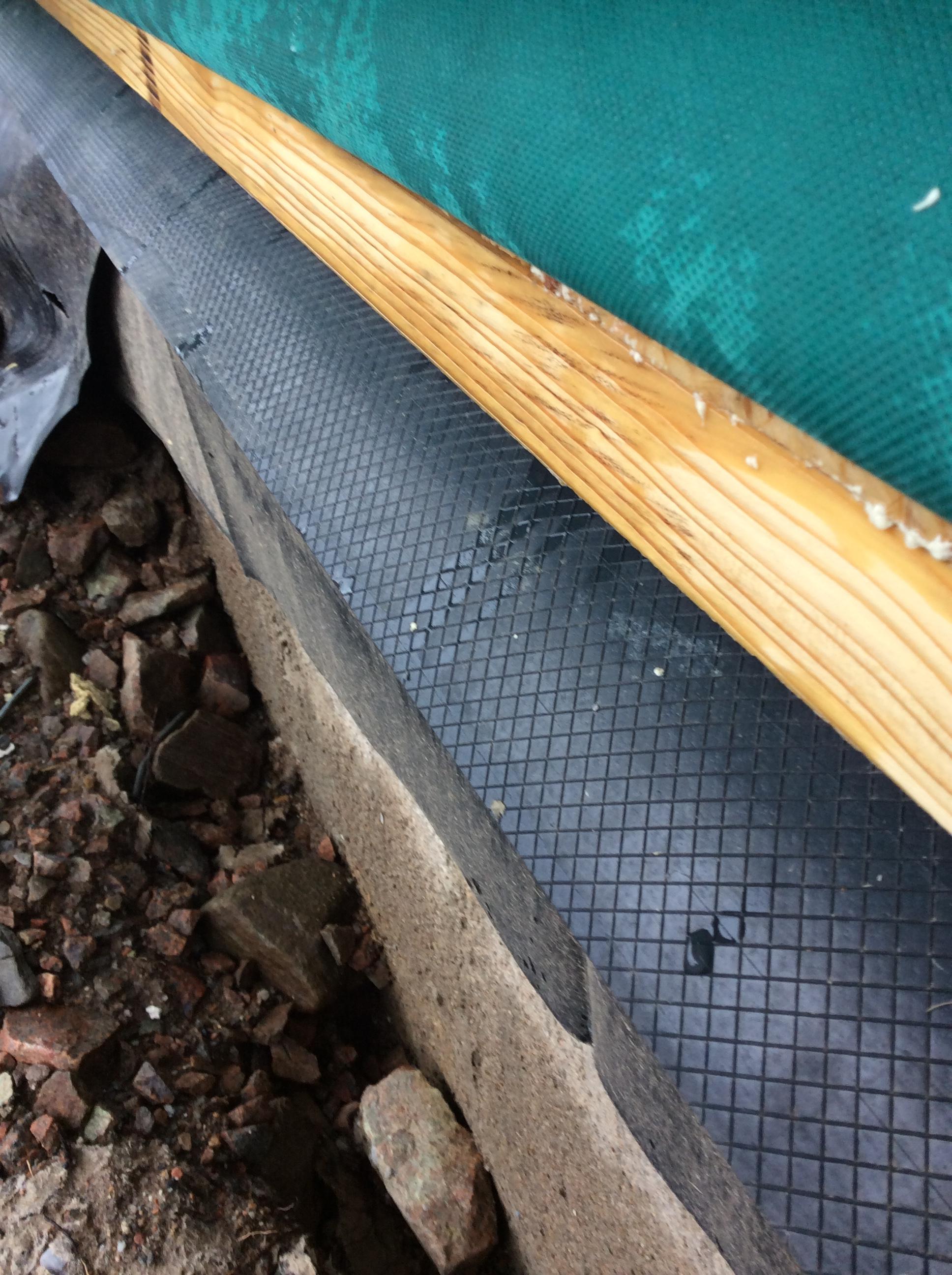

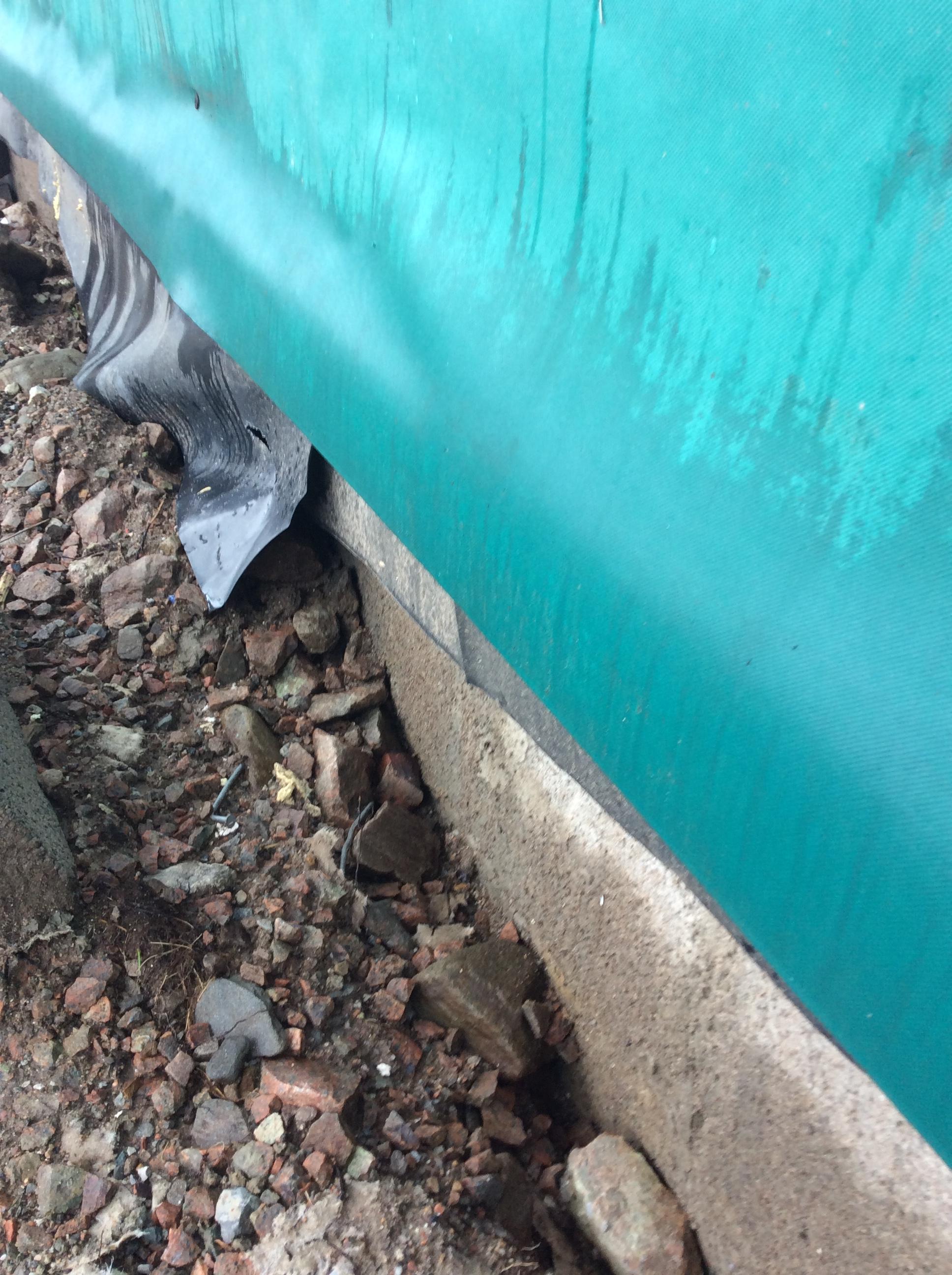

Hi All, First real post so be gentle please! our frame is up now and the sips company have left site and it’s all up to me now. We’ve had quite a lot of wet weather up here in the NW Highlands and I’ve got concerns about the water that is coming in between the sole plate and the dpc. The amount of dpc overhang to me is excessive and was wondering how much to trim it back to. I’ve still to clad the outside so am expecting some water to run down the outside but I am in the dark about this point. Also how far should the breather membrane (FrameShield 100) hang down to as it is getting saturated sitting on the dpc overhang Heres hoping for some help.
