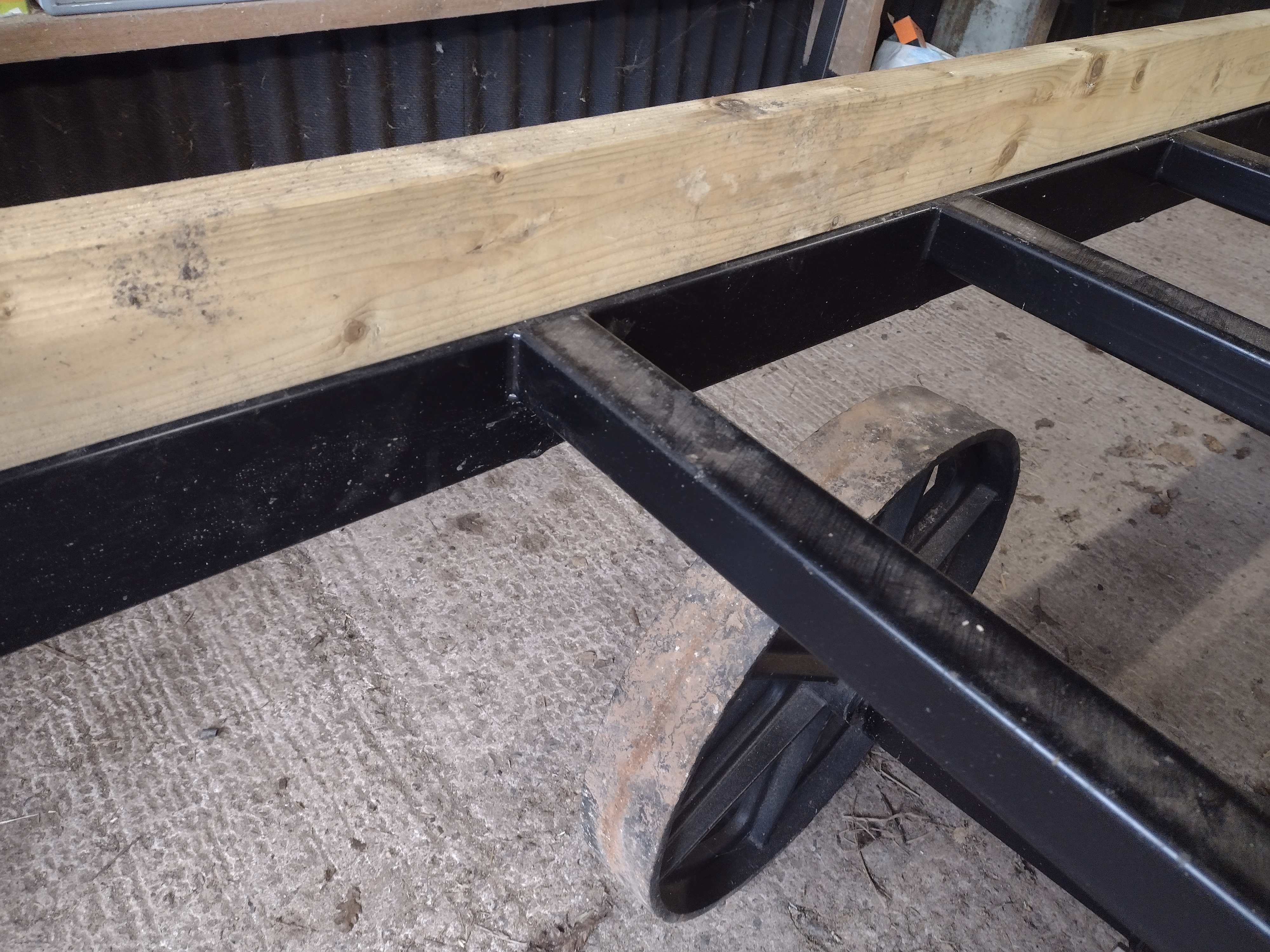

So my Shepherds hut build is stalling a little regarding the floor, I have sorted the mould problem on my plywood to be used on the floor but this has got me thinking how to I prevent further mould when the hut is built and out in the field. I am also concerned about rodents eg mice and rats being a problem entering the space from underneath and causing damage eating insulation and wood. Looking around on youtube I see a lot of Shepherd hut builds have a timber frame floor with plywood attached to the bottom and top of the frame, however my floor frame has only plywood on top with a some kingspan insulation underneath this as pictured. I could double the thickness of the insulation if needed as I have more kingspan boards.
My plan is to use some weld mesh below the kingspan insulation to prevent the rodent problem, but what about mould problems further down the line regarding the floor? I am really worried (rightly or wrongly) about the plywood rotting as it will be quite exposed to the air with it being only a single sheet. I have painted the side facing down to help with this worry but should i put a damp proof barrier below the plywood as well? This would mean the layers of materials from nearest the ground upwards would be as follows: weld mesh, 2.5cm thick kingspan insulation board, damp proof barrier, plywwod and then the interior tongue and groove flooring (yet to be purchased). Does this seem ok? Or is the damp proof barrier not a good idea? I ask as would it trap moisture and cause the problem I am trying to prevent?
