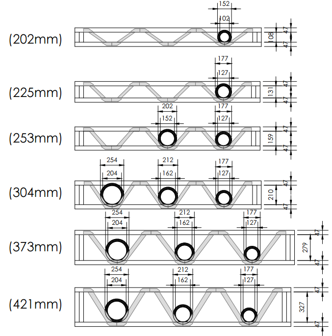

  7. Hi All and Happy New Year! I've been going through Building Control queries to my recent application and came across fire separation between the house and adjoining garage. There will be a connectiond door: FD30 with self closer, that's all fine. It's an MBC timber frame and insulated raft foundation - MBC will install waste pop ups and services ducts through the slab. I would like bring the electrical cable from an outside wall meter cupboard into a consumer unit in the utility. And also run pipes from an ASHP outside via the garage, into the house and to a utility space. I'm proposing this detail below, but would appreciate some feedback on the duct (depth and radius suitability for pipework and cables) and suggestions on how to maintain 30 minute fire separation between the house and garage. Any thoughts?

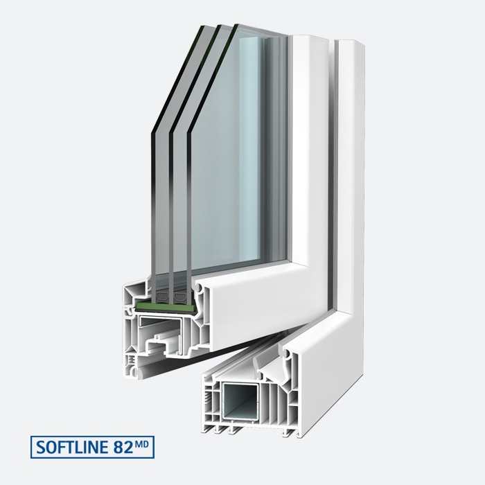

  13. So, we decided to go with MBC for frame, insulated raft and Rationel windows. They have been so helpful after Scotframe pulled out and I now feel it was meant to be. We completed on our plot purchase yesterday after 3 years of solicitors buggering about so celebrating tonight! Hopefully breaking ground in February.
