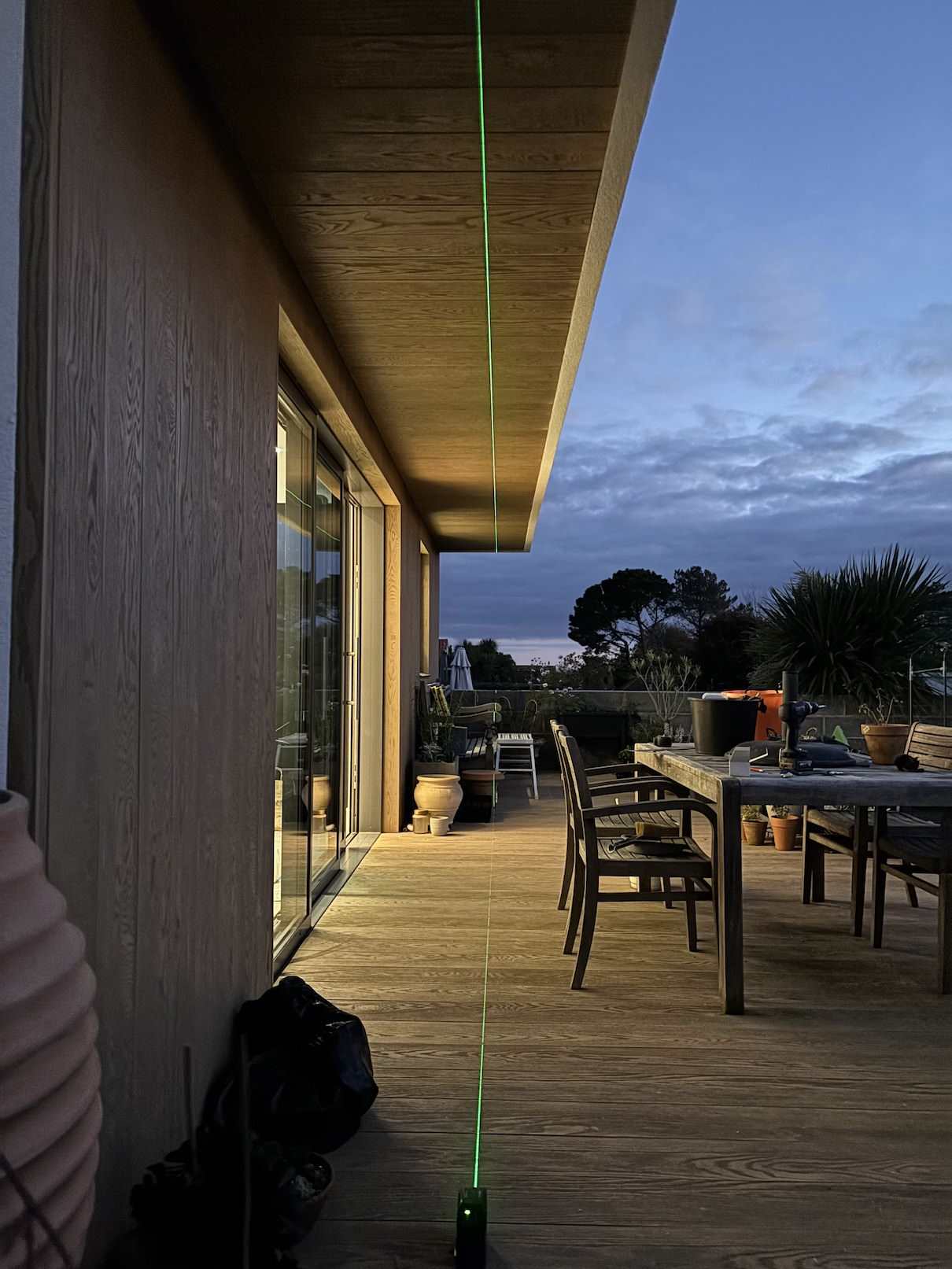

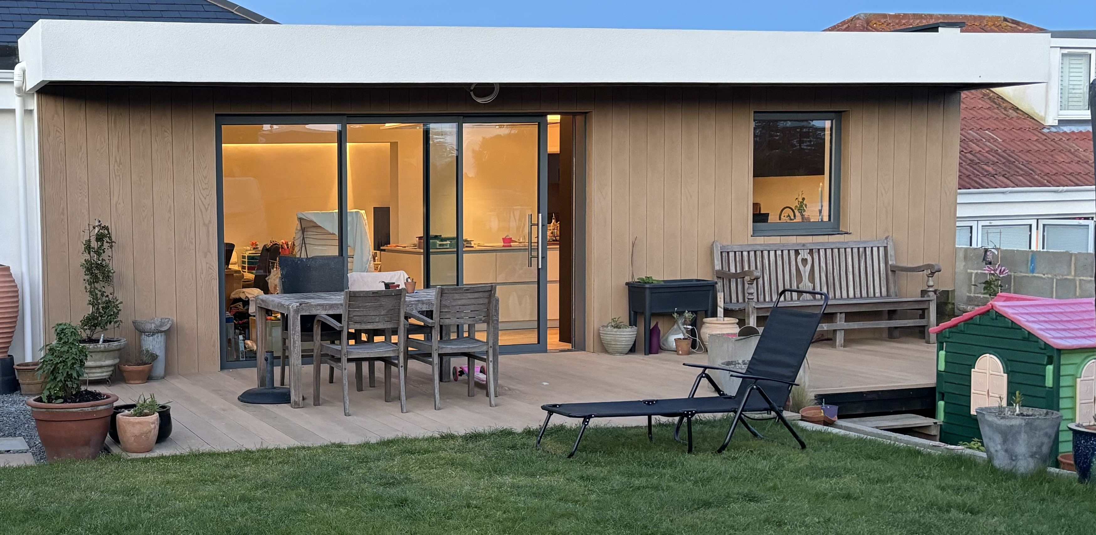

Hi, we did go with Millboard in the end. It was hugely expensive (£8000 including fixings) for both decking and cladding. This is it, in Golden Oak: It is very nice and we are very happy with it. Spent a lot of time fitting it, as any wrong cuts were worth a lot of money! It's unpleasant stuff to work with, the resin dust is very itchy. But the results are very good, and it doesn't expand or contract in changing weather. -

I did it in probably not the optimal way, but I'm OK with it. - 4x2 timbers attached to the block wall with large L brackets - Insulation packed between them (70mm K5) - Breather membrane cover - Battens 15mm thick over the top, nailed onto the 4x2s - Counter battens 2x1, painted up with Black Jack - Millboard vertical cladding
