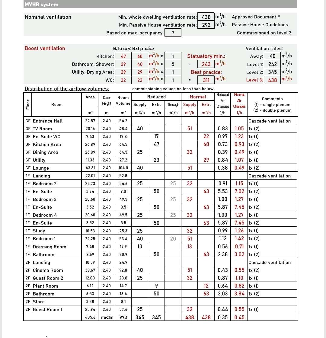

So, PaulHeat have calculated as below, I think that means we need a unit(s) to do 438 m3/hr max. They suggest either 2 x zehender 450 or 1 x 600 - I'm not sure why if we need 438m3/hr, we can't have 1 x 450, is it to do with the l/s do you think? Anyway, if we need one or other of those options any opinions on 1 or 2 units? (We may go for the Ventaxia units but undecided, same Q re 1 or 2 units though) Initially I thought is it easier to have 2 units so that we have less logistical issues ducting from 2nd floor plant room to gf (we could put the 2nd unit in the utility room on the gf) but, I'm not sure if that's reason enough to buy 2 units! Any thoughts?
