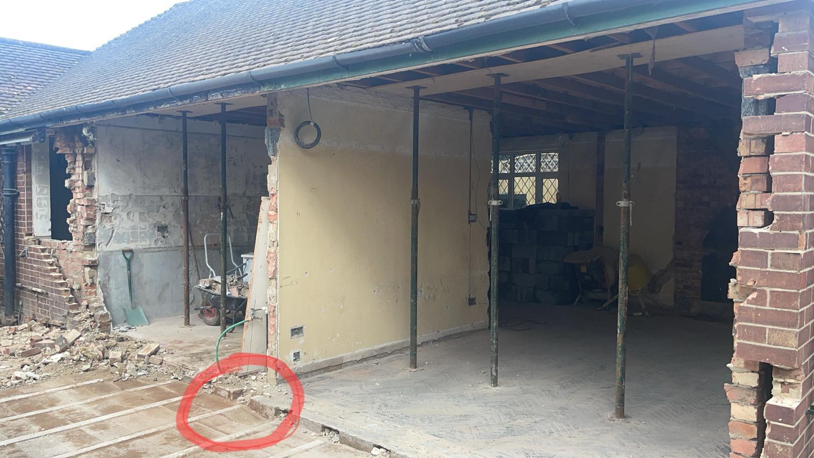

  4. I did think as well the block and beam floor needed to be lower, and raised this with builder. But there's a sewer pipe that runs through the garage that cant be touched without smashing garage floor. This is directly below the block and beam floor, so if the beam floor was lower it be at level of drain pipe
  5. See attached the block and beam floor, and you can see the existing house past the acroos. I dont have much height to play around with. Once I put the pir boards on the block and beam what can I put in top that doesn't increase height. Ideally I want to overlay with ufh boards everything
