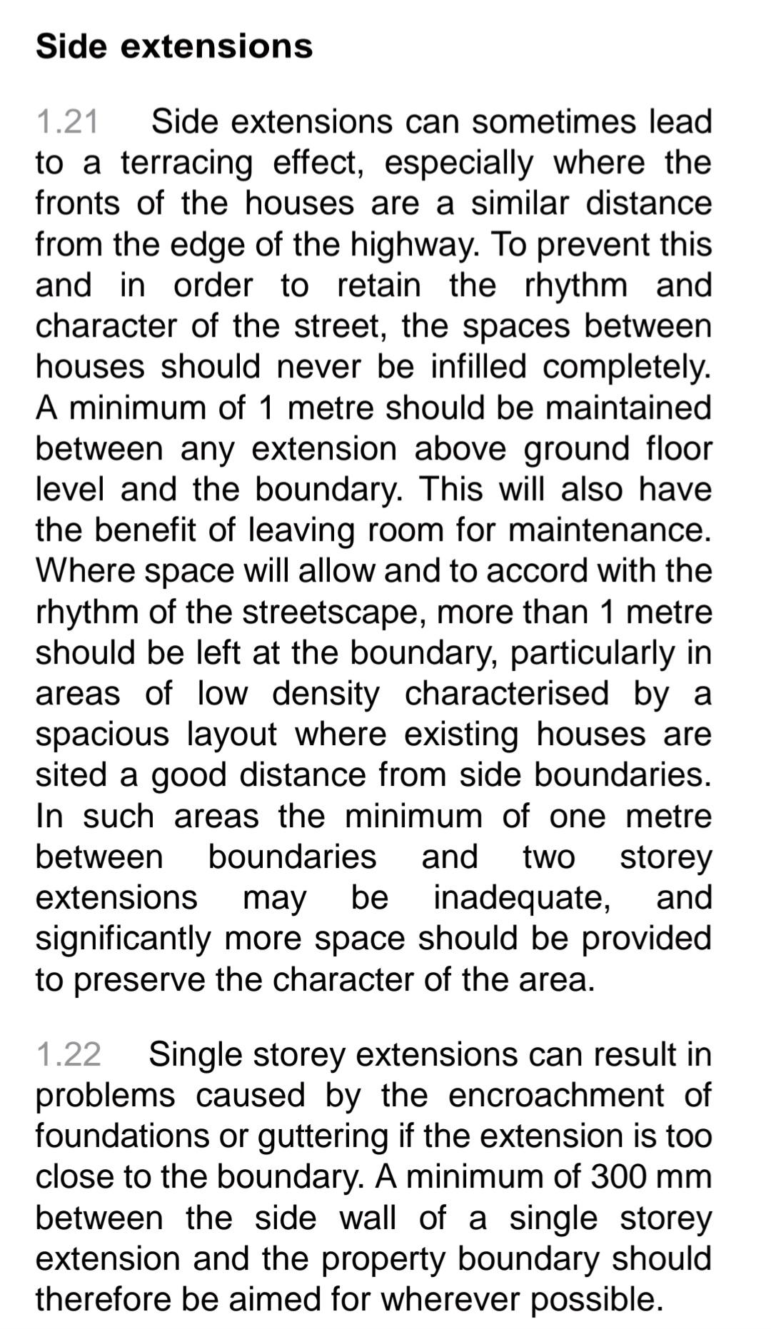

  3. I checked my LPA building guidelines for side extensions, and have attached the below. It seems I have to maintain a 300mm gap from boundary for a ground floor only extension, as im not going above ground level. This has brought me some relief if I have read it correctly.
  4. I thought if you go up a storey above ground floor then you need to keep 1m boundary. With a single side storey you could even in theory sign a party wall agreement to go up the boundary. Also my side extension is at the back of the house, it won't be at the front of the house. Not sure if that counts, But I guess it all comes down to the planners

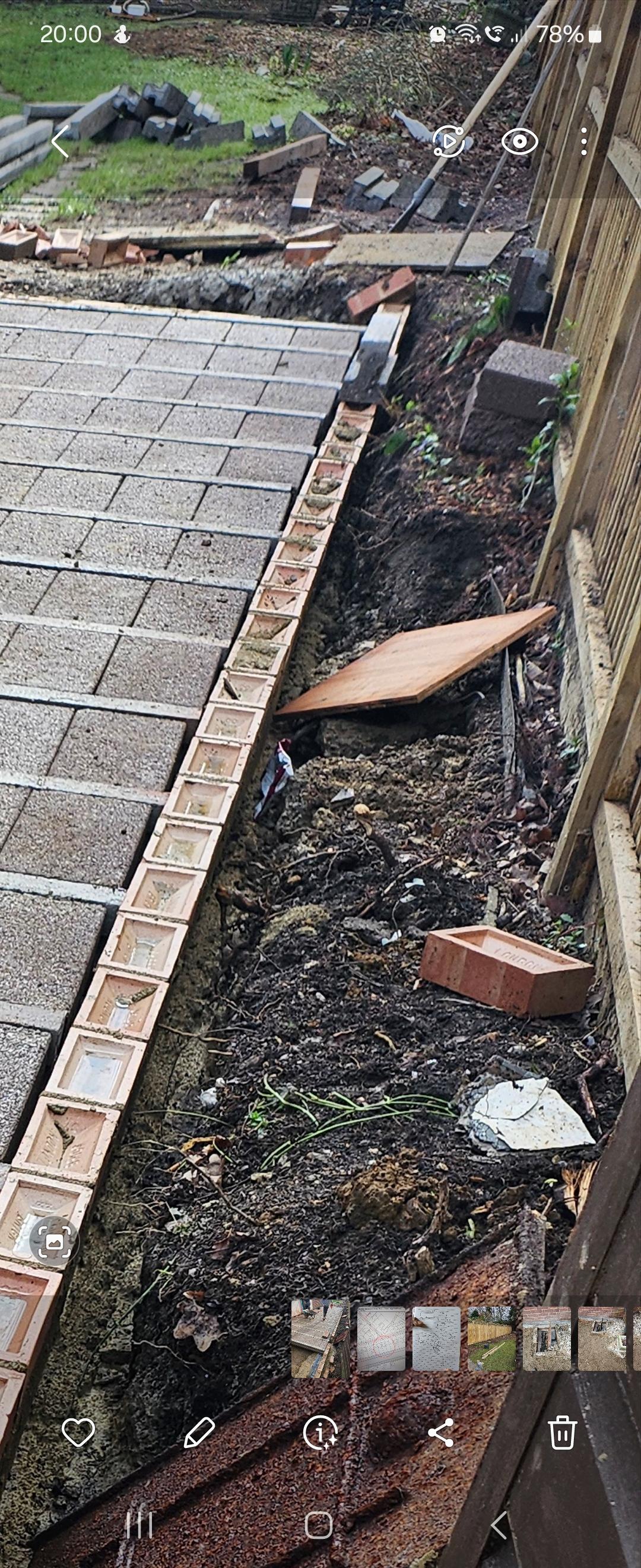

  10. The boundary gap start at 610mm and tapers in at the end to 380mm This is because the neighbour built the fence not in line so he's actually on my side

  20. @ProDave yes you are Right because its 2m from the boundary under PD I can only go 3m high to eaves. Even then I'm only allowed to extend out in length by 4m in a detached house. Hence why i have gone for full planning pernission. the architect has done the calcs And plans so I can only assume it is within half width of the house, in my case bungalow. If I have to go back slightly in length from 10m to 9m, or even 8m because planners don't approve, will they make me submit a new application or will they amend this original application??? Here's a pic of the floor up to corner of fence. We have laid the block and beam floor and stopped all work at this level.

  22. Yes you are Right it does taper in, the neighbour on that side is actually the builder doing the works and he has no problem taking down the fence to allow access for him to do the job of need be. Also the wall is still within my boundary and 50 or 60mm away from the fence on that side, so I'm hoping it won't be a issue with planning dept.
