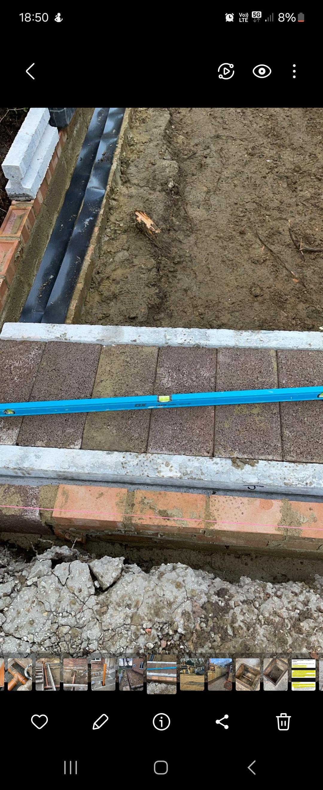

This will be a cavity wall and the beam.is only supported at the ends, there is nothing supporting it below. It's a single storey wall 3m in length. What should I tell the builder?
Have a question on 1 side of the wall the builder hasn't built a inner leaf, he's using the concrete beam to act as the inner leaf to build the inner wall off. Is this OK to do?
So u just laid the blocks straight on top of the beam up to roof level?
Can you lay blockwork on top of block and beam floor to create a wall partition, they will not be load bearing just on single storey with flat roof aboce. I want to subdivided the floor area into 3 separate rooms.

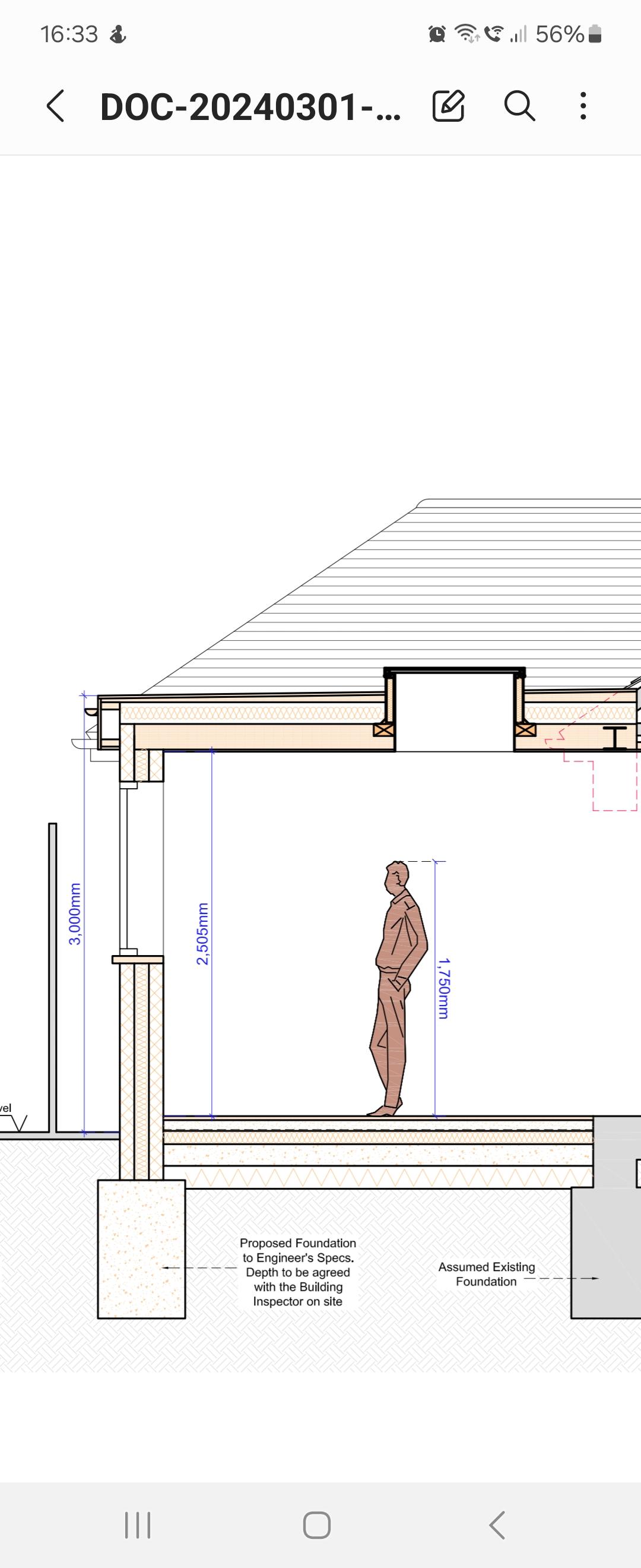

Is there any workaround for this issue. What if I didn't use a flat roof and used a pitched roof would it solve the issue.
That is the drawing my architect drew for my bungalow. Why is it difficult to get through pd?
OK thanks. I'm.exploring options and to gain general knowledge. I'm within 2m of a boundary if the flat roof was designed like below would I be within PD for the height, any workarounds
