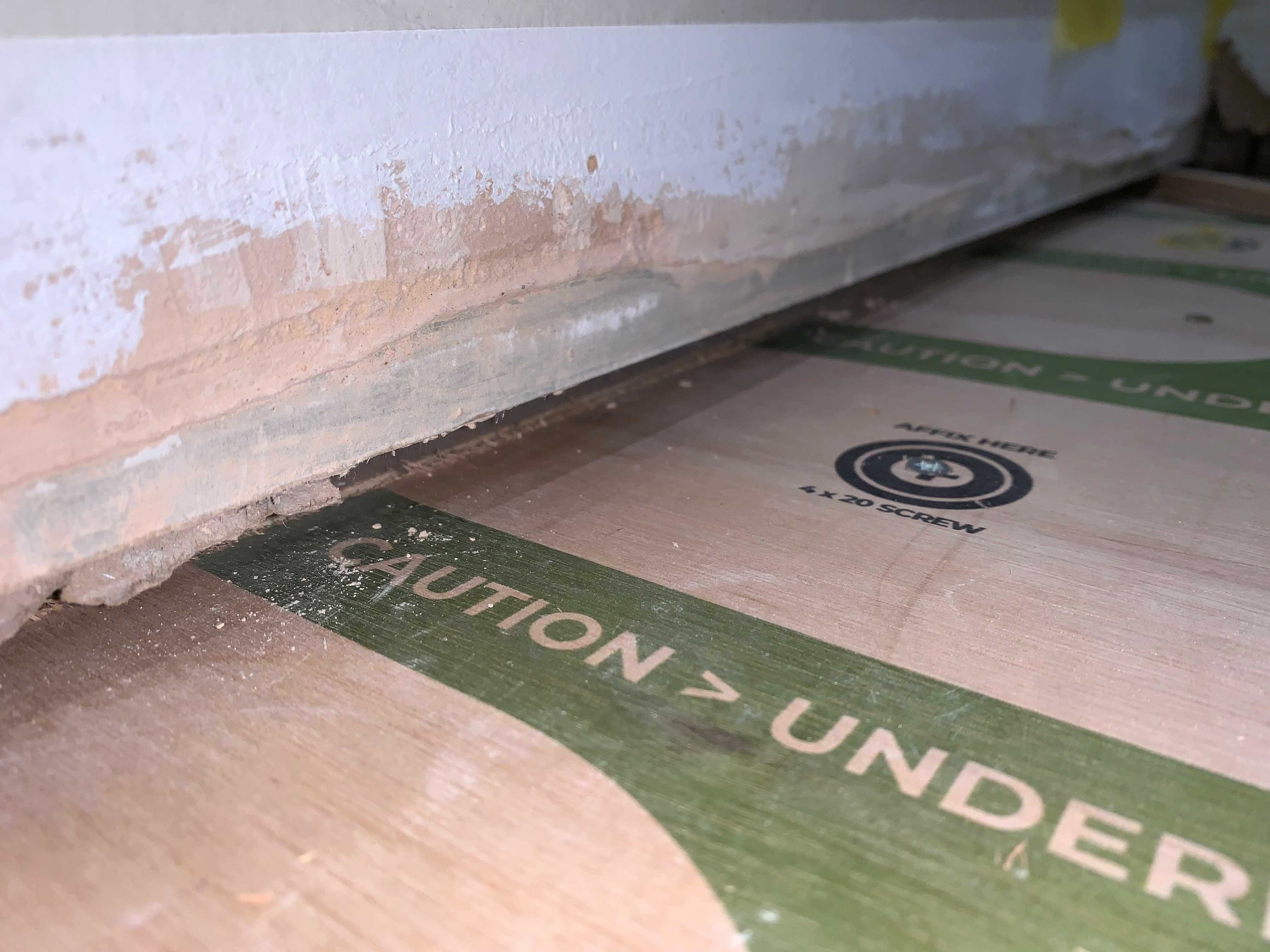

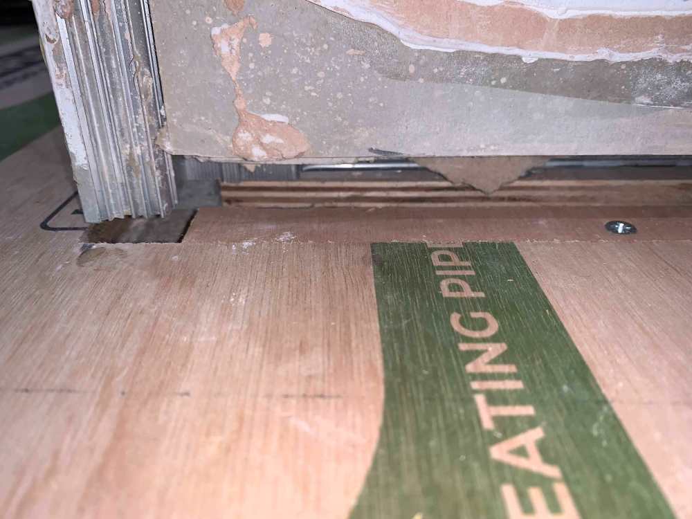

Do you have any photos of the joists after the remediation work you did was done i.e. before you put the new flooring down etc ? From your photos it is tricky to see exactly how the damp was getting into the joist. The newer sister joist shows damp in the bottom 75% extending from the end through to where the bifolds are. I presume the newer joist originally reached all the way to rest on the wall but the end had completely rotted away ? Clearly the older joist was very rotten in that corner. So (a) it may (most likely) be that damp was reaching the joists at their ends through their bearing onto the wall. That is the bottom of the wall in the corner there and the ledge the joists sit on was getting damp. Then in the absence of any DPM between the joists and the masonry the damp was sucked into the joist ends and then down the joist length. or (b) it may (perhaps) be that the older joist is in contact with the masonry under the bifolds ? Or in contact with something on the possibly damp earth underneath (rags, or rubble, or timber shavings) ? Thus the older joist was getting damp and passing the damp into the newer joist by contact. I presume when you did your remediation work and replaced the rotten joists that a new DPM was put along the bearer wall the joists sit on, and really ideally up the very end of the new joists too? I presume all the damp rotten wood was removed and ideally the new joists treated with preservative/wood worm treatment ? I presume the only point of contact for the new joists would be at the ends on top of new DPM and there was no direct contact anywhere else such as under the bifold ? In your photo with the torch it looks as though there may be an aperture under the floor there through the dividing wall with your neighbour ? If so there may be passage of air via such a hole. It is even possible that damp is getting into that corner area from your neighbour's side - take a look over at what is on his side - a leaky downpipe, gutter, a gully drain ? When you lift your astroturf is there any/more evidence of damp near that corner ?
