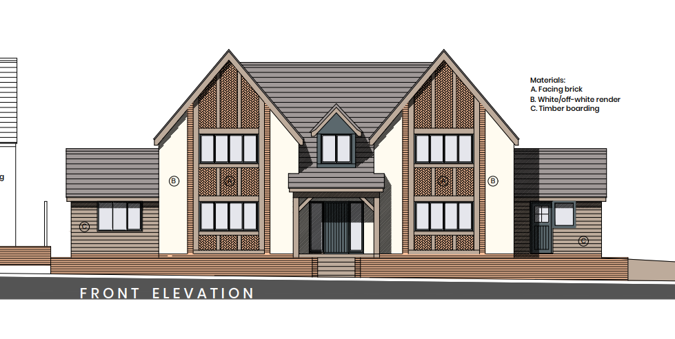

We are in the process of picking the brick for our new build. We have found exactly what we want on a selection of newly built homes on a nearby development - see attached. But we are struggling to identify what brick they've used. I've tried the brick matching service on a few different websites and chat GPT - they've come up with some good suggestions but I don't feel they've found a perfect match. Anyone happen to recgonise it? Or have any other suggestions for matching it?
