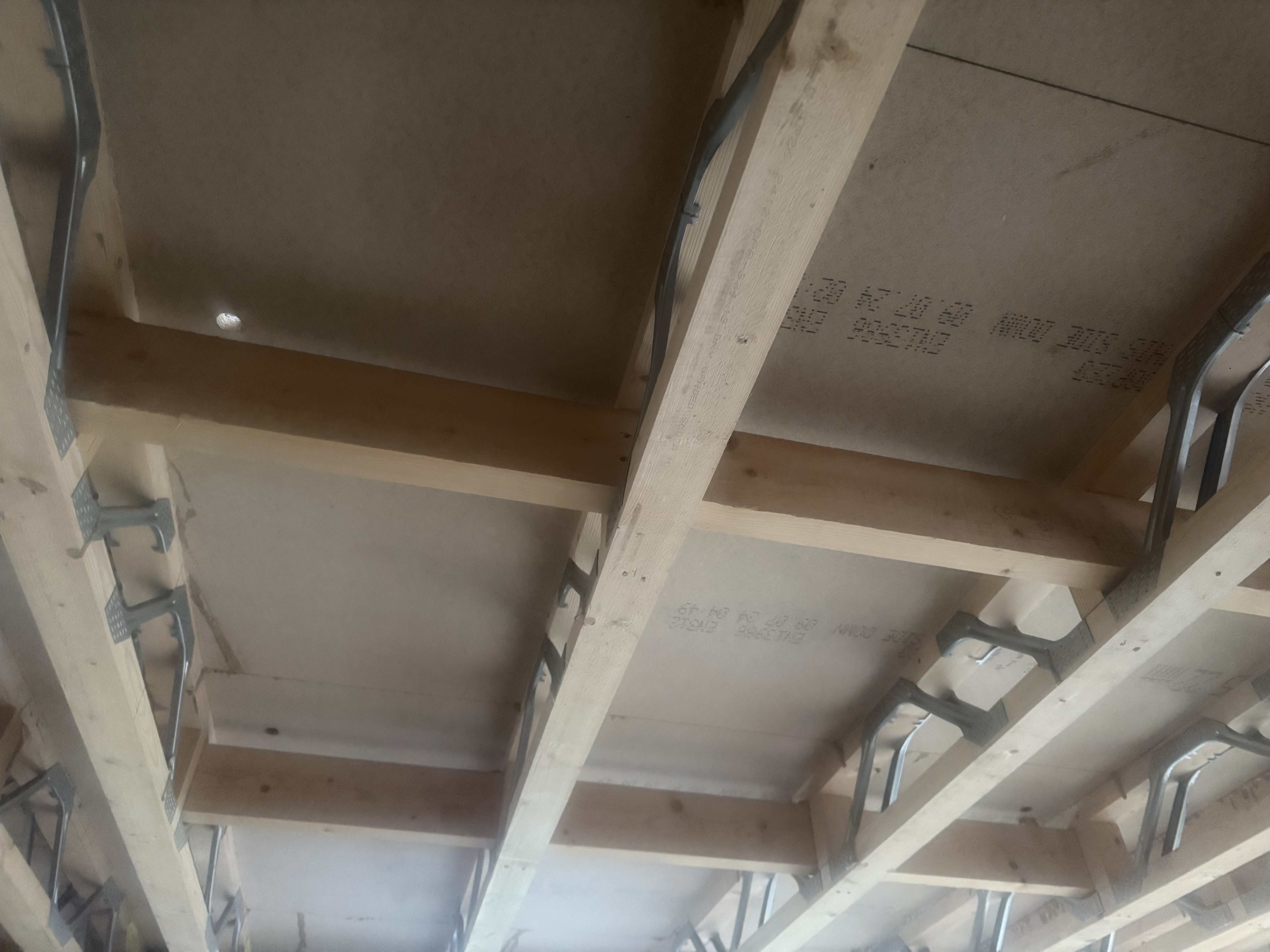

Thanks. Posi’s are 22cm from very top to bottom so hoping I might get more than 100mm insulation in there. Good suggestion on the strong backs. I do have some narrower channels with no strong backs so predominantly going to use those but there will be a few places I need to scallop out. 👍 Do you have photos of your ceiling build up? Would be interested to see and get a visual in my head. cheers -

Thanks that’s useful. Still trying work out the best build up for my ceiling. The posi joists upper cord is about 45mm and there are regular noggins with the same gap above so thinking maybe 50mm Rockwool rwa45 then MVHR ducts then another layer of acoustic insulation. I feel like the ceiling should have as much insulation as I can get in but realise I also don’t want to be insulating the wiring . I’m probably way off here so really interested in what others do… another steep learning curve! -
My MVHR parts have arrived 😀 I have plvcu ceiling/wall plenums and wondering the best way to mount within the ceiling. The mounting tabs are useful but not sure whether to go direct to the underside of the 22mm egger floor above or whether I need to fit a piece of timber for each one and screw into that. Any advice and photos would be really appreciated. Thanks

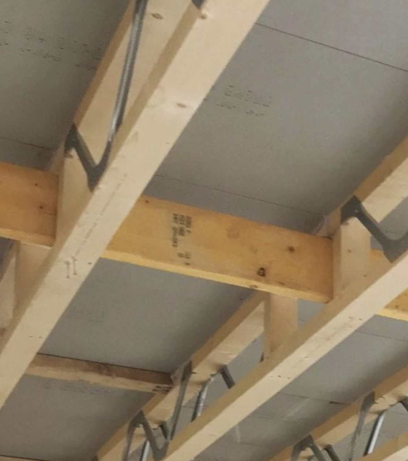

Thanks for the detail. I think now that one I counter batten the ceiling there may be enough room beneath the strongbacks to accommodate the ducts 🤞 really useful info though so much appreciated.
My posi joists are joined with cross members like the attached. I’m wondering if can drill through those or take out to run MVHR ducting along the length? The open web is great for running across the building but I also need to go parallel to joists. Any advice appreciated thank you

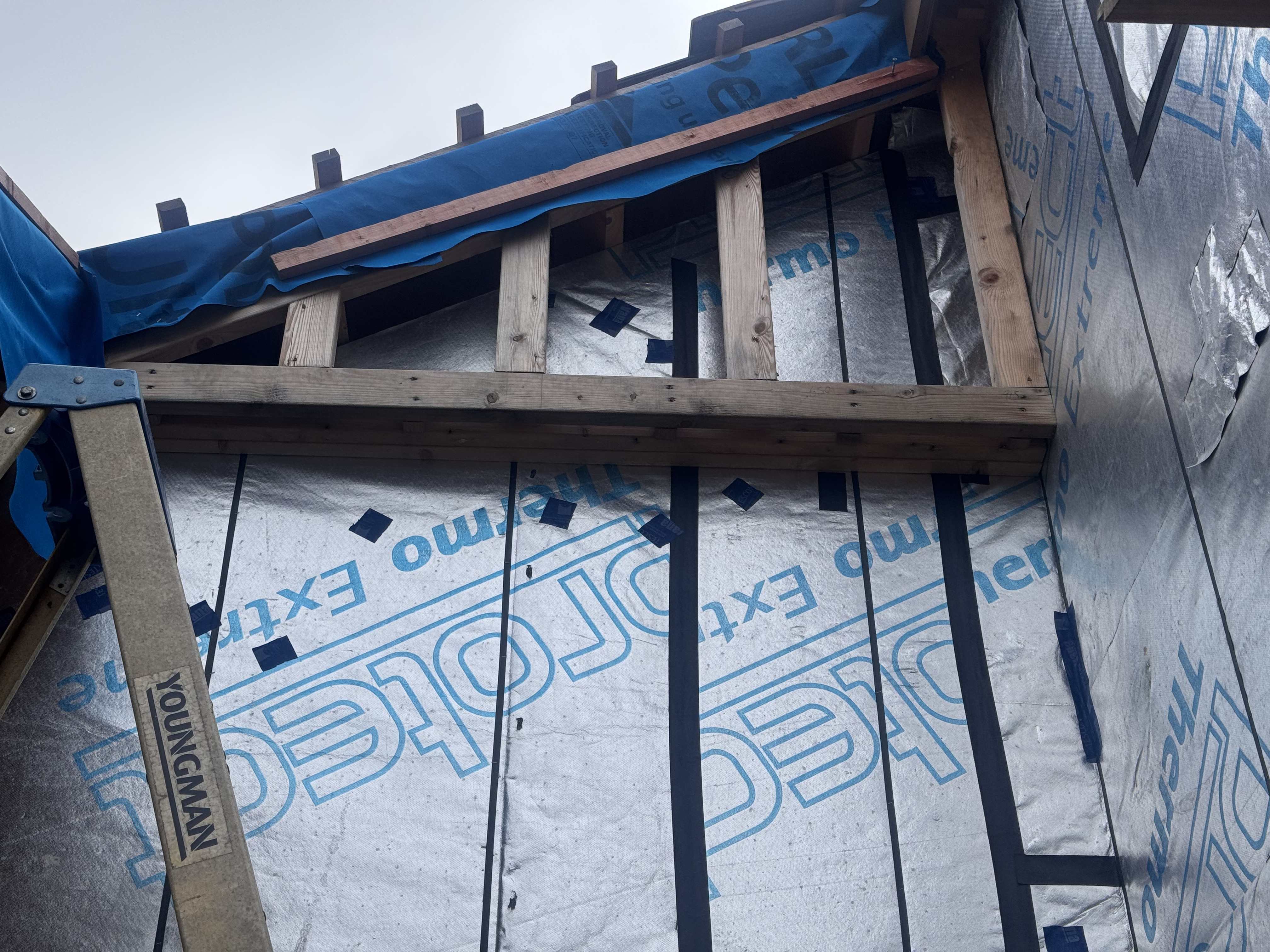

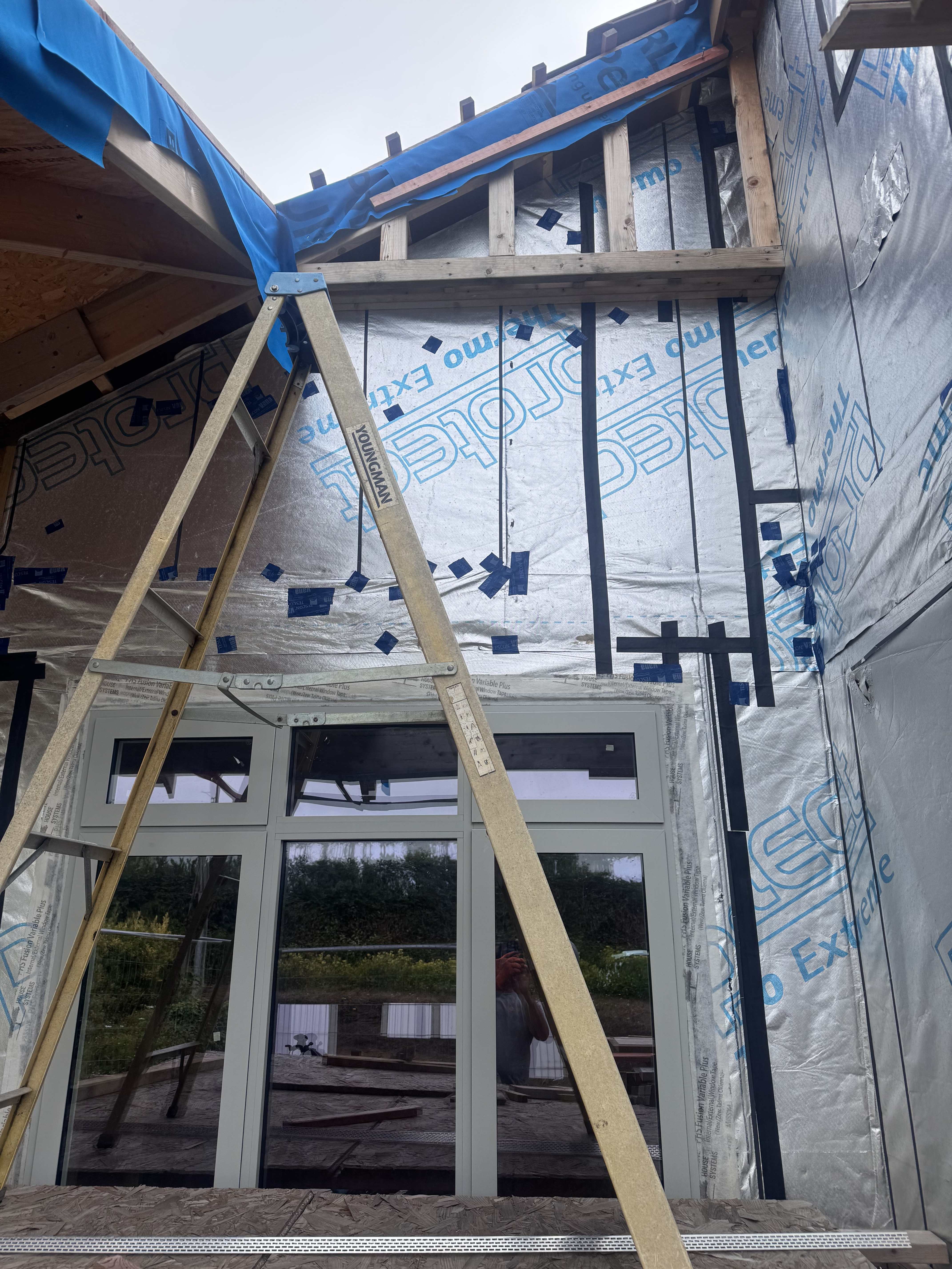

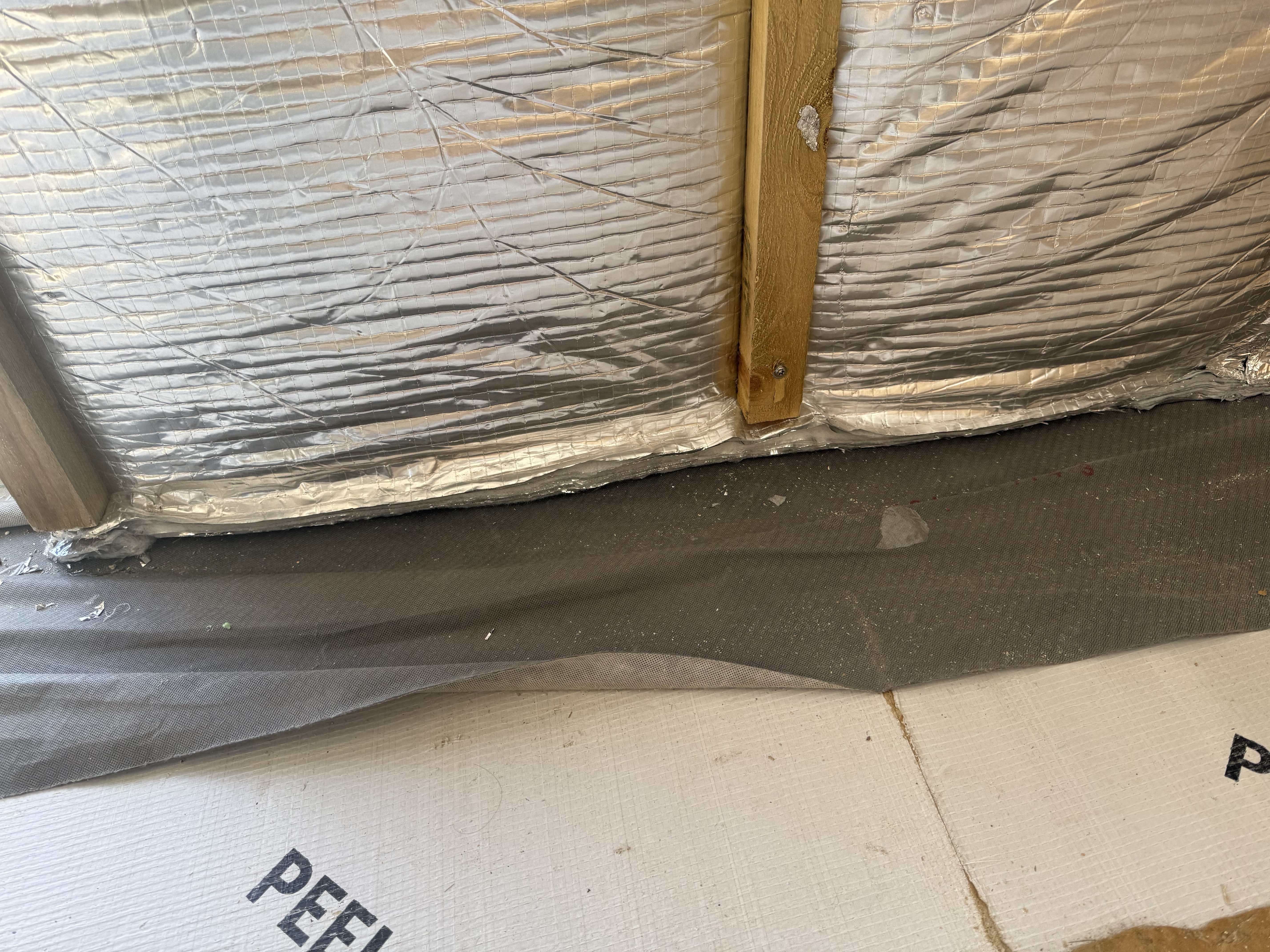

Thanks. Does it matter how much overlap there is. The battens are about 60mm off the floor so could tuck underneath and tape the overlap without lifting the battens.
On most walls there’s enough space to lap up underneath by about 7cm without removing battens. But presumably would still need taping regardless so not sure if there’s any advantage to that.
Yes prefabbed. Came like that with vertical battens
Just working out best way to tape this junction. The vcl is lapped around the cassette from bottom floor to top. Should I trim and lap under the ybs and then tape or just tape direct to the ybs as it is… seems like there’s no gain in folding and extra work. any thoughts? Thanks
