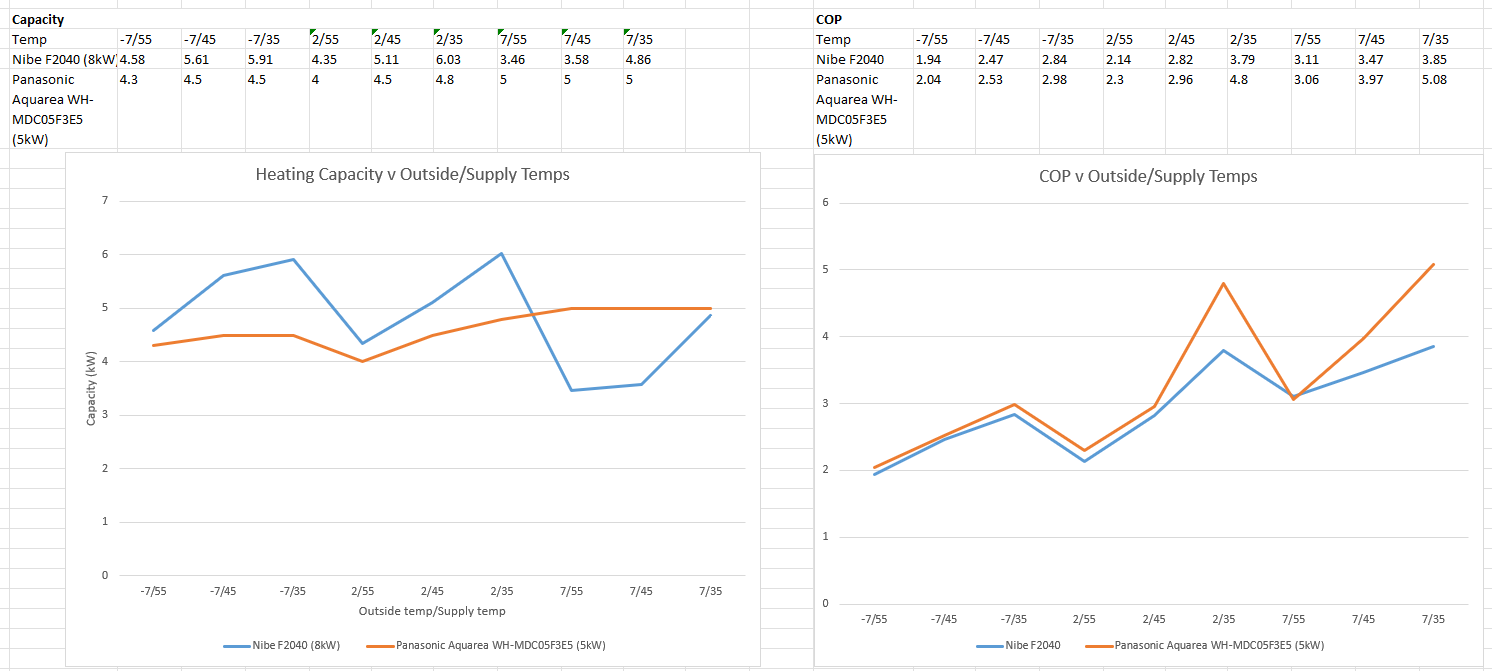

  8. Really useful thanks @jack. I took a quick look at the Panasonic unit and on the face of it the specs look good and folks seem to have been able to integrate fully to HA using ESP32. Annoyingly the image seems to have a problem and won't load 😞

  10. So, now that lovely discussion is out the way. Anyone got recommendations for a 5kw pump that does heating and cooling? Obvious candidates are Viessman and Valiant but I know nother about HP manufacturers really. Only requirements other than heating and cooling is integrated into Home assistant so I can keep the cooling point above the dew point, and (probably separately) do weather comp for heating. Plan is a simple open system, no zoning, have enough water volume to not need a buffer, and have bug enough pipework for dt5 flow rates.
