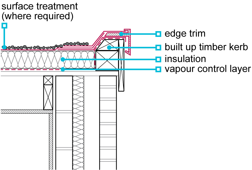

I'm now confused again. I was planning on doing something like below (image from NHBC), but full fill rather than partial fill cavity obviously.
Cheers. Good to confirm thoughts; have detailed the warm roof insulation to go over the cavity with an overhang.
Main reason for 125mm cavity is aligning to existing walls that will need IWI. However yes can easily tweak cavity size. Given you can get EPS and Bats at same lambda value (0.32) any thoughts on best filler?

So considering options for insulating the cavity of our extension. Have come to the conclusion that using PIR ends badly from an air tightness and gaps perspective. Learnings from this thread: Cavity is currently planned at 125mm and would prefer not to tweak. So thinking my options are: - full fill batts - closed cell foam - EPS In terms of what's easiest for builder not to get wrong, and not need another sub contractor, and VFM full fill batts seems the way to go. However, is there any potential issues with air tightness with using them? To note inner leaf will be parge coated for air tightness and some IWI added (mineral wool) before plasterboard.
