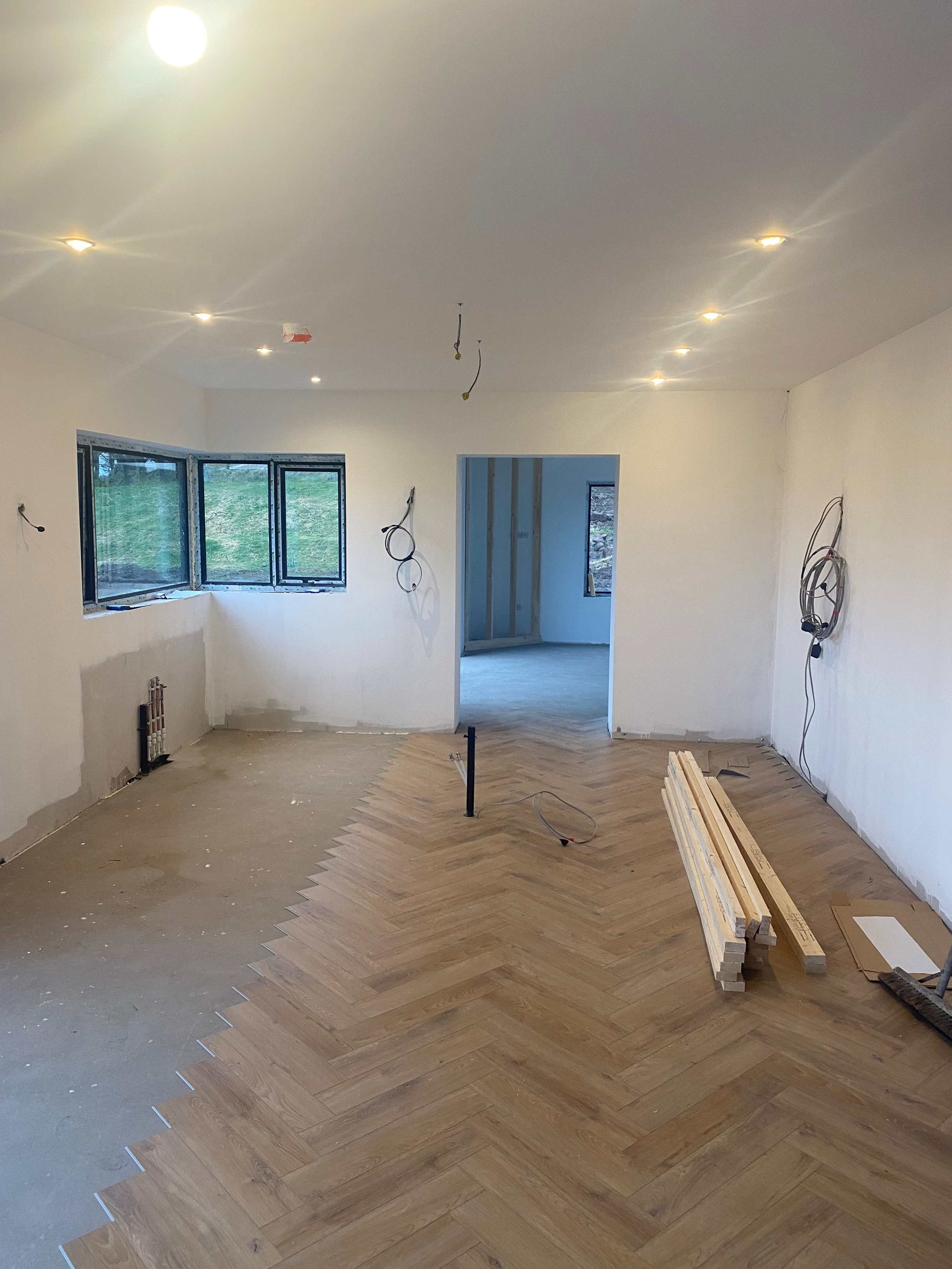

We used Lignum Core LVT, with the built in underlay. Picture of it being laid, very easy to work with but you need a very level floor. Went for it due to its advantages with UFH and that its scratch, impact proof, waterproof etc. Get yourself to a flooring store as they nearly always give a bit of a discount

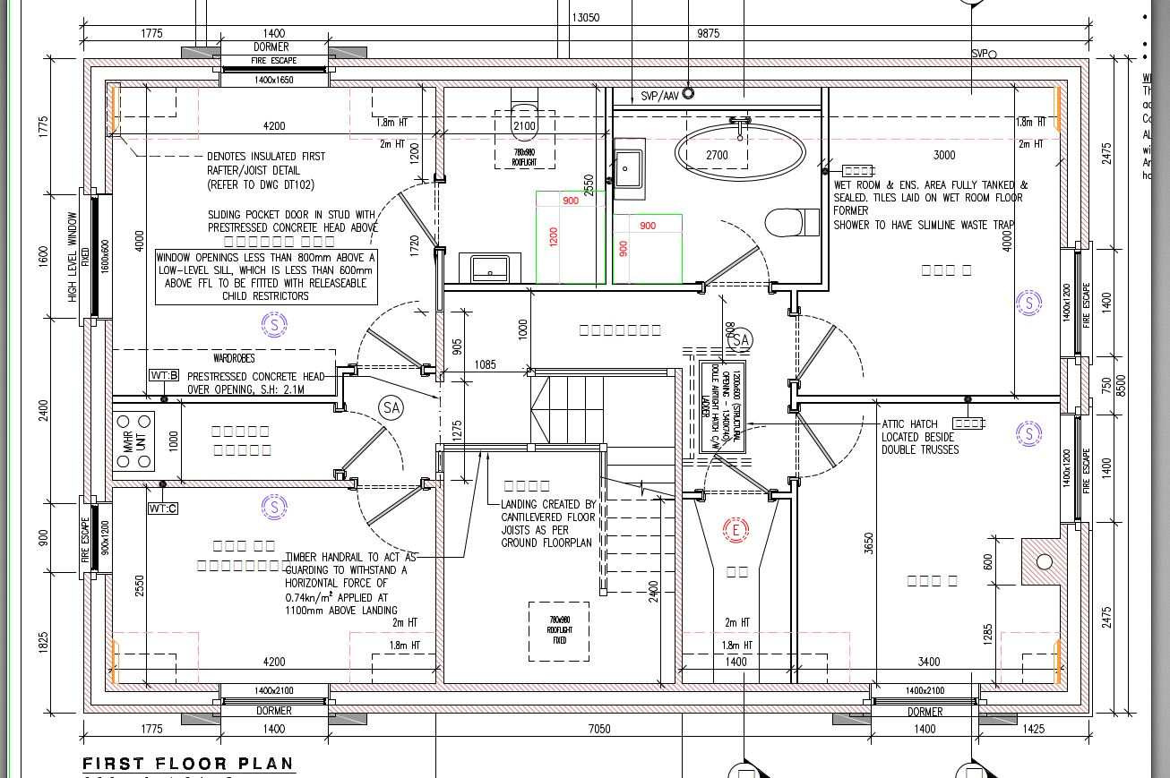

Hi - I was wondering if anyone could advise. Trying to figure out the best place for radiators. Any help appreciated!
