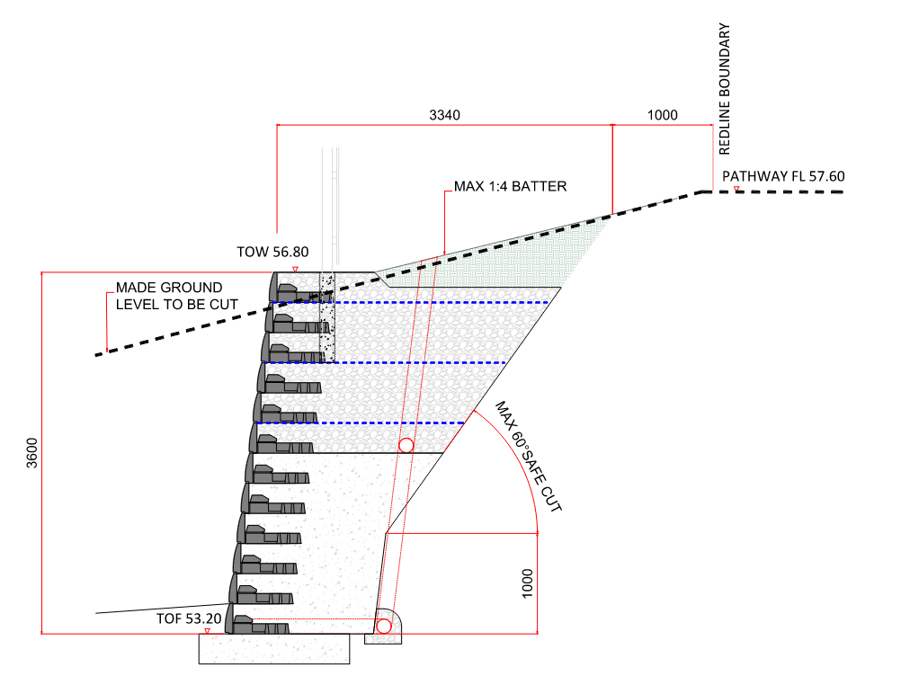

Hi Chaps, i have attached a section because its much easier than trying to explain parameters i need to work with. -

Totally agree far too many unknown factors with made ground. Like I said in previous comments my gut feeling is warning me -

I'm a MSE retaining wall designer and made my concerns very clear to the client from the start. In fact my suggestion was actually metal sheet piled but wasn't to keen with the vibration close to the road that needed retaining or the additional cost for temporary works. Thanks for the advice, appreciated -

For maximum safety yes 45° I would totally agree with you and I don't really like designing much steeper even when I know the soil cut will be stable at 80°+. Sorry I should have given more details. The made ground to be cut is an embankment previously retained by a timber crib approximately 1m from a pedestrian footpath and road the retained height exceed 4m in some parts. I'm quite green re geotechnics (structural background) but my gut feeling is giving warning signs. I appreciate your advice, thank you -
so a bit of a head scratcher for the geotechnics gurus!! I'm currently designing a MSE retaining wall, but in order to keep within the boundary i need the safe cut to be 60deg. going off the SI report no bore holes or trial pits are in the area required so they have exposed a small section of the embankment revealing a variety of materials including brick, rubble, colliery spoil/ash even a work boot. so you clever lot!! any advice is much appreciated.
