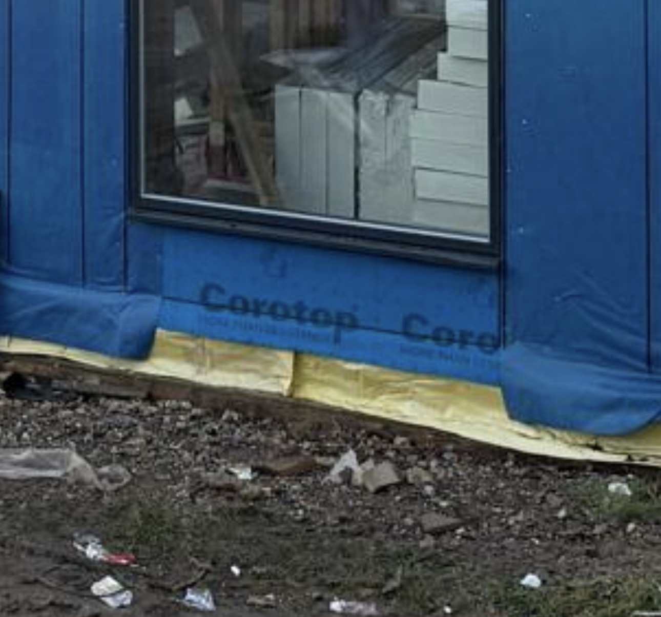

The detail just shows what most do - DPM just ‘finishes’ directly after the soleplate. -

My thinking was more along the lines of keeping a sealed envelope. If I lap down, the opening between the DPM and soleplate is exposed. If I lap up (and do it properly) then the envelope is sealed - better airtightness and less chance of water ingress. Double sided tape (butyl) between DPM and mebrane, staple through, then tape fully over the top of DPM to form a complete seal. -

Will grab some better ones tomorrow but here’s a hastily cropped and zoomed version. The buildup on top of this includes Actis BoostR Hybrid - for insulation and airtightness. So ideally the DPM gets lapped up, taped, BoostR stapled and taped, battened, and then clad / render depending on area. -
Hello everyone. I’m doing a few ‘keep busy’ jobs over the next week until my crew are back on site. One of them is tidying up the DPM flaps that are hanging everywhere. My build is timber frame, over blocks on slab. DPM is between blocks and soleplate as per usual - and currently extends out anywhere from 15cm to 40cm. What should I do with this? Original idea was to lap it up the breather membrane on the OSB (DPM flaps cut to a uniform length first) and then tape. Is that just the standard detail?

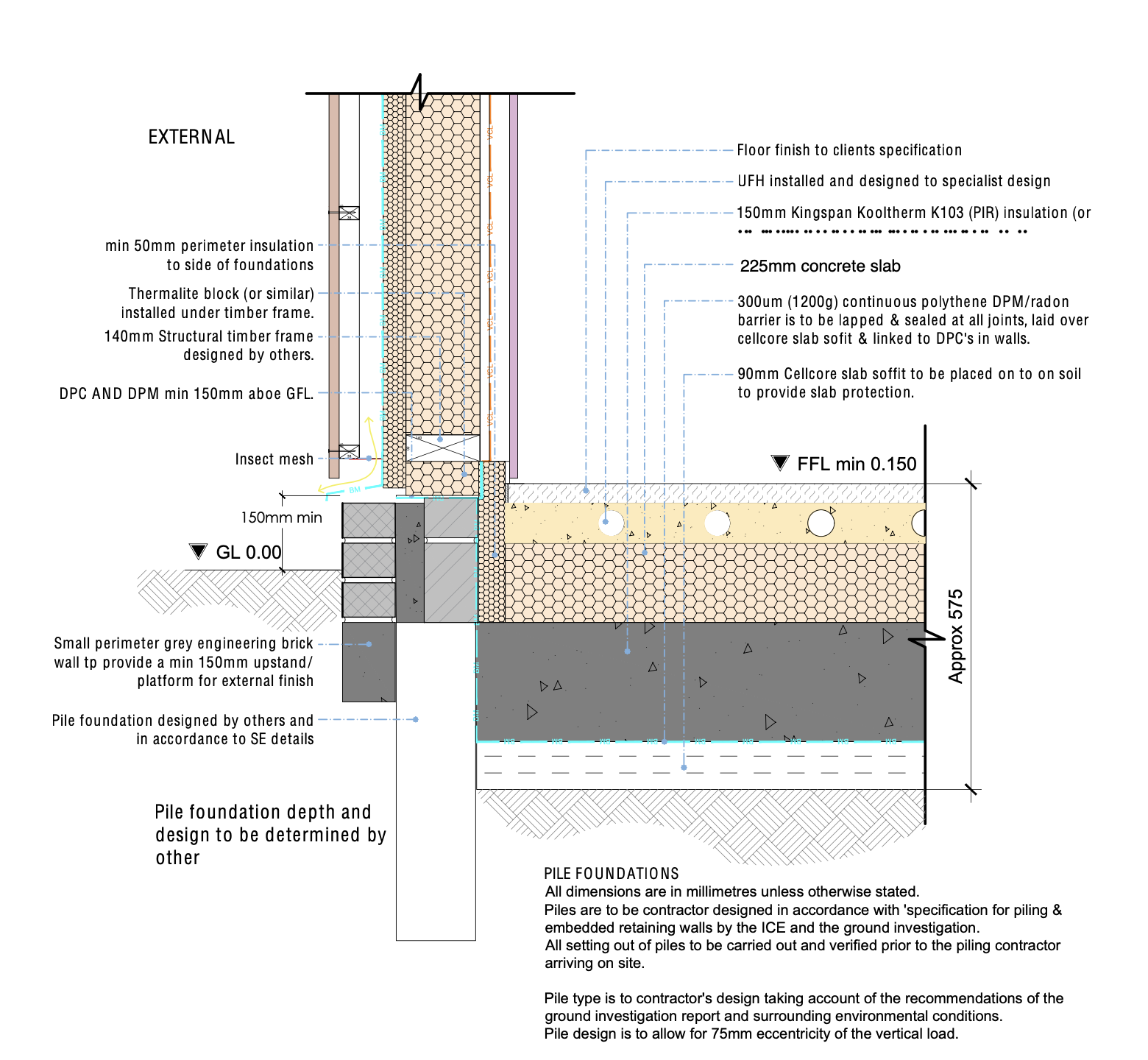

Does this make sense? Piled raft cross-section
AppleDown replied to AppleDown's topic in Foundations
It definitely needs piles. GR has been sent off to about 10 different people - including AFT and Tanners, and all suggest it either needs replacing down to 2.5 metres with new ground, or piles. Piles is easier and cheaper. The design for loadings has been done, so they know where and what depth to place them at. I'm just trying to work out if that drawing makes any sense - as my understanding is based on what's on the forum and what an initial part-time PM is telling me. If the slab extends further, is that all that needs looking at - or are there other glaring mistakes? -
Sorry, that's just me using the term - can call it slab. As above - if the slab extends to under the supporting dwarf wall upstand, is that then correct? Where does the DPM meander through? -
I totally understand the piles and slab will be designed by a SE who knows what they're doing (that's happening at the moment), but in the actual details of what's shown for the slab to wall junction, and how it's supported - are my assumptions correct? If the slab extends to under the upstand blocks, is that how it should look? And if so, what's the route of the DPM? -
Looking at the cross-section we have from our Architectural Technician for our piled raft. Before I go back with questions - his inclusion of a 'pile' on the edge of the concrete makes it look like the timber frame is floating on nothing. Am I right in thinking the raft needs to extend under the timber frame wall and dwarf block wall, and then add some insulation outside of that? Also, what does the DPM do? Then you have the perimeter build up next? Or am I taking crazy pills?

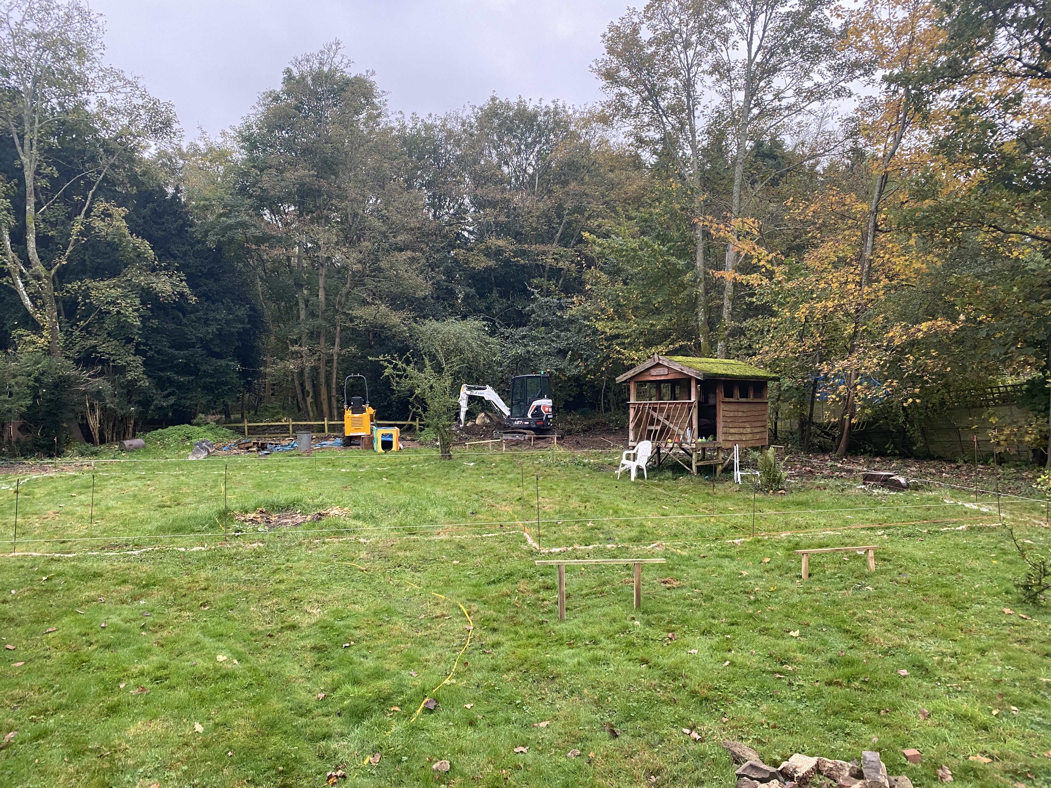

So after three years of planning shenanigans, plenty of back and forth over designs and a house sale that is (hopefully) completing soon, we're finally doing something meaningful on the plot. Last week saw us mark the foundation outlines, set up a few levels and work out a plan of action for clearing the site. First up is removing the leftover brick supports and plastic sheeting from an old summer house/chalet, then on to the the overgrown brambles and finally clearing a tonne of dead wood from years of blown down trees that were cut up and left in place. But the biggest and most precarious job will come when we try to move the tree house my late grandfather built back in 1992. It's stood the test of time, providing many adventures for both myself and my brother, and now our two young boys. The fact that three tress around it that were felled in numerous storms over the past 30-years managed to just miss it is a bloody miracle. So it deserves all the care and attention to move it to a new safe spot, and receive some much needed replacement legs, boards and felt. No idea how we're going to do that though... Next week we hopefully start the dig out, ready for the piles - but the rest of this week will be clearing, laying some hardcore and marking out some of the drainage/utility runs. More to come!
