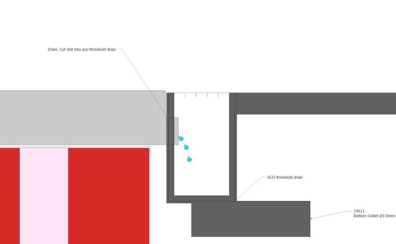

Detailing for cill drainage with a 'flush' finish patio
GaryChaplin replied to SBMS's topic in Landscaping, Decking & Patios
Thanks for the reply. I'm hoping to use an ACO threhsold drain abutting the sill, then cut slots in the plastic section of the drain to insert the door sill into. Below would be an additional waterproofed drain into a french drain I have around the whole building. Though I suspect I'll change the plan when the doors arrive! Something like this: -
Interesting reading. I have exactly the same issue. Did you come to a conclusion? -
