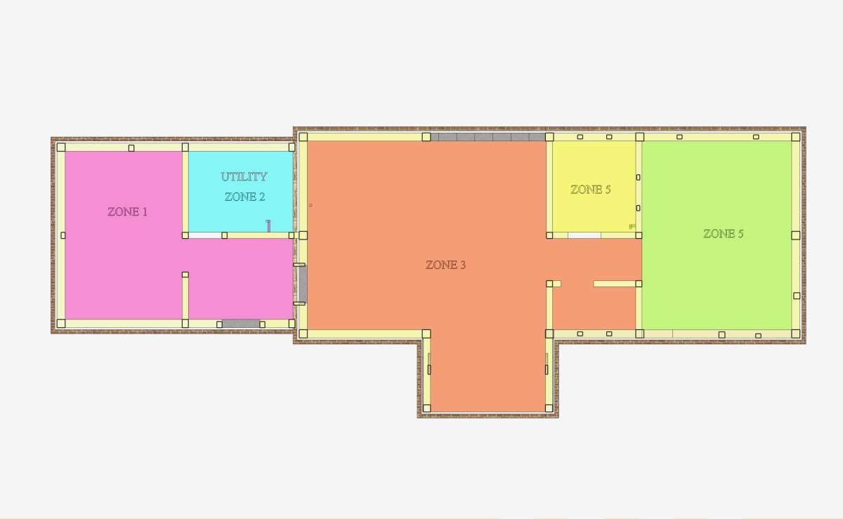

Hi all, I’ll firstly admit I’m pretty lazy when it comes to reading / scouring through loads of posts for the answer I’m after, so thought I’d just gauge an opinion... I’ll soon be at the stage where I’ll be installing the UFH and I’d originally thought zoning was still common practice. Though it would appear it’s not advised so much any more? (according to this forum) I’d like to know what’s common practice nowadays? Here is my plan from last year, however the whole ground floor is only 100 sq m, so I’d prefer to just have two zones if possible, with manifolds in the utility space. The simpler the better I guess. Thanks in advance. G.

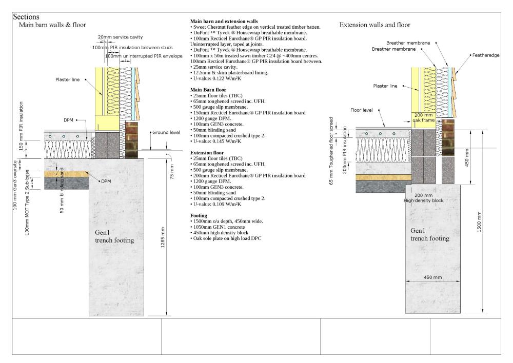

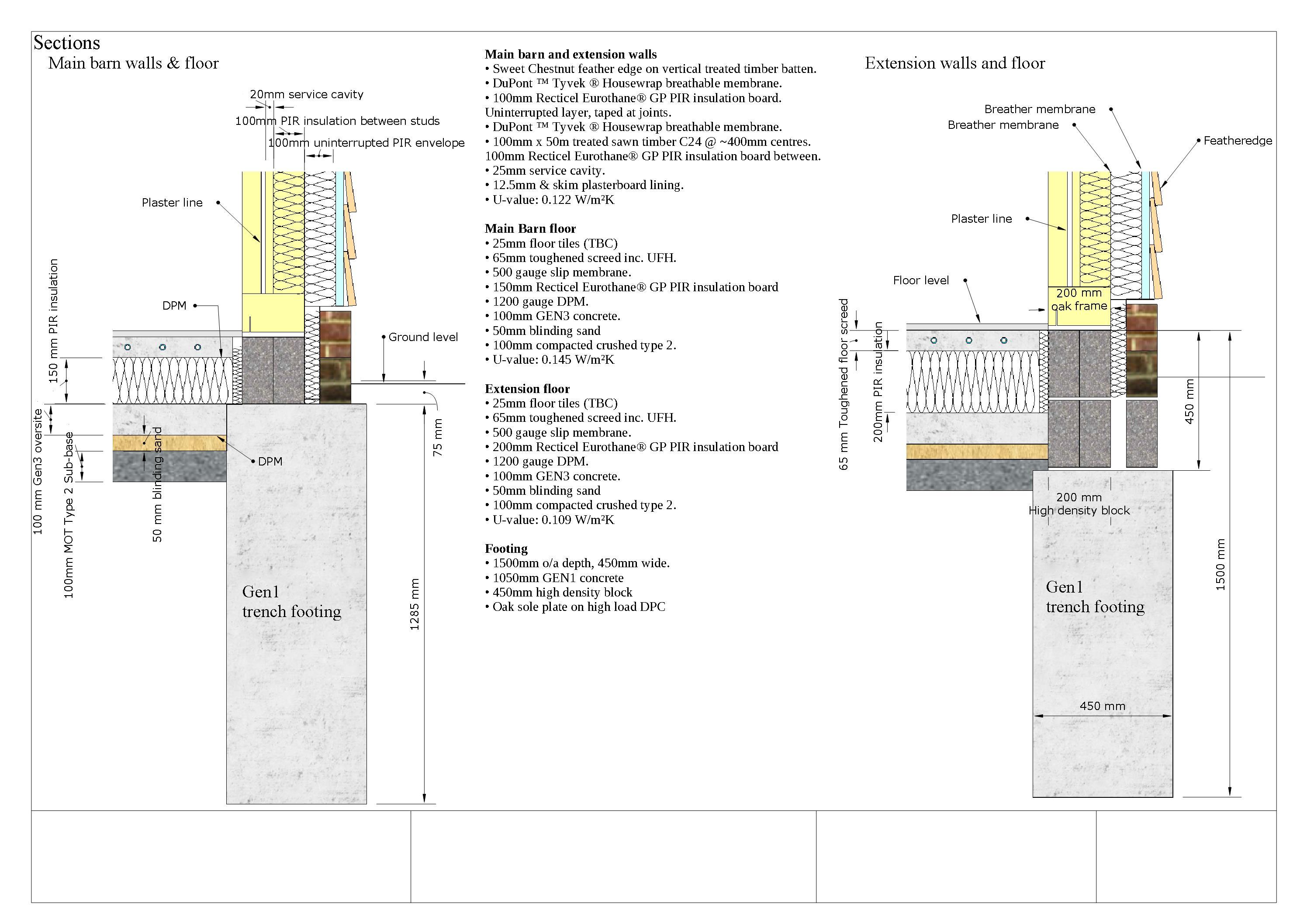

Thanks for asking me to comment, though I've way to busy to read this whole thread. Sorry. I would always design an greeb oak frame to be within an insulation 'envelope'. This can be acheived with SIPS (expensive) or a continuous layer of PIR, taped at the seams. The oak will shrink within this envelope and not give you issues with airtightness. I have dozens of examples of how this can be done. However, these sectional details may be of use. -

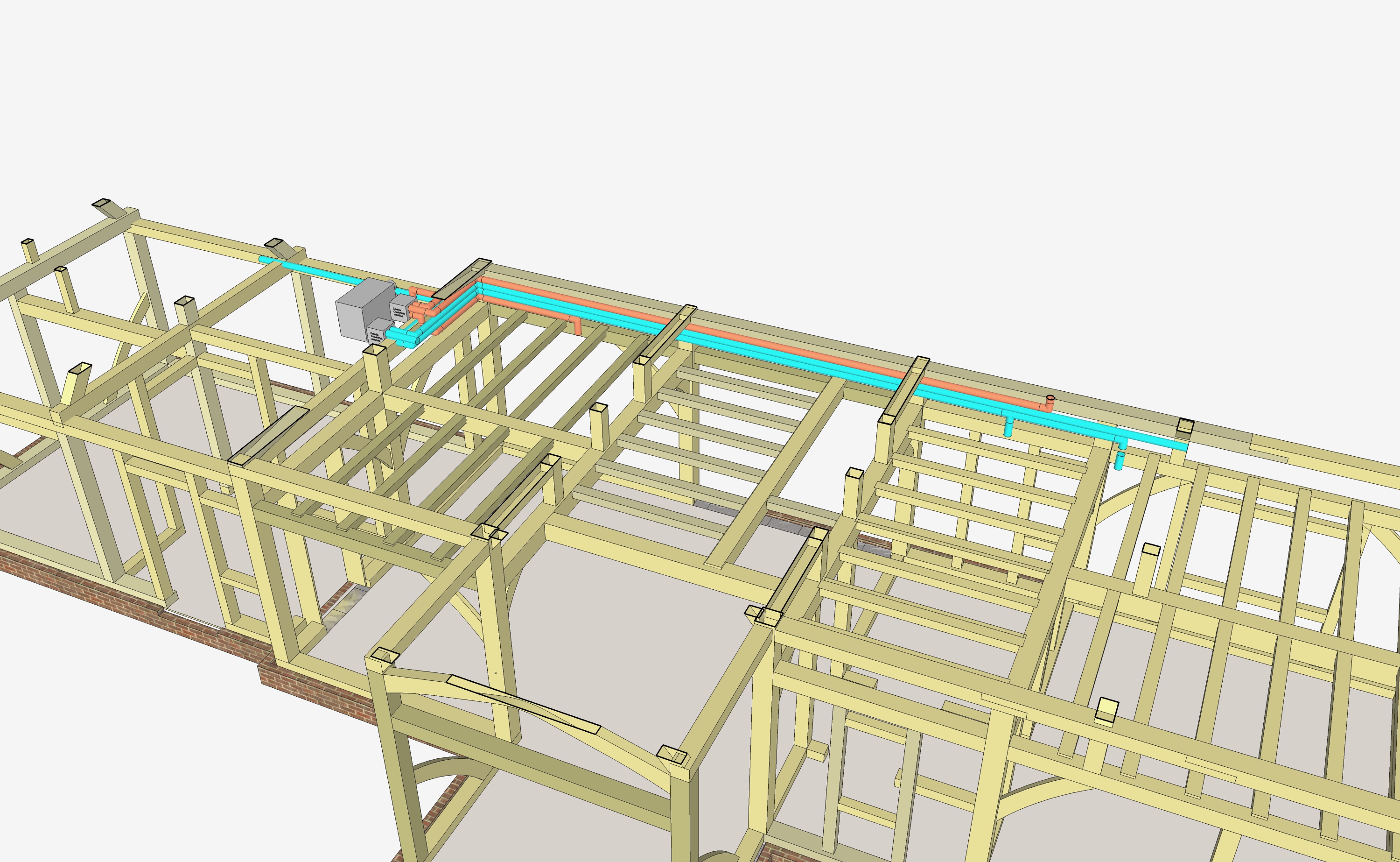

Thanks for the replies. The primary construction is oak frame and in hindsight I would have considered the MVHR before the initital design. However it was designed and built as a well insulated barn, then permission gained for conversion to residential. I have the design modelled in sketchup, but it may not be clear from the following drawing as it's pretty cluttered. I plan to run the pipes vertically stacked along one wall in a hidden cavity within the insulation envelope. Red indicates extraction, blue is clean air. It's only a 1 1/2 storey build with a very open and simple layout. Extracts from kitchen, bathroom & utility. Elevations.Plans.Sections.ServicesPlanning_V7.pdf -

Hi all, Firstly, hello! This is my first post, so apologies if this has been asked before. I'm part way through a true self-build and I have designed in a MVHR system. I have received a quote for a company install, but I'm simply not prepared to pay the ridiculous costs for essentially running pipes into every room. There seems to be much talk about commisioning and flow rates etc? Can anyone point me in the direction of some guidance so I start my research in the correct place? I have to use 90mm pipes and intend to have 3 extracts and 4 supplies. It's an intentionally small passivehaus inspired build, so hopefully should not be too complex. Thanks, Gary.
