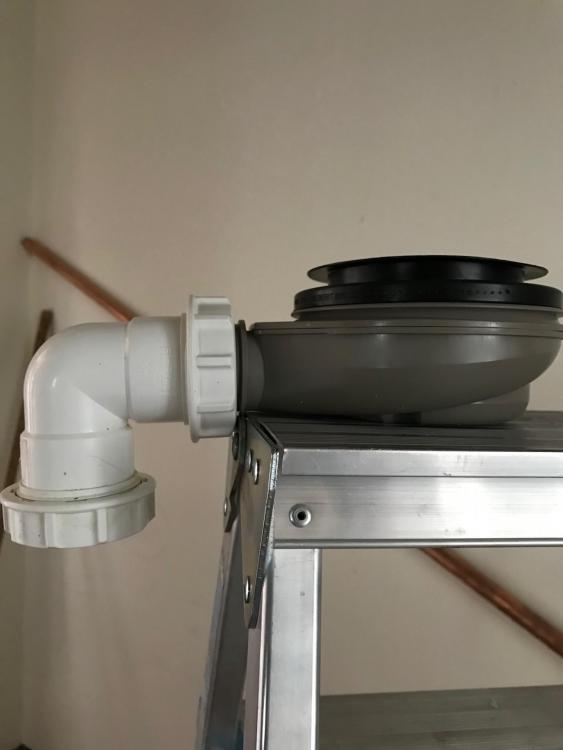

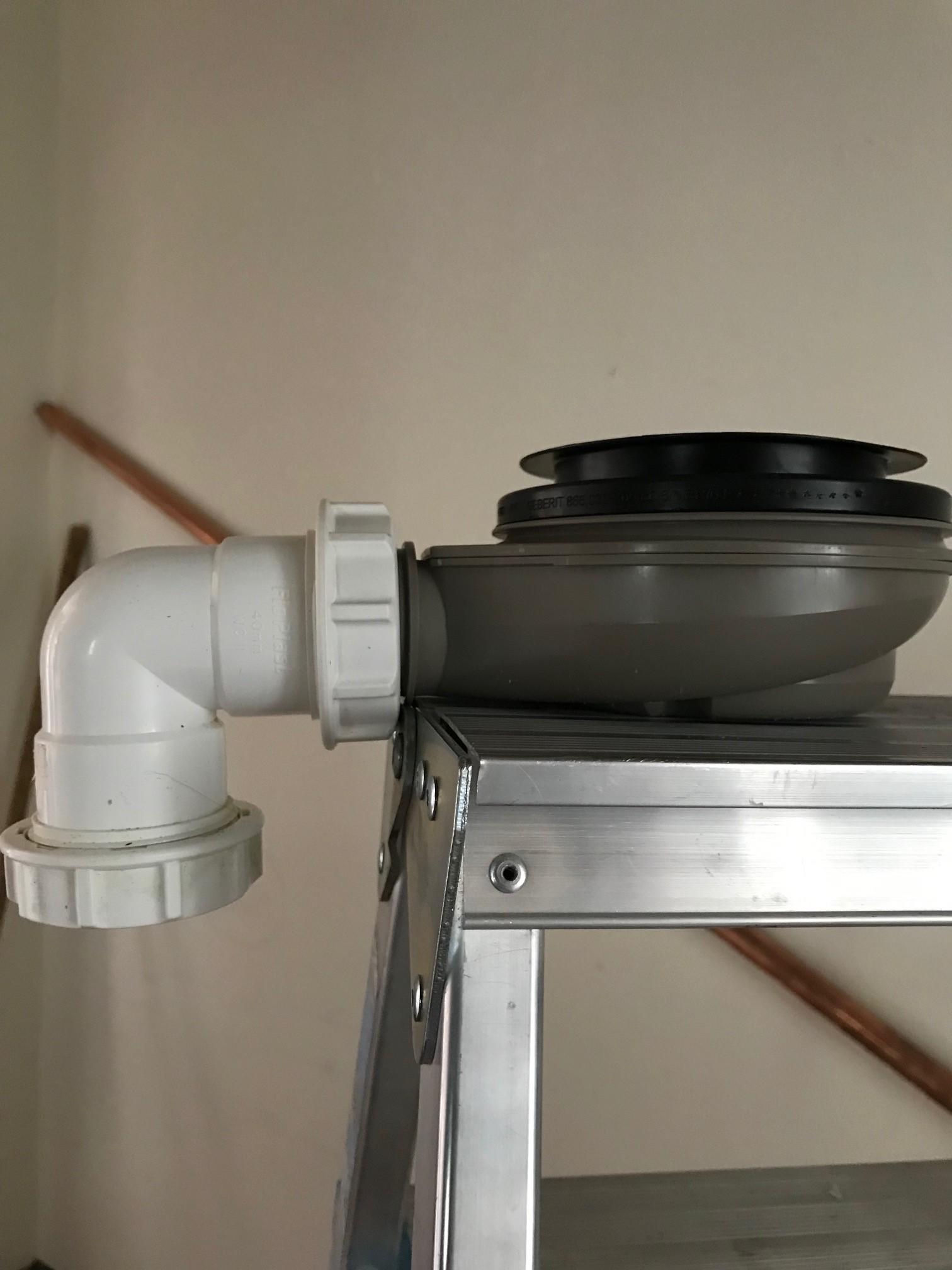

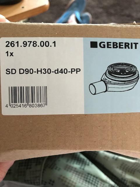

So got hold of some pushfit fittings from Screwfix yesterday and they are too big by 1mm ? Geberit OD 39.8mm Floplast pushfit pipe OD 40.9mm the 1mm I thought would not make much of a difference but the Geberit exit pipe flaps around like a d**k up a shirt sleeve. My own stupid fault for not taking the Geberit with me, ah well. Does anyone have any other ideas please because I'm about to send this thing into the back field
I must admit in the future I don't think I'll buy Geberit, I had to is this situation because the shower tray manufacturer insisted on this model

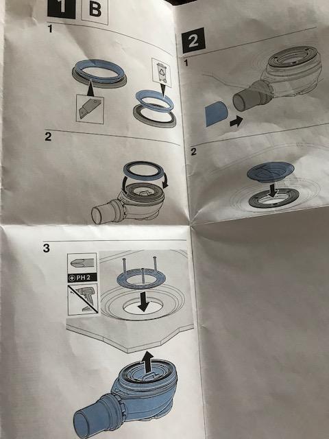

Instructions are an absolute joke and had to search around on the stupid Gerberit website for ages to find the right info No pipe I'm afraid, maybe if I'd paid another £50 I might have ?
No solvent due to the materials its made from. I''m the same when the pipe work is going to be locked away under a floor I like to use solvent but Geberit seem to think that other methods are fine on their stupidly expensive parts. Going to take it with me tomorrow on a day out in Banbury to see if I can find a good fitting push fit ? From my experience of manufacturers the more expensive it is the less information is available and the worse the design is. Just a temp fit up until the drainage is sorted out in the room below but thanks for the heads up anyway PeterW
I have a low profile Geberit shower trap and from the install instructions it requests that you do not use solvent weld so I thought a Floplast compression fitting would be fine but the collar of the compression fitting pushes against the bottom of the shower tray. Does anyone now of any waste compression fittings that have low profile collars? Stupid design :-(

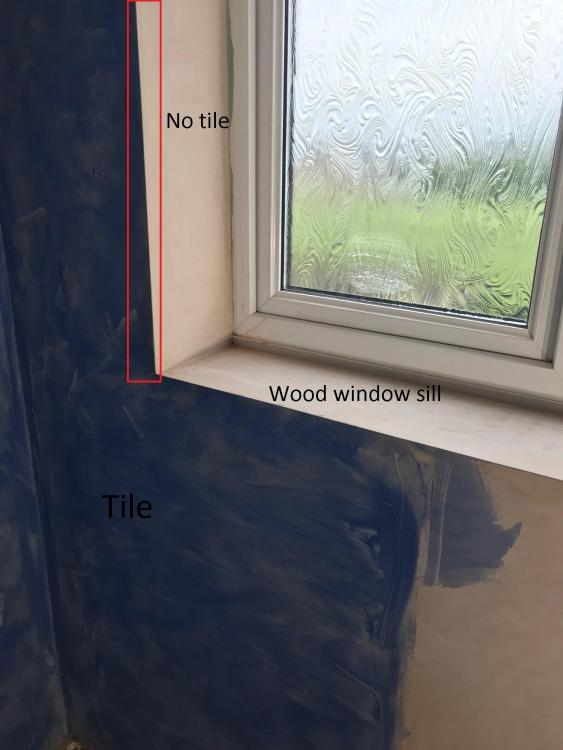

No I'm afraid the tiles do not have that option, Wickes specials so just basic ? Yes the top left corner is the only corner I need to do for the reveal but yes I'll make sure I measure twice cut once, I just like making things hard for myself, I actually hate tiles and would have used panels but wifey put her foot down and the tile decision was made. The way the bathroom is planned it would look wonkey tiling the reveal and I'm using a wood sill because I have all the time in the world and cant wait for it to warp and twist so I can take it out again and burn it on the wood burner ??? Thanks for the advice chaps ?

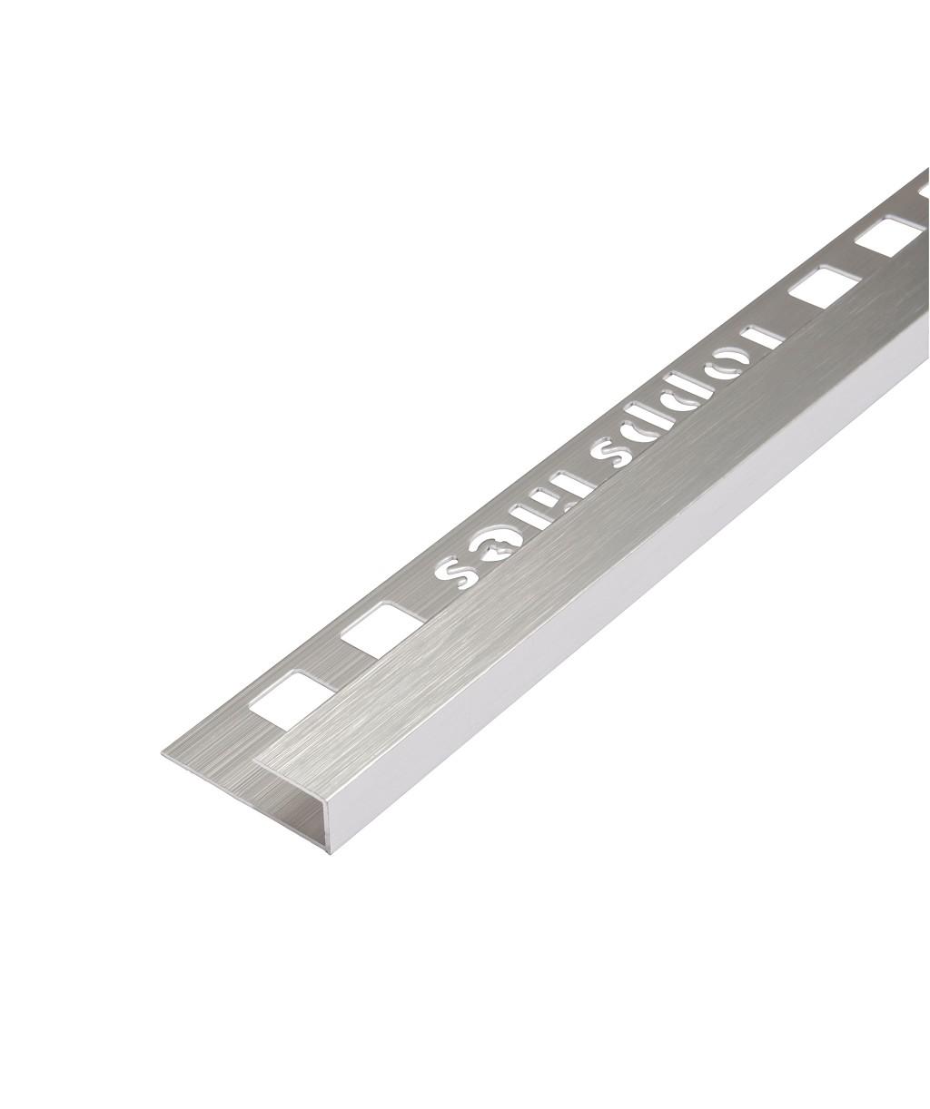

I am tiling my bathroom shower area soon and doing a bit of pre planning and had a question regarding how to finish a tile edge at the point that it meets the window reveal? In the pic below the blue tanking shows the area to be tiled, the window reveal with no tile and a wood window sill. I have marked the area in question with a red box Would I just use one of these in the pic below? I was not sure as I could not find an example online that was equal to my requirement As always thanks for any advice you give as it help so much guys ?

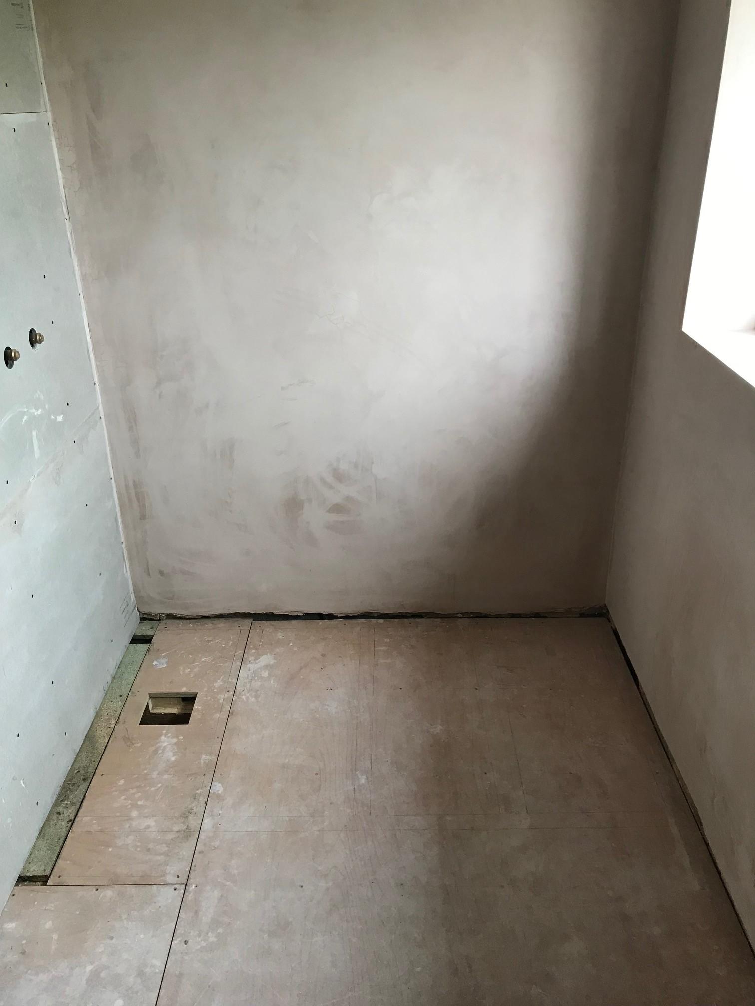

Thanks Nick, yes I'll stick with the 1st idea as could be a problem getting the tile board back on. Should I tank the 18mm Plywood floor? its already been SBR'd -

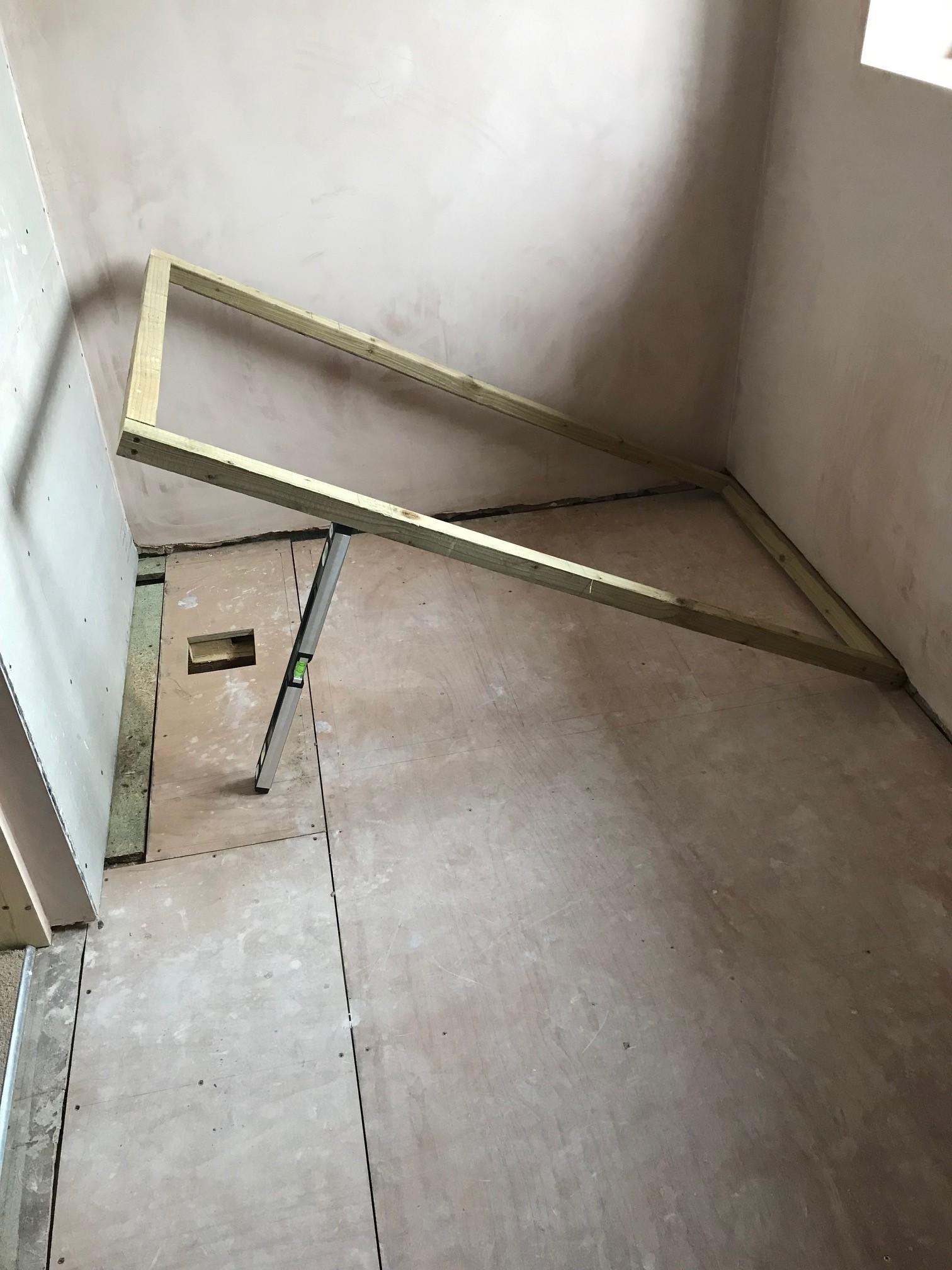

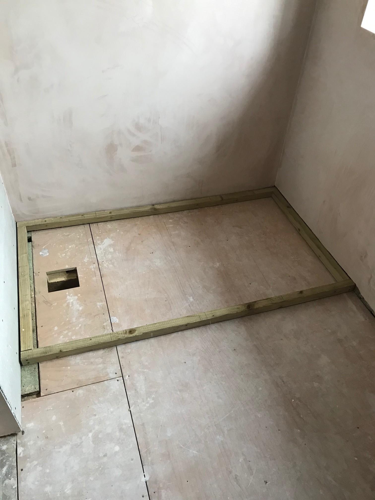

Just had an idea, I'm going to remove the tile backer board from the other shorter wall as this will allow me to pivot the tray from the longer edge against the back wall doing away with the 2x4 through the waste hole. after the tray is in position I'll just re-attach the tile board and seal/tank. ? -

Hey people thanks so much for the ideas ? This was my original plan but the wall bows out at the shorter newly plastered end ? I know exactly what you mean but lowering all 4 props at the same time would result in whatever hair that is left on my head gone forever ? but from this idea I am going to use the waste hole in the floor to hold one end of the tray up. See pics below ? As in the pics below I have made a mock frame that replicates the tray exactly and from this I have realised that no I cannot lift vertically from the front edge as the newly plastered wall on the short end bows out. The manufacturers instructions say to use a Acetic Silicone or Polyurathane to seat the tray so was planning on using CT1. I have some Aquaseal which I planned on using on all 3 walls top to bottom and also applying to the 18mm ply floor area in the tray footprint, the plywood has already been SBR'd but the more protection the better eh ? I'm using 600x300x9mm tiles, wanted panels but wifey didn't like them. --------------------------------------------------------------------------------------------------------------------------------------------------------------------------------------------------------------------------------------------------------------------------------------------- So this is the area I'm working with: I have cut a channel just a bit thicker than the tray into short wall near the window as in pic below I plan on applying the CT1 to the floor then moving the tray end into the channel I cut and propping the tray up at one end with a 2x4 which will be poking through the shower waste hole - see pic below , I also plan on applying Silkaflex to the edges but don't know if I should apply this once the tray is down or whether to apply a small amount before lowering the tray? Once the CT1 and any Silkaflex has been applied I'll run down stairs and man handle the 2x4 post and lower the tray into position ......easy What could possibly go wrong ?
