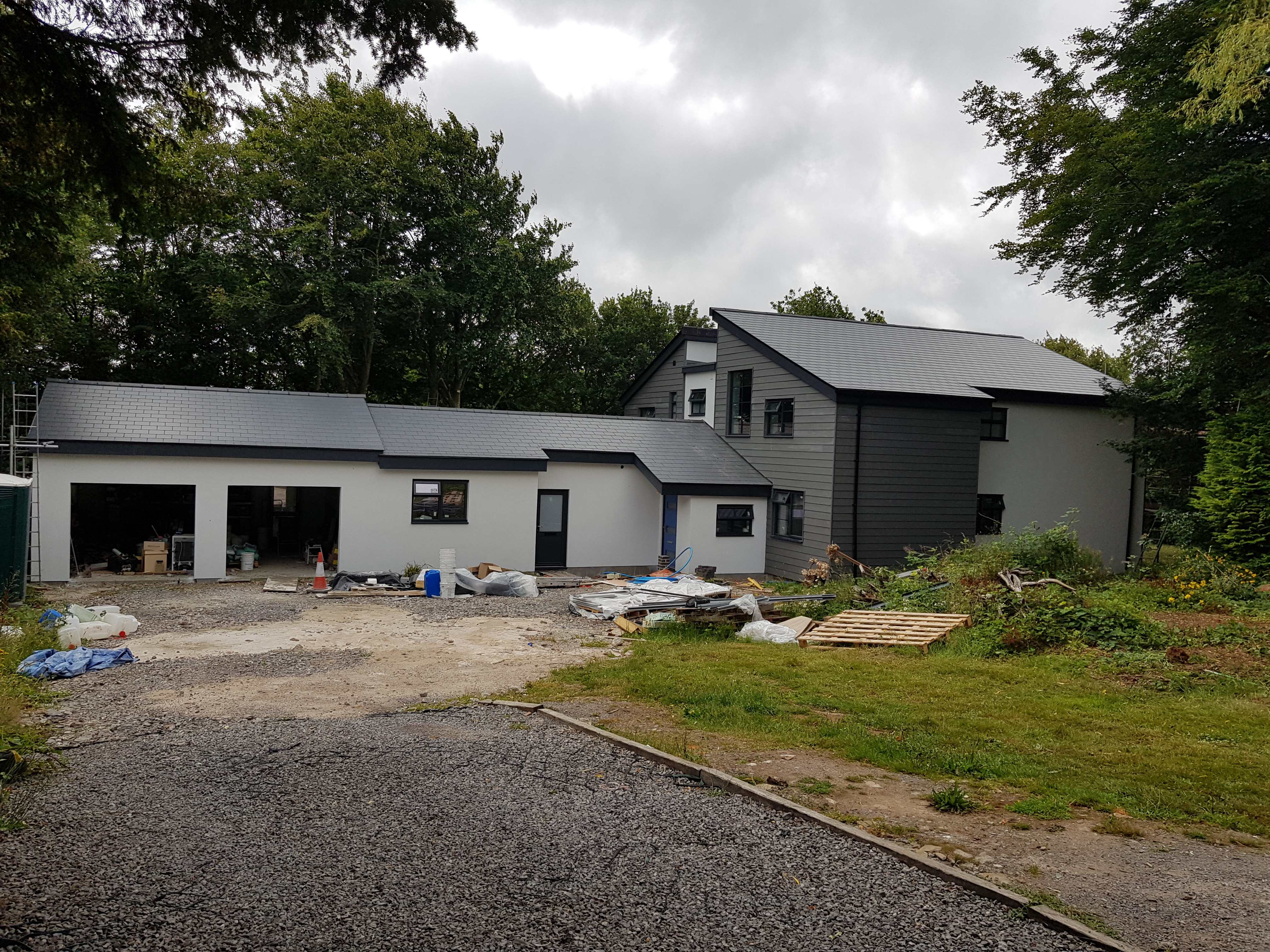

I have gone for a combination of Drivit Render and fibre cement cladding (Cladco)on my Nudura build. Photo taken last week. Still cladding rear but render finished and looking crisp in White Haze which has the slightest touch of grey in it. Hope that helps. Cheers Drew -

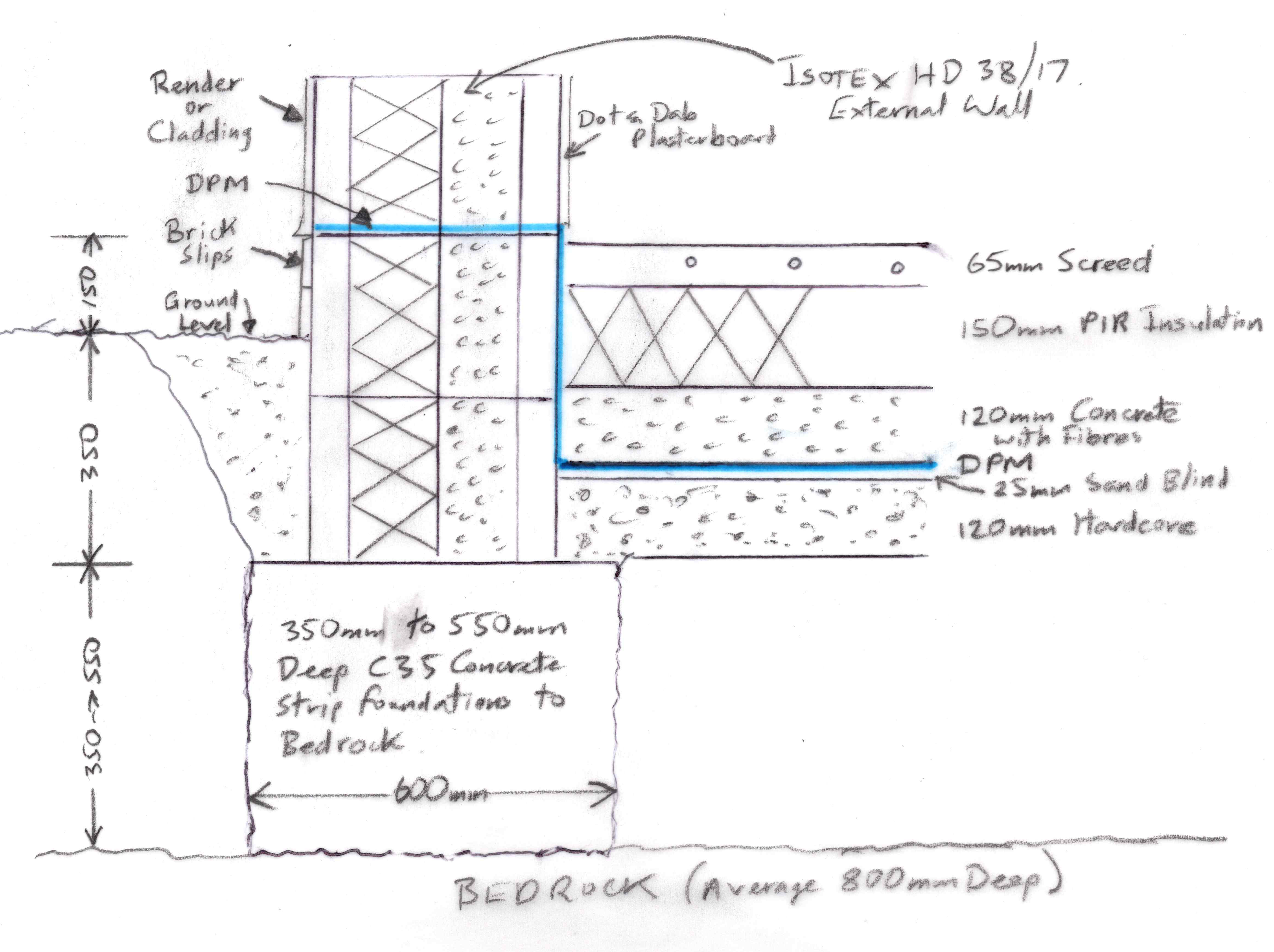

I've short listed Isotex for my build and have below The strip foundations /slab /dpc detail as I see it (will most probably have the slab at 150mm). Doing it this way you ca clip the u/f heating pipes to the PIR Insulation (would add another DPC between PIR and under Screed. This would also be the detail for door threshold i.e. footing plus 2 blocks woth DPC.
